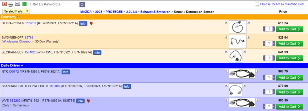

I wonder if I should try replacing it then. My car makes all sorts of noises and vibrations that I don't understand, but I also tend to be a little too concerned and obsessive with small stuff that probably isn't important.
$150 is steep for a non-essential "fix". I can buy a used OEM one on eBay for like $20 shipped. I don't see any brands I particularly like/recognize on RockAuto though...

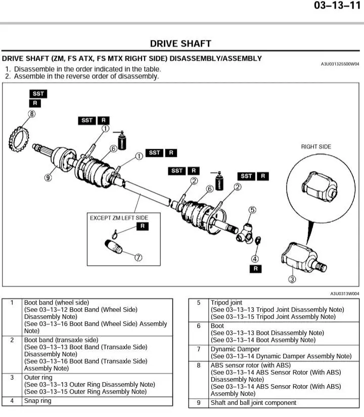

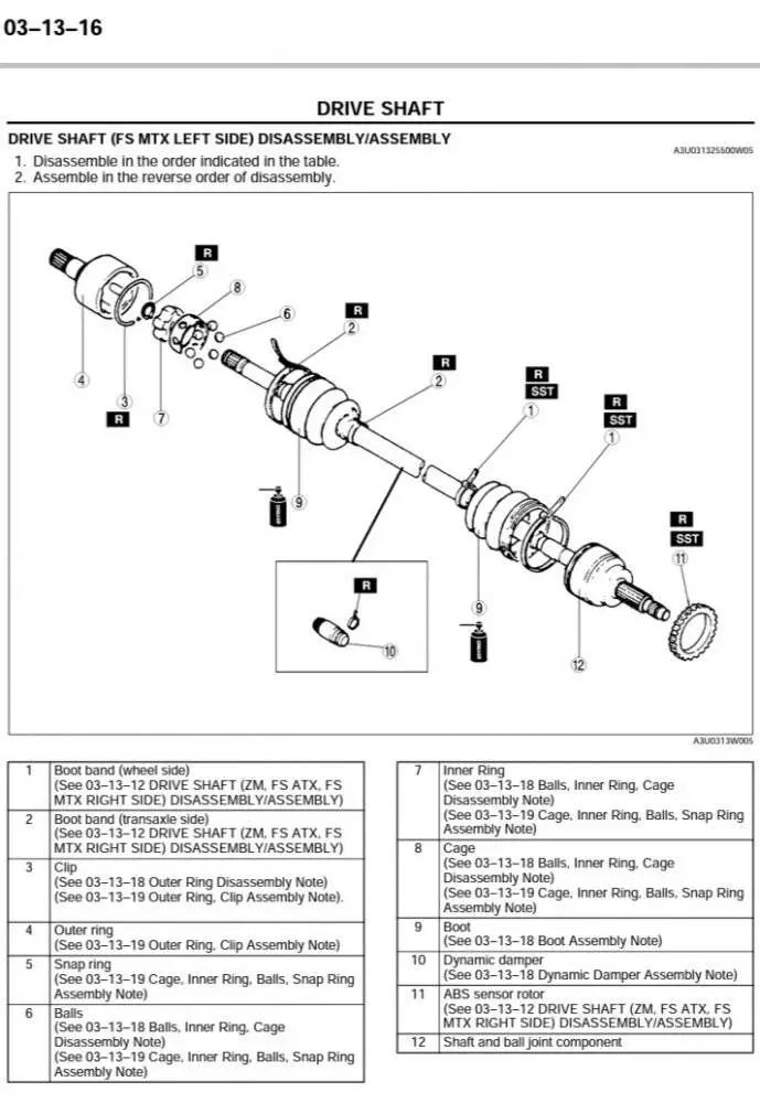

The left front axle is different for the manual transmission.
It looks like it's a much beefier axle, but I have no idea why they would only beef up one side ??
It may not even fix anything.
I'm ignoring mine until I notice a problem.
I would worry that it would be an original OEM sensor and they just wiped the goo off. Lol
I don't really know about brands, but at least with RockAuto, it will almost certainly fit and work.
How long it lasts and the quality has more to do with the brand I guess?

Part of that might be to keep the weight of each axle the same.
I think it was my GLC that had a big rubber weight on the shorter axle to weigh it down.
If one axle is lighter it will have less inertia, it will get more power during acceleration and the brake on that side will grab harder during deceleration.
On our car they use the same axle for both sides on the ZM automatic and standard transmissions.
The FS has that same axle for both sides on the automatic but the standard transmission has a different axle (not necessarily heavier, but stonger) on the left side only.
I don't get it?

I wonder if I should try replacing it <the Knock Sensor> then.
Unless its throwing the code, I'd hold of buying it and use your money elsewhere.
To me, pinging sounds more like a rattle than anything I'd call a "ping." You might be able to reproduce the sound on a normally-working engine by going up a hill and lugging the engine at the same time - or if that's not pinging, it sounds similar to me. Someone here may be able to describe it better.
To me it sounds more like a clatter or clattering on acceleration or putting a load like "going up a hill and lugging the engine" or accelerating while braking at the same time to load the engine down.
Here's an article linked below that might help (or not) when I searched for pre-ignition/detonation.
They also talk EGR and Knock Sensor stuff as well.
What Is Pinging, Detonation and Pre-ignition

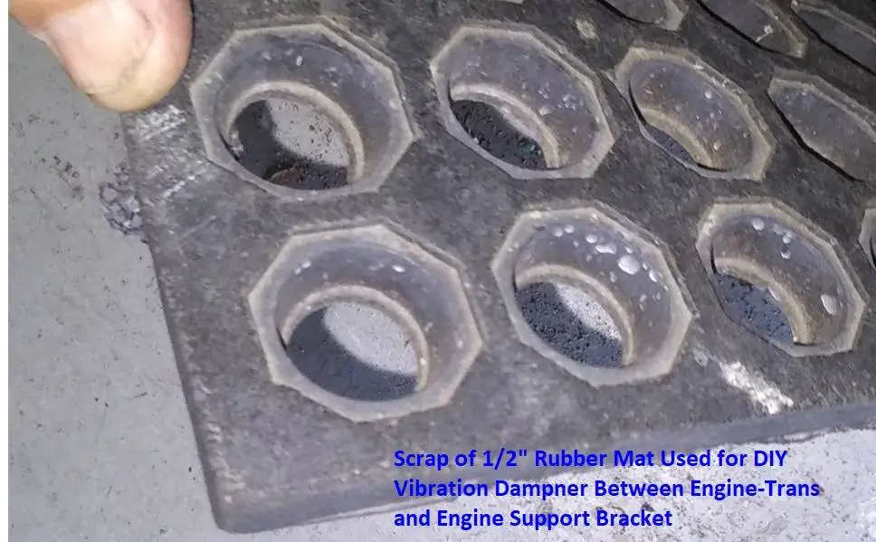

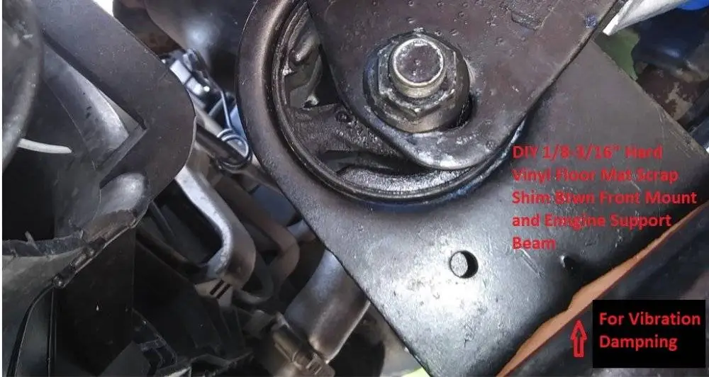

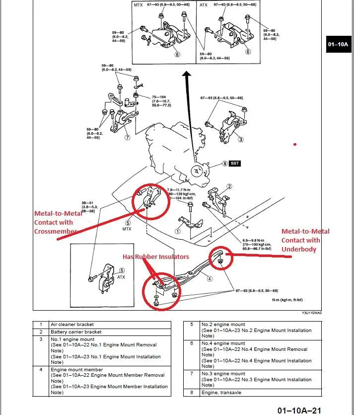

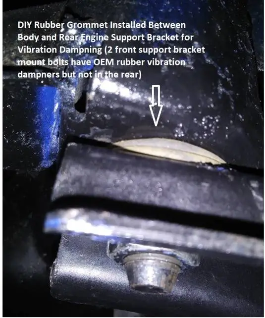

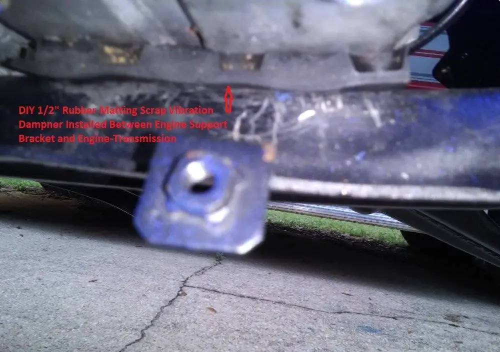

Some photos attached below:
Other front-end engine/drivetrain vibrations calmed down after I experimented and:
--Installed a hard vinyl shim (about 1/8-3/16" thick) under the front motor mount between the engine support bracket and the mount.
--Installed a (spongy about 3/8" thick) rubber body grommet between the body and rear engine support mount stud and bracket (also added a larger washer under the mounting nut -not shown).
--Installed a piece of rubberized mat about 1/2" thick (probably could used folded rubber hose pieces) between the engine support bracket under the engine/transmission.

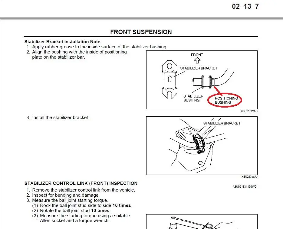

--Replaced the Sway Bar Bushings with new Stock OEM rubber bushings and installed a DIY bushing retainer.
Rear end noises were primarily from 155K mile struts, old (and one damaged)s strut links, worn out sway bar bushings, and loose areas of the rear bumper where mount clips were broken (and drilling a few holes and using zip ties did wonders).
The Megan shifter - Well I pretty much RTV gasket sealed everywhere and anything where metal met metal under the shifter body plate, inside the aftermarket metal shift knob void and shifter threads.
--I also broke down and replaced the two bronze shift bushings at the base of the shifter with the OEM plastic ones and packed the inside of all the shift linkage tubes with CRC Silaramic high temp brake grease.
-Now I'm not noticing any vibration (that I can tell) apart from the ringing in my ears from working on F-4/F-15 Fighter aircraft.

  • P5 Hard Vinyl Shim Installed Between Front Motor Mount and Engine Support Bracket .webp
  • P5 DIY Vibration Dampner Between Engine-Trans and Engine Support Bracket.webp
