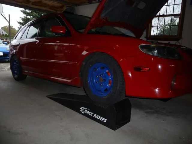

Just came in from swapping the snow tires on. Also topped off the coolant and oil and loaded her up for my trip up to Boston tomorrow. I think this is the lightest I've ever packed for a trip up there. If the Noreaster hits us as expected I'll get a good idea of how well these Nokians are going to do for the rest of the season.

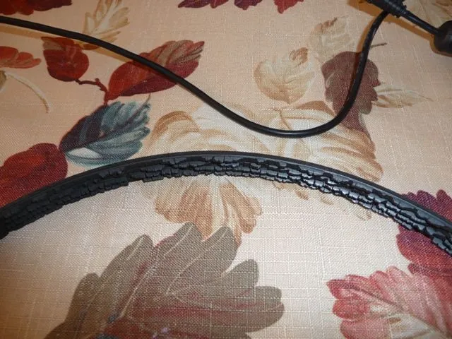

Took a ride up to Boston to meet up with the NEPOC gang yesterday and came home with a bumper while dodging downed trees on 287 in NJ in the snow. Changed the accessory belts while there so no more annoying squeal in the cold....woohoo! Belts were original and had over 153K on them...DOH.
Winter Mode

Hmmmm, wouldn't know why it was squealing. lol

Is belt chirping/squealing common on these cars? Mine has started squealing in cold/damp conditions, but goes away after 10-15 seconds. My belts are brand new though, about 6K on them...
They simply might not be tight enough. Generally a couple weeks after you install belts you should check their tension again because they tend to loosen up over time. I just recently tightened my alternator belt because it was way too loose; at stoplights I could make it squeal on demand by pressing the rear-defroster button :P
