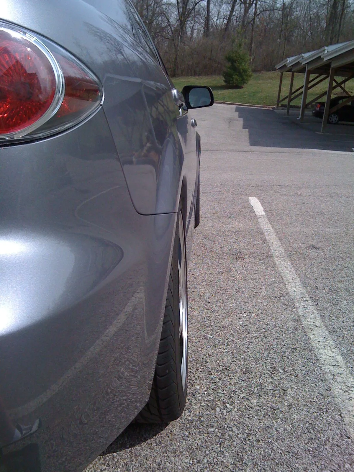

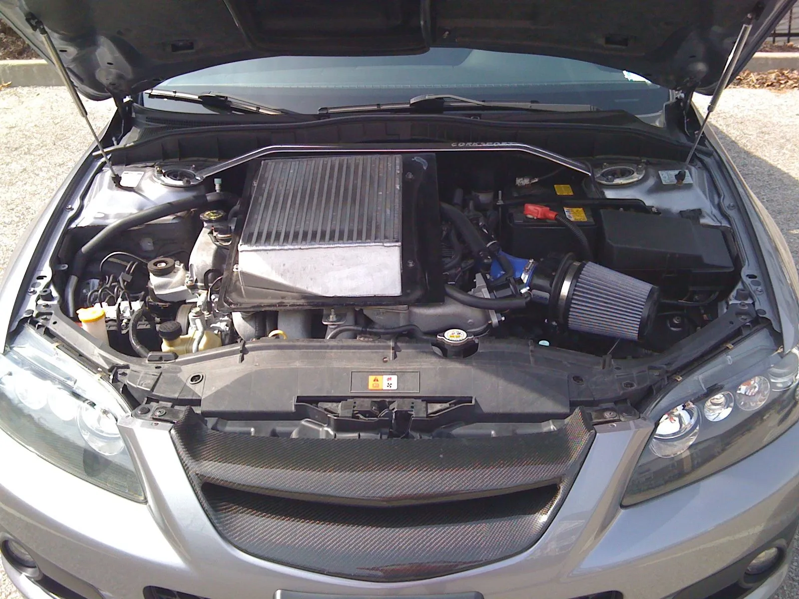

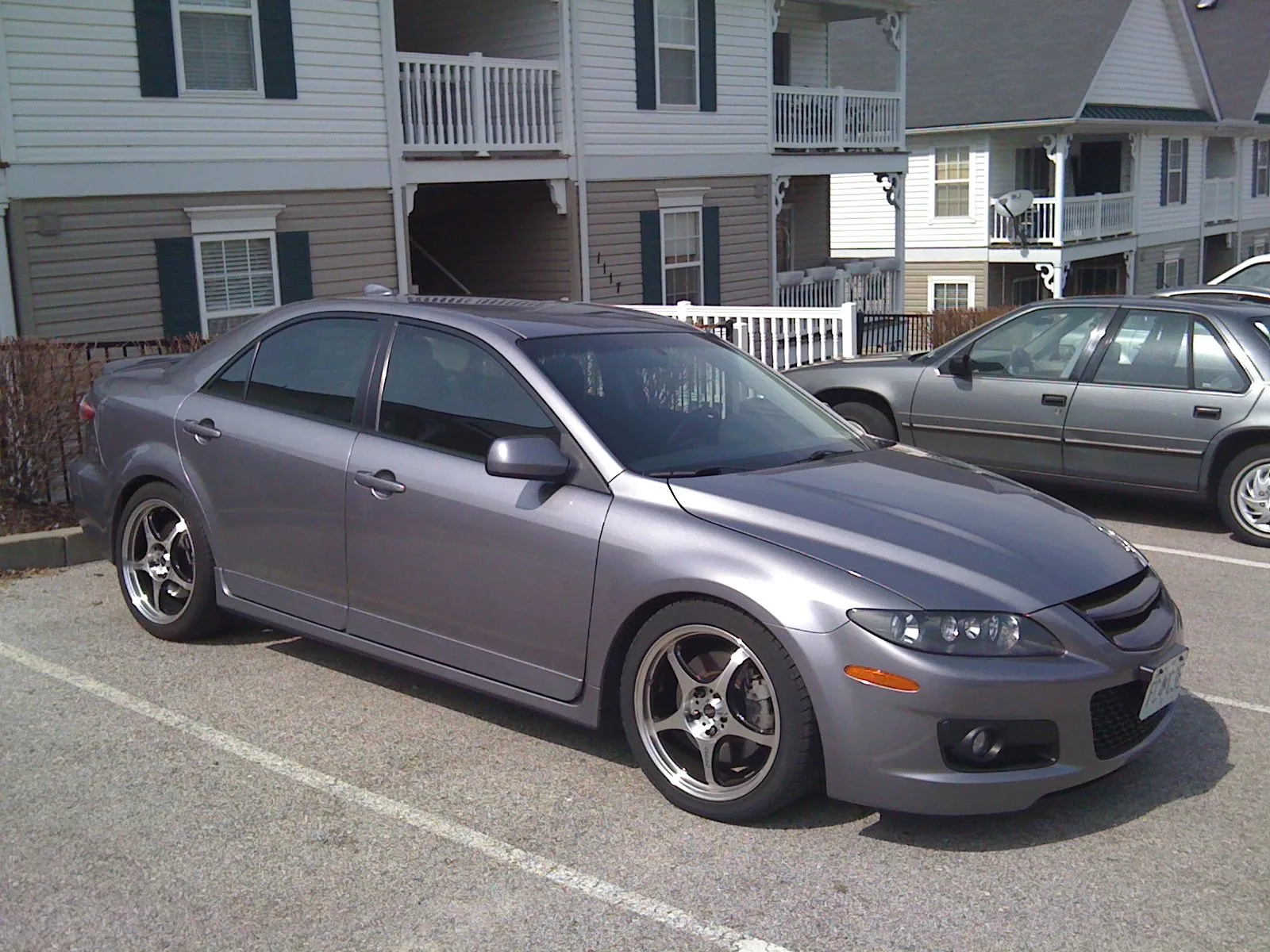

Took a three day weekend on the nicest day of the year so far. Gave a quick wash, adjusted my clutch pedal, cleaned inside... Kind of nice after a long winter.

sweet pics chris.. cars looking sexy!!.. two things.. must.. paint.. calipers and rotor hats. that is all
That's in the cards. My 5-Zigens are only 8 months old and the clear is already peeling (frustrating). When I take them off to get them re-cleared I'll paint the calipers and center of the rotors.
