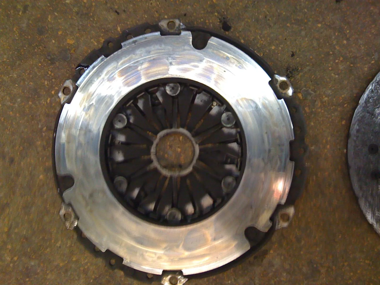

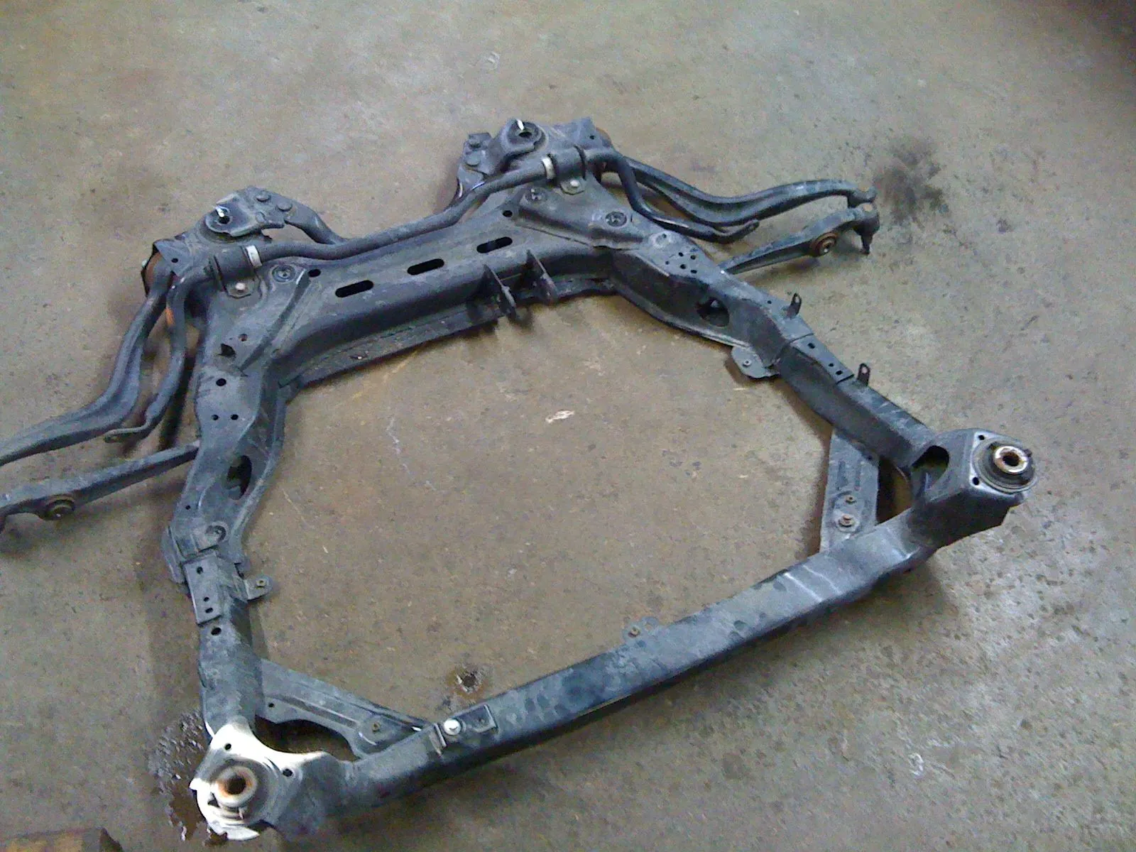

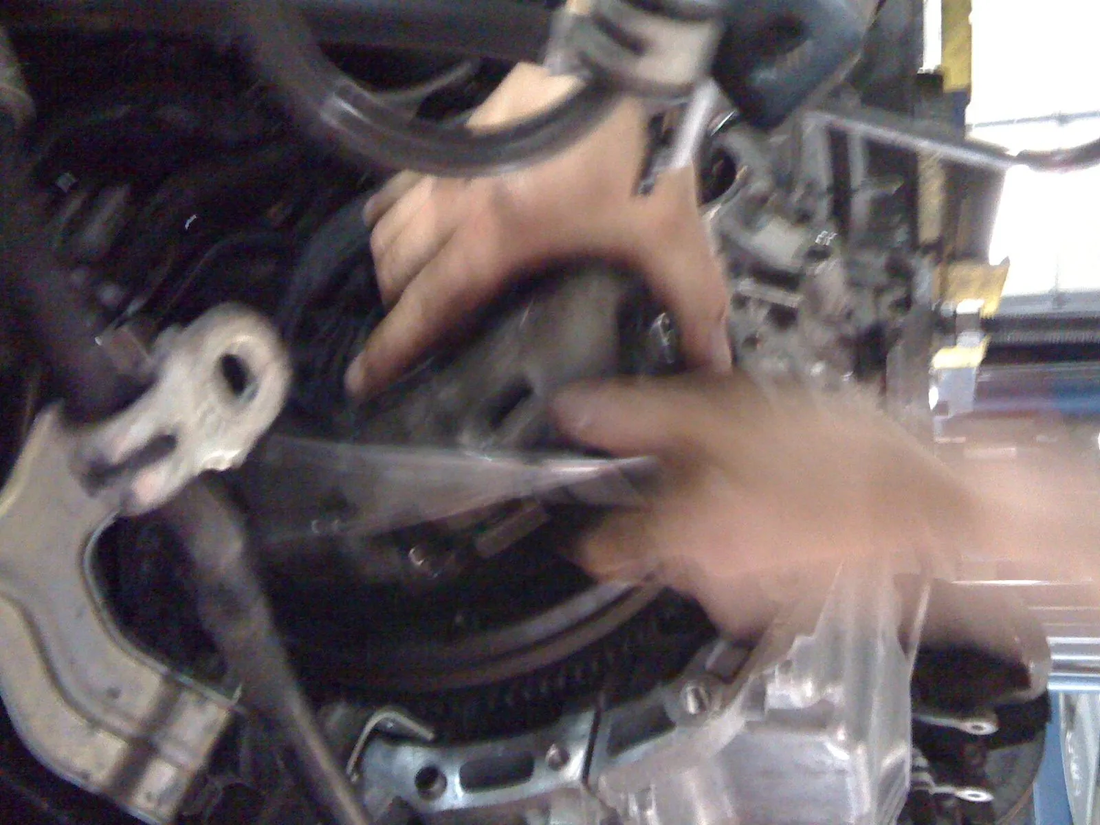

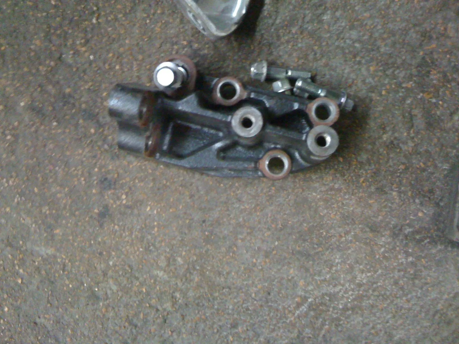

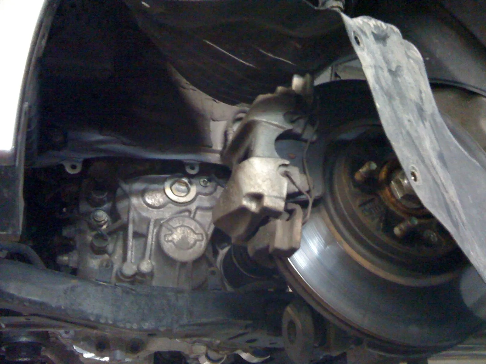

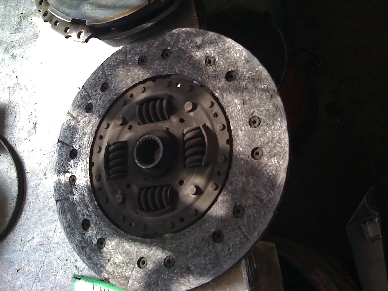

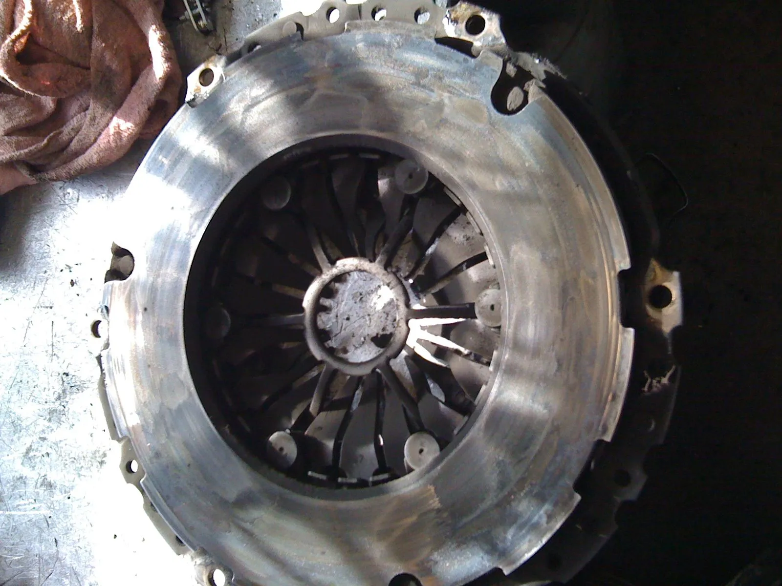

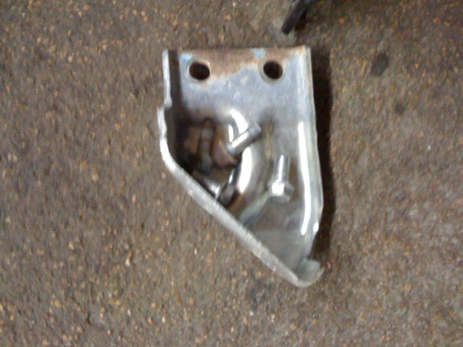

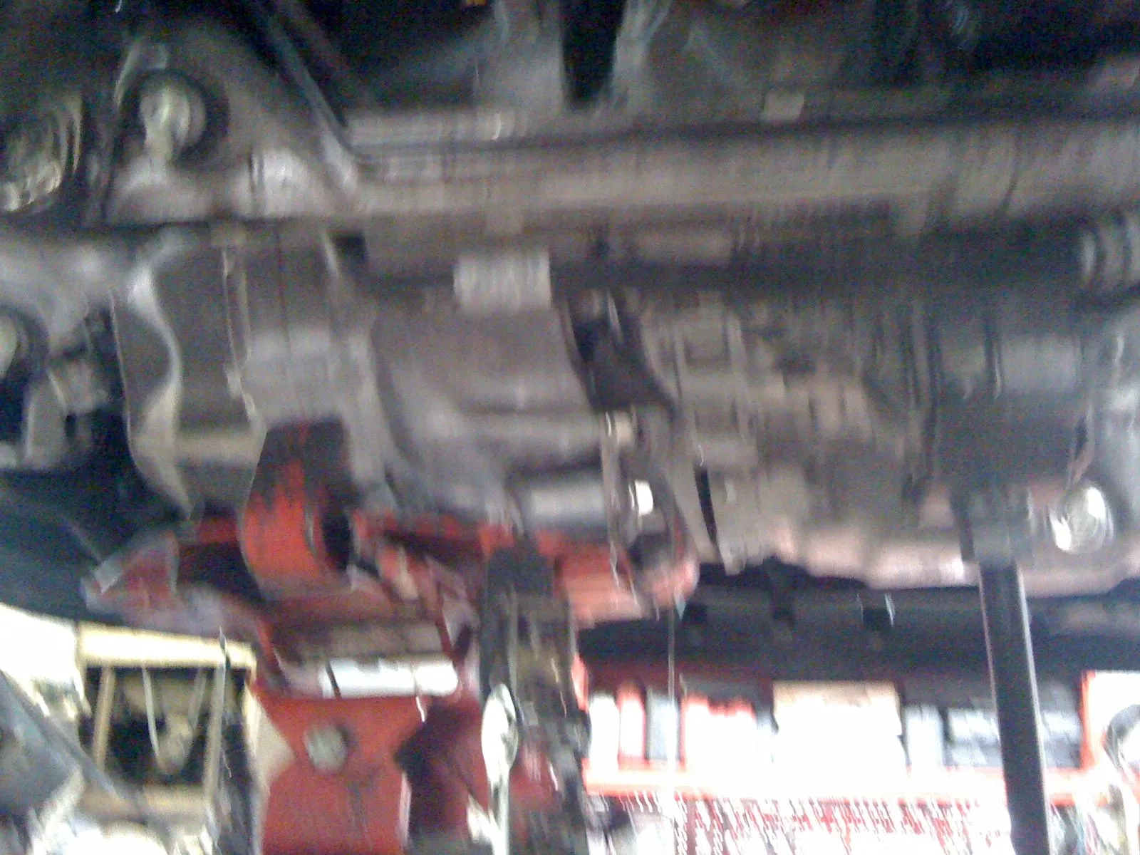

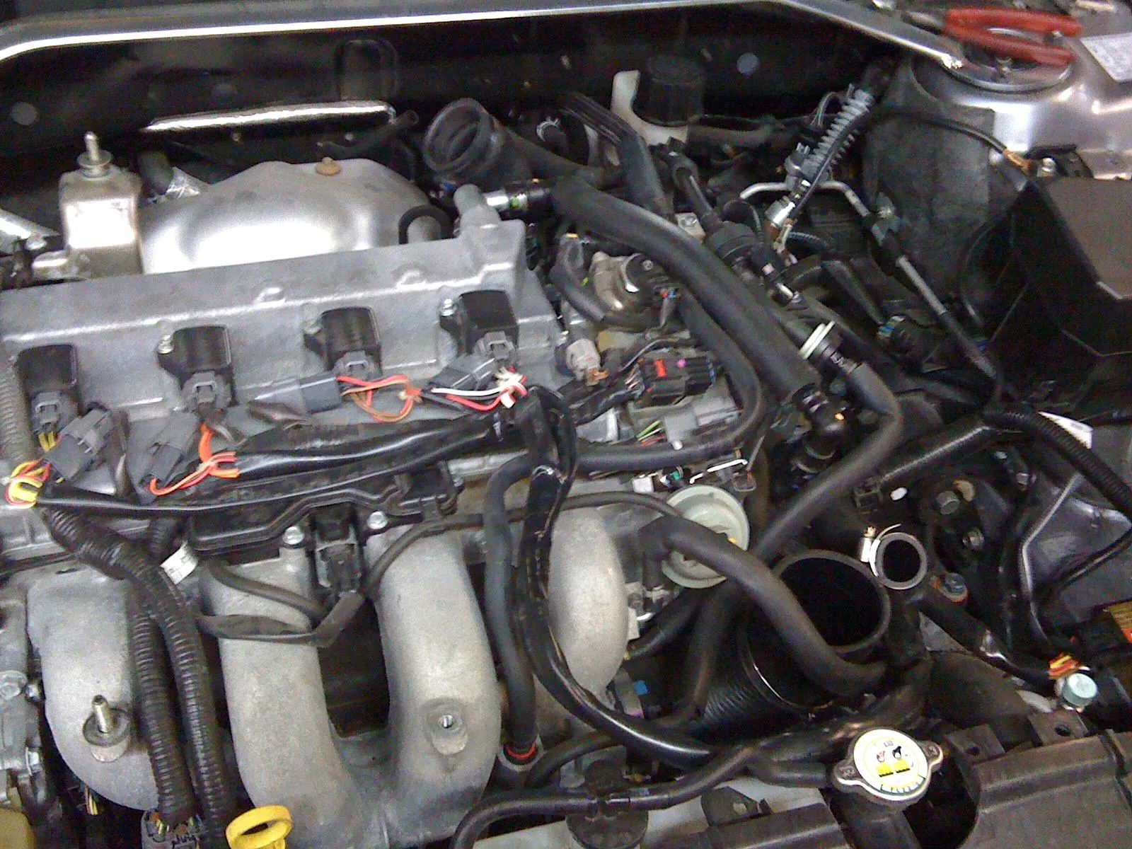

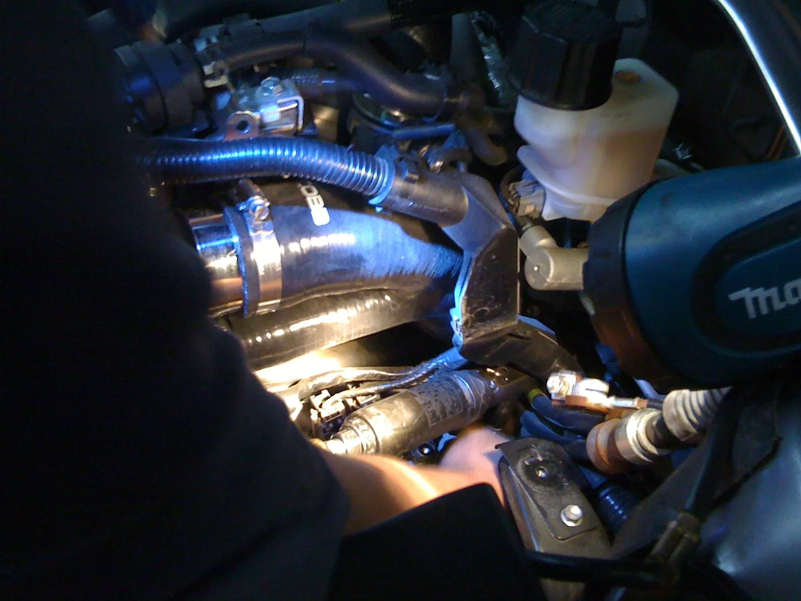

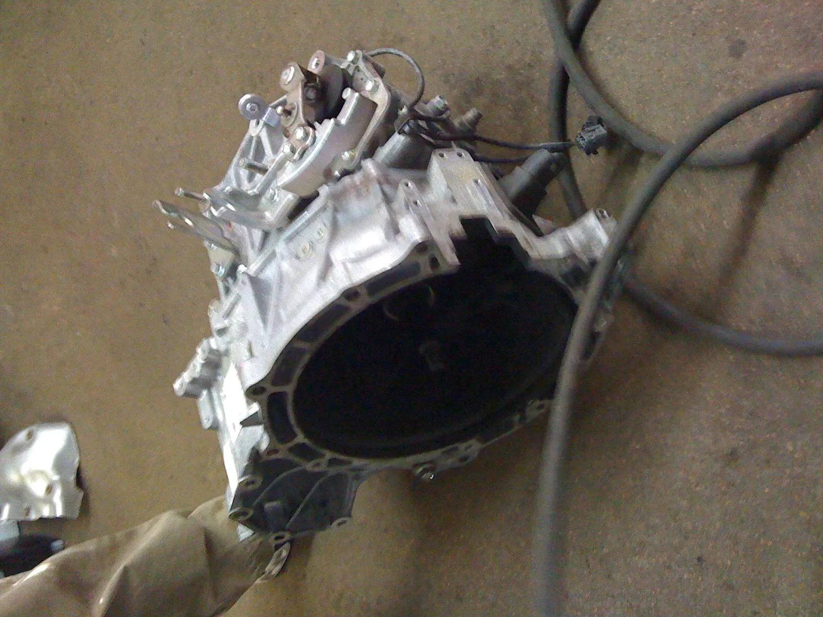

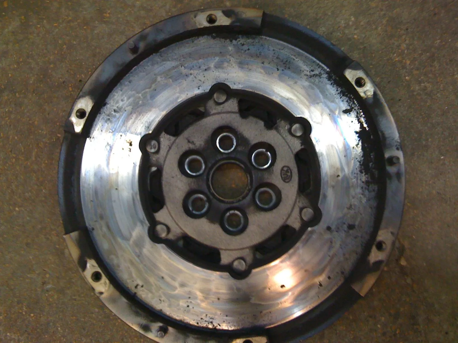

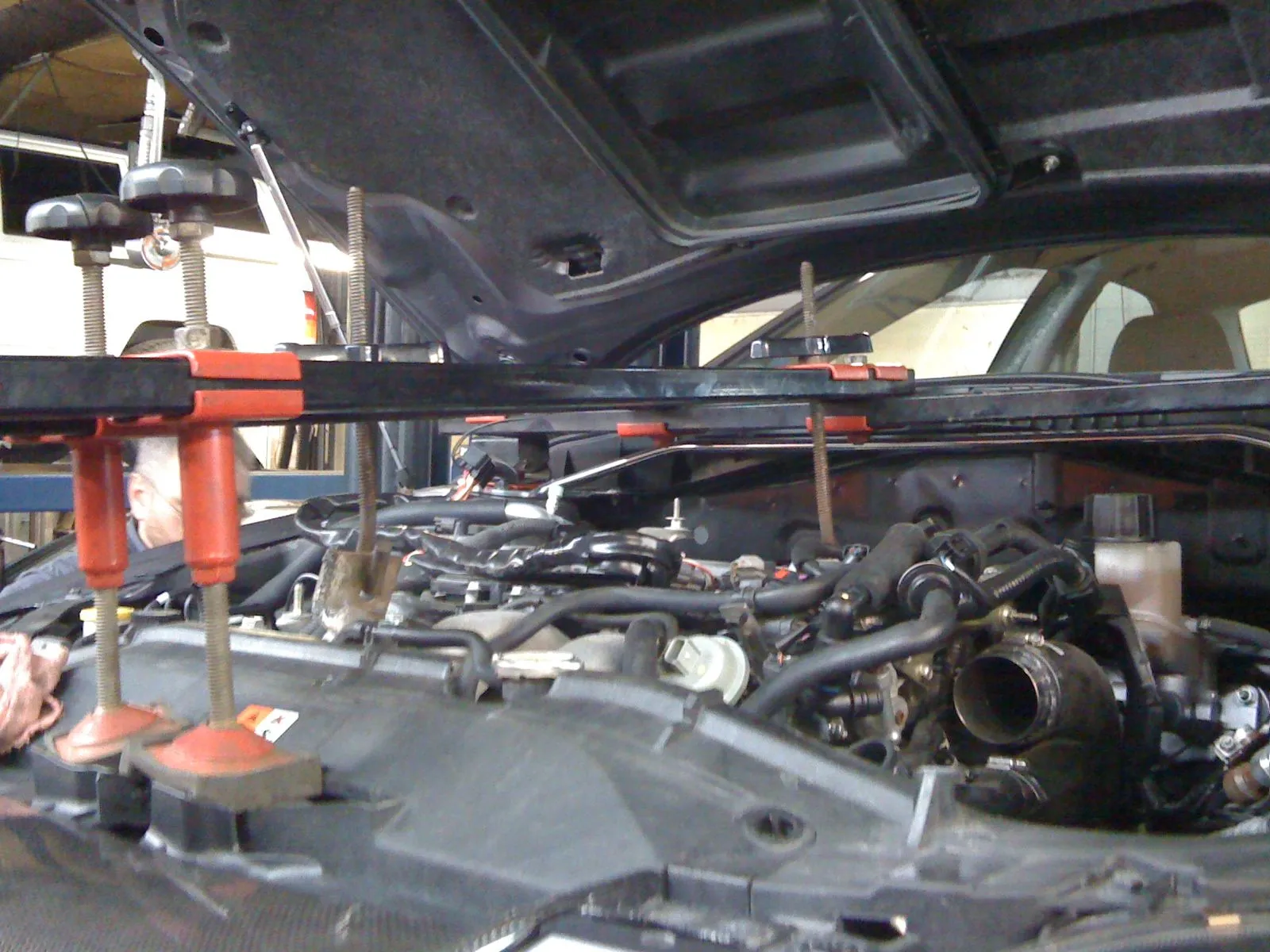

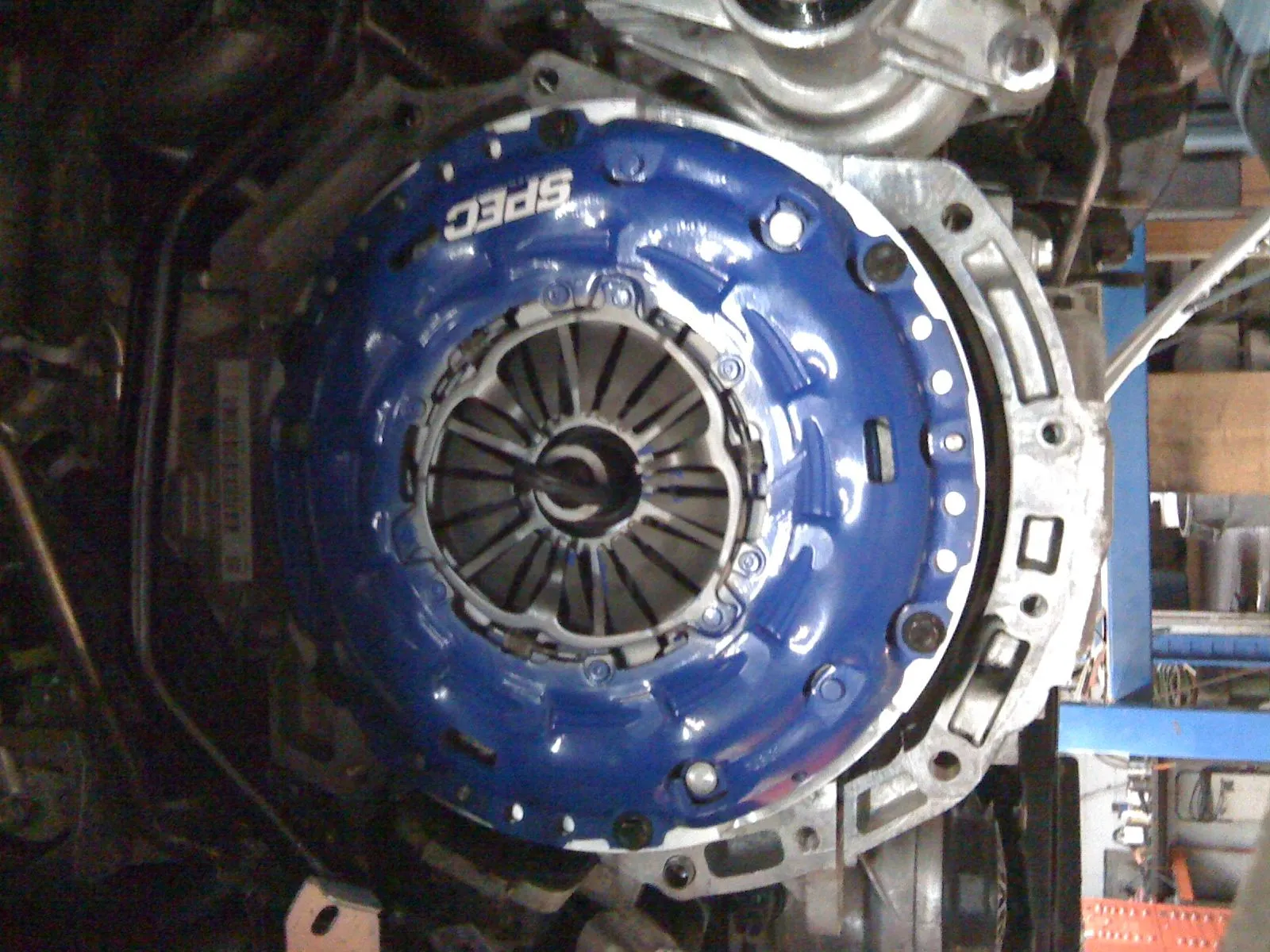

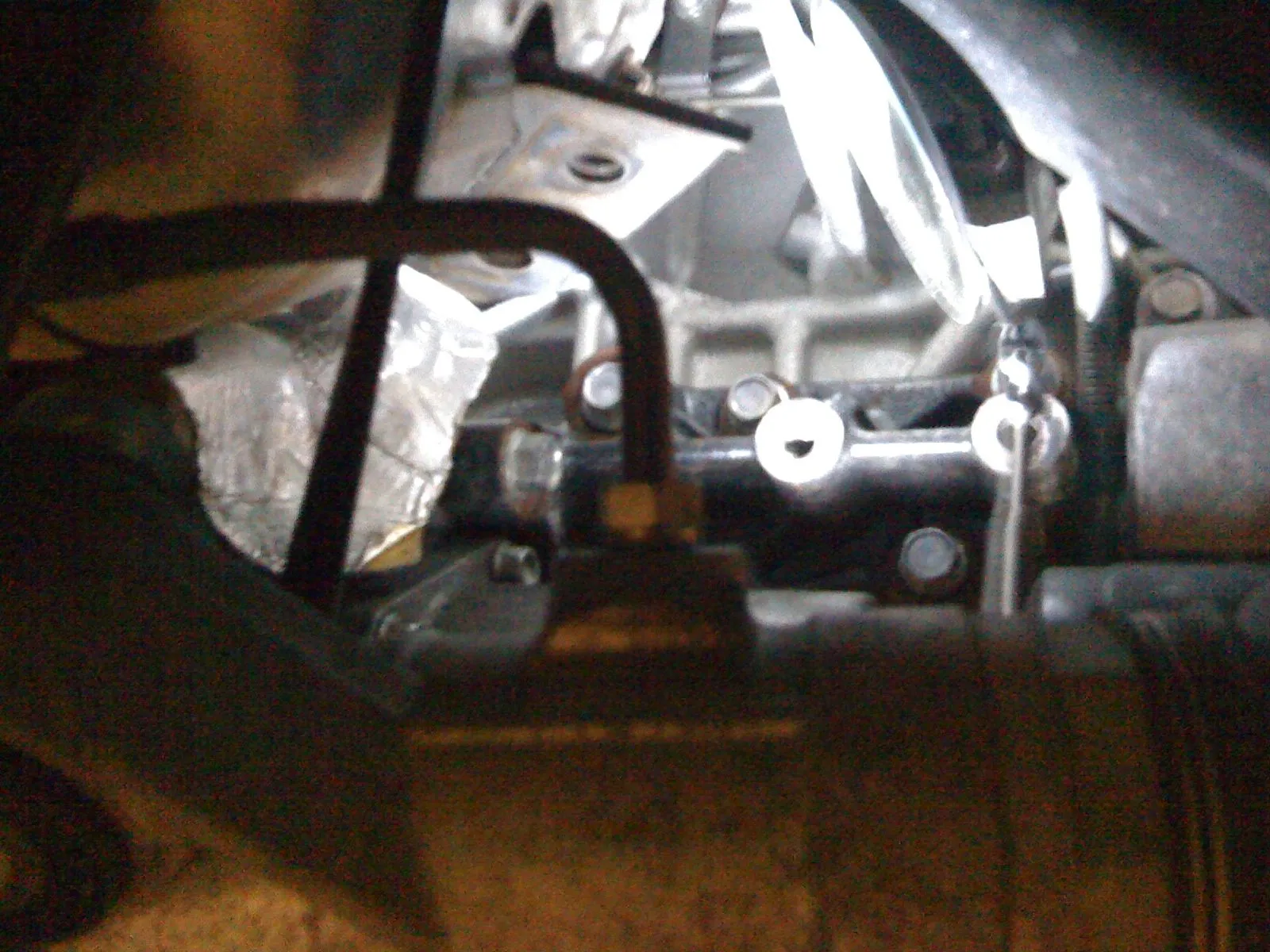

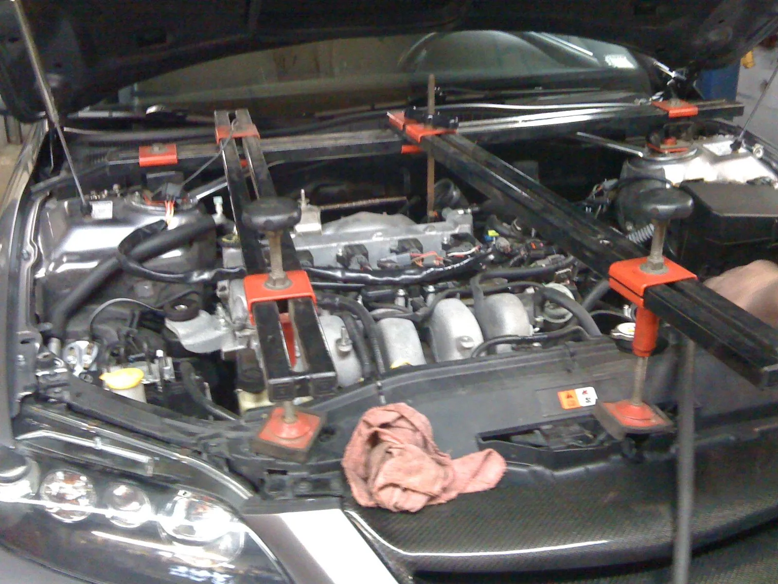

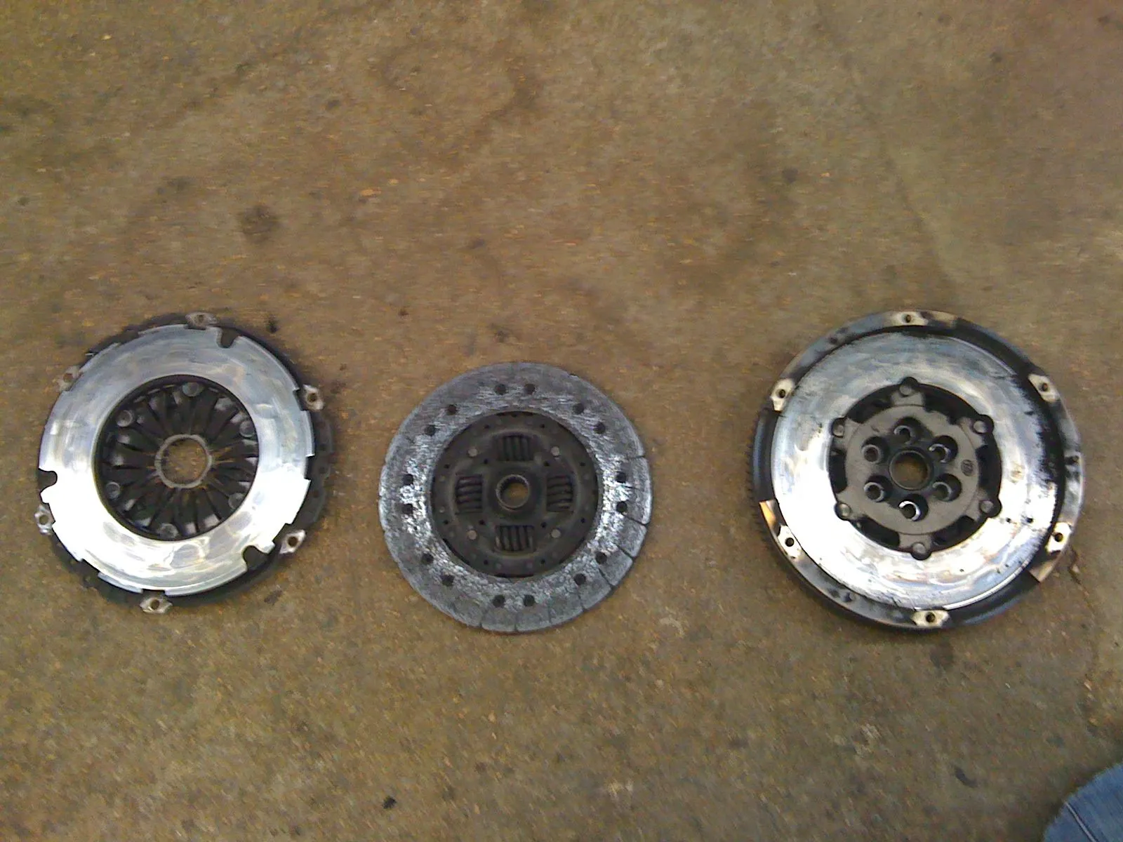

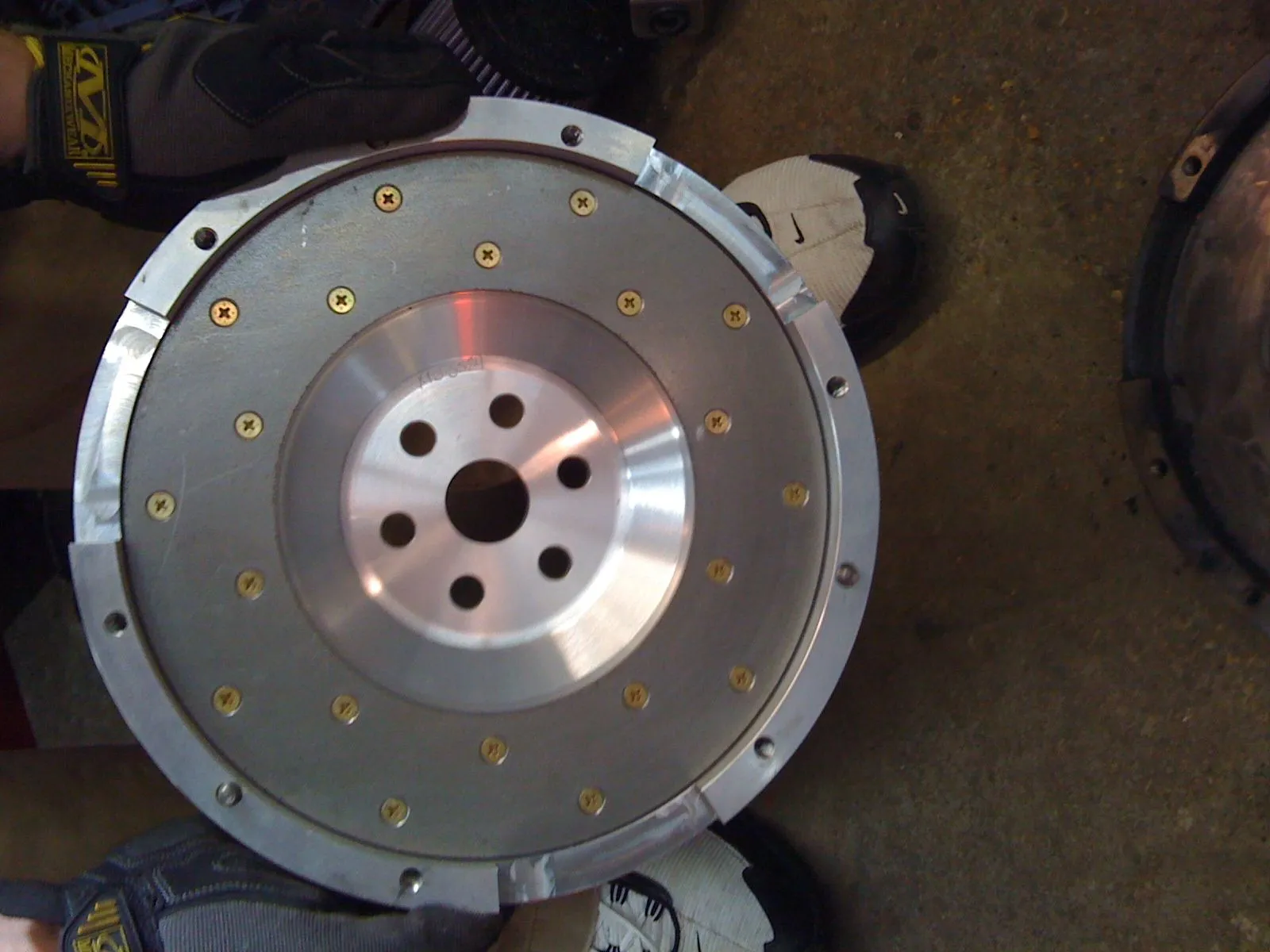

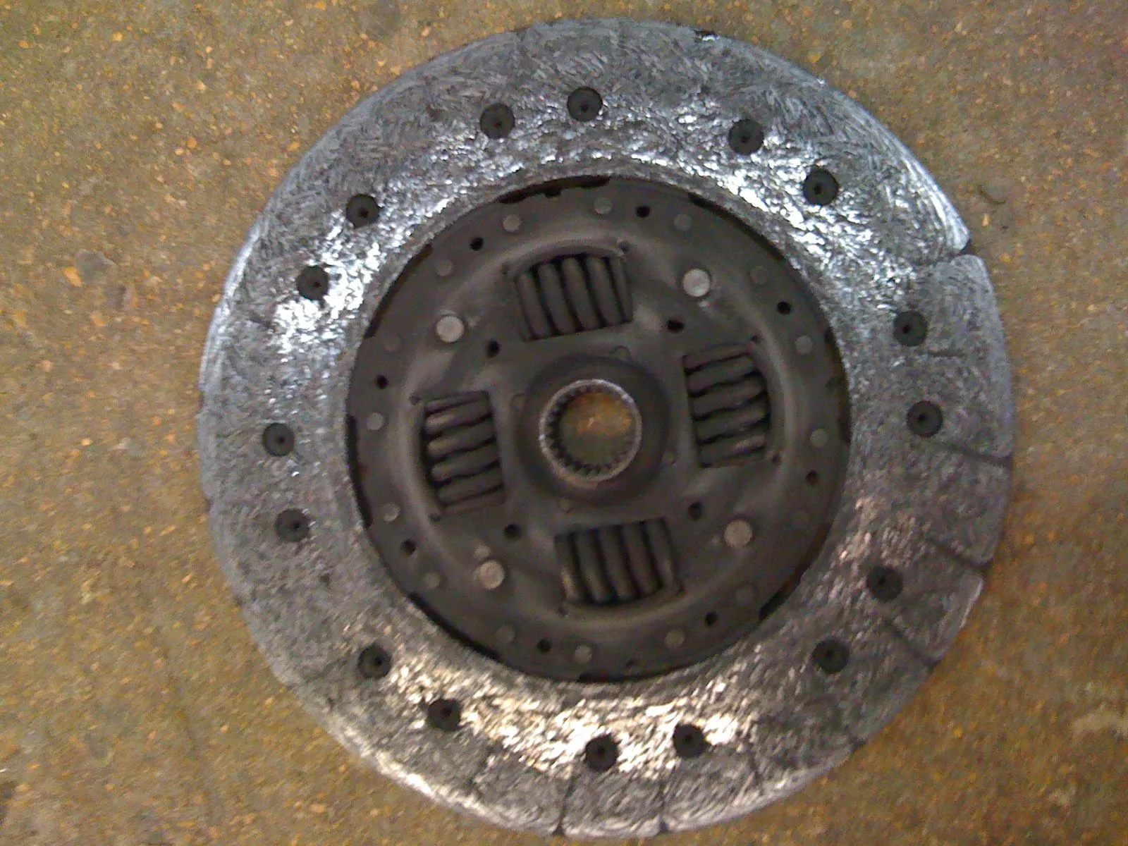

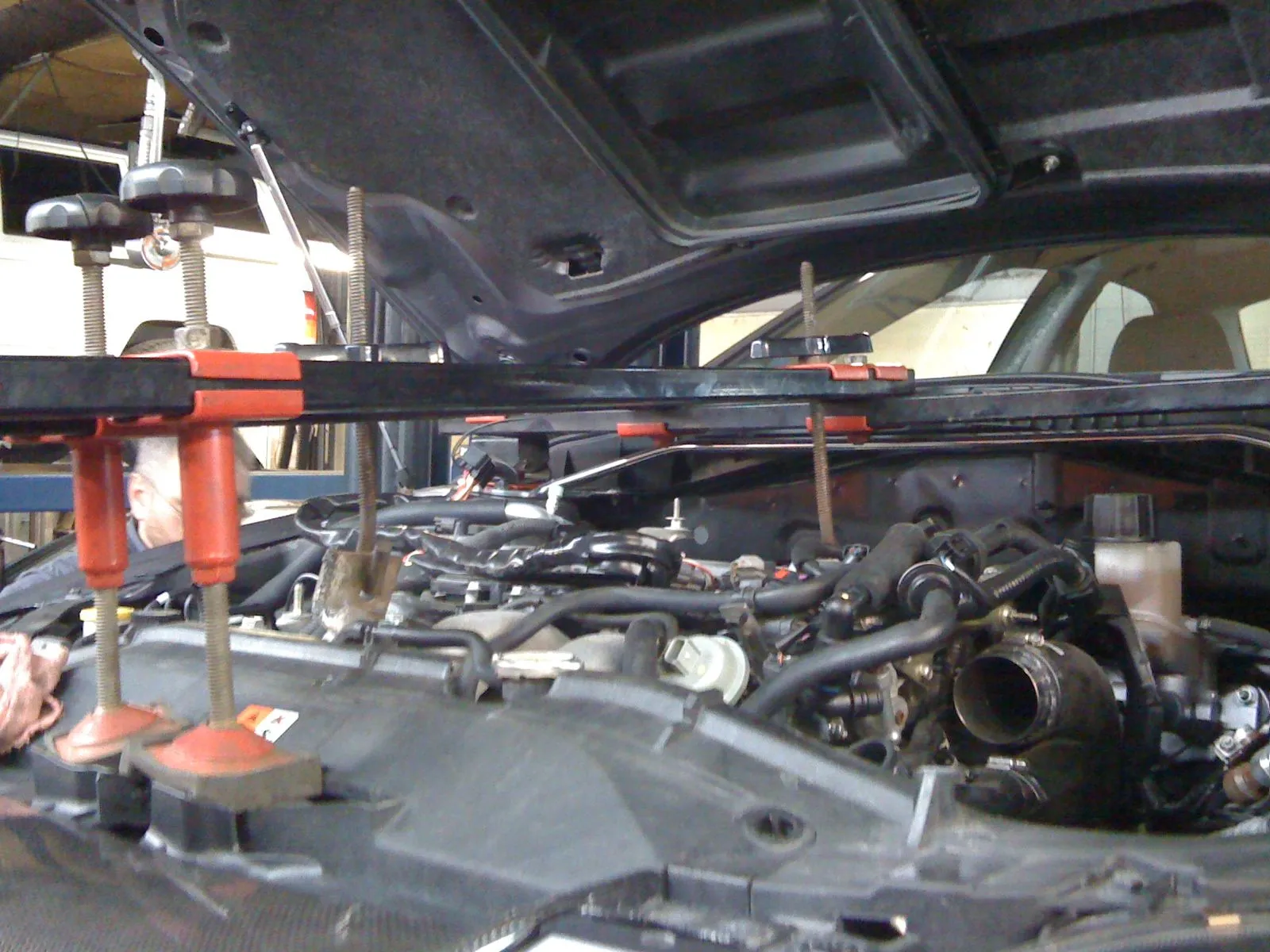

Clutch and flywheel are in. Difference is night and day. Here are the pictures. There are some steps missing... those are the steps where I'm trying not to beat the car with a pry bar. :) FYI, you cannot do this in your driveway or up on jackstands. I didn't have to loosen the turbo, but had to pull the entire subframe off. The transmission and PTO have to come all the way out (obviously) and the engine has to be suspended above the car. This is some serious work, so if you don't have access to a lift, have all the required air tools, and are not familiar with this type of work... DO NOT ATTEMPT.
With that said, it feels great to be rid of the stock clutch. Poor OEM clutch disk was destroyed and the pressure plate and flywheel both had hot spots on them.
6 Hours total install time.

You took out the center diff?? We got by without removing it.... Told ya it wasnt going to be fun/easy...
