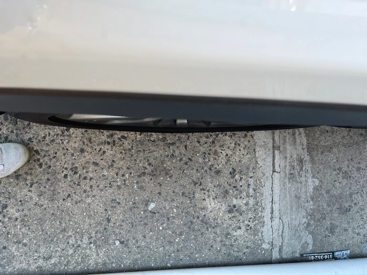

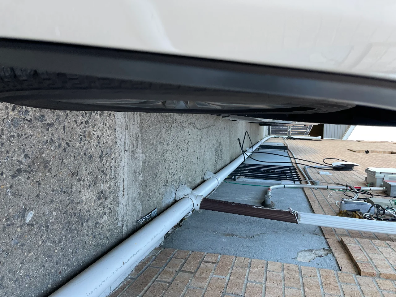

So update on the off-center steering issue. To recap, I had my front lower control arms and sway bar end links replaced with OEM Mazda parts that were verified with my VIN. I got my vehicle back yesterday and the technician said they’re unable to recreate the issue. Went on a road test with them and the issue is still there but they basically turned a blind eye and said, “nah, that’s normal.” I’ve attached videos of my concern, as well as the alignment sheet the Mazda technician gave me.
Lmk if I’m going crazy or if you guys see the problem too 😂😂
Hard to tell based on the videos... But often these things are felt and hard to see or recreate.
Good suggestions from experienced users you may want to consider.
It might ever so slightly to the right. However, you don't think that is because all roads are slightly banked to the right to allow for water to runoff to the sewer?
Nah, definitely not. Before I had the front lower control arms and sway bar links replaced, the steering wheel would be centered regardless of the lane I was in, or the road.
I’ve attached two photos and a video showing the front driver side tire and how it’s slightly turned to the left, even though my steering wheel is completely centered.
