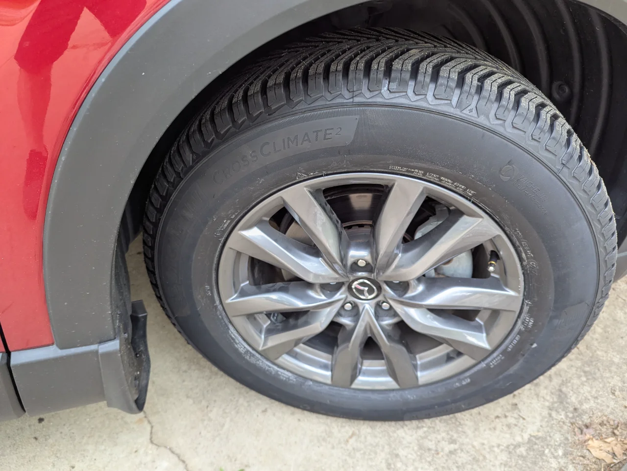

Fancy new shoes!
Michelin Cross Climate 2 from Discount Tire. They matched Sam's club prices and have road force balancers, so yeah went there instead.

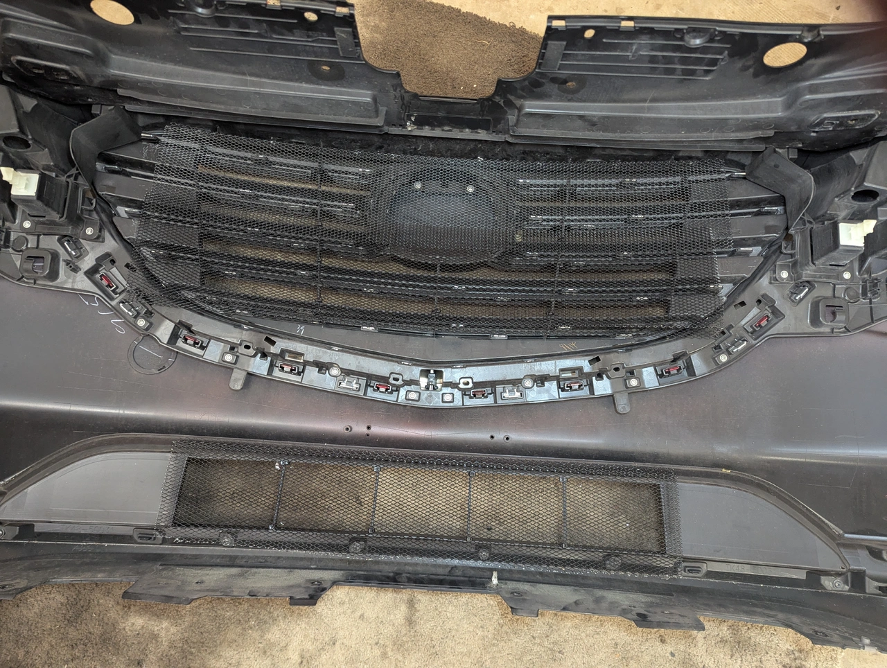

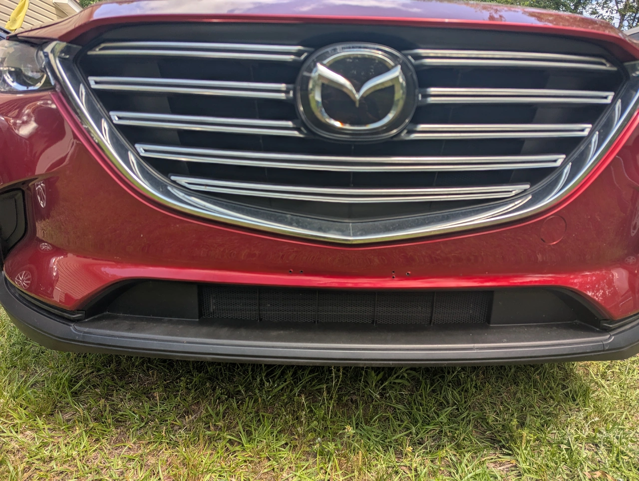

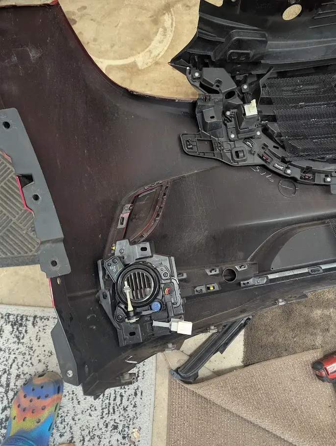

A little trick I learned from the Porsche community. Use some very inexpensive gutter guards from Home Depot, and secure them to the back of your grille with zip ties to keep the garbage out of your intercooler/condenser/radiator!
I also installed the OEM fog lights while I had it apart.

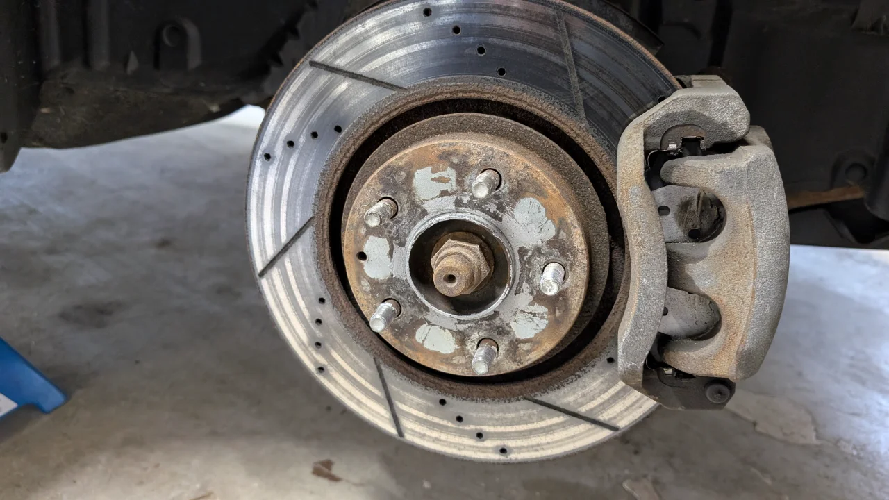

Yes it seems that the caliper isn't squeezing evenly. Or possibly that one pad is dragging because the piston is slow to retract/doesn't retract.
What's your brake fluid moisture content? If you haven't changed the brake fluid in a while, I wonder if that could be part of the issue. Corrosion in the line could cause a flow restriction to the "good" pad side, causing that imbalance. Caliper slide pins should also be relubricated as needed (I check them whenever I have to change pads).
Hey,
Just an update though it's been awhile as I was on vacay and using my 3G eclipse as the weather warmed up.

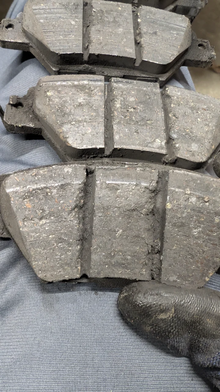

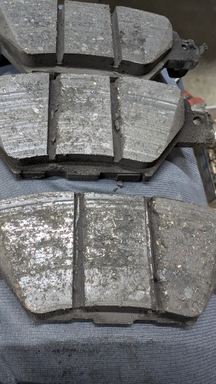

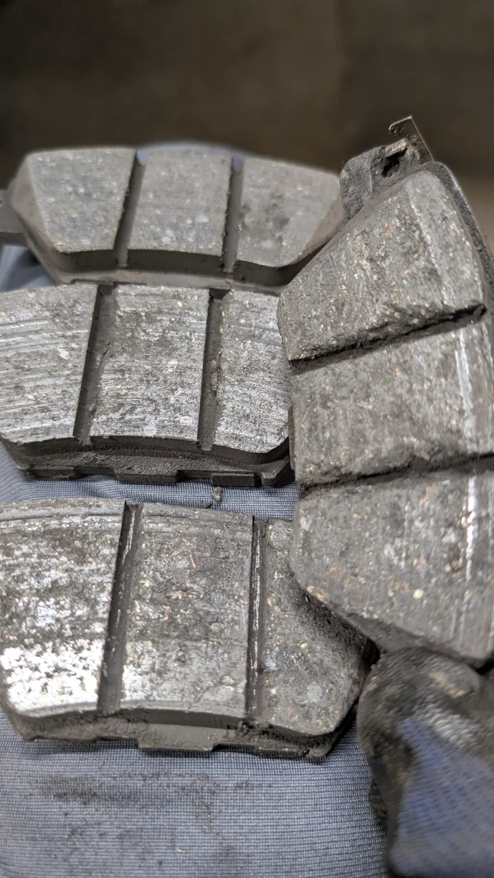

So Powerstop sent a new kit under warranty. (They stand behind their products!)
Before receiving the new kit, I bought new rear pads to buy me some time. (Ceramic pads OE+ brand from Canadian Tire)
Anyways, the pads on three of the four, lost big chunks (0E+). See the pictures.
Last time I'm buying those, though I've had good experiences with other OE+ products.

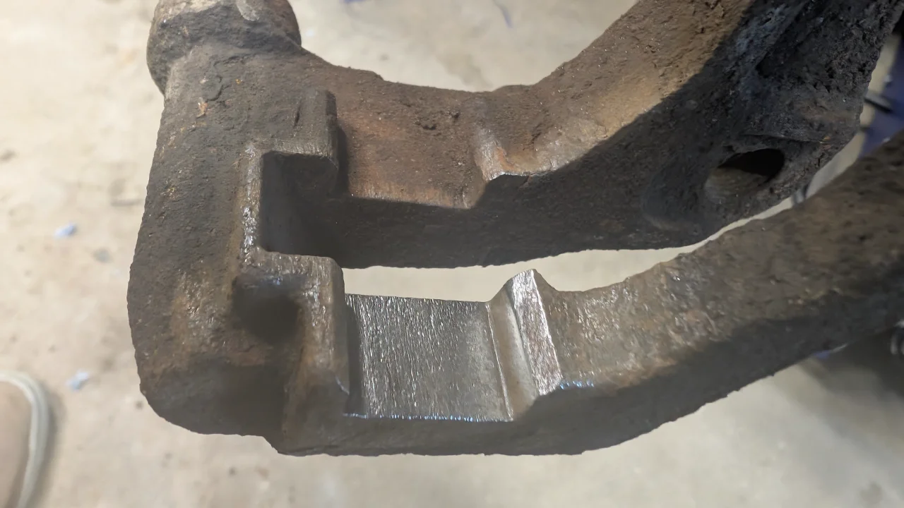

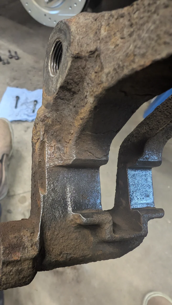

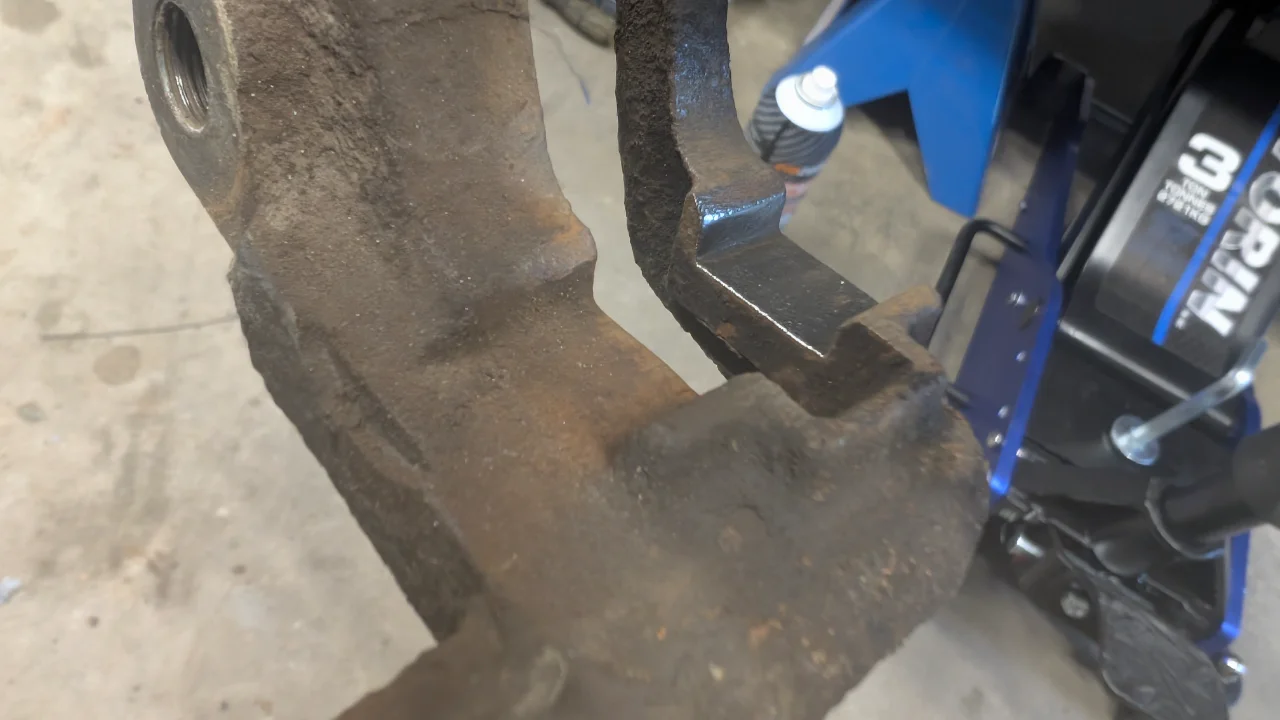

I resolved another issue. The guide pin boot was not seated correctly over the guide pin and it allowed moisture and debris in. This could be one of the reasons the pin was not sliding properly.
Also, I took my time with cleaning under the brake pad clips with a wire attachment to my drill.
I strongly recommend removing the entire housing holding the brake pads in order to fit the pads back in properly. The clips are tight and it's easy for the pads to go in seated improperly. Push in the side with the noise clip and push the top pad in at a slight angle while pressing against the back of the clip. It's much easier doing this on a bench or seated position than laying on the ground.
Take your time, walk away for a few mins with a cold beer when you need to.
Next time I'll definitely clean the rust off the brackets at the very least. Hell I may even do it the next time I get the rear wheels off.
Yikes, those pads don't look good. I'm sure they would have been fine with blank rotors though. I bet they weren't designed for use with drilled/slotted rotors.
I know that may be an extreme case, but even at 3000 miles I had enough buildup to justify my decision to switch to ceramics. Stopped the mess before it got too bad.
It's likely they weren't designed for the drilled and slotted. Still surprised by the breakdown and the additional dust.

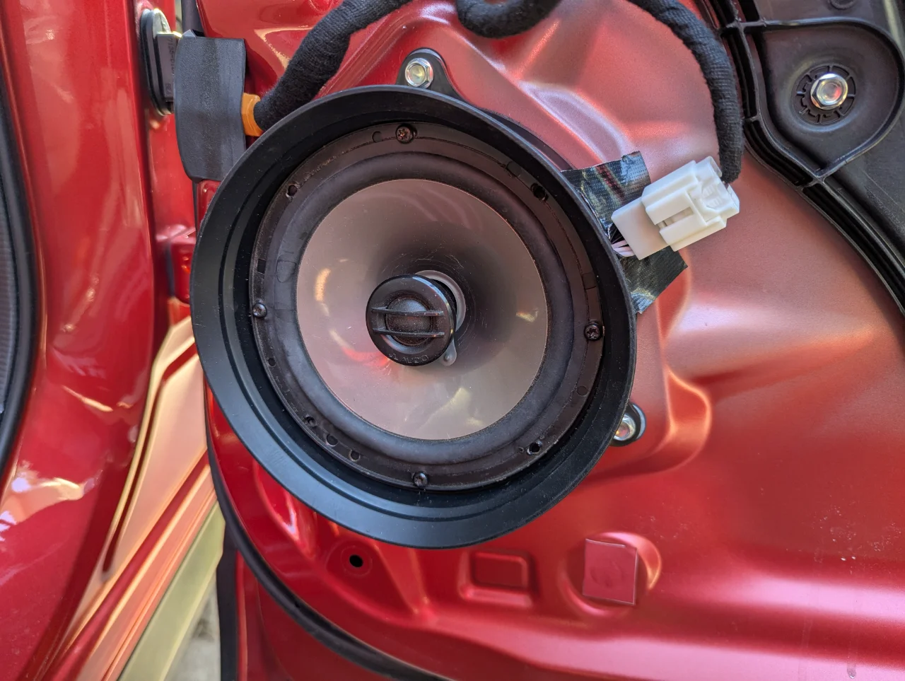

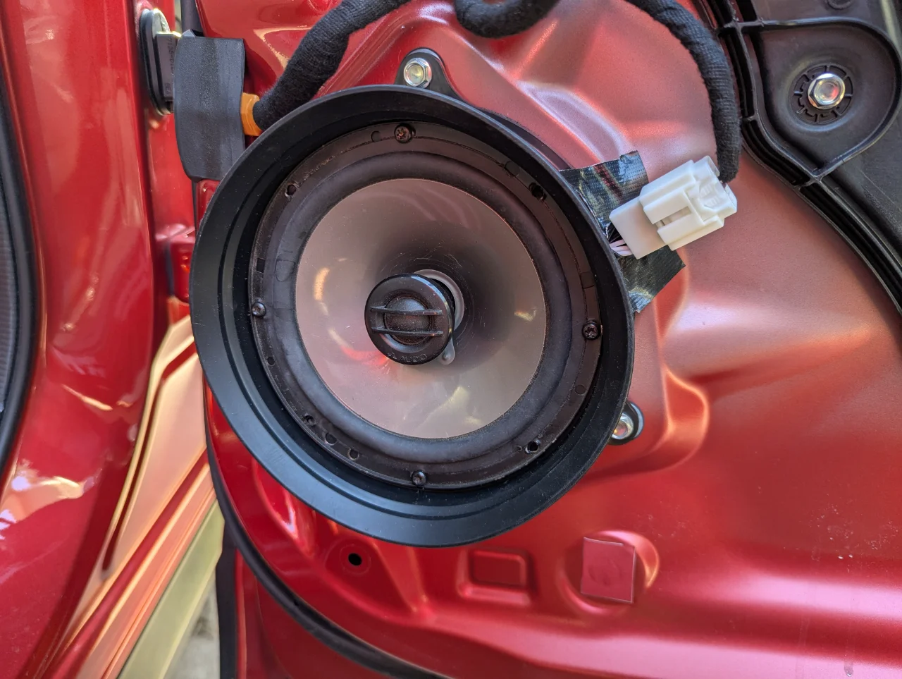

Installed some JL Audio C2-650x's in the rear doors today, along with some sound deadner inside of the door skin.
The stereo install is a slow but steady process. I'll do a full write-up when it's complete.

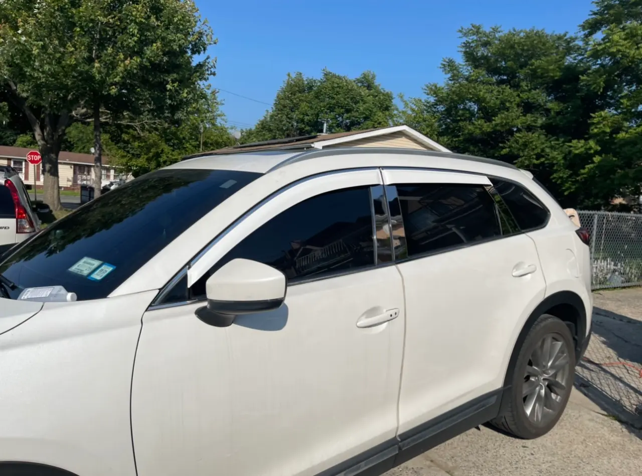

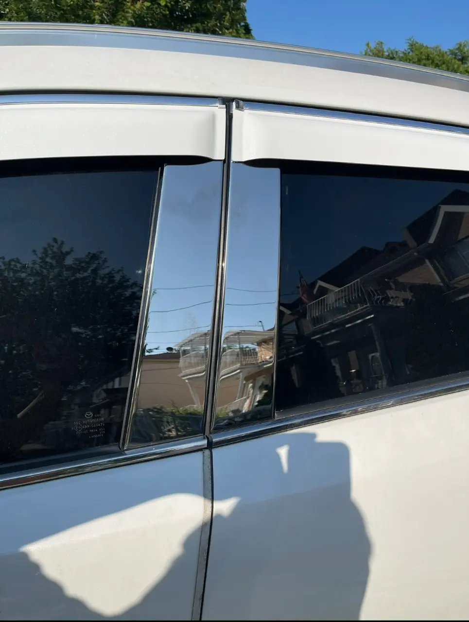

Hey everyone,
Today I installed color-match window visors. I had them painted snowflake white pearl. I also installed chrome pillar trims. I think it looks pretty good.
- Shawnee

Fancy new shoes!
Is there any difference in having the wheels balanced on road force balancing machines?
Gives a more accurate balance, because it replicates the forces of the car actually going down the road.
I mean, it doesn't cost anything extra, so why not?
That depends on the tire shop. When I got quotes to have new tires mounted for my Miata, a couple of shops included RFB at no extra charge but their M&B charges were extra whereas some shops charged as much as $43 per tire to RFB them. Their M&B charges were cheaper but by $10-15 per tire.
