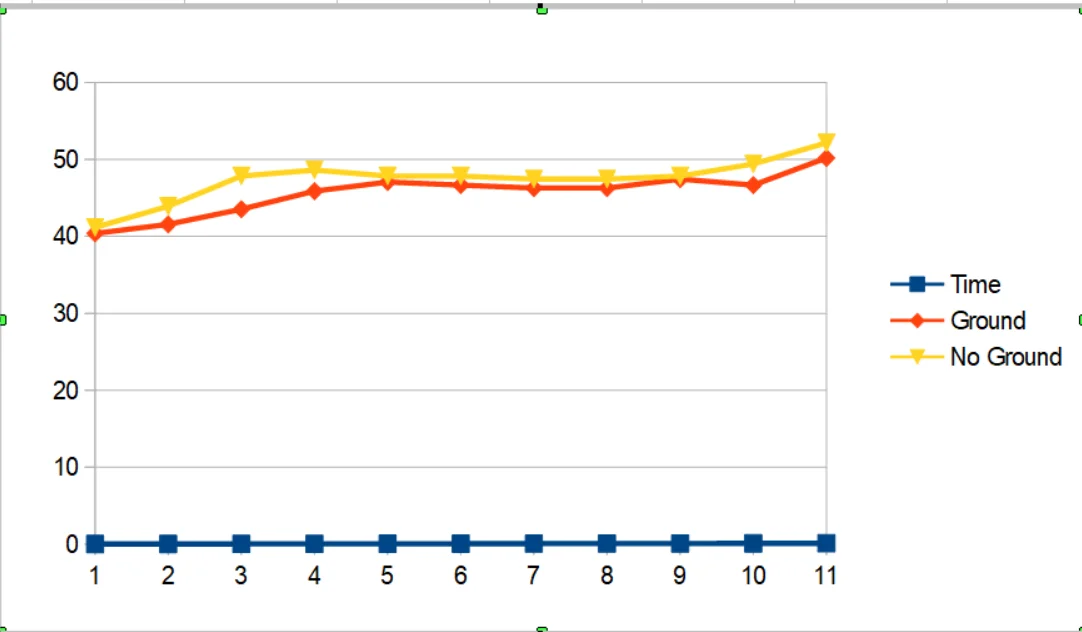

Here is the road test with and without grounds from Post 109.
Car was on CC, same speed, same road, same day. Tests done back to back. This road test combines a few steep grades and level stretches. This is 11 data points that easily lined up with each other. One could run a test for an hour and average the two and much more. I'm not inclined to make a research project for a modification I've done for over a hundred cars.
This graft is % engine load vs time. If the car will run with LESS engine load over the same course it is more efficient.
Going up the grades the grounded engine shined vs steady state on flat or down grades. Accelerating it does even better, per the WOT, dyno tests. The CX 5 seems to be difficult to chassis dyno so I'm not motivated to dyno test.
This in NOT a home run, break through mod. It's cheap and save gas year after year or delivers about 10 crankshaft HP. I put ground on our new 2024 the evening we brought it home to lower operating costs.
Yellow line, no grounds, red grounds.

Here is the road test with and without grounds from Post 129.
Yellow line, no grounds, red grounds.View attachment 383015
What is the vertical axis?

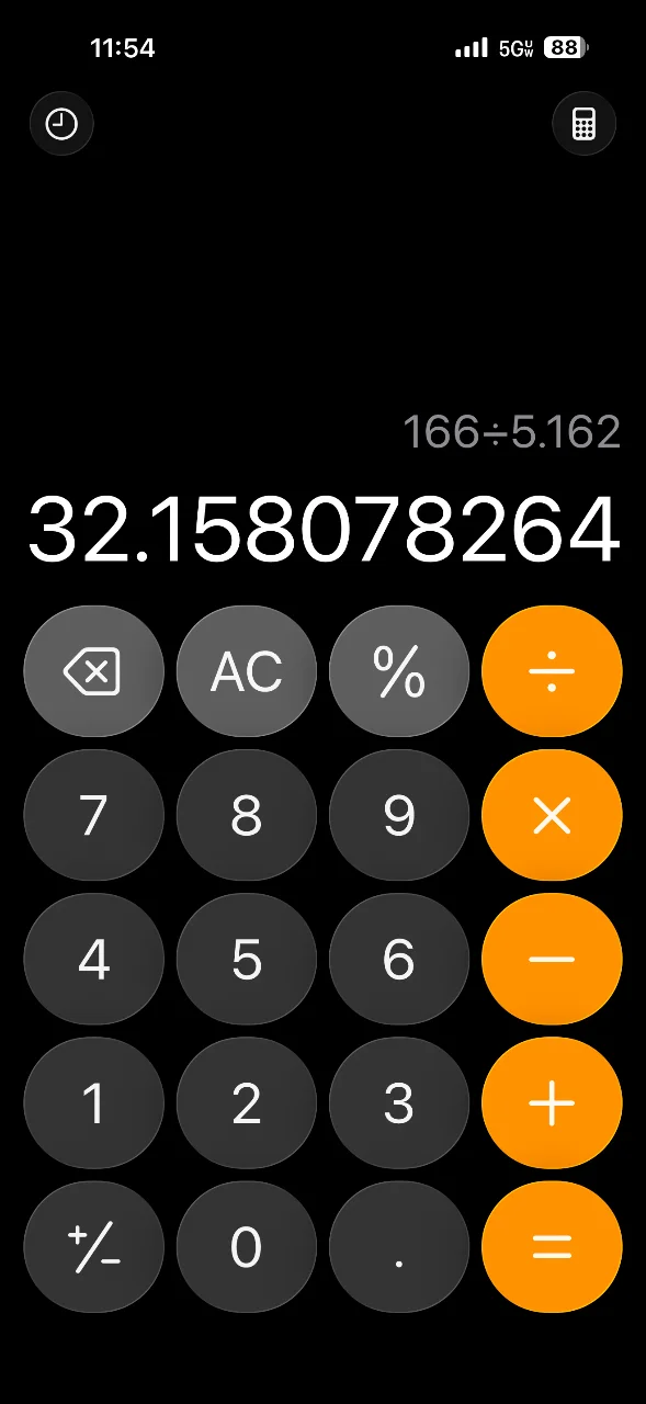

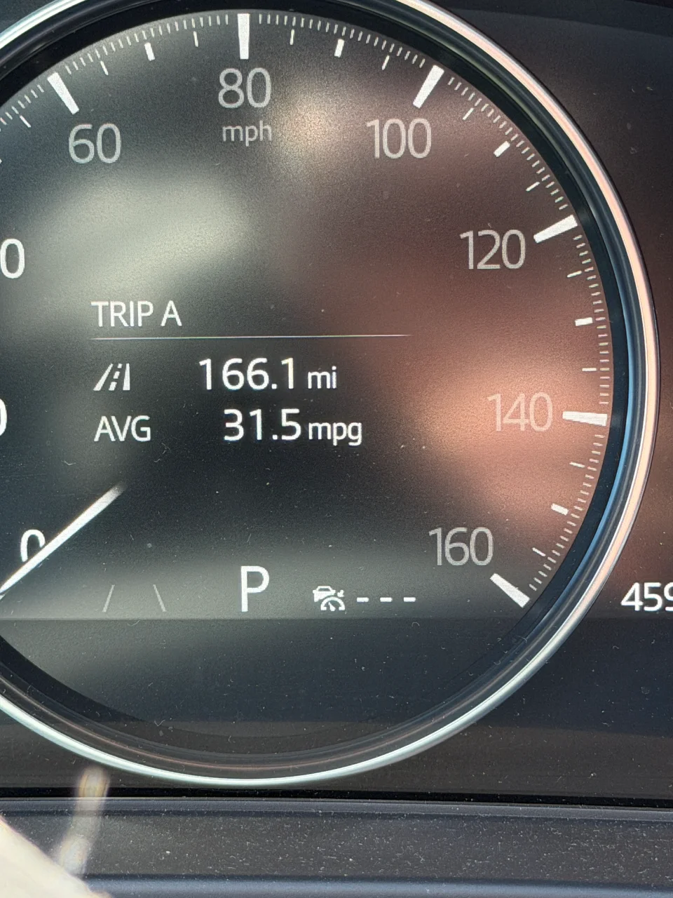

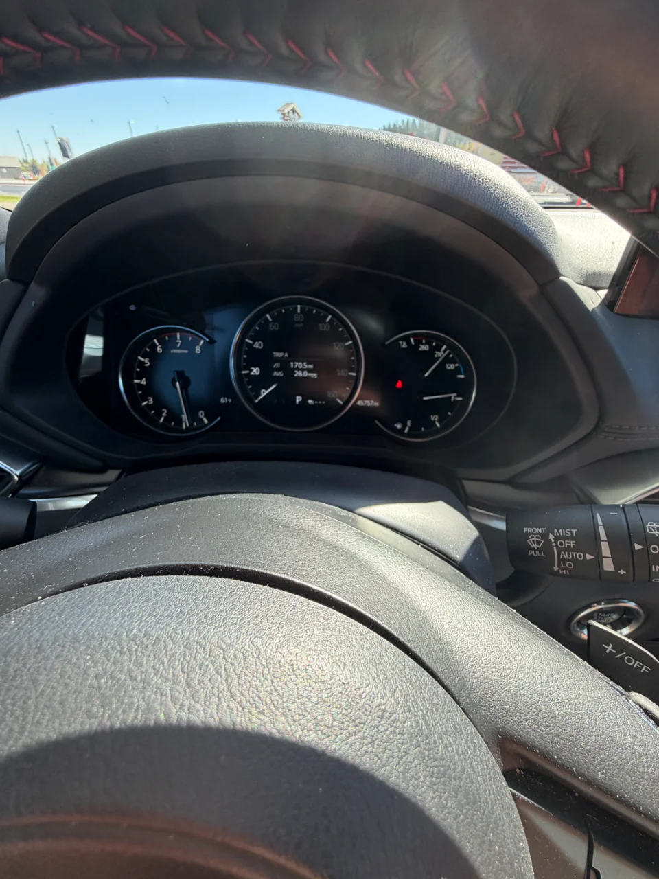

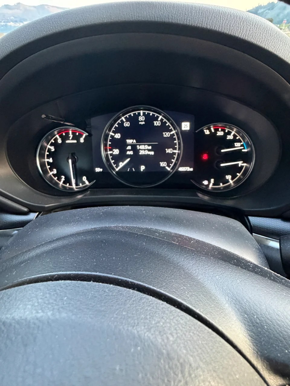

So the good news is mpg is no worse.. bad news is doesn’t seem any better. First fill up was driving in Montana including passes speeds 80mph and some faster. I have done this drive many times and it is what i normally get
This mostly Oregon again normal

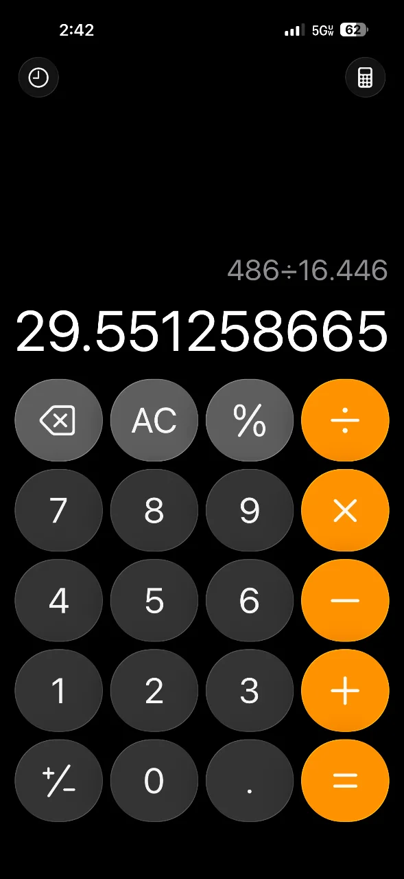

486 miles 16.5 gallons so yesterday didn’t see any improvement maybe over the next few days i will😂
That's pretty conclusive evidence you will not get better fuel mileage.

ok. I won't do the individual fillups but for 765.5 miles I filled 26.03 gallons over the next 3 fillups..one stretch was 80+ in the mountains so that impacted overall a bit..trust me I wanted this to work as who does not want better mpg. one fillup was at $5.79 a gallon so extra mpg would have been nice. one stretch did 366 miles and took 12.181 gallons..I don't see the reason to hook them back up for the return trip as seat of the pants is no difference and mpg is the same either way within margins of the pump. maybe I just got a good one as I have said since joining this forum I have always got great mpg from my turbo even better than the window sticker says. I hope it works for others and was well worth the $5 or so dollars and 5 minutes of my time just to satisfy my own curiosity.
