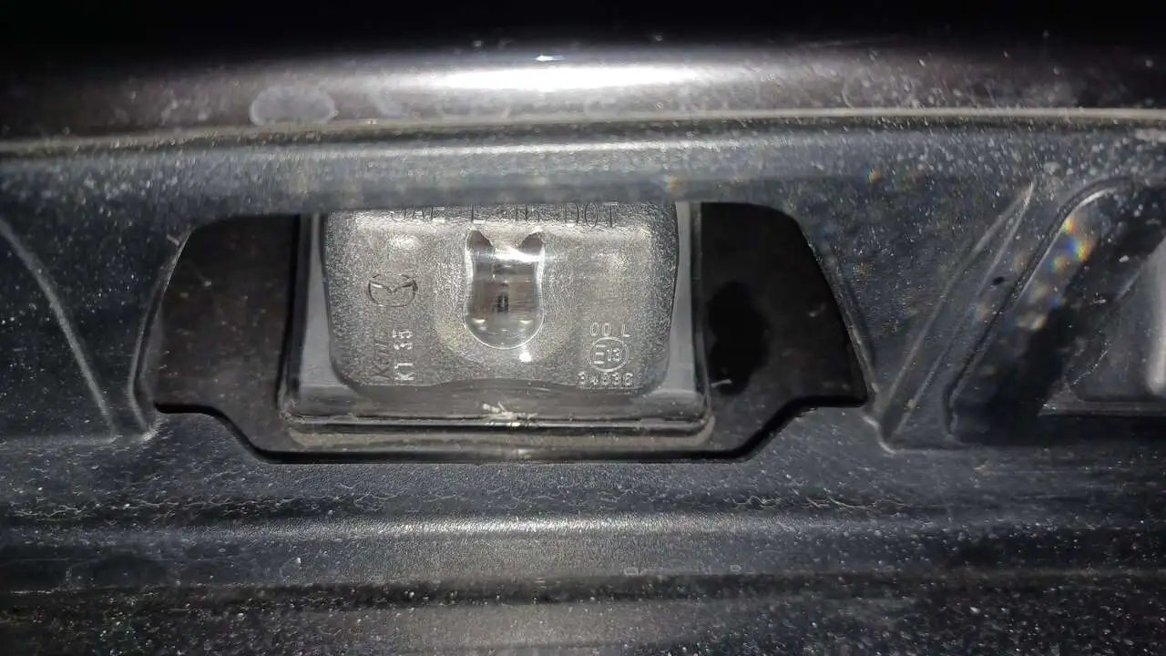

I have a small problem here. The plastic covers for the Number Plate lights do not have ears on the sides so you can pop them off with a flat-blade screwdriver, unlike the older Mazdas. I haven't been able to find a video on my model year that shows how to replace the bulbs with LEDs. There's a picture below.
Thread '2nd Generation CX-9: License plate bulb installation/upgrade' Guide - 2nd Generation CX-9: License plate bulb installation/upgrade
Here is a thread for 2nd gen

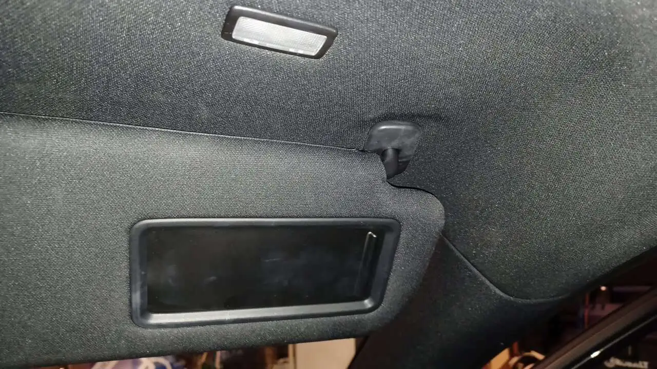

I must have had the wrong online web manual. My first clue was that "tire" was spelled "tyre". Anyway, the bulb types for some devices were different ("Already LED") and the License Plate (Number Plate) must be one of those. There are no pop-off tabs on the sides so I guess that means the dealer has to change these. I'm hoping that the vanity, overhead, and map lights can be switched. But the map lights have two settings (Normal/Brighter) if you press the panel button twice. I doubt the DE3175 bulbs have two intensity levels.

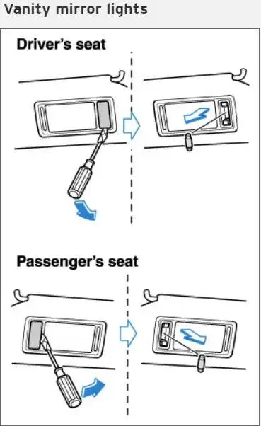

Overhead lights are finished. But now I ran into another problem. The vanity light is always shown in the manuals as a part of the "Slide open" mirror covers. On my 2021 CX9 GT, the lights for both vanity mirrors are on the roof above the mirror unit and not a part of it as the picture shows. Searches for a way to replace this bulb always show the light compartment as an integral part of the mirror device. And they also say it covers 2021 models.
