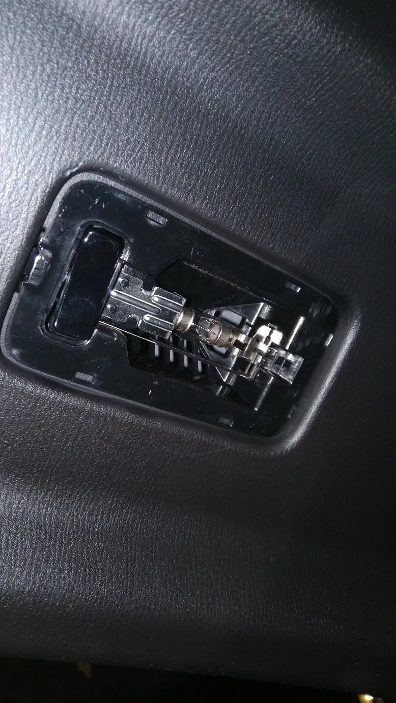

4. The bulb will be exposed. Remove it by pulling out the side closest to the switch first, then the other side. Again, be prepared to catch the bulb as it comes out.

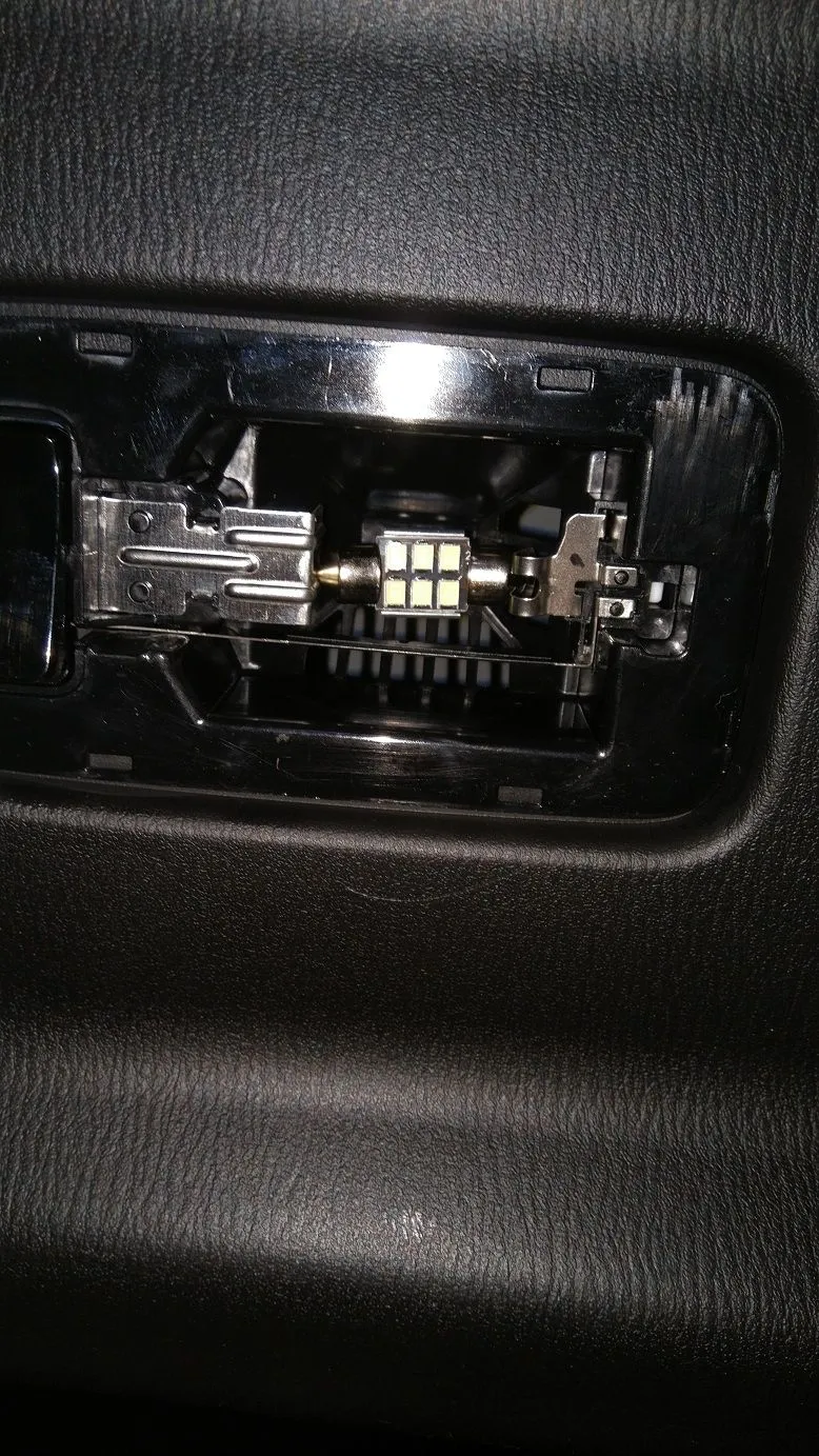

5. Install the new bulb. I took this opportunity to upgrade the halogen bulb to an LED bulb. Please do your research when buying an LED bulb to ensure that you get the right bulb and that you will not encounter errors from the change in voltage. Reinstalling the bulb was a little tricky. I found it easiest to insert the bulb on the far end of the switch first, as the metal tab it sits on has some flex. Then I slowly pushed the other side in. Note that you won't hear it clip in or anything. Also note that in the pic below, you can see that the bulb isn't installed correctly on the side closest to the switch. The pointy end should be resting in the depressed area. I need to go back and fix that.

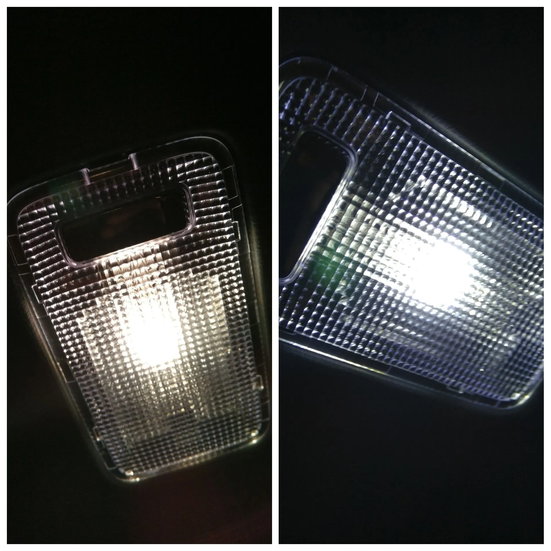

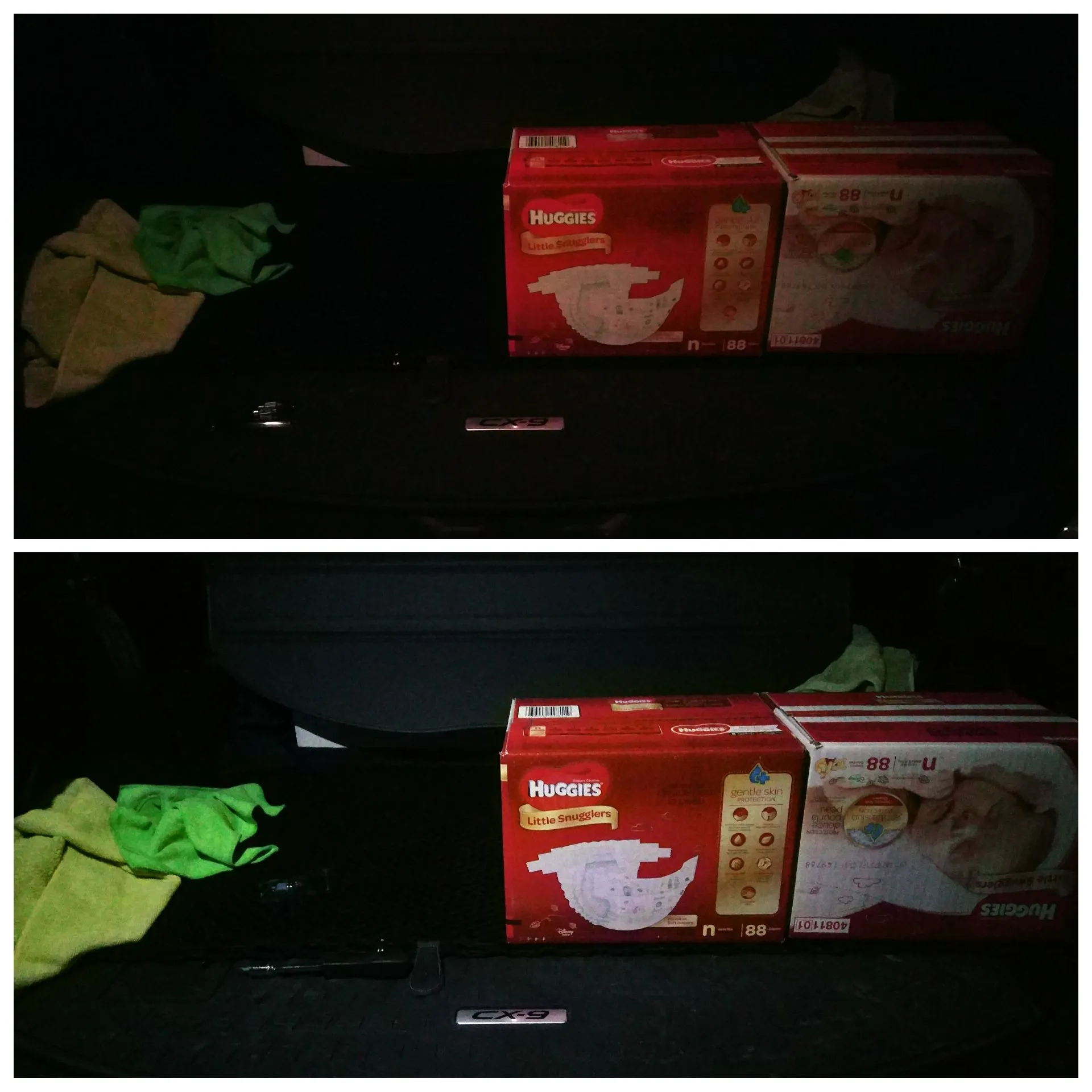

Here are a couple of comparison photos I took. As you can see, the LED bulb is much brighter than the OEM halogen bulb. Unfortunately, this doesn't solve the issue of the single light source of the cargo area being behind you. Oh well! At least it looks nice, haha.
