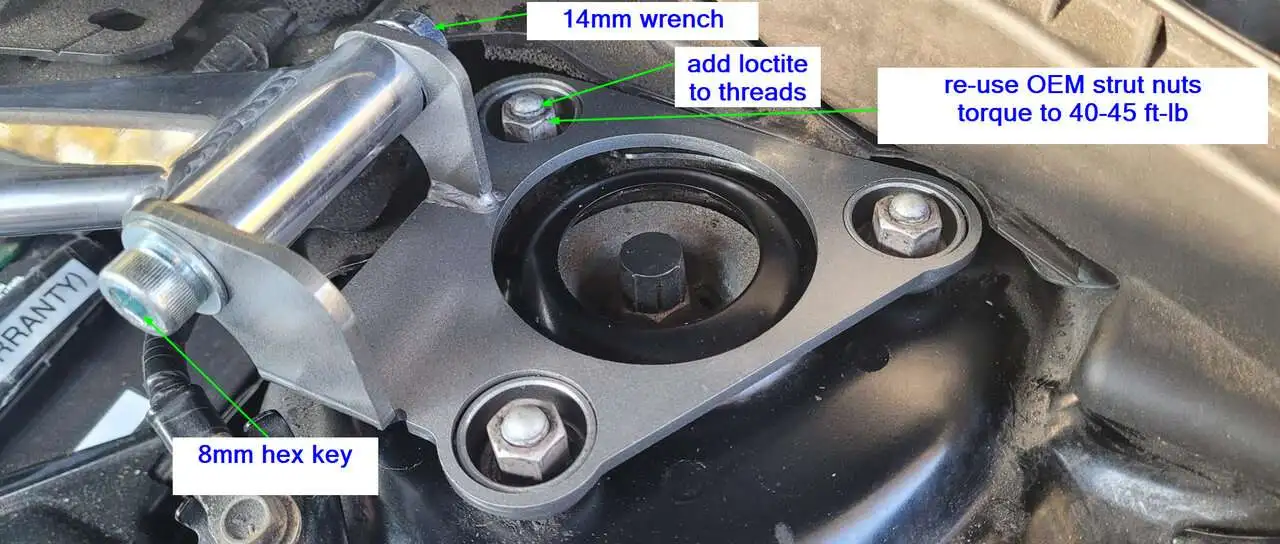

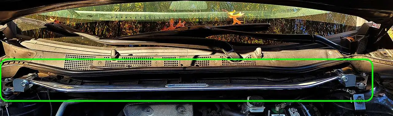

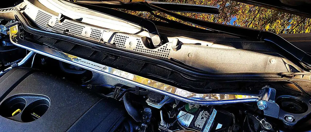

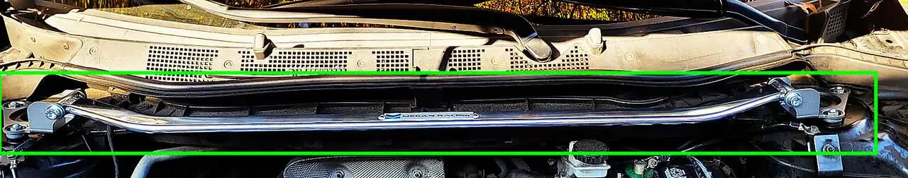

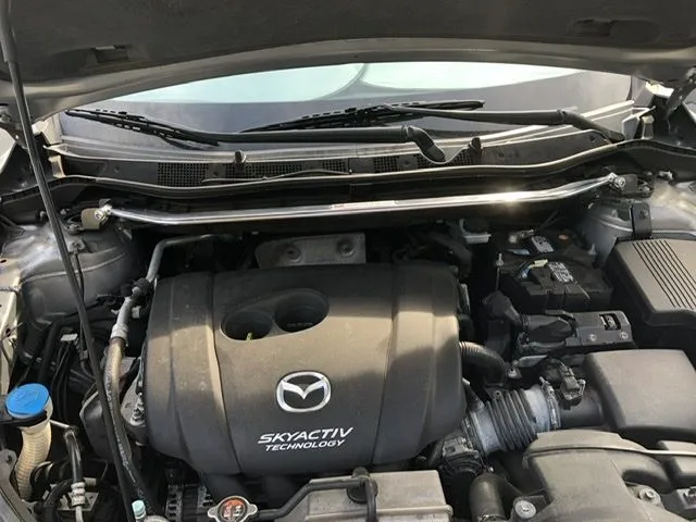

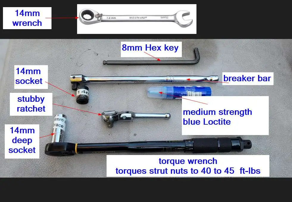

I installed a megan racing strut tower bar. took it for a short drive and i want to say that side to side transitions feel better, maybe a little bit of confirmation bias(?). a solid bar would have been preferable but this was cheap and in stock.
I installed this Megan Racing strut tower brace bar as well over the weekend and can confirm the front feels stiffer and more rigid and less body roll when going into turns above 40+mph, definitely improved handling up front, less dipping when going into turn...... super easy install... see pictures for tools needed.... strut is $94 on eBay. there is also a youtube video, Megan Racing strut bar install on 2016 Mazda CX-5 but the poster didn;t re-use the OEM nuts or use a torque wrench to tighten, I recommend re-suing the original OEM strut flange nuts and definitely use a torque wrench to tighten to spec...

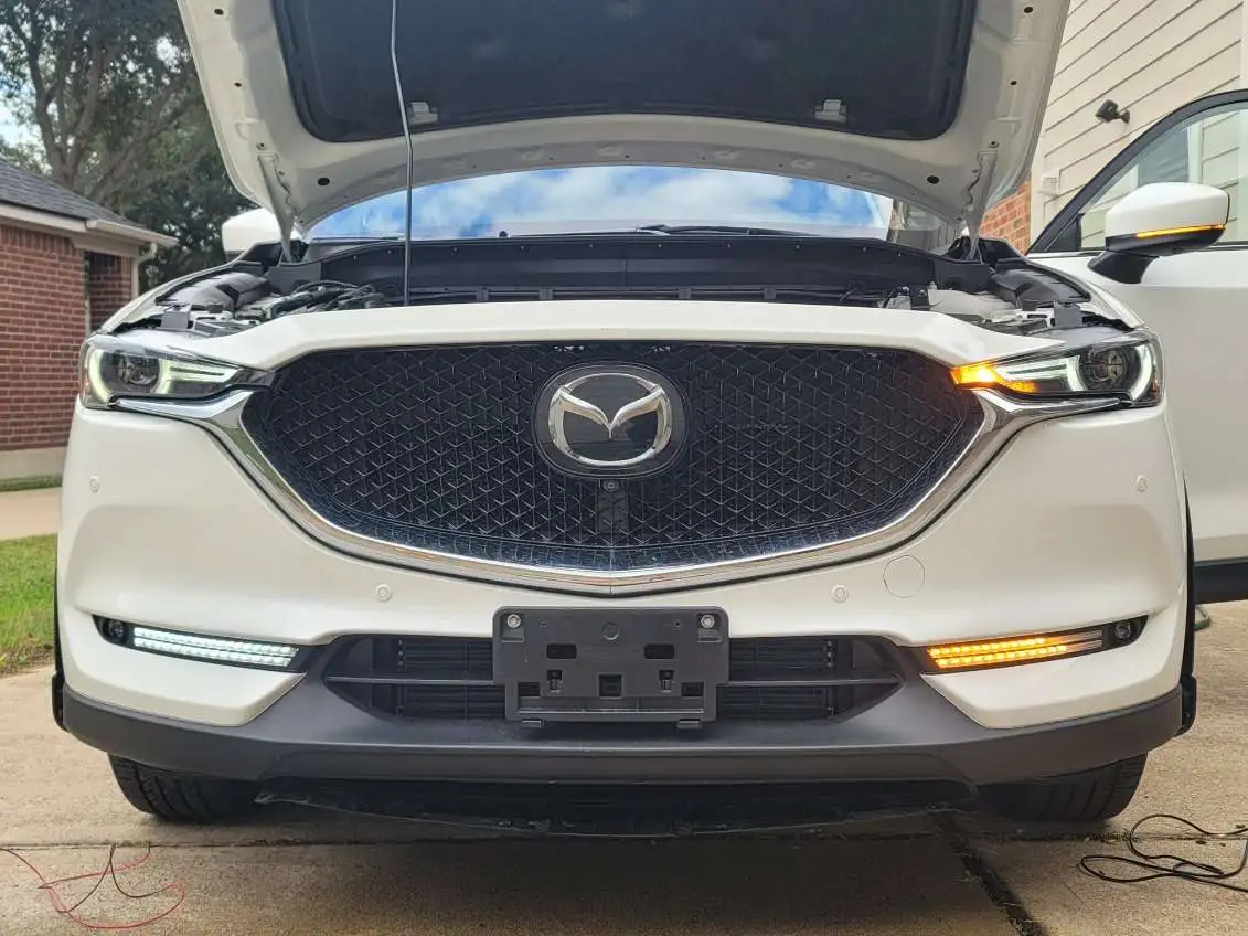

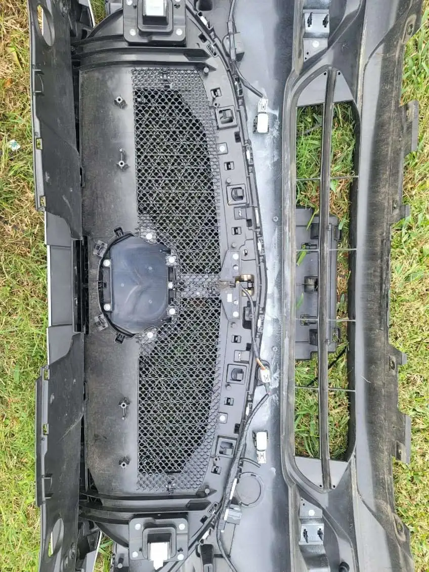

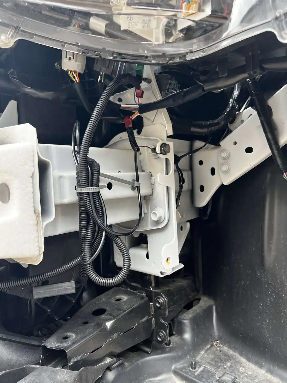

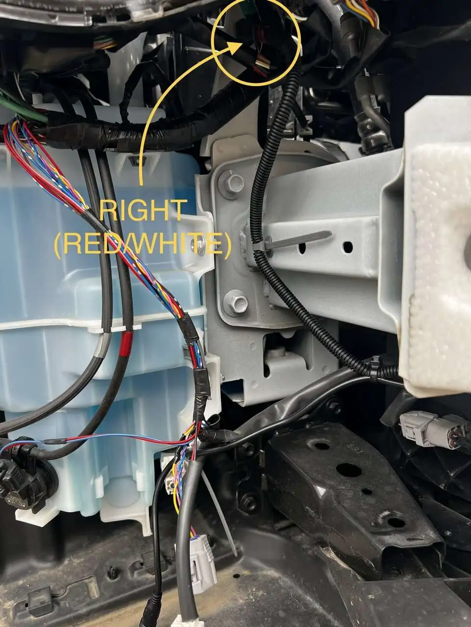

All done… taking out the bumper was not as bad as I thought.
Here’s a couple of pics of the work for those of you planning to do this.

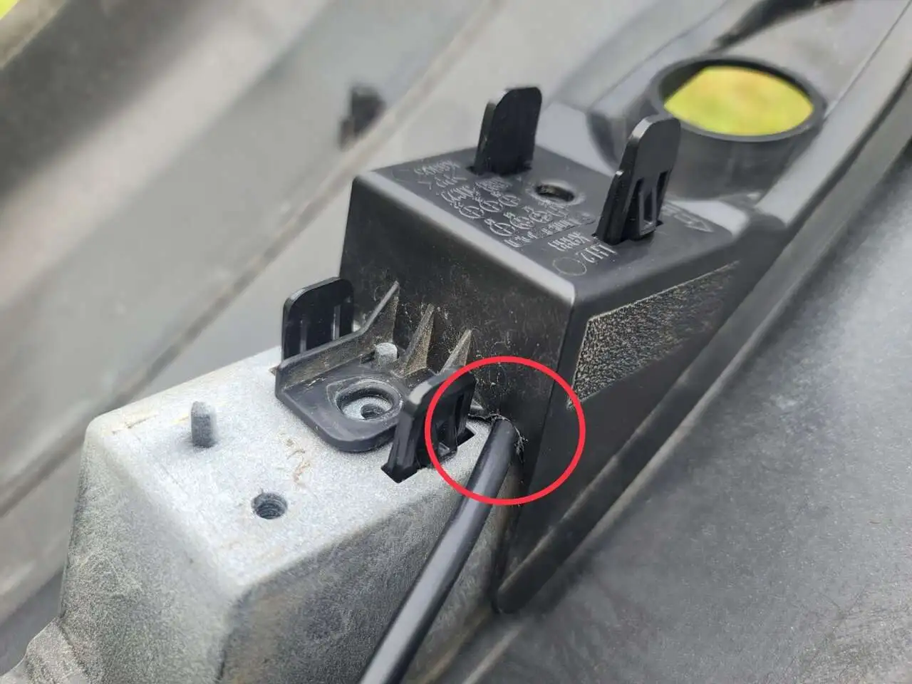

I notched a small opening here so the wire does not get pinched.

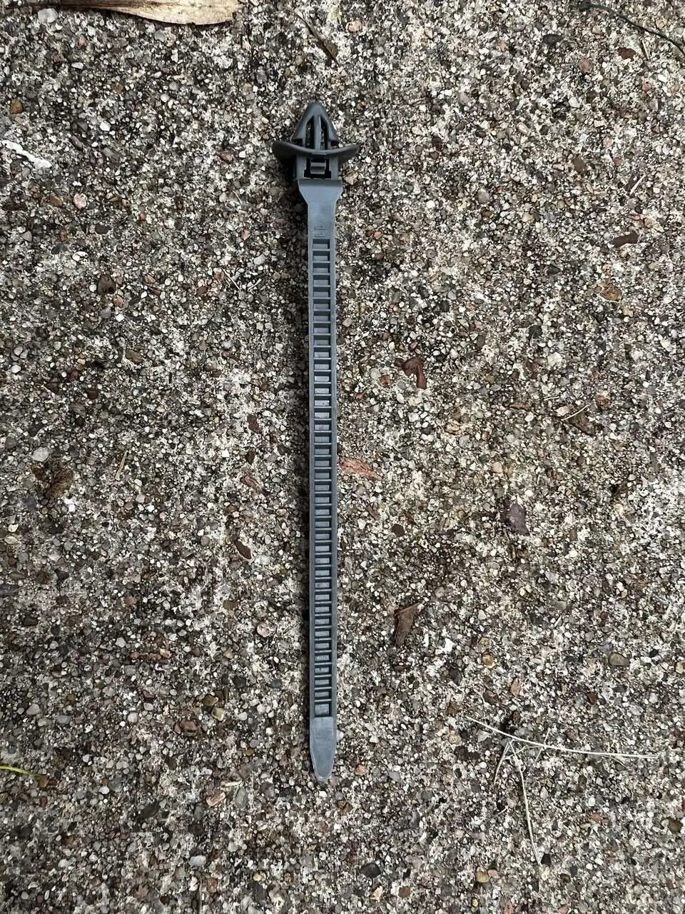

I typically use posi-taps but I didn’t have any laying around so instead is used these.
I have these laying around, got them from Amazon. It’s the best way of securing the wires.
Here’s a pic of it installed

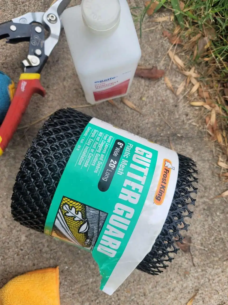

And since I had the bumper off, I installed this. It helps keep the bugs out in there.
Here’s a video of the startup (using the Linkr LTE)

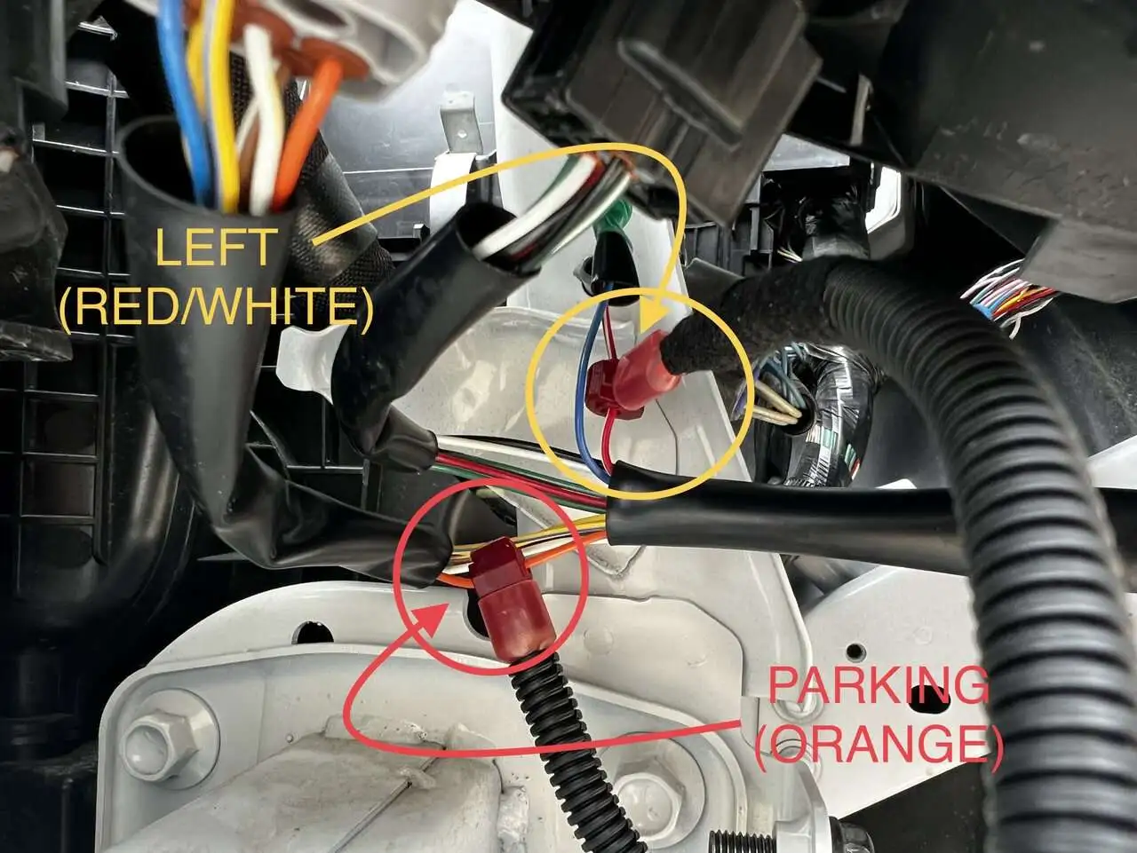

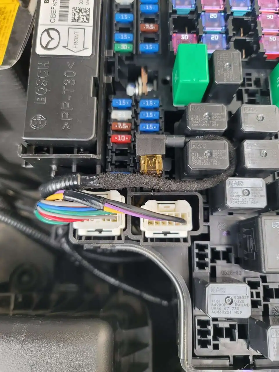

I love the light but wasn't a fan of the DRL portion not working during the day. Plus it was a little roo bright at night so I made a change and added a relay.
Orange wire (parking light) goes to 86 (relay). Then use a fuse tap on 23 (from the engine bay fuse box) to go to 30 (relay) then the positive of the DRL to 87A (relay). The DRL comes ON when the engine in running, then it turns OFF when the parking lights (Auto) comes ON. This does not affect the turn signal portion.
Updated...

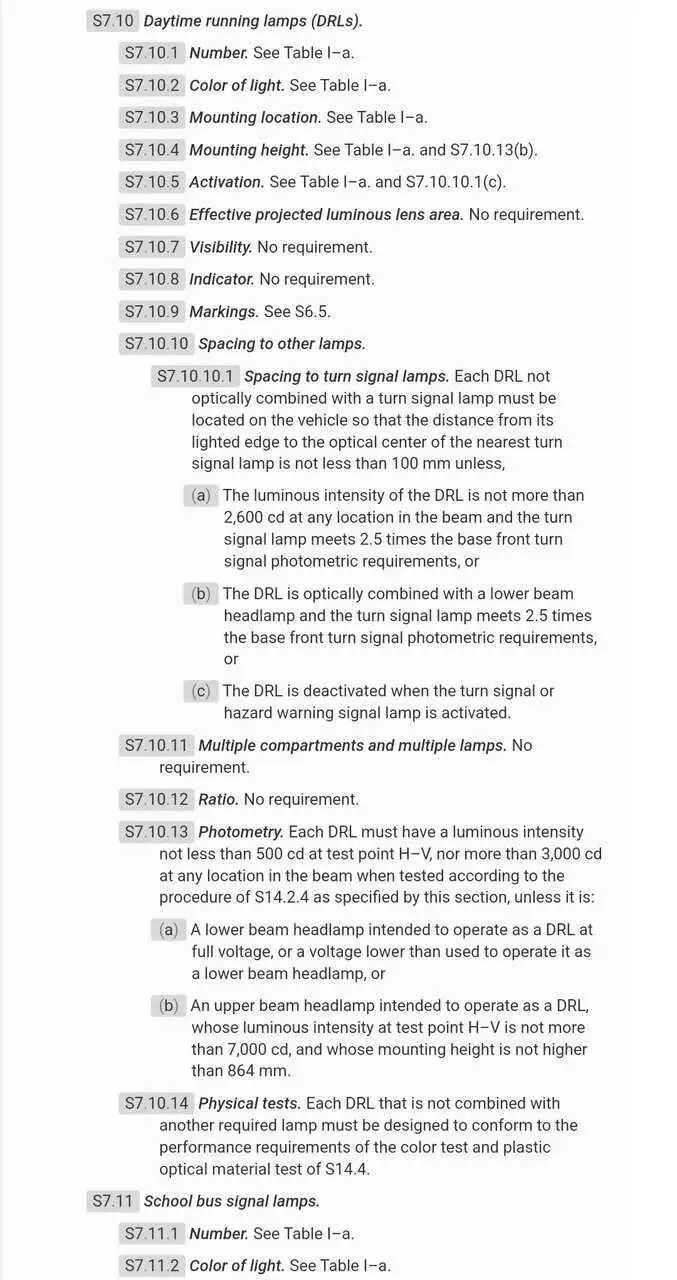

This is one of my main complaints with the KF CX-5. The fact that the DRL is the low-beam, regardless of which headlight assembly. I wonder if it's using a lower current in DRL mode?
My guess the reason for this DRL arrangement has to lie in the rules buried in the FMVSS 108
YES (I believe) on the dimmed low beam as DRL.
IMO these were too bright at night that you couldn't even tell when the fogs ON, beats the purpose of having the fogs (You can see it in the video I posted). Plus, didn't want to risk having too many lights ON at the front at night because some States DMV only allows a number of illuminated lighs.

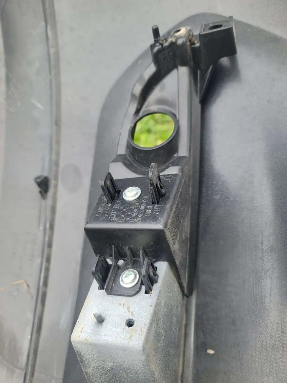

Swapped out the Corksport rear sway bar for the stocker. Never planned on doing that as it's a PITA requiring dropping the rear subframe, but the bushing brackets both broke (not at the same time) and I decided I didn't need the extra handling over not worrying about another breakage. Also did the brakes all around, went with coated Powerstop rotors with ceramic pads. Have to bed them in tomorrow, that's gonna be a pain as they ask for 30 cycles from 30-5 mph with 30 seconds in between applications.
Got the brakes bedded in, stopping is really good. Interested to see how the new caliper pin lube I'm using (CRC Silaramic) works at keeping things operating as they should and maintaining the performance.
Was looking at things since it appeared there was not much if any clearance between the sway bar end links and the subframe. Turns out I had them in backwards. I am used to installing them from the inside (nuts attaching on the outside) but on this vehicle Mazda has them with the nuts on the inside. Had a small amount of rubbing but a little Rustoleum took care of covering the evidence.
