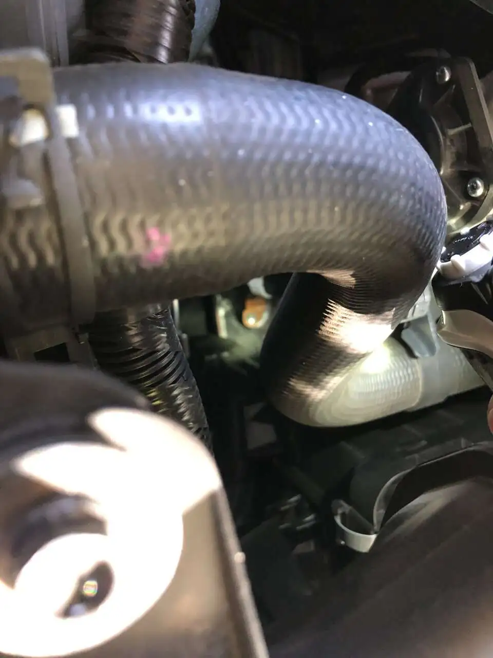

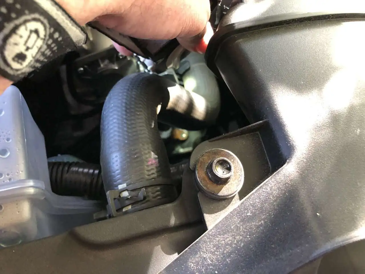

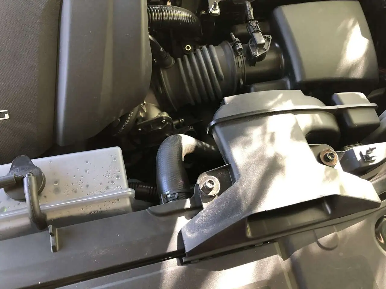

Well - different years different situation - 2019-2024 have a very short plastic dipstick which is extremely difficult to access - and if you are lefty - even better - but its below the airbox and attached with a 10mm bolt as well -- on Turbos -really difficult - anyhow - Some use OBD scanners to check it --some can get it from above . others from below after being hoisted ? thanks
All of them have that short dipstick. And yes it's below the airbox, which can be removed in 30 seconds by removing 2 10mm bolts, and then pulling the bottom of the box straight up and out of the way.
Historically checking the ATF requires the engine be at operating temp ( my old 3 says drive it then stop , idle check ) and at idle - so its a hand burner , if i pull the airbox off -will the rpm change - or are u getting an accurate read with the airbox off ?

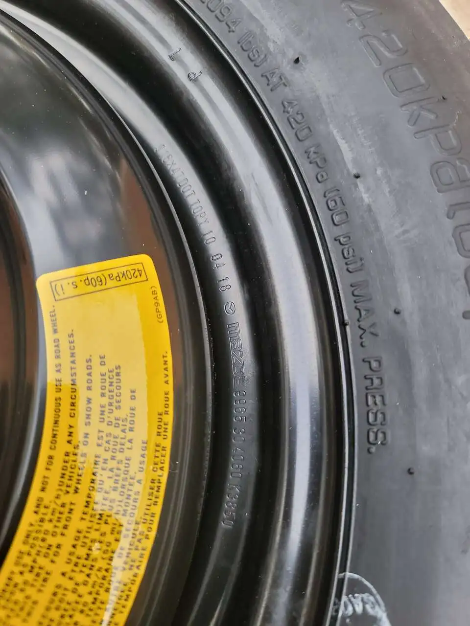

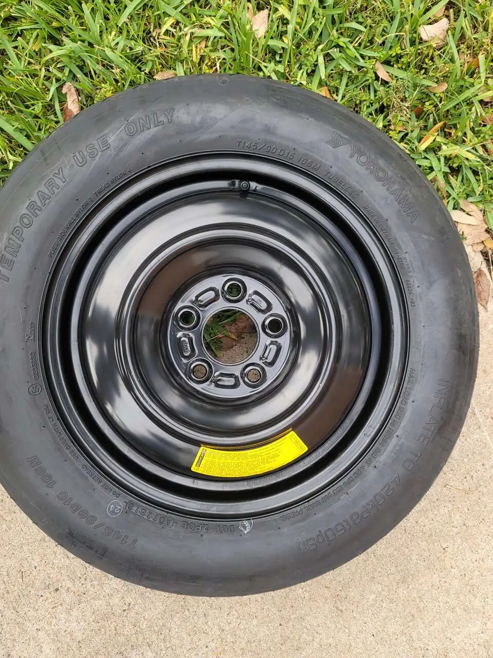

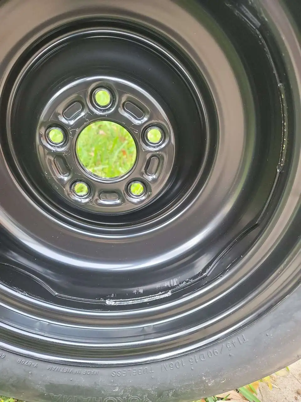

Question for the group.... I was going to rotate my tires and was going to use the spare temporarily as I do the crossover rotation. I just learned that my spare does not fit. It's hitting the caliper.
Attached are pics of the spare.....
If you have the 2.5T, your front brakes are bigger. If you have a flat in the front, you'll need to replace the rear with the spare and move the rear to the front.
You'll need to cross rotate the rear with the temp first.
