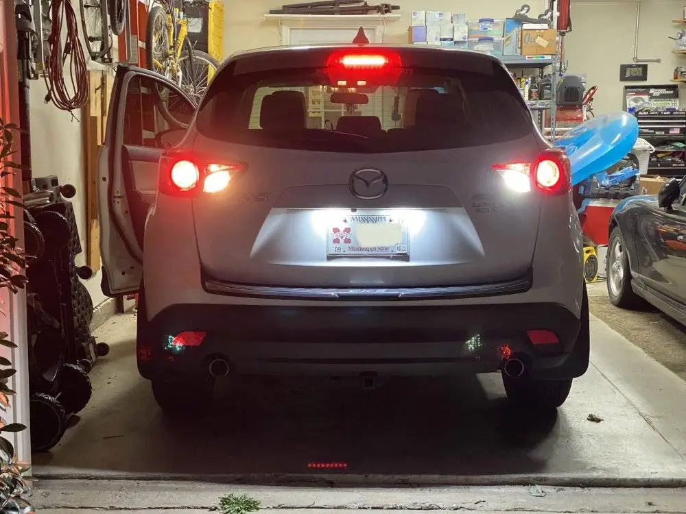

Swapped out all rear bulbs for LED. I had already previously changed the license plate lights and turn signals. Now I did all the brake, tail and reverse lights. Now all 3 of our cars are fully LED except for the head and fog lights.
photo shows the old bulbs on the left side, new ones on the right.

did you use a kit? do you mind sharing? thanks

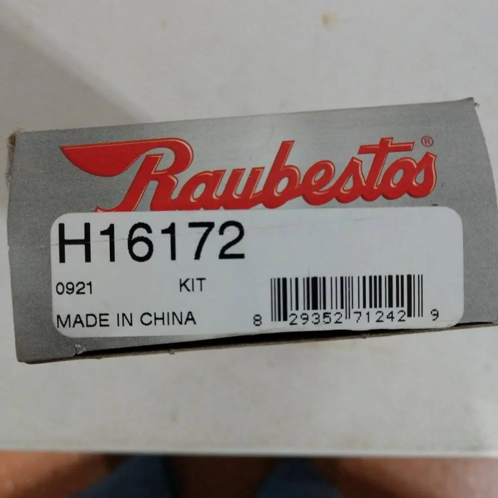

Was still having some brake pulsing so figured those sliding pin bushings were too swelled. Asked the dealer if the rear caliper sliding pins were available but you can only get them with the brackets. Looked on Rock Auto and found you can get a brake rubber kit with those pieces and the sliding pin boots in it. I bought this one:
Pulled the rear pins out and replaced the bushings. They were very tight to remove so I am fairly confident that was the issue. We'll see if that corrects the pulsing once and for all, if not then I'll also replace the fronts (those seemed to move more freely).
No kit, I just went to superbrightleds.com and ordered the bulbs that fit the car.
2x (red) 7440/7443 CK LED Bulb - Dual Function 27 SMD Tower - Wedge Base | Super Bright LEDs
2x (white) 921 LED Landscape Light Bulb w/ Focusing Lens - 10 SMD LED Tower - Miniature Wedge Retrofit - 350 Lumens | Super Bright LEDs
4x (red) 194 CAN Bus LED Bulb - 5 SMD LED Tower - Miniature Wedge Base | Super Bright LEDs
I already previously did the turn signals, which are LASFIT 1157 front and 7440 rear amber LED bulbs with integrated resistors.

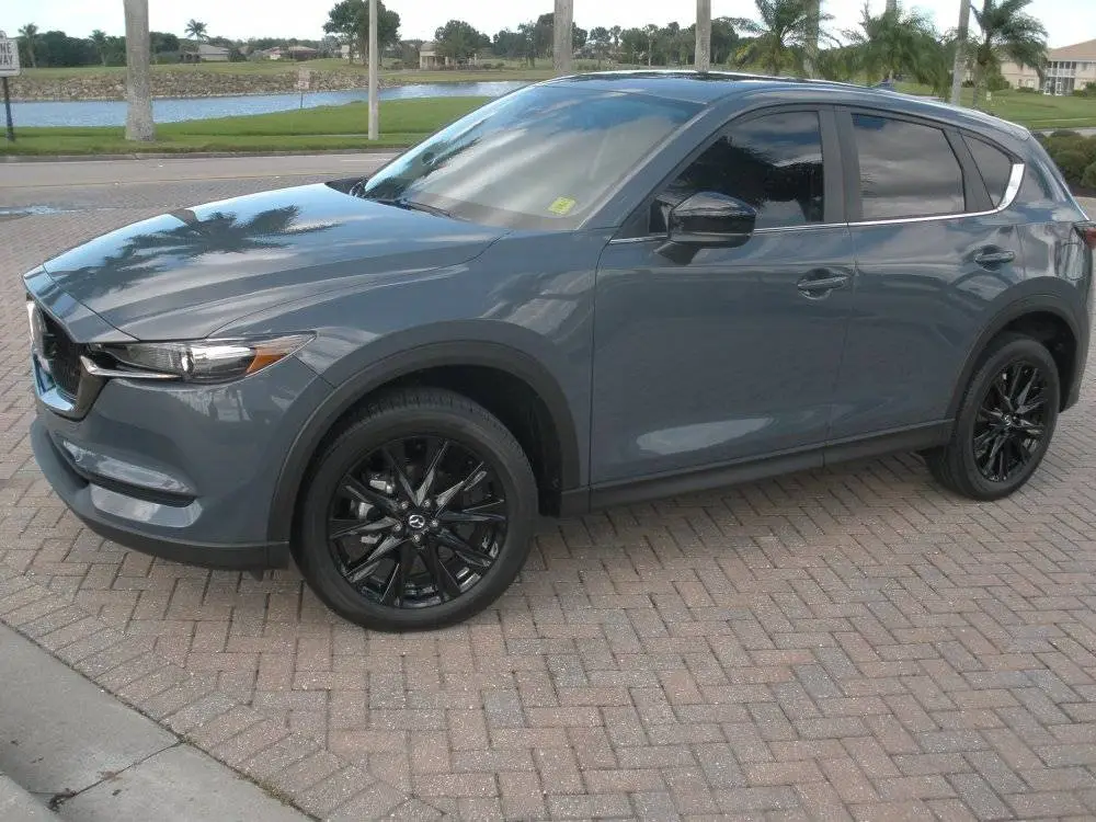

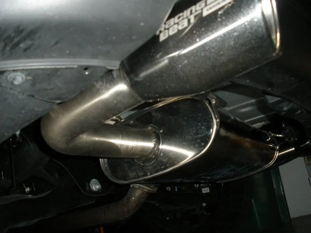

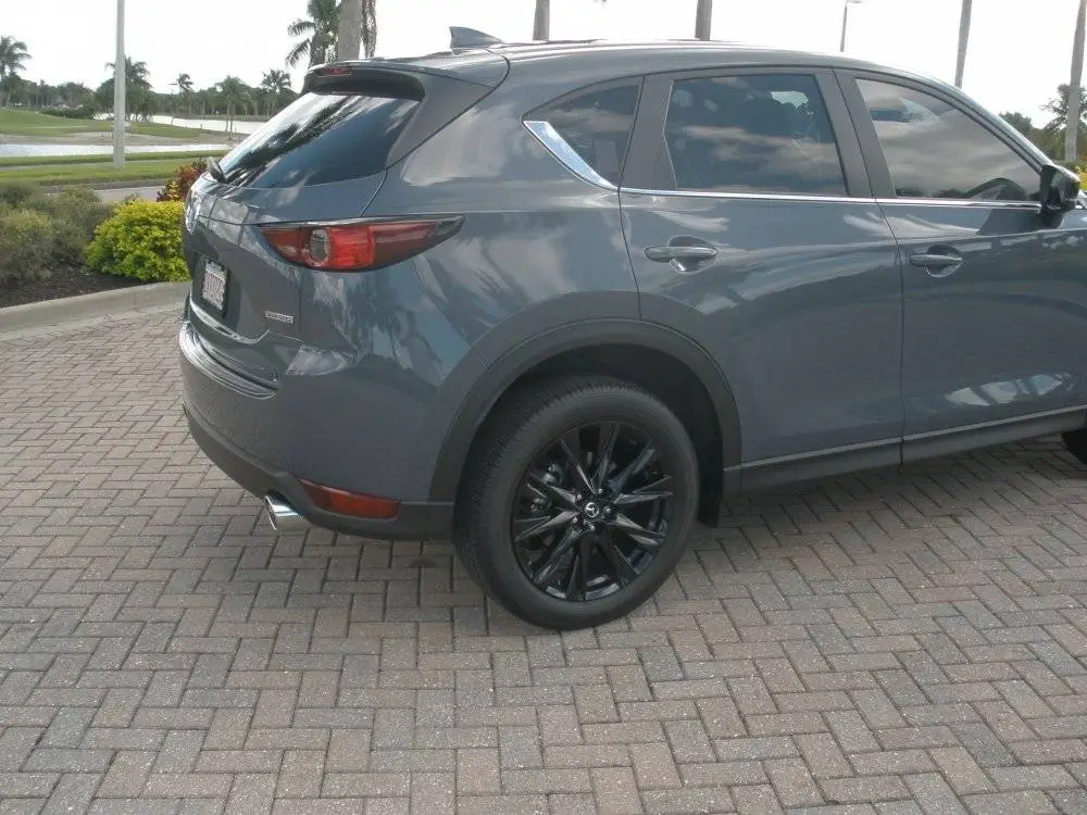

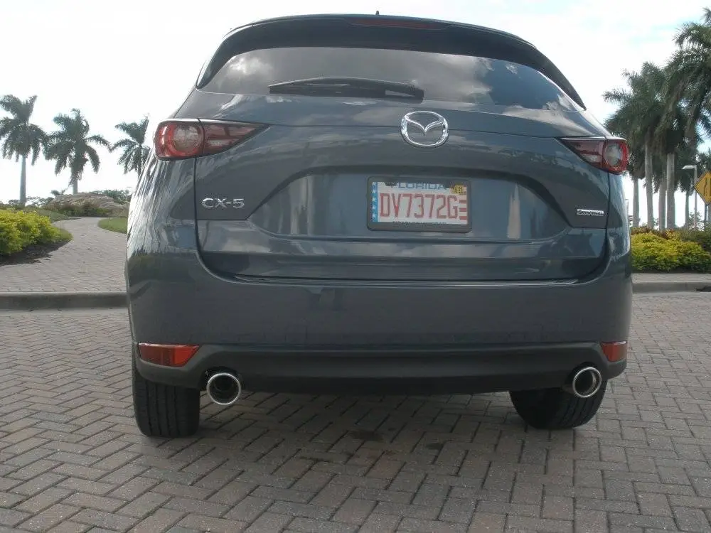

Recently replaced stock exhaust with a "Racing Beat Power Pulse" axel back exhaust.
Really like it. Nice sporting tone, no obnoxious, buzzing, droning noise.
4" Tips fill out bumper cut outs nicelyView attachment 304361View attachment 304359View attachment 304363View attachment 304362View attachment 304363View attachment 304359View attachment 304361View attachment 304362View attachment 304363
Looks good, can you post a sound clip so we can hear what it sounds like?
Update - Never mind, found a clip on their web site, sounds nice. Have to go listen to my stock one.

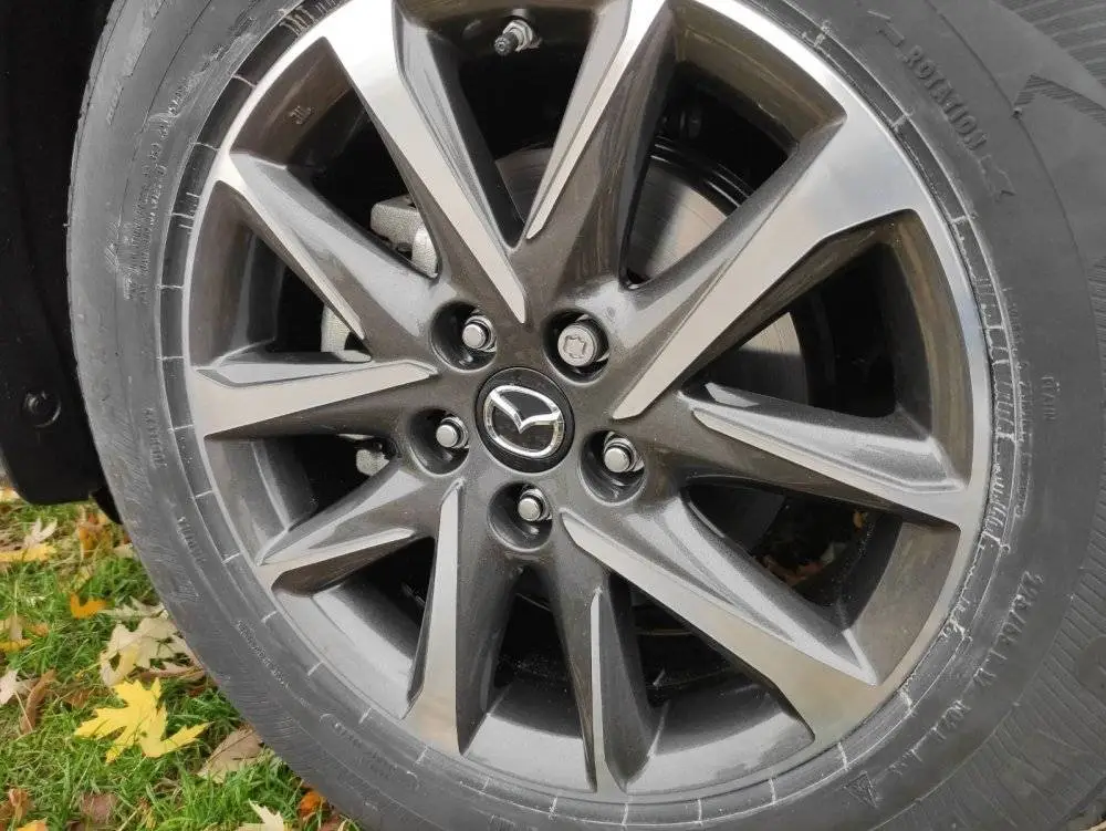

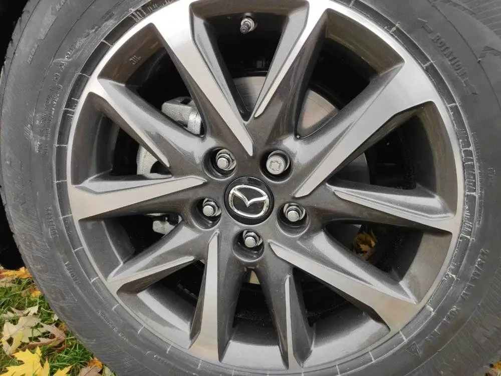

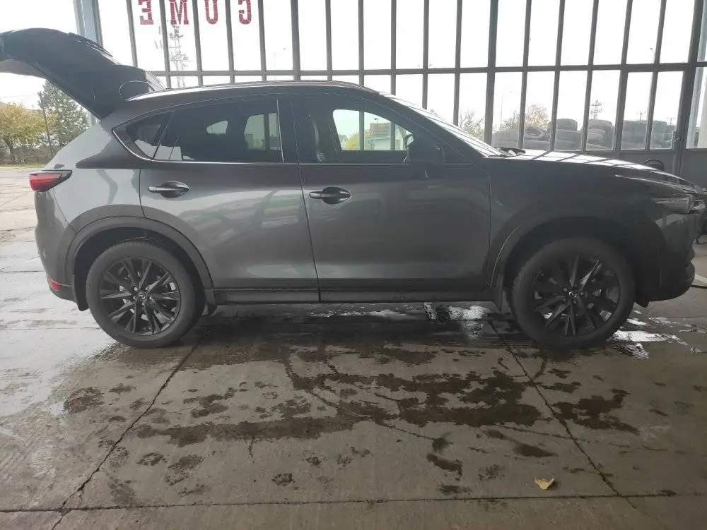

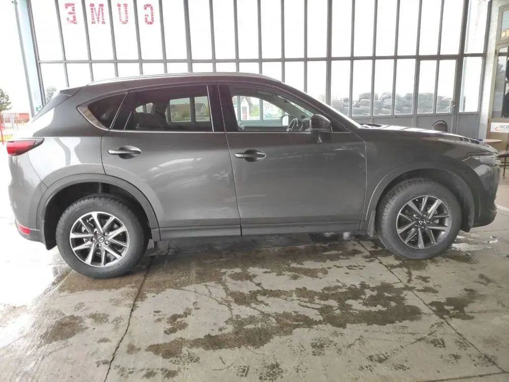

Changed wheels from black 19" summer Toyo to winter 17" Platinum . Car is much softer with 225-65-17
