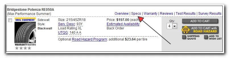

Check out tirerack.com, they have specs for all the tires they sell (or most of them at least).
Here's the specs for the stock tires on the MS3s.
The columns: Meas. Rim Width and Rim Width Range tell you what size wheels the tires will work with.
From what I've seen (from experts like fourthmeal) it's probably not a good idea to push the wheel/tire combo to the limits of the manufacturers' specs.
So, even though the stock 215/45 18s could probably be forced onto a 6.5" rim it's not wise.
