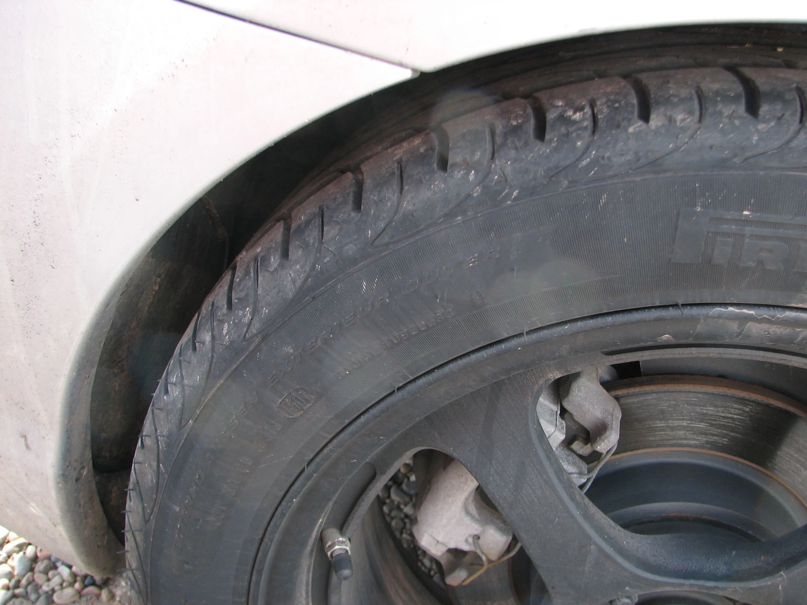

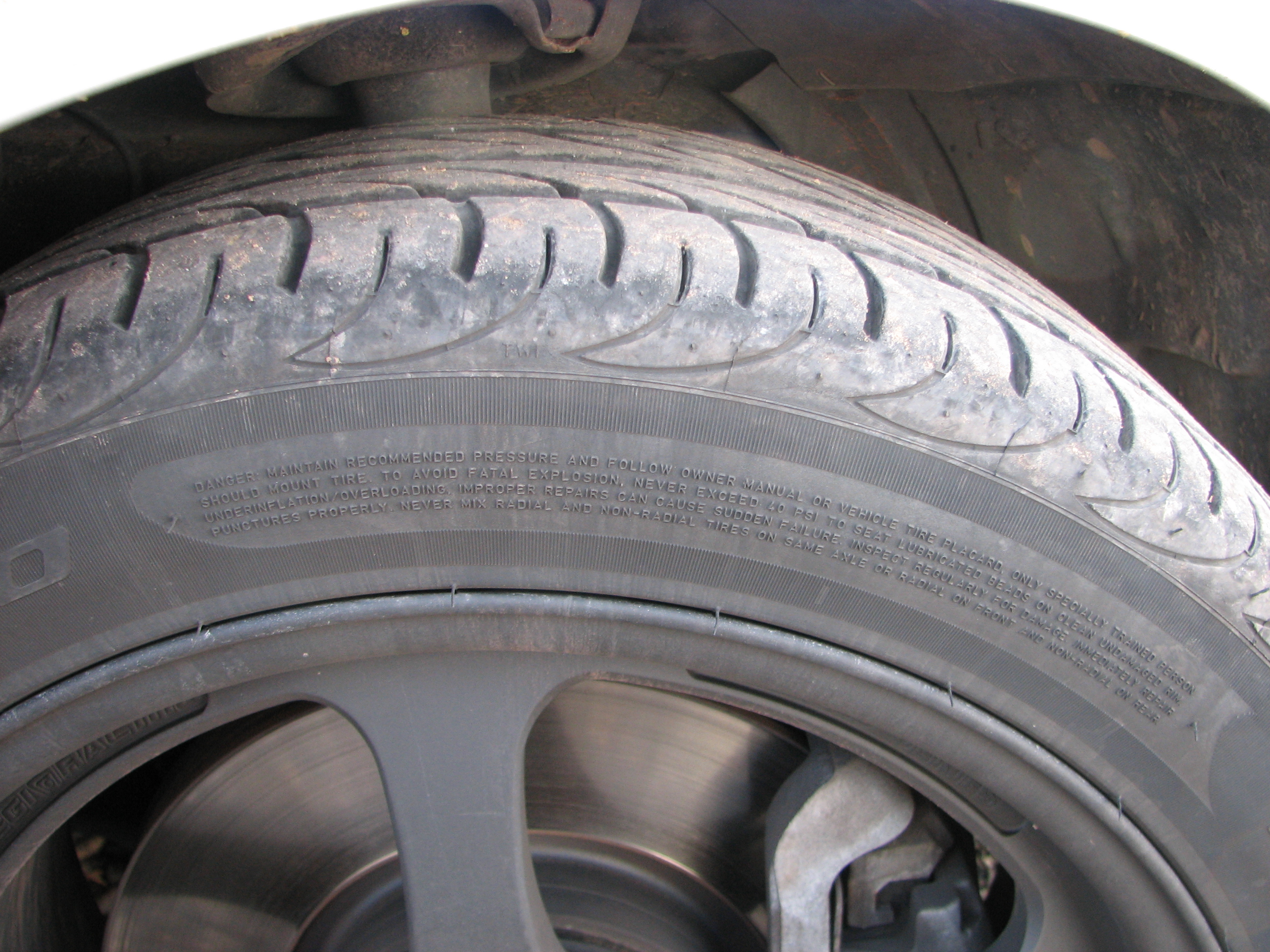

I'm also using 235 tires (235/45 17s (8" width rims, 45 mm offset)). Here's a pic of my right-rear tire (all the tires look the same). These tires have been on my car for more than a month I think. I personally don't think I'm rubbing much if at all.

Here's the front right (the file is too large for this site so you'll have to click the link to view it...). As I understand it rubbing isn't as much of an issue on the front.
Da Pic
Da Pic

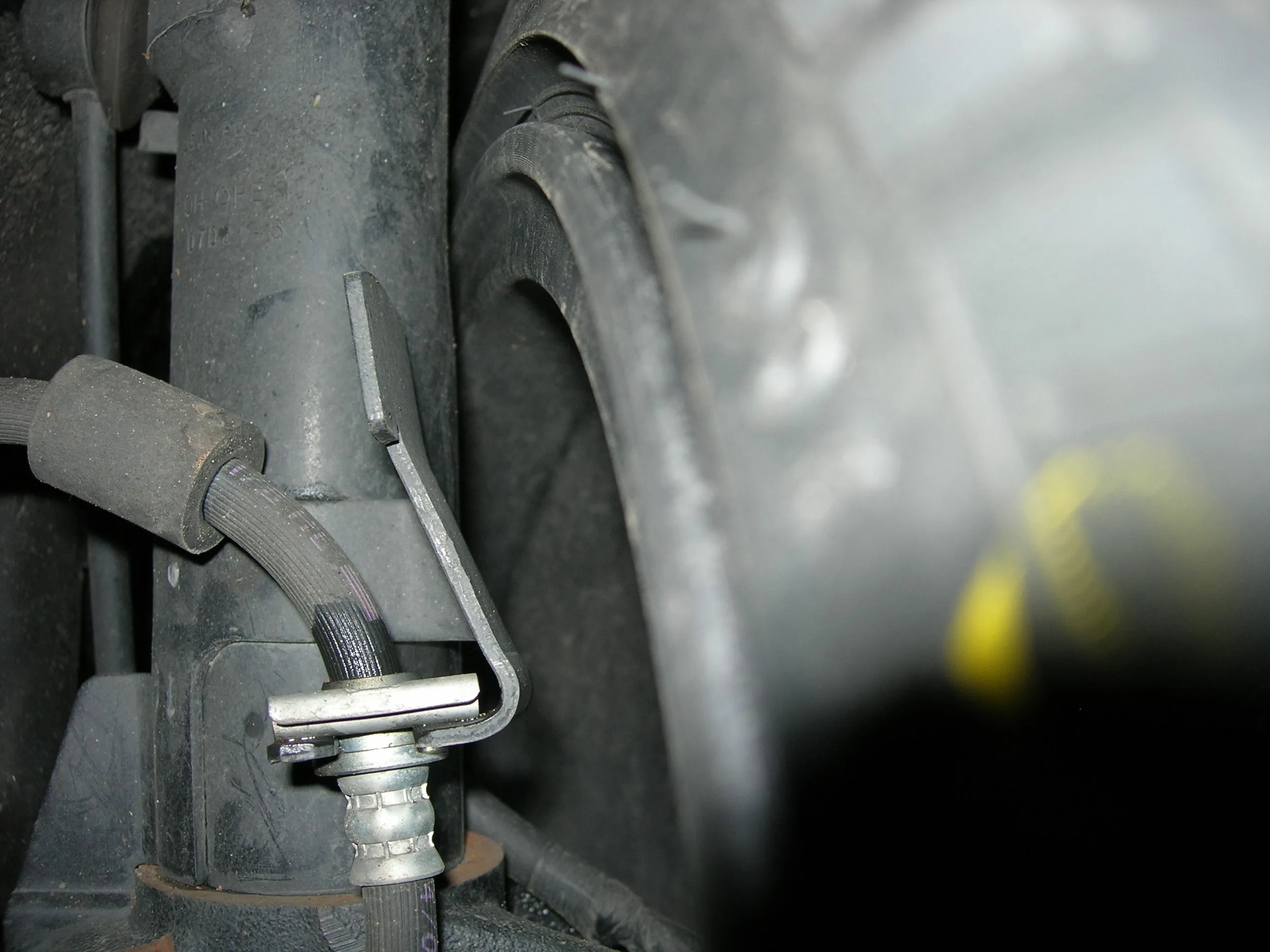

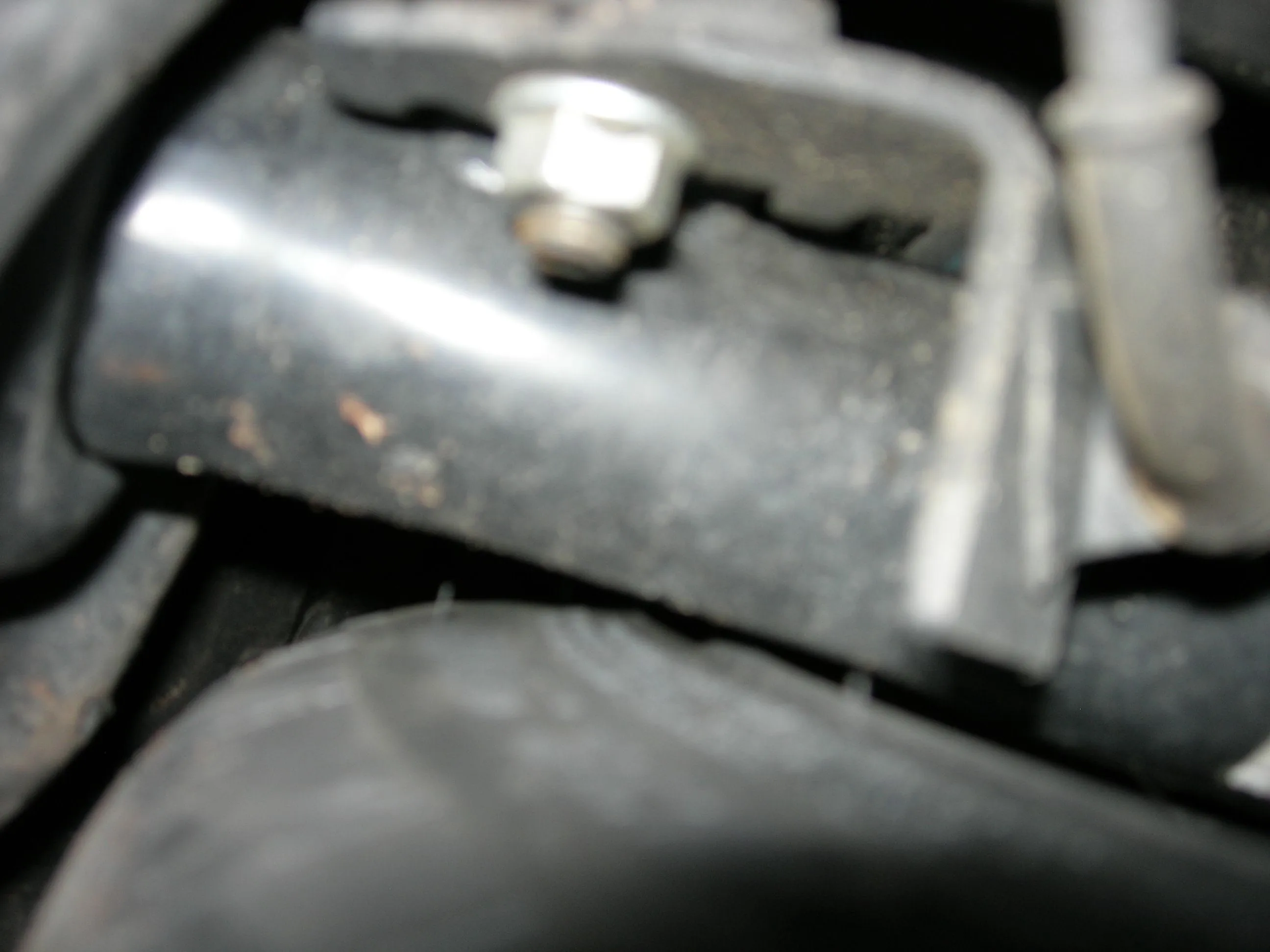

Here are some pics to clarify things. 18x8.5 53mm offset 235/40/18
I should have fone with 245. I Played it safe with 235; I knew things would be tight. any body manage to fit anything wider than a 8.5 wheel on there speed.
"The width of the tire is pretty much going to be greater than the width of the wheel.
If the wheel is 1/8" from the strut now a tire on that rim is likely to touch. A 235 tire should be about 9.25 in wide"
The pics show how this is not the case:)

Wow that is a tight, TIGHT fit. Kudos on the very tough clearances! I'm curious to see how much rubbing if any is created if the rear suspension compresses fully.

Good lord that's close! Those wheels look awesome too by the way. (2thumbs)
I stand corrected about the width of the tire compared to the rim. I'm glad I used the modifier "pretty much", there will always be exceptions.
All that said, as you can see our clearances are CLOSE, and we must be careful with our offsets and widths. Could you imagine the trouble you'd be in if you used wheel weights on that inside lip? WOW!
Thanks man, stock there is no rubbing while driving in a spirited manner.(drive2)
When i put my coilovers on in the spring I will find out if a fender roll is in order. It looks like it will be close, the front should be fine. (yes)another good reason to use stick on weights.
