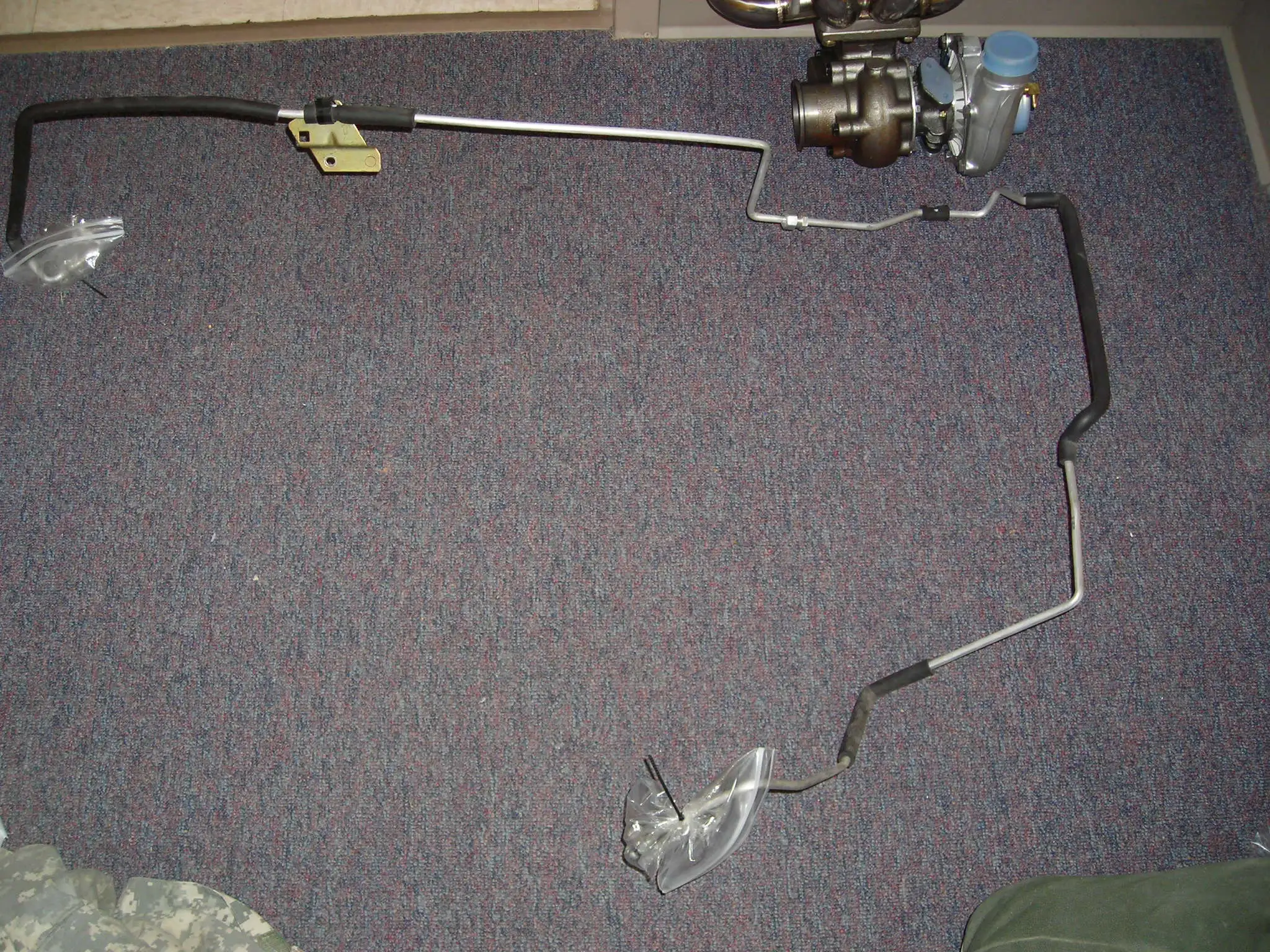

it was the line that cracked, right at the bottom of the line its tweaked somehow, my warranty ended like just this friday so im hoping they;ll cover it monday

alright im down, its the one that goes to the drivers side, going away from the rad, i see it connects to another peice above the throtle body

That is the line right. I can send the whole thing or just the half that goes to the dryer (little canister thingy) PM me when figure out what your gonna do.
i believe thats the reciever/dryer. Make sure when u install a new line, DO NOT MAKE A RESTRICTION. as in don't bend any part of the line just to make it easier for you to install. the way it comes, install it as it is.
