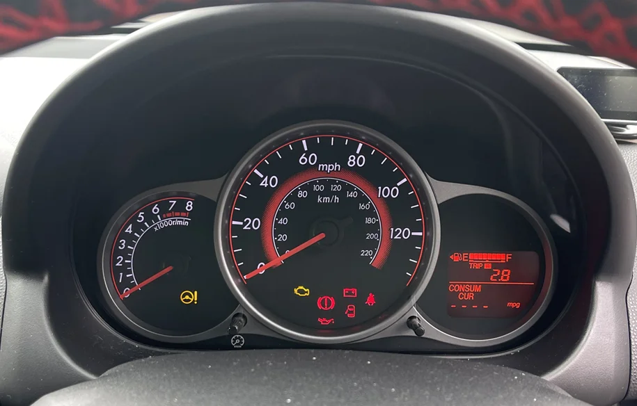

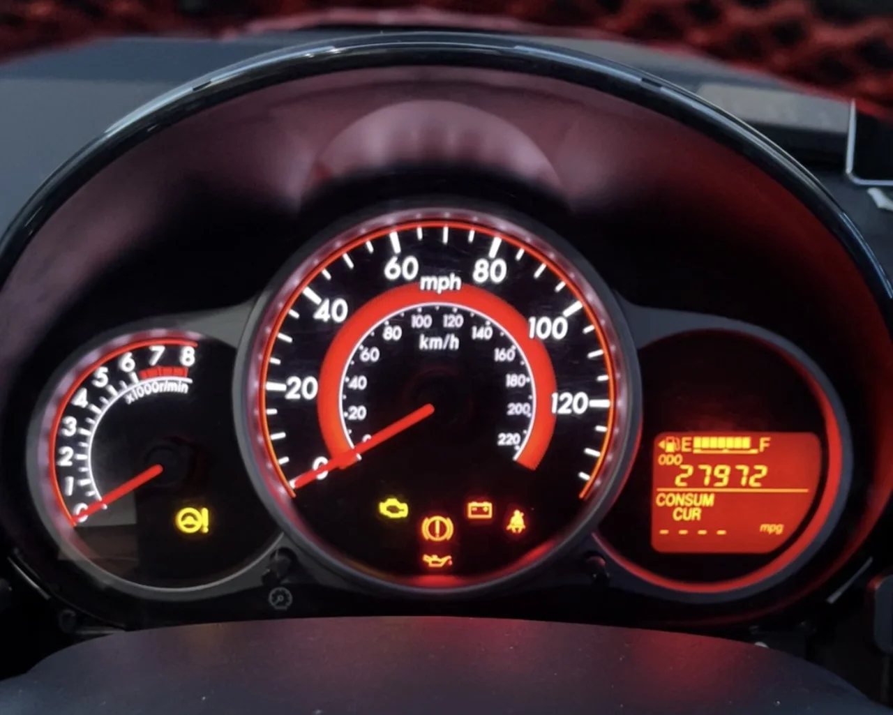

Hi people, I see that there are multiple guides already out there about what to do when swapping out for a new cluster, but most of these guides are either incomplete and doesn’t explain how to program the new cluster for your car, are for the Mazda3 BL, are very hard to find and requires alot of digging, or steps have to be implied from Ford instrument cluster instructions. So, I want to create this guide incase somebody has a Mazda2 DE and would like to upgrade...
From this...​
...to this!​
for around $60-70USD (prices obviously vary depending on how/where you source them).
With an upgrade like this, you will be able to:
- See your fuel economy statistics
- See your miles remaining on current fuel level
- See your current ambient temperature
- Enjoy a way better looking cluster in your Mazda2 :D

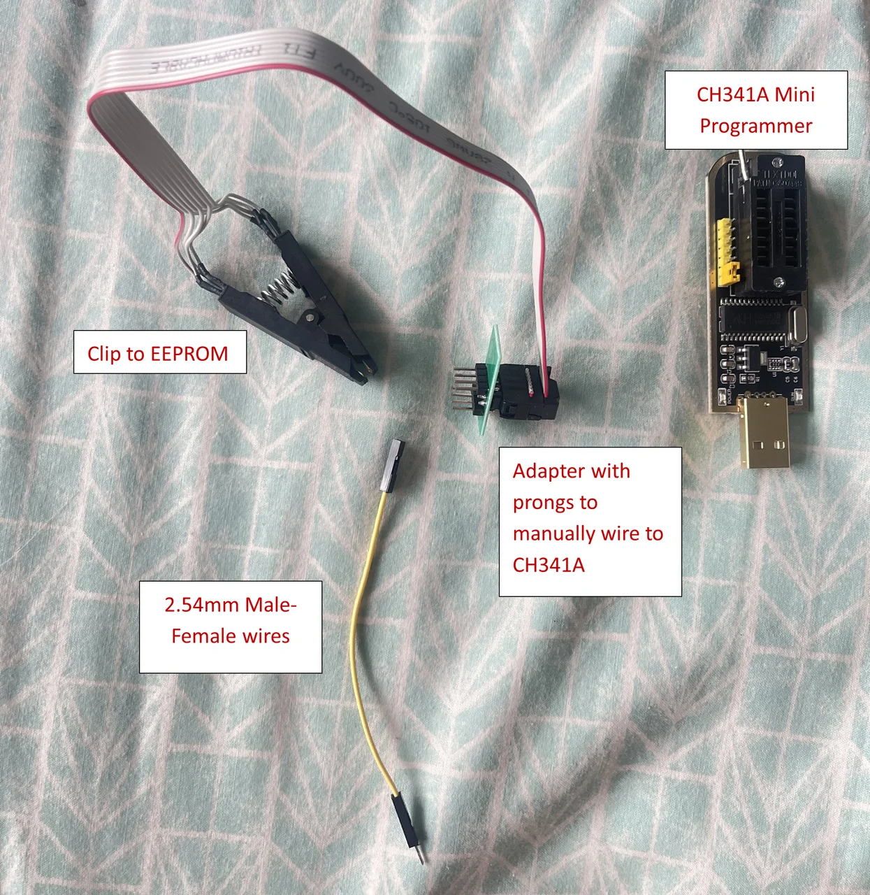

  • £5-£10 | CH341A Mini Programmer
    • Ensure when buying a set that it comes with a clip that you can easily attach to the EEPROM (a chip that stores your odometer value) and prongs that you can manually wire to different pins yourself, something like this:
    • If your set comes with a 93XXX to 25XXX adapter (or the set youre buying explicitly supports 93XXX type chip), then that will make your life easier.
    • I used this set (did not come with any adapters).
  • £2-3 | x7 2.54mm Male-Female jumper wires and a jumper bridge
    • A small jumper bridge to give the CH341A full 5V for programming, and jumper wires to make the CH341A read/write compatible with the cluster EEPROM.
    • If your CH341A programmer set explicitly says compatible with 93XXX chips with a 93XXX to 25XXX adapter, then jumper wires may not be required. However you still need a small jumper bridge like this to give the EEPROM a 5V supply.

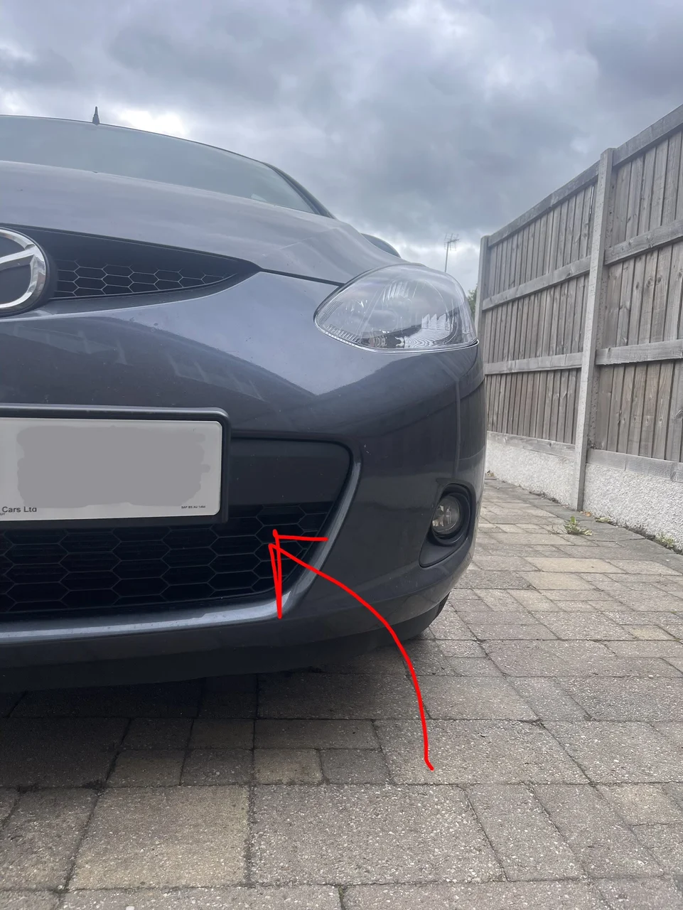

  • £5 | G518-61-764 Ambient Air Temperature Sensor
    • FORScan will pull a trouble code if you are upgrading your cluster to a larger LCD with ambient temperature view and your car does not come with the temperature sensor as standard.
    • The best way to check if your car has this sensor or not is to physically look through your car vent. The sensor is located on the left side of the vehicle near your radiator:
    • Obviously if your original cluster already has an outside temperature reading (the bigger LCD) or your car has automatic climate control, then you don't need to purchase this. You will only need this when you are upgrading your instrument cluster with smaller LCD screen to a cluster with bigger LCD screen.
    • You can buy this sensor for as low as £5 from China on eBay.

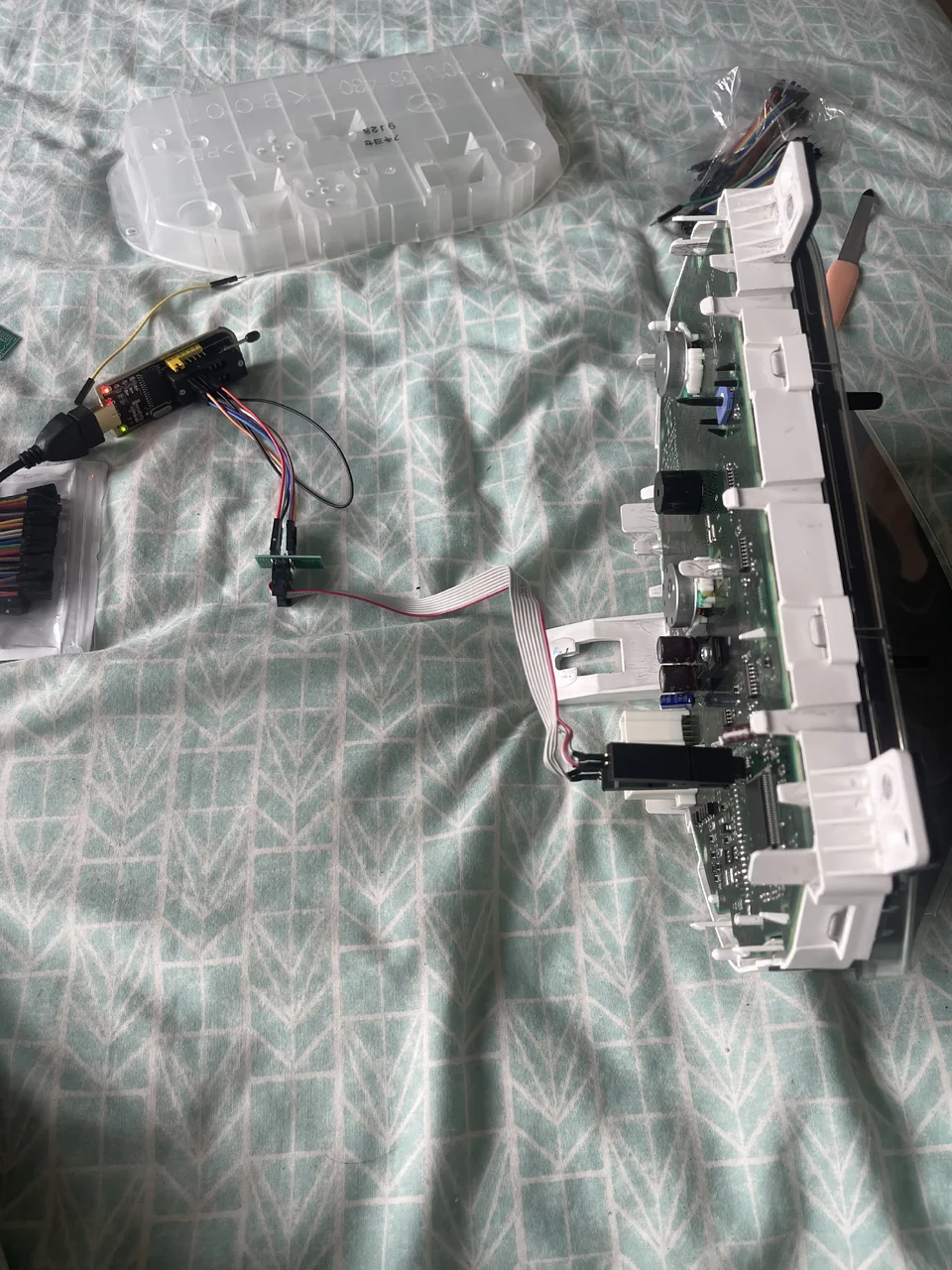

1. Remove the instrument cluster. Learn how to remove the instrument cluster using this YouTube video. No need to disconnect 12V battery.
2. Remove the back cover of the instrument cluster. Slowly pry the case whilst you pop the white plastic wedges on the side.

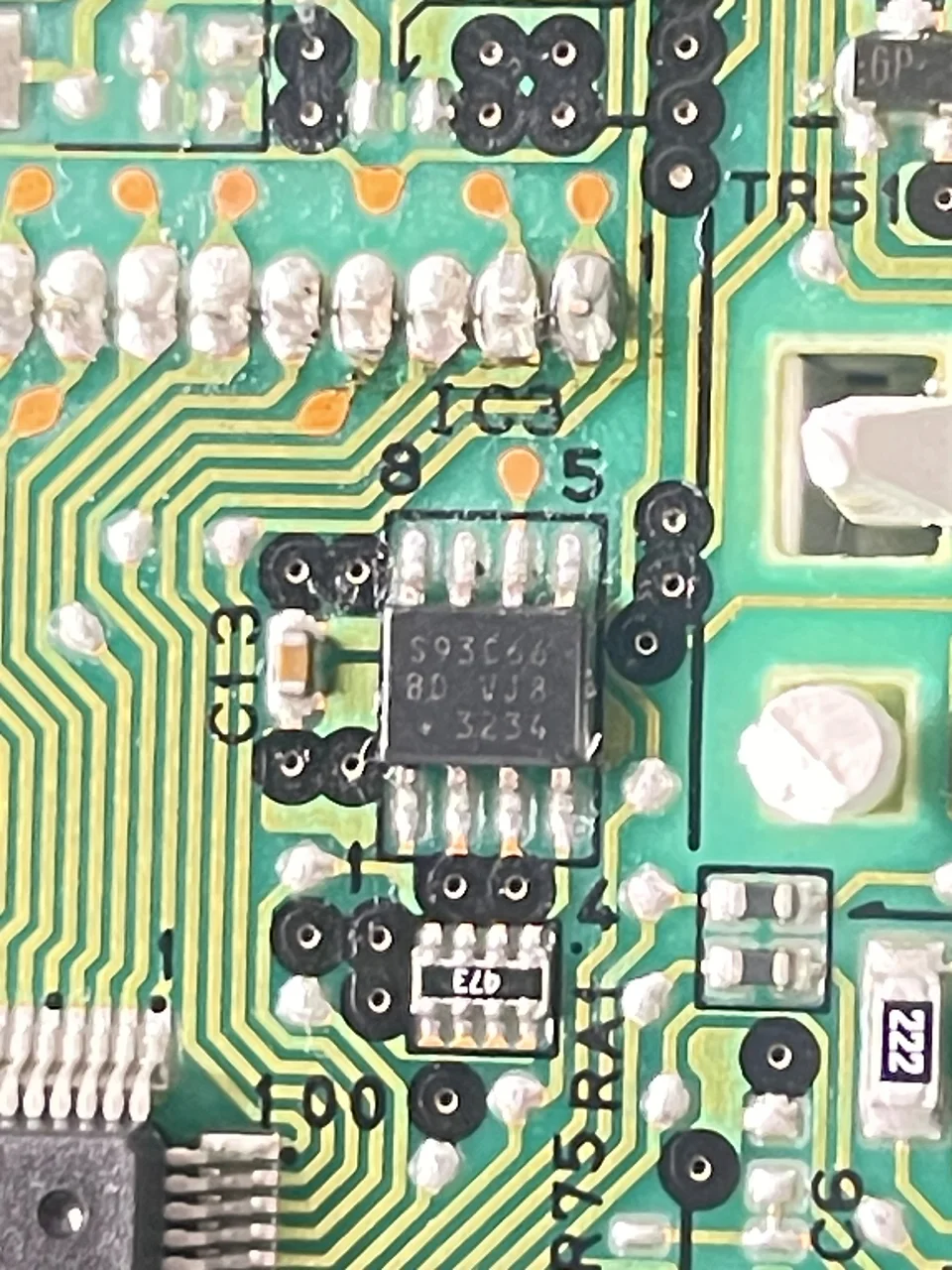

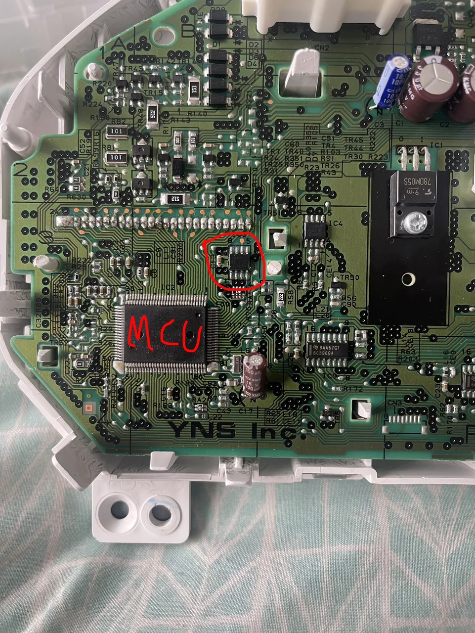

3. Locate the EEPROM. The cluster's EEPROM is an 8-legged little chip usually next to a really bigger chip (MCU). You will know you found it when the chip has the marking 93c66. My EEPROM was made by Seiko so its marked S93C66, but so long as the chip has "93c66" then you're in business.
Different clusters may have different locations, but here is my old cluster's location:
You should now have located the EEPROM. This is the tricky part.

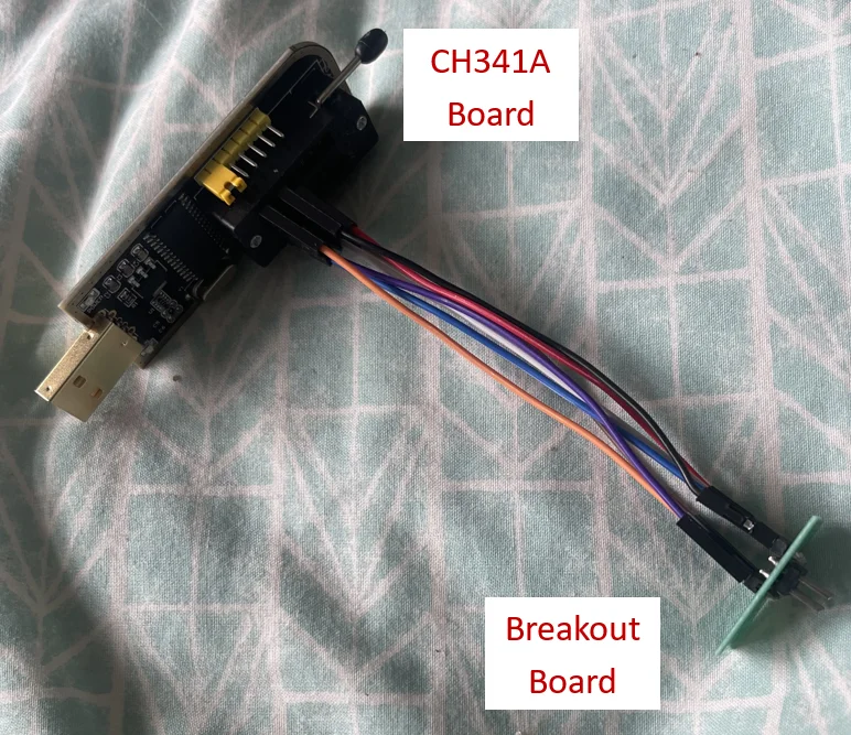

If you do not have the 93XXX to 25XXX chip adapter, you must now do the following (or follow this video):

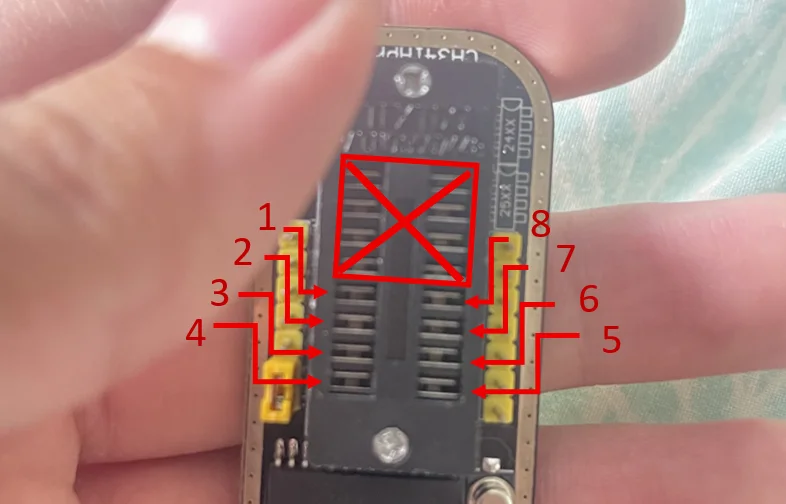

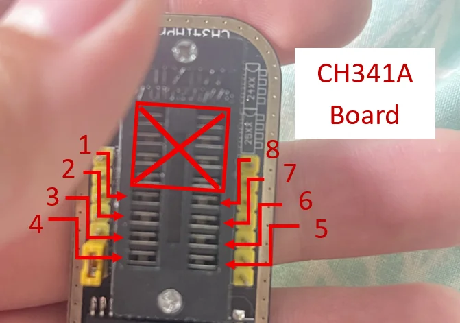

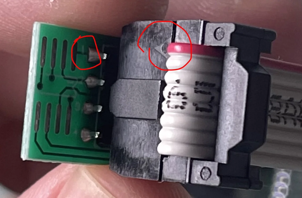

1. Grab your EEPROM clip. Connect your EEPROM clip to the breakout board provided making sure that pin 1 (red wire) on the EEPROM clip connects to pin 1 on the breakout board. You can identify which pin on the EEPROM clip connector is pin 1 by finding a triangle pointing to one of the edge pins.

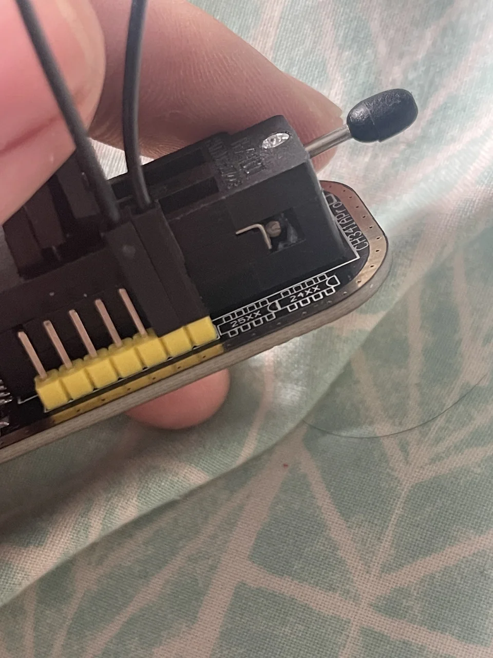

2. On the CH341A board, bridge the 3.3V to the 5V. The two pins are next to each other and they are both located near the "25XXX 24XXX" diagram.
3. Using the 2.54mm jumper wires, connect the male-end to the CH341A board (25XXX side; 4 rows closest to USB), and the female-end to the breakout board as follows:
It is imperative that you take your time with this.
Breakout board (Female)<----->CH341A board (Male)
1 | Chip Select<----->1
2 | Clock<----->6
3 | Data In<----->5
4 | Data Out<----->2
5 | Vss<----->4 (squeeze with 6)
6 | ORG (93CXX is 8-bit)<----->4 (squeeze with 5)
7 | PE (NOT USED)<--/-->NOT USED
8 | Vcc (5V)<----->8

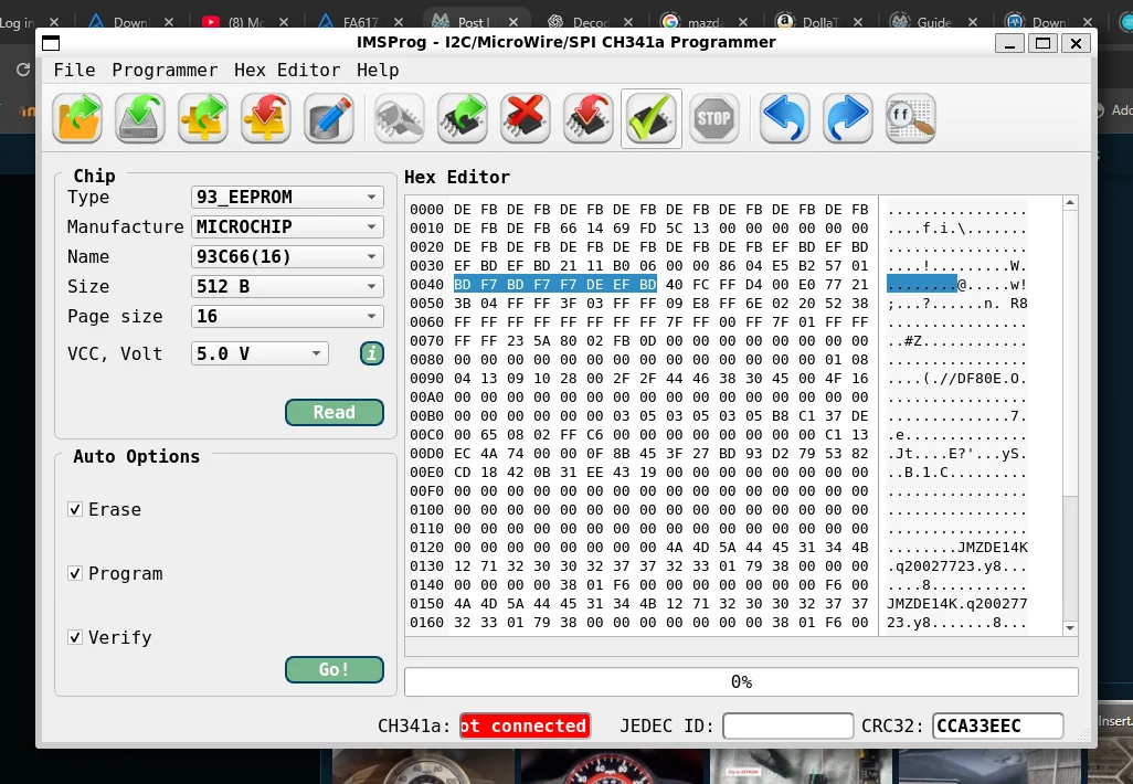

4. Once correctly wired, use the EEPROM clip and )clip onto the cluster EEPROM. Mazda engineers are nice enough to put numbers on the edge of EEPROMs to show you which pin number is which; make sure that pin 1 on the clip (red wire) connects to pin 1 of the EEPROM. This may take some time as it can be very fiddly. Be patient. You will know when a complete connection is made when the green RUN light on the CH341A board is lit. You may have to hold onto the EEPROM clip to ensure good contact with the EEPROM.
Take extreme caution when trying to clip the EEPROM. I recommend disconnecting the USB whilst you are trying to clip the EEPROM, then connect the USB and see if the green light is on. Every small little adjustment can run the risk of shorting the EEPROM, meaning you have bricked your cluster.

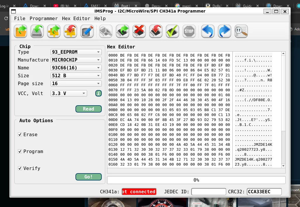

5. Select your chip (_93C66), set Vcc to 5V if necessary and press read. You should get something like this:
Verify integrity of the file by checking the VIN data on the EEPROM (line 120). This data should somewhat correspond to your car’s VIN number. If the VIN data on EEPROM isn’t matching your car or is gibberish then something is wrong with your software IC settings. (My VIN is JMZDE14K200277238 like in the picture above)
For NeoProgrammer: _93C66 (16bits) [5.0V]
(IC->Microwire->Generic->_93C66_16-bits)
For IMSProg: 93_EEPROM MICROCHIP 93C66 (16)
Make sure Voltage Vcc is set to 5.0V
For asProgrammer: ???
I've tried multiple versions of asProgrammer but I couldn't get it to work. When I verify the dump with my car's VIN number, it's scrambled and just wrong.
WARNING: Flashing new data onto an EEPROM is a PERMANENT change! ALWAYS save all EEPROM dumps you come accross, and name the dump files clearly before proceeding to make any permanent changes.
6. In line 0040, copy the first 16 characters (as highlighted in the above picture). That is your hex data for your odometer value.
