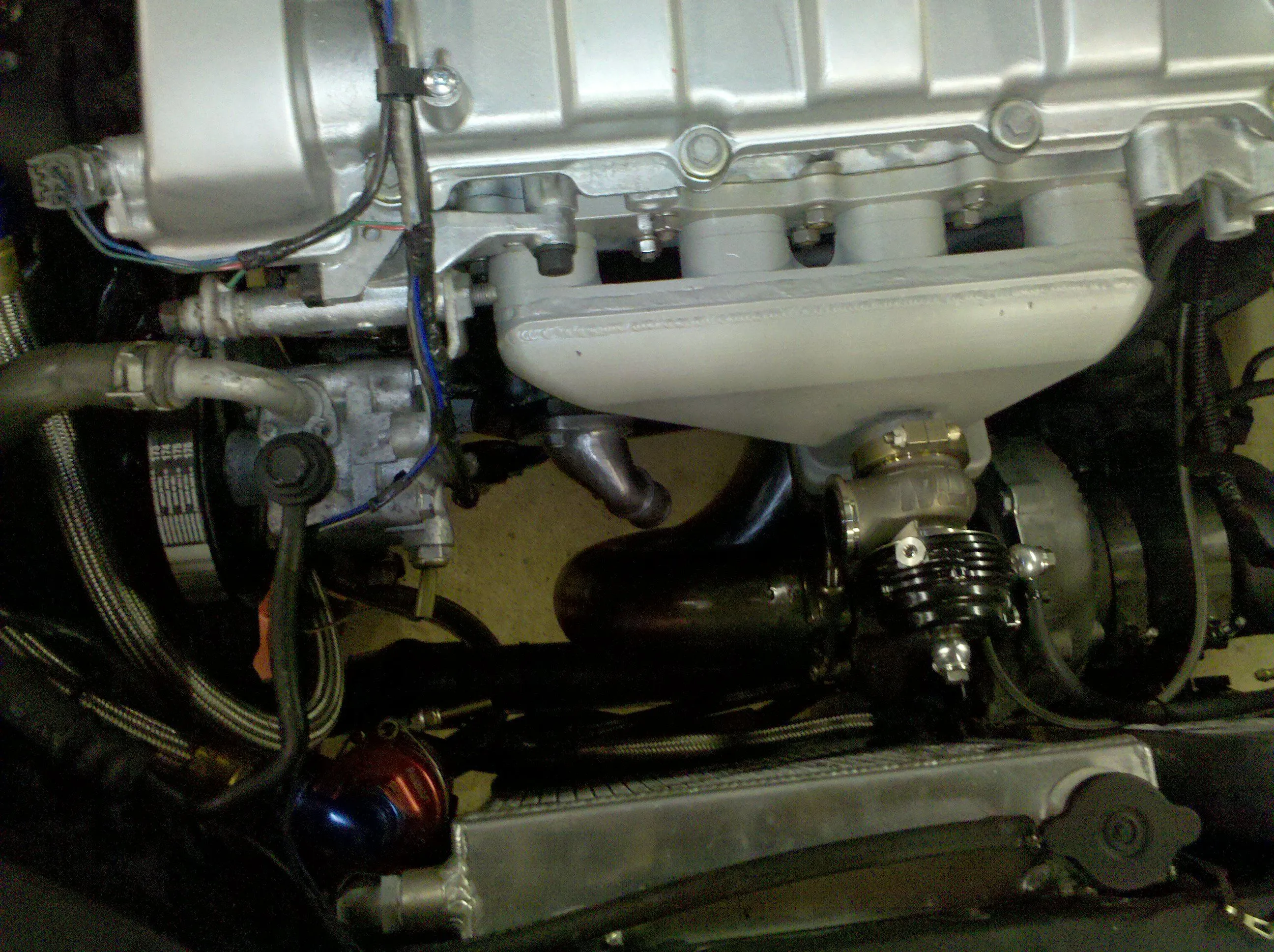

Turbo System Switch to MAM 2nd Gen Streeet Sleeper Kit

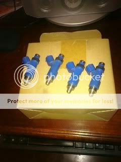

Just received these today:
2006-2007 Subaru WRX 560cc Injectors (Part # 16611AA720)
I also just recently replaced my injector insulators that seal them into the intake manifold...
No dyno yet. <qtlend></qtlend>

I read through the thread looking but couldnt seem to find the answer...
What turbo are you running with the Sleeper mani?
Also, do you know if the EGR port on the sleeper mani is designed to be used with the stock EGR tube? Would that be the same location for the MP3 as with the MSP?
Long time no see (drinks)
edit: my bad. I checked the last page and saw that your running the potato. Question about the mani still stands though
Yep, I'm running the GT28RS with at .64 turbine side. As far as the EGR valve goes, it is the same on all models of the 3rd Gen Protege. Yes, the EGR port on the manifold is designed to be used with the stock EGR tube.
