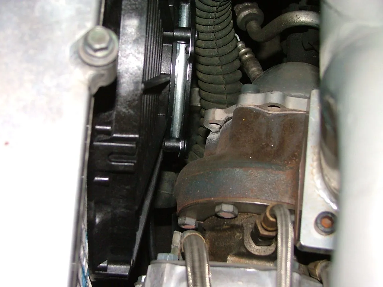

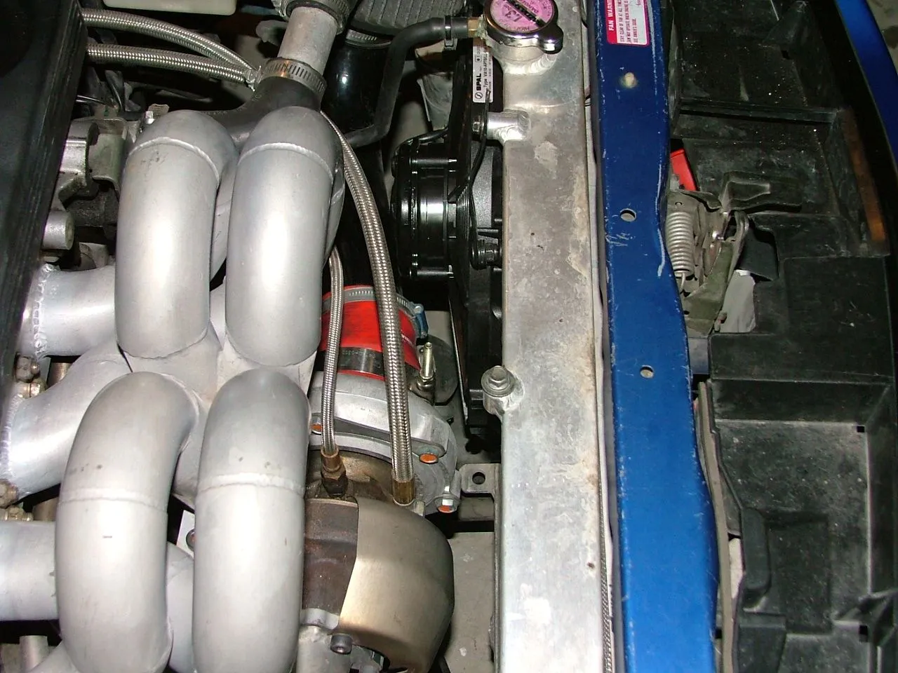

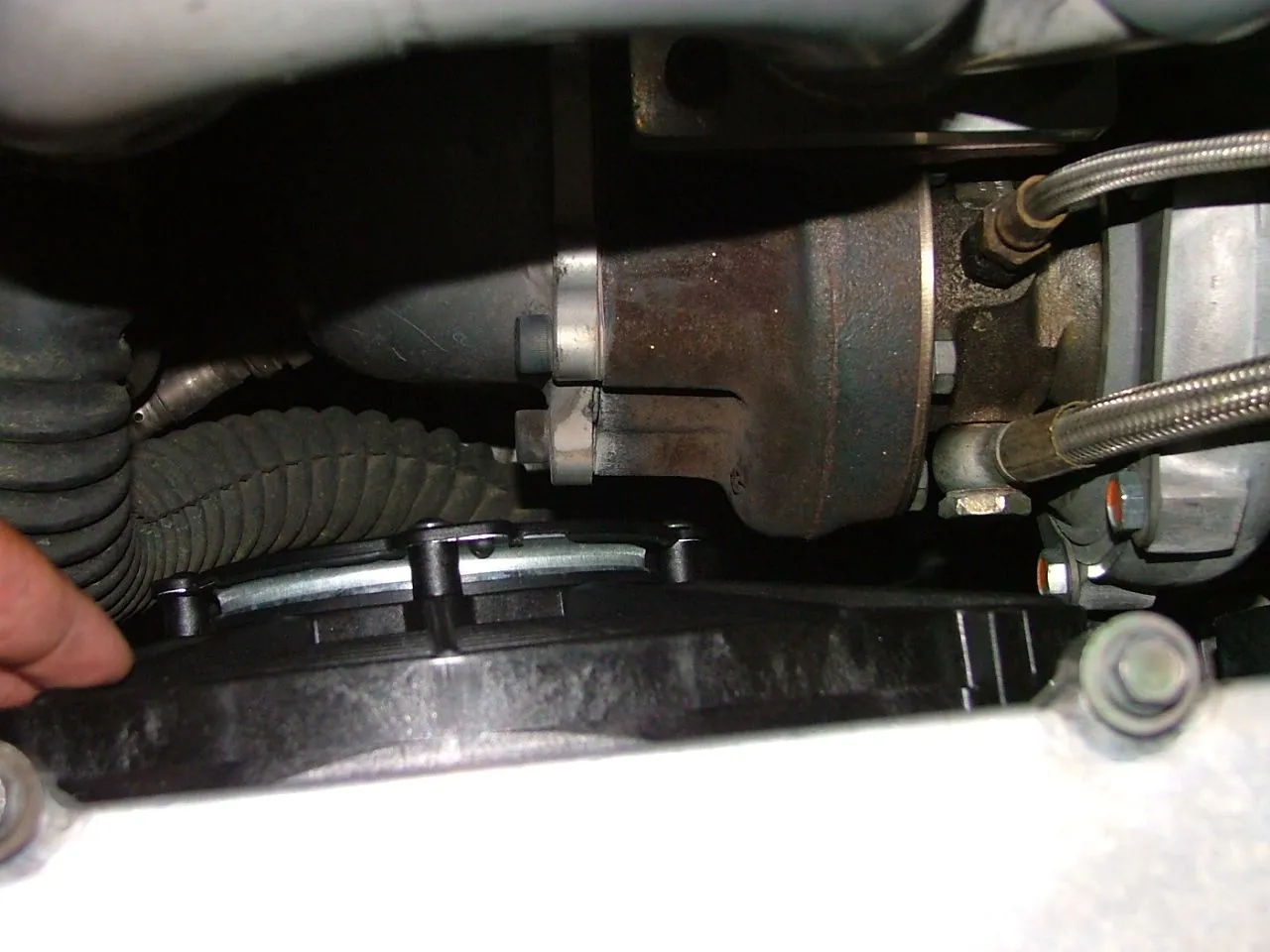

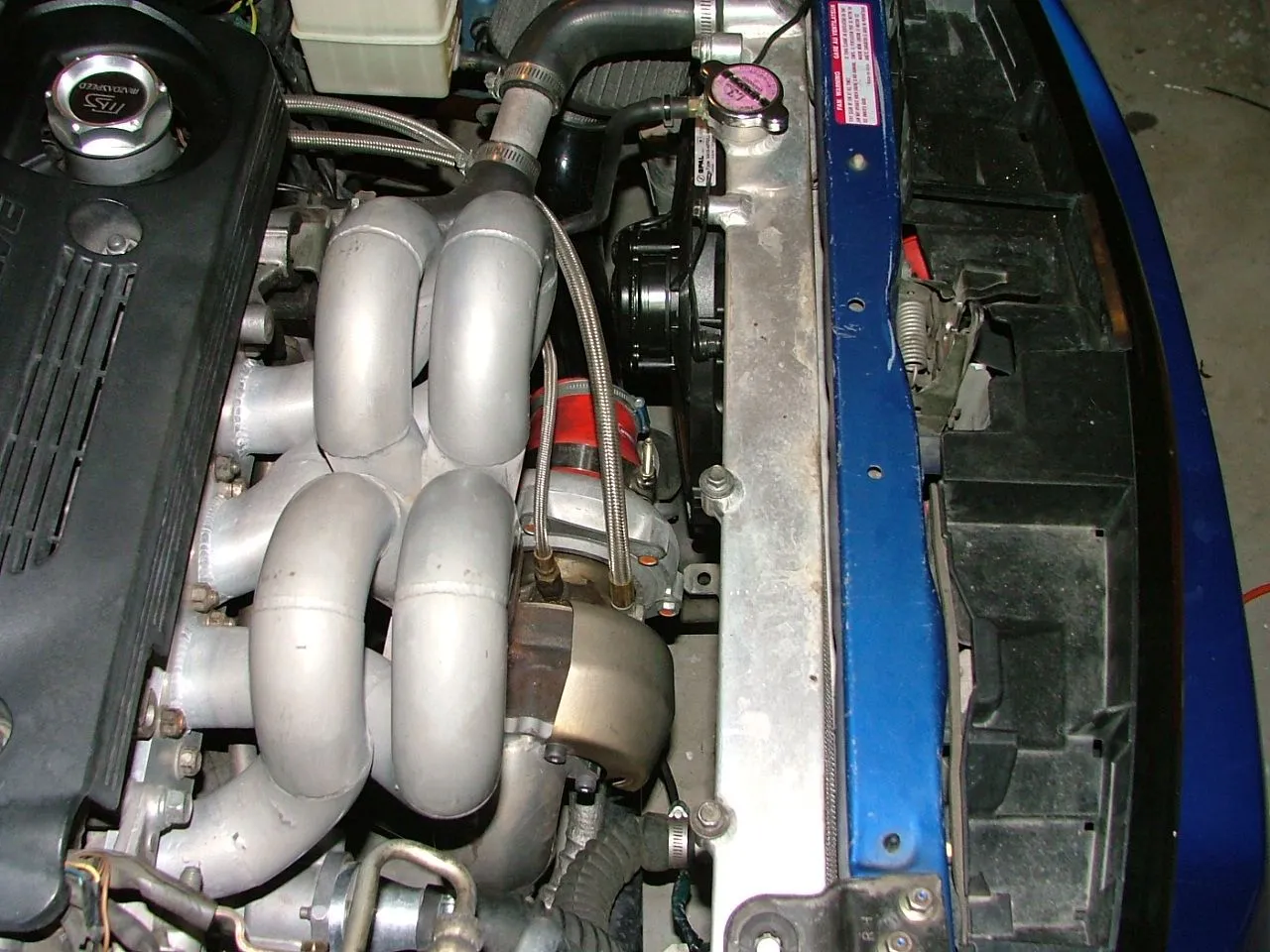

Tired of dealing with overheating issues in the summer, so I am working on some solutions. One such solution is an 11 inch SPAL fan on the other side of the radiator, in front of the turbo. I already have a Maradyne 12 inch fan on the driver's side, and a SPAL 9 inch pusher in front of the condenser on the passenger side. One concern I have is that the new SPAL fan may be too close to the turbo. Doing some test-fitting now. Is this too close?

I dont get it I dont have any over heating issues. Is the gauge going up in the car or are you reading from another gauge water temps?

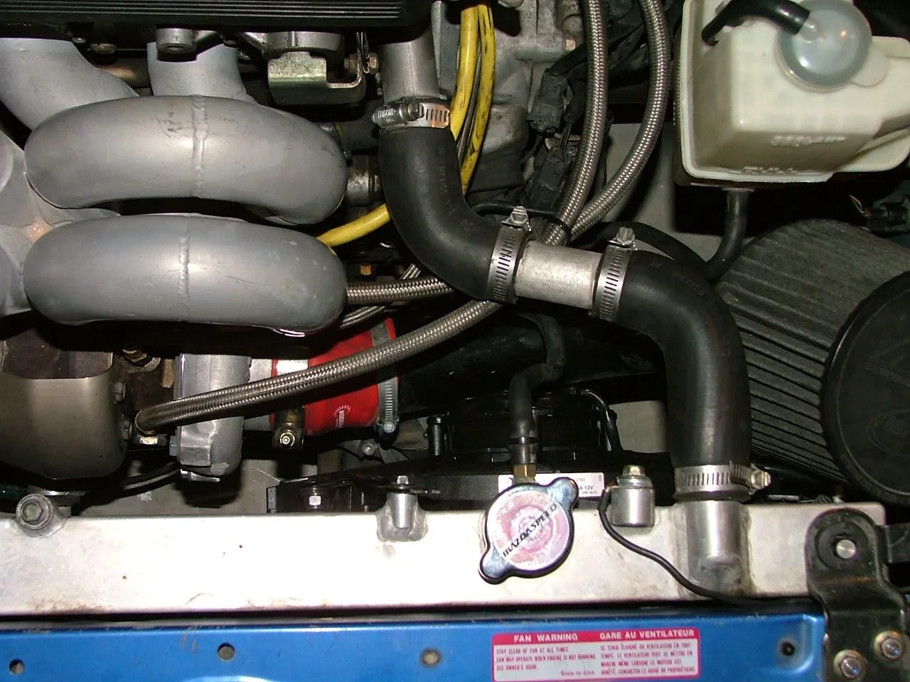

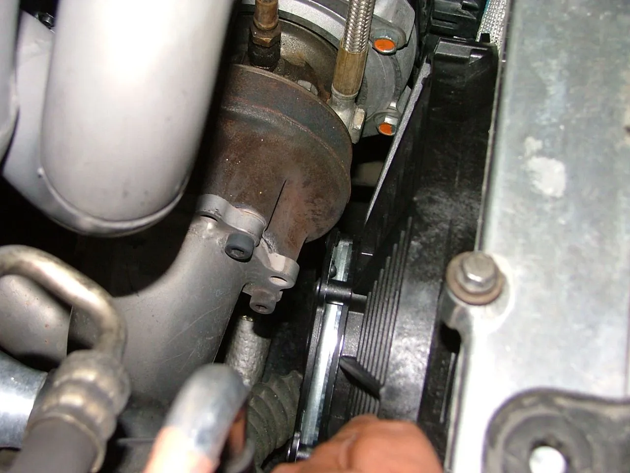

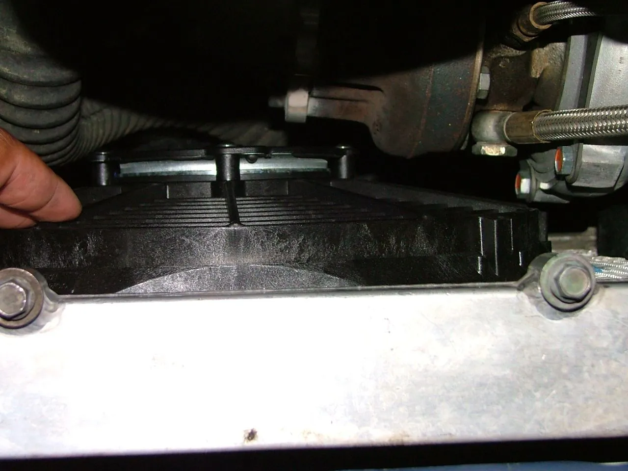

I added the MSP heat sheild to my turbo, and got a new radiator fan.
I had recently bought a SPAL 11 inch, but took that back, and exchanged it for a nice 12 inch Spal High Performance, curved blade (that sucker is 3.39 inches in depth) to replace the 12 inch Maradyne fan I had on the driver's side. Wasn't going to be able to fit the 11 incher on the passenger side with that MSP heat shield in there. I had to re-angle my intake to the turbo to fit the new fan. This sucker really blows!! 1360 CFM!! It really has made a difference. I am still in the testing phase for this fan now. I did notice last night that it came on, dropped the coolant temps, and then kicked off, all while I was parked. For the last 2 years, I had only seen this happen in the winter. I also want to relocate my Haltech water temp sensor to the water neck, rather than the radiator hose (right in front of the fan flow). Another thing I want to do is hook up the cooling fan to my Haltech E6X, and have it come on sooner.
