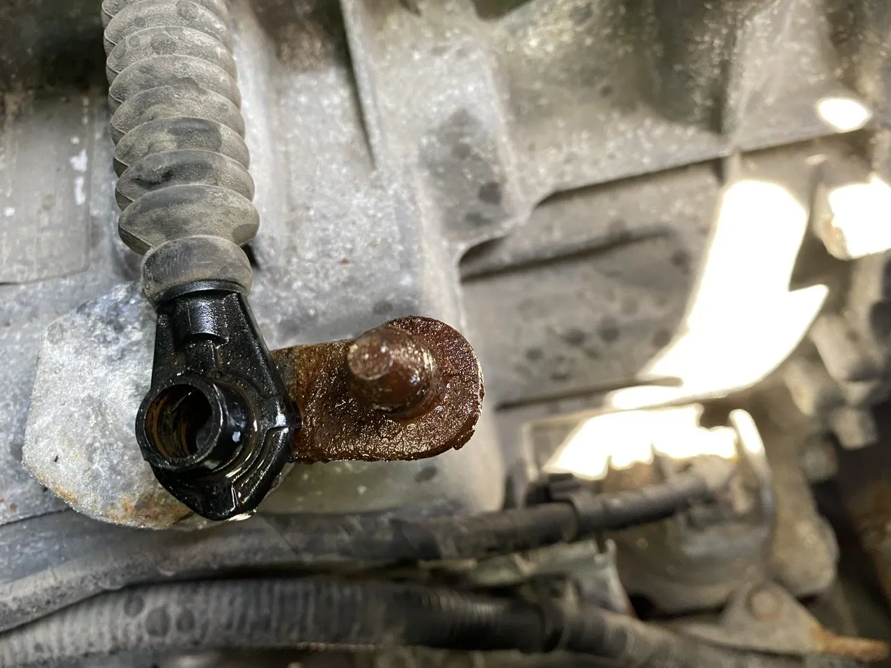

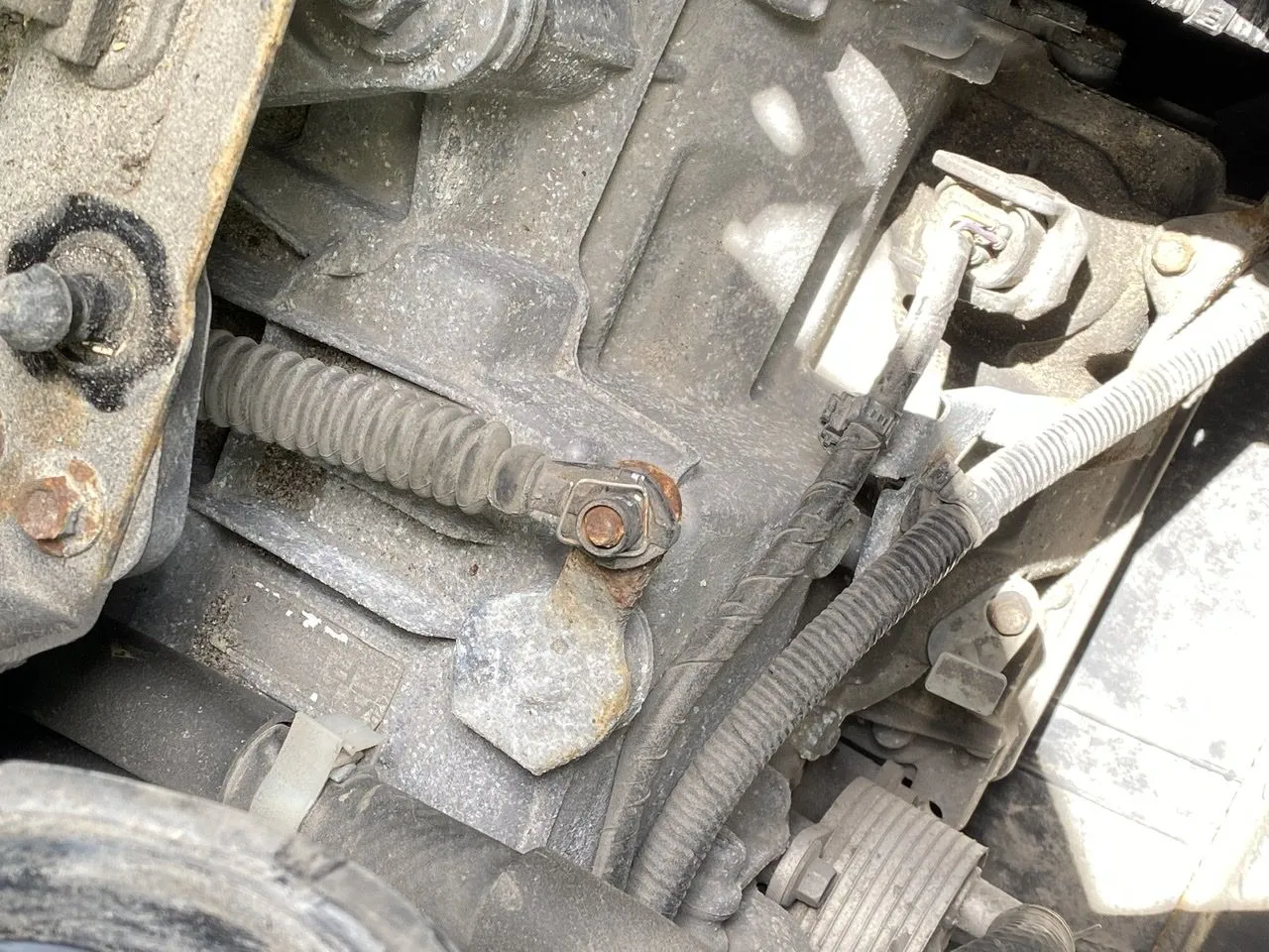

I took a better look at mine today and the issue was actually the shift cable where it connects to a pivot point on the top of the transmission. The lever was corroded which made pivoting difficult.
If you remove two 10mm bolts that holds in the air box and remove the air box assembly you have full access to the area needed. It took some time to get the cable off of the lever, but once I cleaned it up and lubricated it, the car now shifts like it did when new.

Sounds like you saved yourself the cost of a transmission replacement. How often do you hear stories of people fixing their issues by having their mechanic cleaning up a cable? I haven’t heard them yet! Simple stuff like that doesn’t seem to be checked. Nicely done!
The transmission itself was fine so I wouldn’t have had to replace it. However, if left in a corroded state, it could have damaged the cable and likely would have prevented the transmission from shifting into gear.
I have not heard of this issue on any CX-5, but Mazda has been using the same design on many of their models for at least the last two decades and there are plenty of documented issues regarding the shifting cable where it meets the transmission when corrosion is present. Some grease goes a long way in preventing the issue altogether.
Joe's Advice worked for me. THANKS JOE! Two 10 mills up on the top of the air intake pipe where it is open facing to the front. Then loosen the boot and take off the top of the filter housing by removing two spring clips. Getting the lower unit out is tight but do-able. pop up the lower unit from the three rubber holders and then just tilt and pull up until you can get the whole thing out. I had to press on the steel bracket behind the air box a bit to get it out and in again. Then as Joe shows in the pictures the linkage and cable are easily accessible.
For my car it was very corroded (do to northern Canada road applications). I took some synthetic motor oil and an old tooth brush and soaked and brushed the two pivot points from every angle possible. Waited a day and then did it again. Now it slots right back into drive properly and shifts much smoother. Thanks again Joe for saving my a shop bill.
Thank you, you saved my time and money, it works now!
