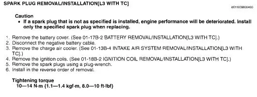

Does any one recal the torque spec? I had it around here somewhere... But, it is worth repeating as some folks are swapping plugs it seems. Those aluminum threads cannot take much abuse.
8-10 ft-lbs.
