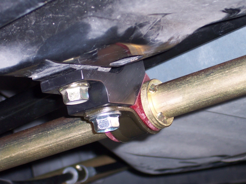

still would like to see picks of the AWR swaybar installed.
ah google...
lol i did googles but came up empty.that looks real nice actually.
Im dissapointed to hear that you could still get the clunk with that awr bar. can anyone confirm this?
I have the 21.5 bar and yes you can still have the clunk, but I modified the bar by cutting off 6" off each end and modified some energy suspension brackets and bushings. Never had a problem since then.
I did the same thing. the awr bar kept hitting the lateral link so I cut it like you did. lol
heres a pic of where it would hit going over bumps. (not my car) I now have the msp rear bar with modded energy suspension brackets and bushings as well.
