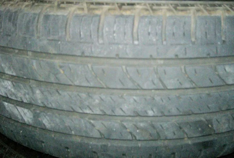

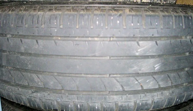

My CX-7 has 13,500 miles on it. I just put snows on my car. The back tires were worse then the fronts. I'm assuming maybe the dealer rotated the tires at some point. I can't imagine the backs having more wear normally. The wear was a lot more then I've seen on other cars.
I've attached pics of the tires. Bad tire is the backs (possibly fronts that were rotated?).
Not sure how much longer these will be good for. I have snows, so I don't plan on putting these back on until April.

Mongrul: The pictures of your tires are difficult to read. They look like they are a long ways from the wear bars. Since tires gennerally wear fast for the first part of the tread I think you have lot more miles in them. Did I read the pictures wrong? Ed
Erkel: I guess I was looking more at the wear down the middle of the tire. The 2 of the tires look like they have untreaded slick bars down the middle. The other 2 actually have grooves in these bars.
They probably are fine for summer use as is, but traction would be pretty crappy.
More wear in the middle than on the edges could mean too high a tire pressure.
