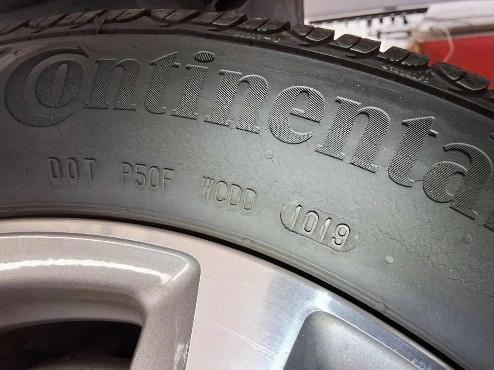

This is the picture I was sent about the tires. I guess it has some tiny cracks on the sidewall, but when I look at them up close I see nothing

That's pretty superficial cracking. So long as you don't push the tires hard (high speeds hard cornering) those are fine

Ditto on the point that those minor cracks appear to be "surface" ones.
But I guess it doesn't surprise me that a shop would begin to balk on 7yr old tires with signs of cracking. Simple safety point.
As the cracking and other visuals continue changing, you will likely find more shops unwilling to touch the tires (outside of replacing them). This coming year's probably worth considering the next set of tires, before another season's out, particularly if you have begun to notice certain deficiencies in performance (ie, grip during early morning damp roadways).
Rotations, though, are simple to do. Just need a basic floor jack, a torque wrench, and the time to do the switch. Even if you can't find a willing shop, it's an easy DIY thing.
