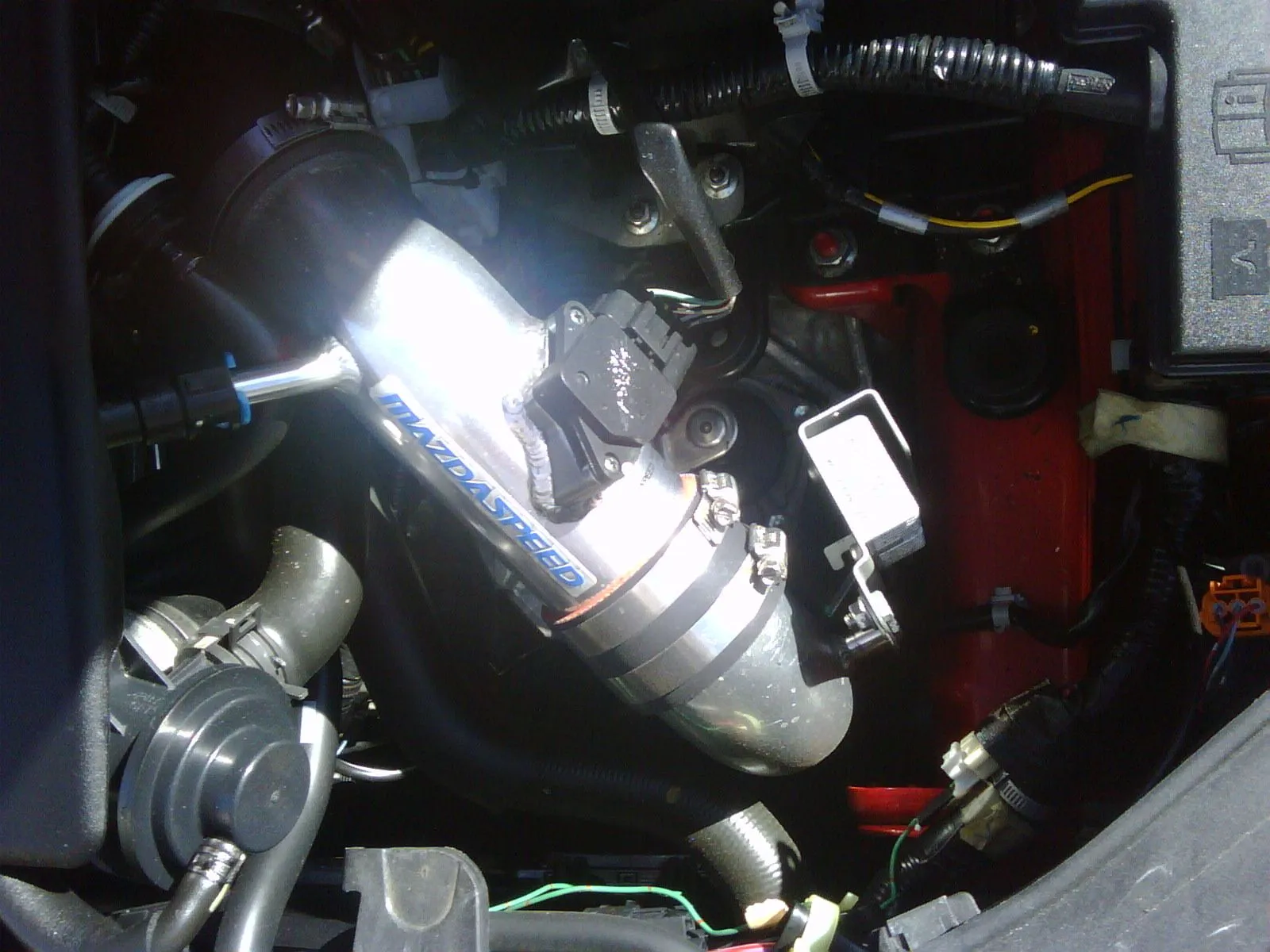

When I bought my car about 6 months ago and yes I bought it used. I noticed that there was a Mazdaspeed CAI already installed. When I first looked at the car I thought that was what it came with stock. After reading about people upgrading to to a CAI or SRI i was confused. So the Mazdaspeed CAI that i had on my car when I bought must have been upgraded from previous owner right? And also if I wanted to get the COBB FMIC installed will the CAI get in the way of installation? thanks in advance.
here is a pic of the CAI that i got with the car.

Yes the CAI is an upgrade. The stock airbox looks like a black plastic box in place of your silver CAI.
I know some CAI's will get in the way of FMIC's but im not sure which brands. Honestly though if your not familiar with modding you should read up. FMIC's are great but aren't necessarily the best 1st mods to do. Not to mention they take 4-5 hours to install.
