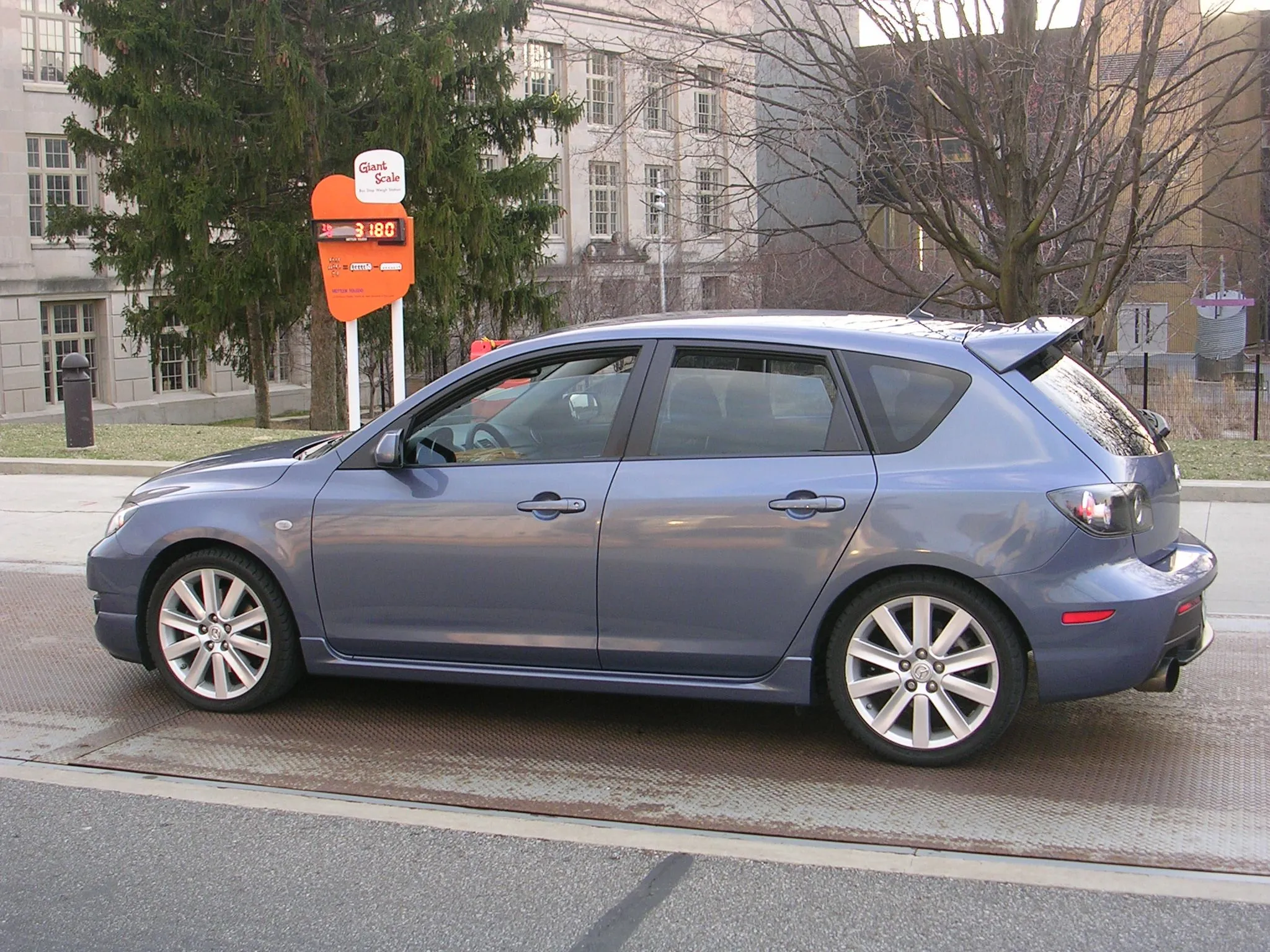

weight....w/out my fat ass

Car weighs 3100 pounds full of fuel, w/o driver. Dragstrip certified scale.
