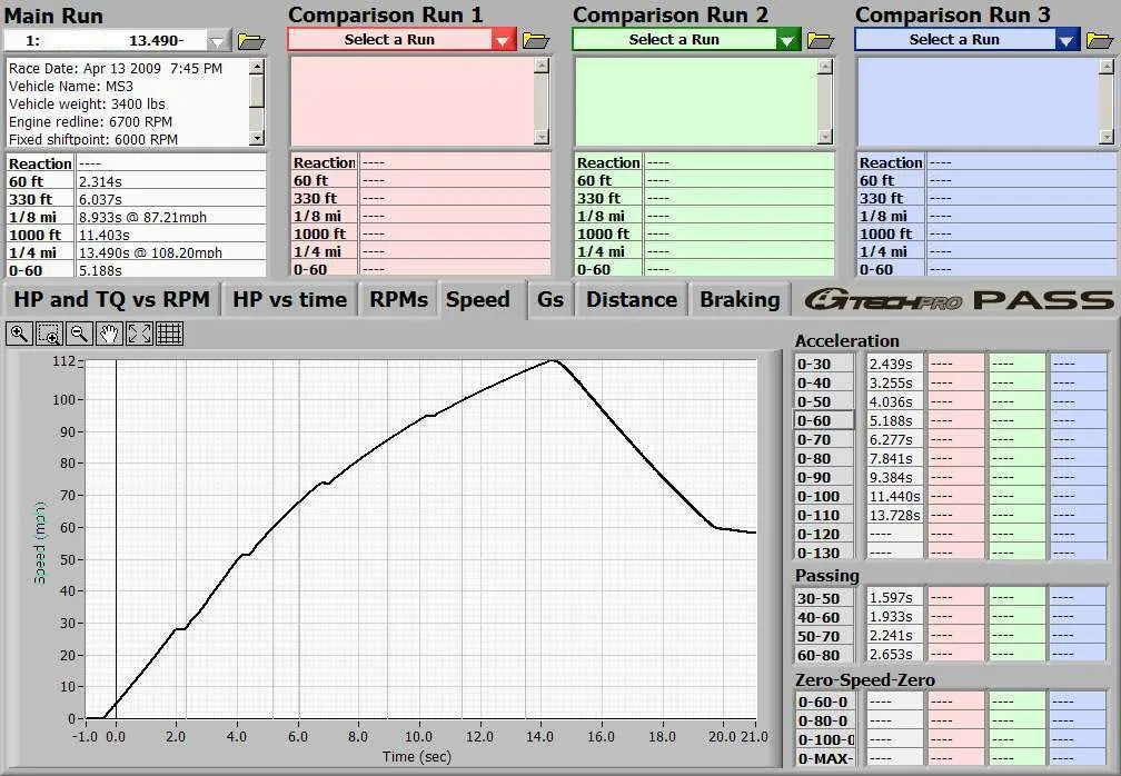

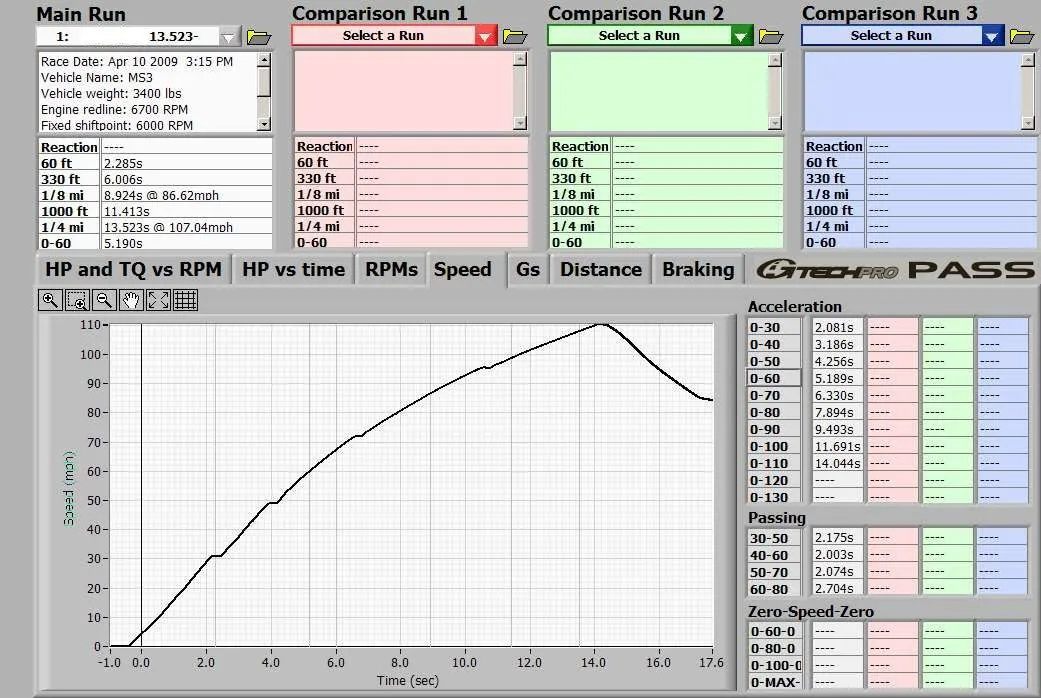

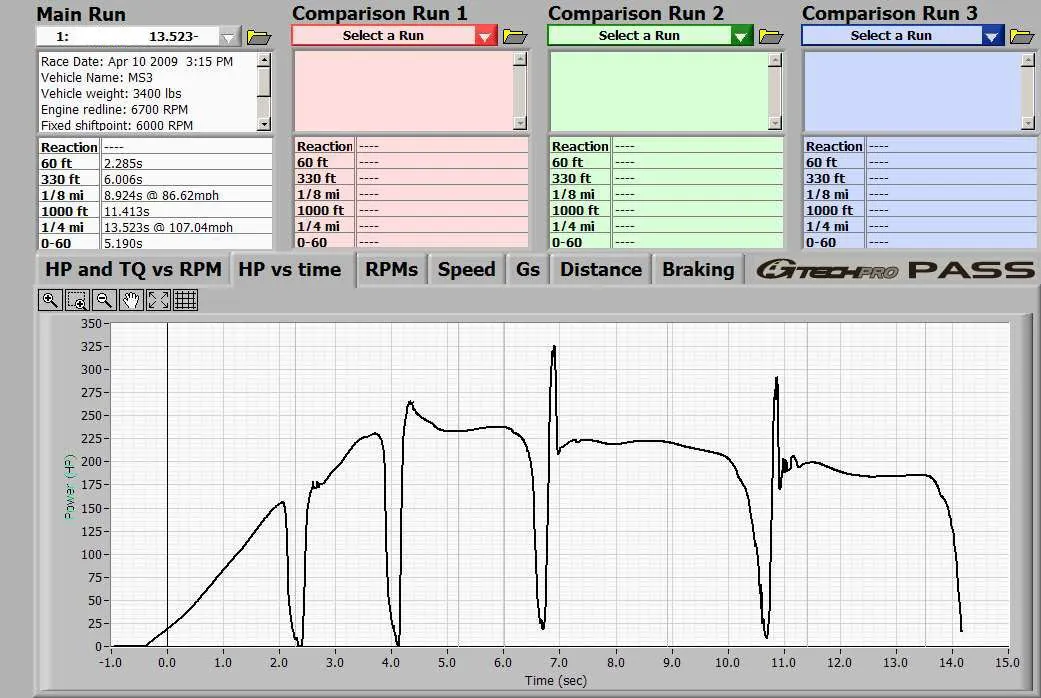

Here's some data from some typical runs in good weather back in April. Again, this is nothing much different than many others here with similar mods which can been seen in the posted time slips. Yeah, it shows traction problems hooking up in first and power shifts in third, fourth and fifth. Big, short duration spikes are electrical artifact (need better shielding of the wires to the accelerometer) and should be ignored.
Also, note that accelerometers measure under real world driving conditions and unlike a chassis dyno, show the powerful effect that aerodynamic drag has on pulling power down once you get above 60 mph. And it gets worse as speed increases.
BTW: You can replicate the time v. speed data manually and cheaply with just a simple stop watch. It's easy to do once you get into third and away from all the launch variables and have the ECU giving you full power.

Pretty normal actually for a good intake and opened up exhaust. Lots of guys running similar times. I'll try to pull up a slip and post. Best way to show all of the data, however especially 0-100 mph and other intermediate times, shift points and rpm relationships is with a good accelerometer that can also generate saved data and make charts from the data. The G-Tech Pro RR is very accurate and has been consistently within one tenth of a second of strip timers . It does read about one mph high on trap speed because it measures absolute quarter mile speed at the end, while the strip timers average the last 66 feet.
not sure if this makes a diff but it says your vehicle weight is 3400 lbs. its more like 4200. 325whp with what people put down w twice the mods....im a bit weary but no need to convince me. nice times tho. id like to see it on a track.
i believe it is about 3400 with driver but an great performance i agree on stockers.
You have to tell the accelerometer the actual rolling weight. Car weighs around 3200 with a tank of gas, but otherwise empty. I weigh 180, plus there's a little junk in the glove box, so I dialed in 3400. I think that's pretty close.
I also put 6,000 rpm in as my shift point, although I shift at a tach indicated 5,500 rpm. Since these are power shifts in the upper gears, and it take a couple tenths to actually complete the shift, that's probably an accurate number. It only affects the shift light feature, which I keep turned off anyway.
I dial in the roll out for 12 inches, which is very important to accuracy since that is pretty close to shallow staging at the strip and can affect ET's by several tenths.
Not trying to sell accelerometers. I just find that a good one, set up properly and downloading and studying the data is one hell of a good tuning aid.
BTW: Peak whp on the rpm v. hp run was about 270, occurring at the beginning of third gear, before it got pulled down by aerodynamic drag - the later tall, short spikes are just artifact that happens during the power shifts - I need to shield the wires better.
