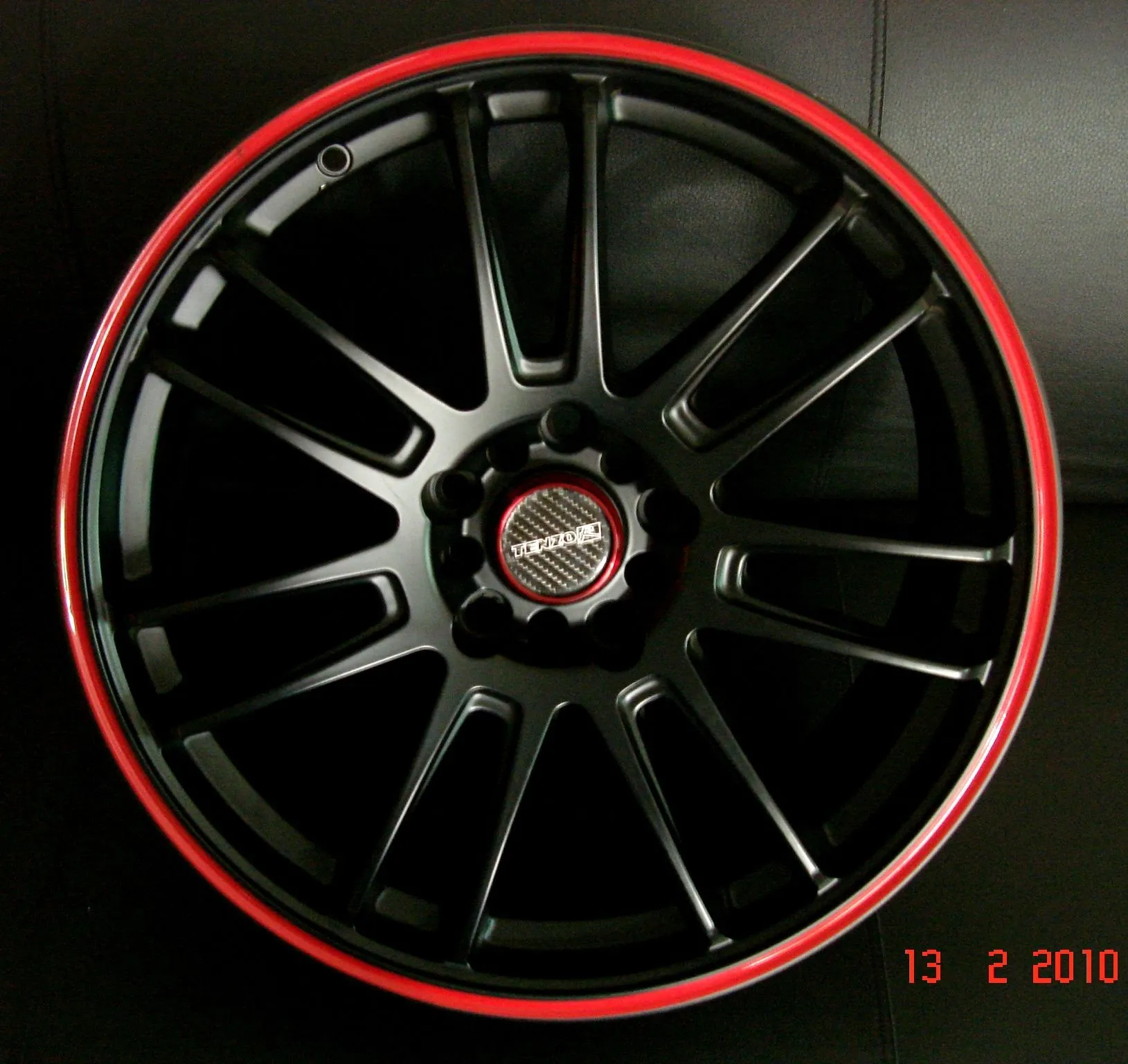

New Wheels
Today I bought 18 x 8 wheels for my 5. I will have to wait a couple of months to buy the tyres, here is a picture, hope you like it. (spin)
Thank you very much.. I'm planning to buy the tyres two per month, so I expect by April I will have them installed. It's my project.
