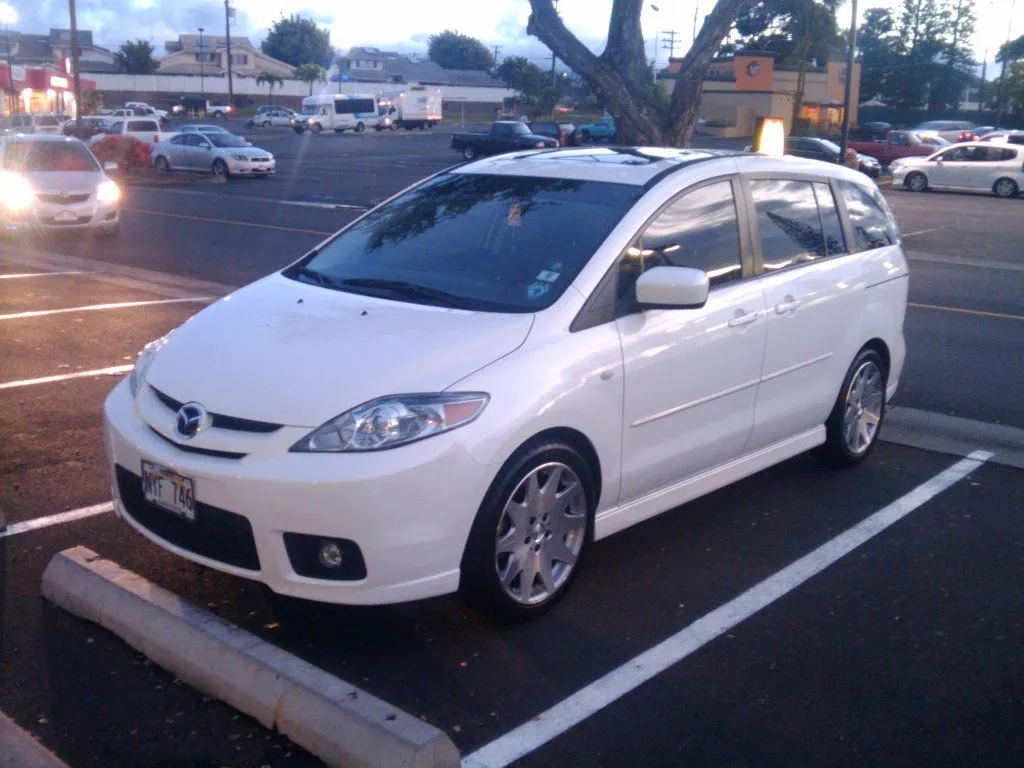

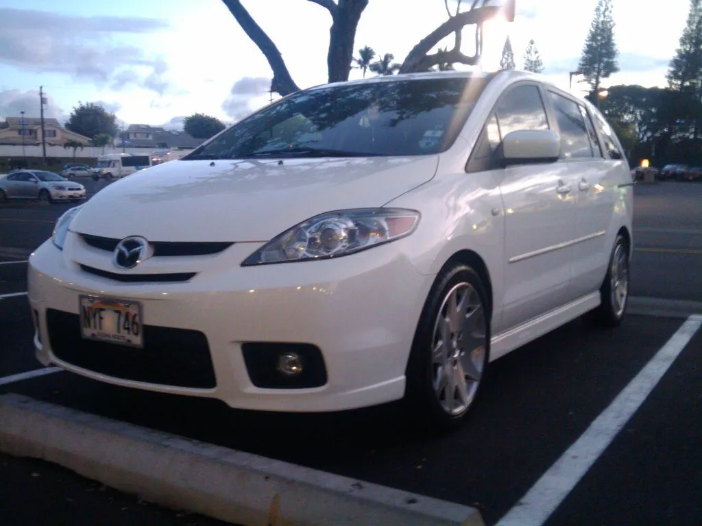

new photos of 18" mrr hr3's
Finally got more photos.... 18x7.5 48offset... 225-45-18.. no rubbing even fully loaded....

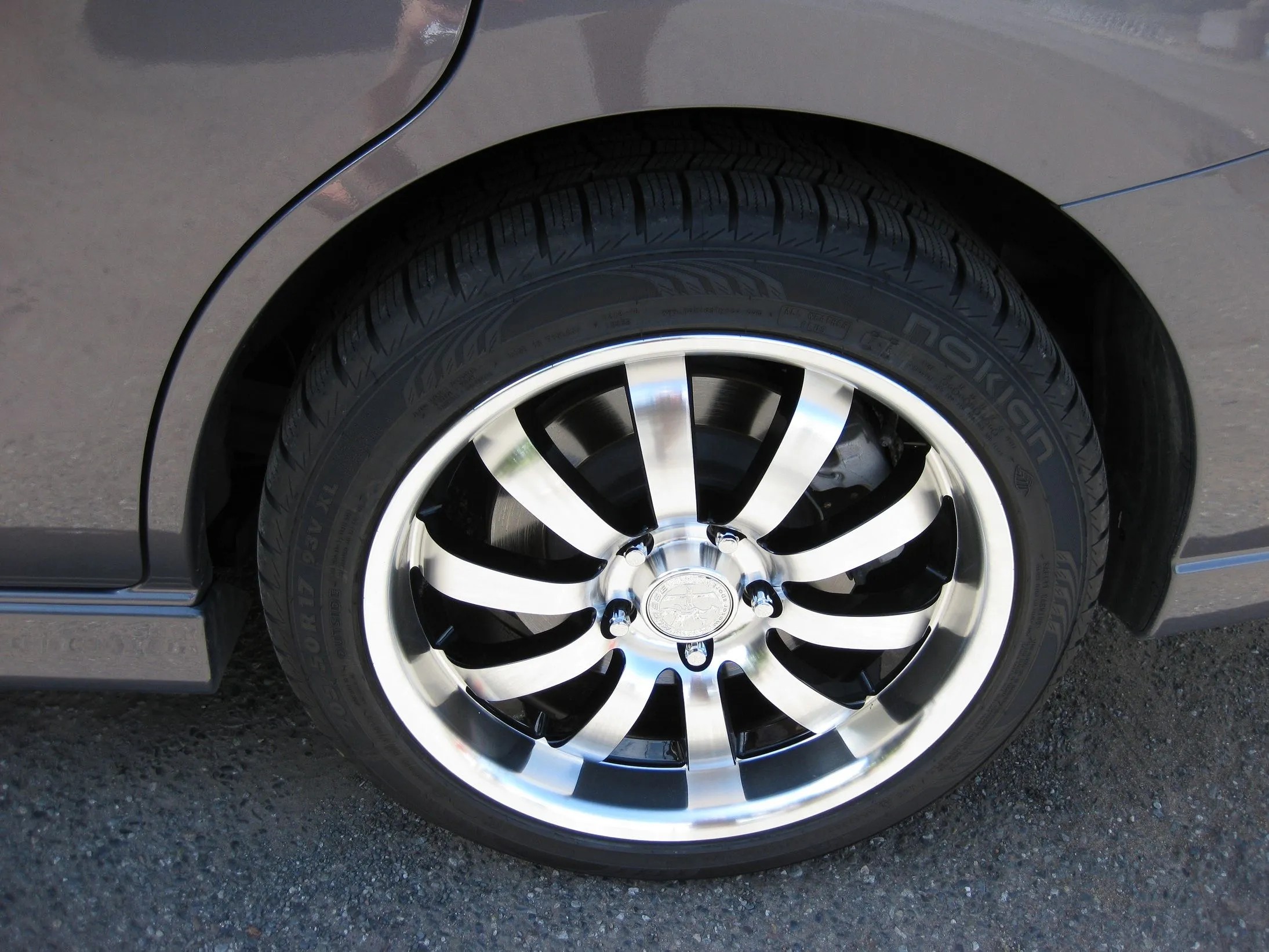

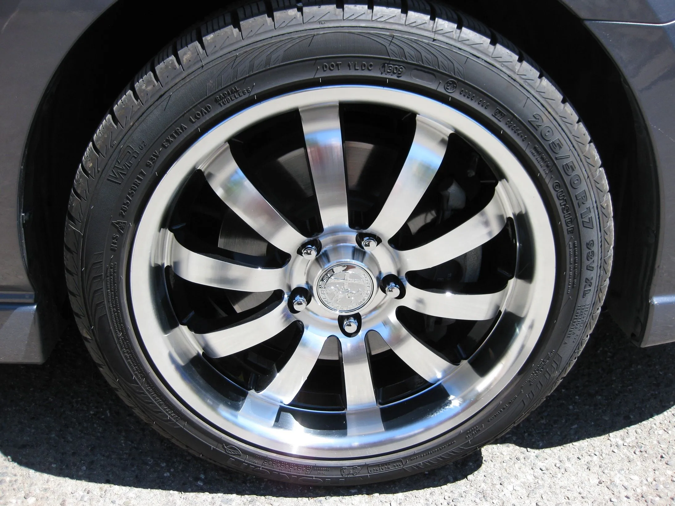

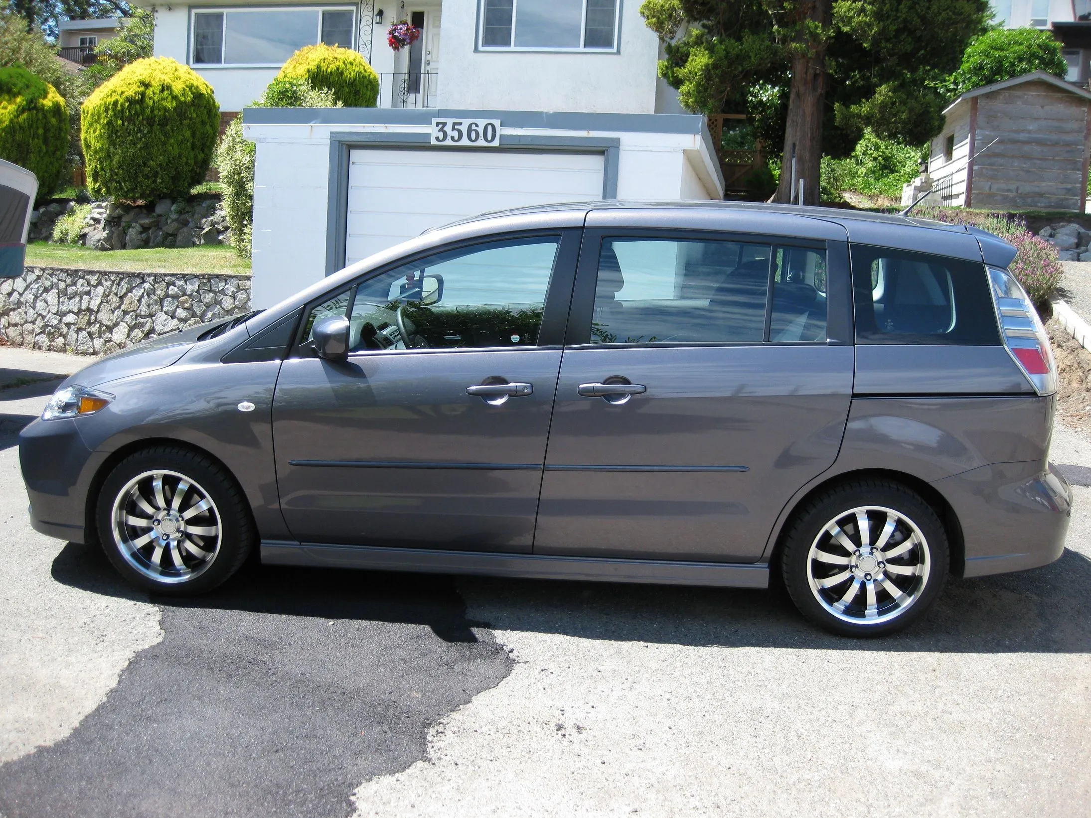

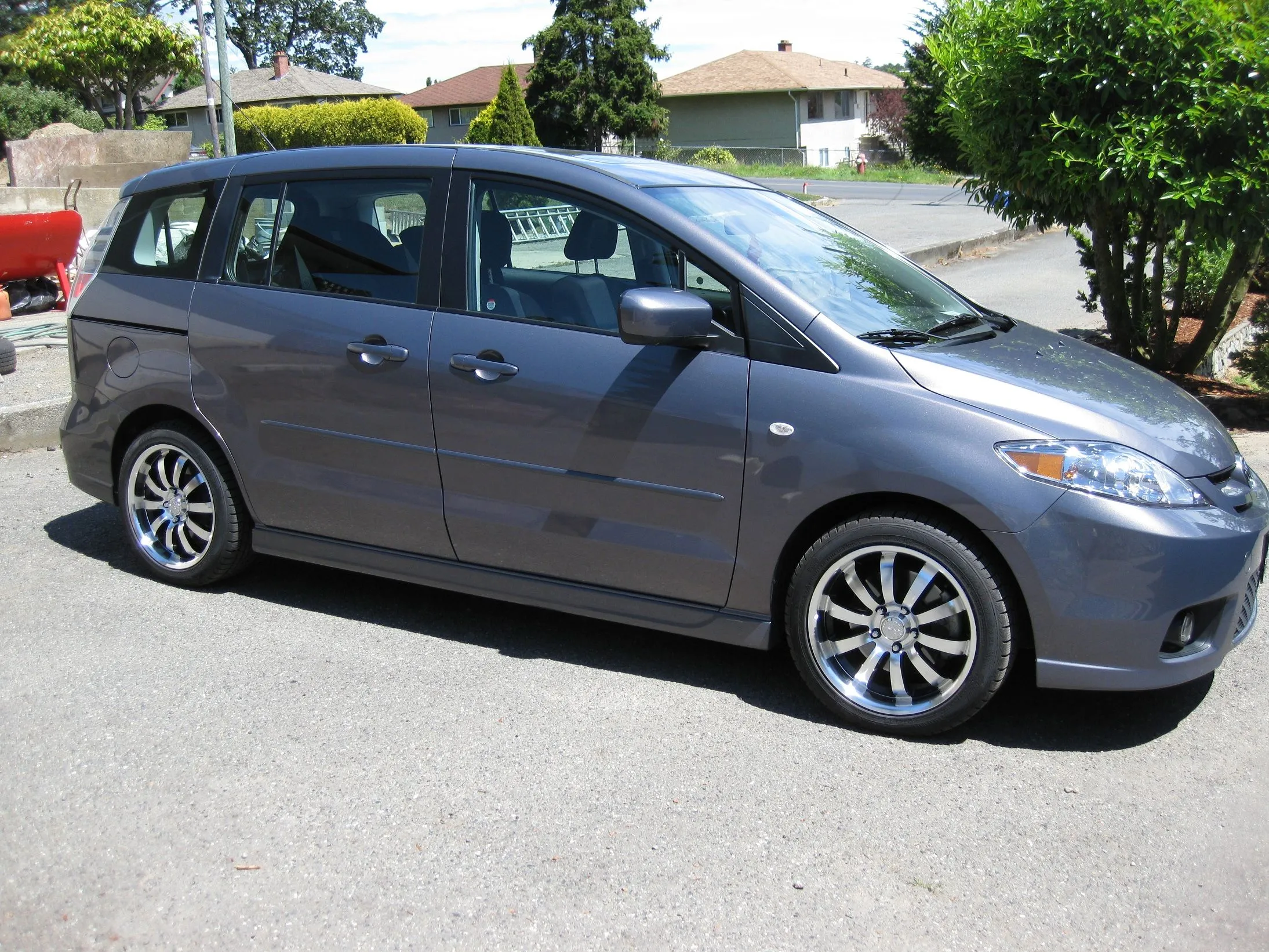

here's my setup 17" bonn wheels with machined finish and black on inside edge of spokes and inner face edge
mines a 07 sport touring
forgot to mention tires are Nokian WRG2 205/50r/17

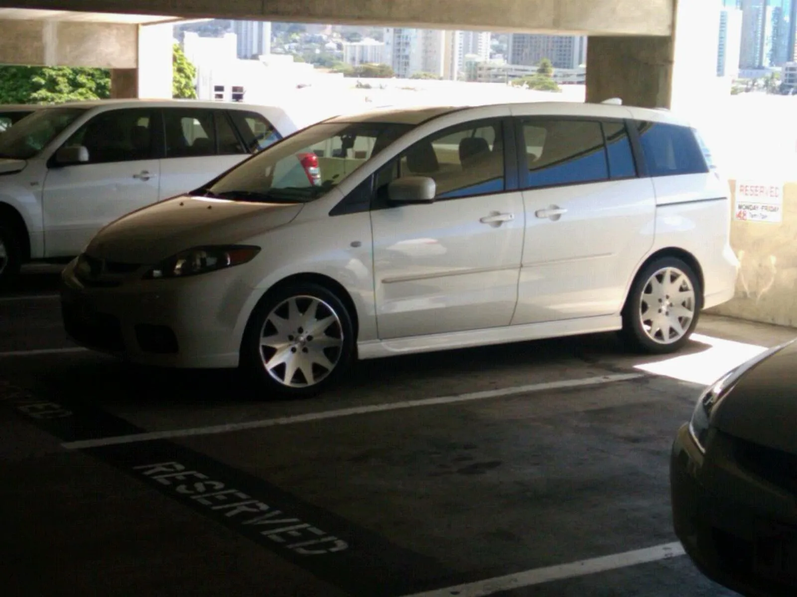

18x8.0 et 45 BBS replica
225/40/18
Dropped on :
Fronts - Progress springs (1.8"?)
Rear - Mazdaspeed3 springs (1.5"?)
I got the adjustable camber link but no need to use it since I didn't change the rear springs.
When loaded with 6 people and baggage, it is lower by1/2 inch but still no rubbing and I'm happy.
