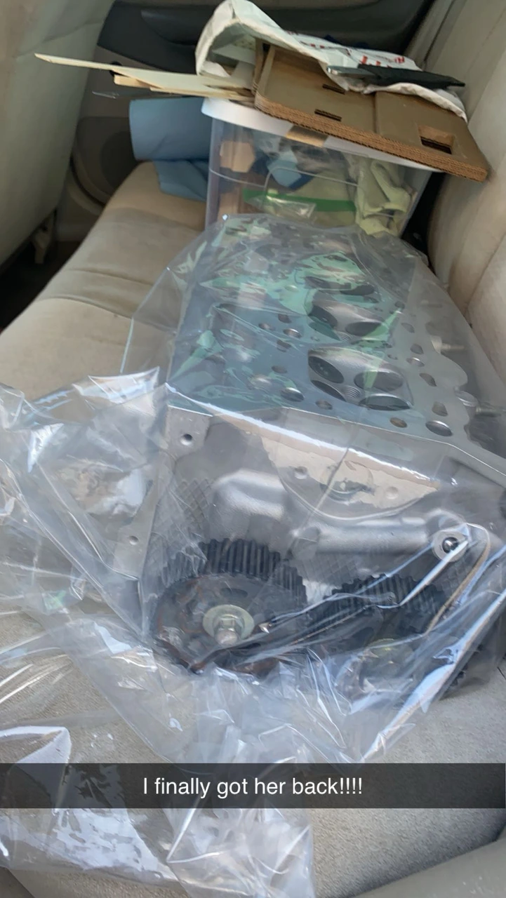

After pulling a fellow 1.6 from the Local pick’n’pull, I crossed my fingers and took it to the engine builder to have the block and head resurfaced, cleaned, and the block over-bored to 78.5mm.
After a rough 8 months, I finally got everything back and started scouring the internet and forums for every little scrap that I could find to guide me.

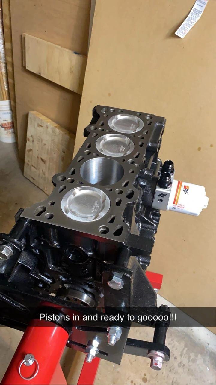

BLOCK:
- Decked
- Overbored to 78.5mm

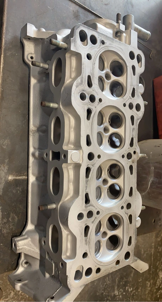

HEAD:
- Decked
- Valve job

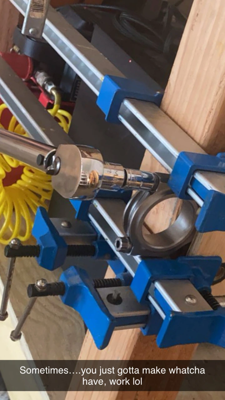

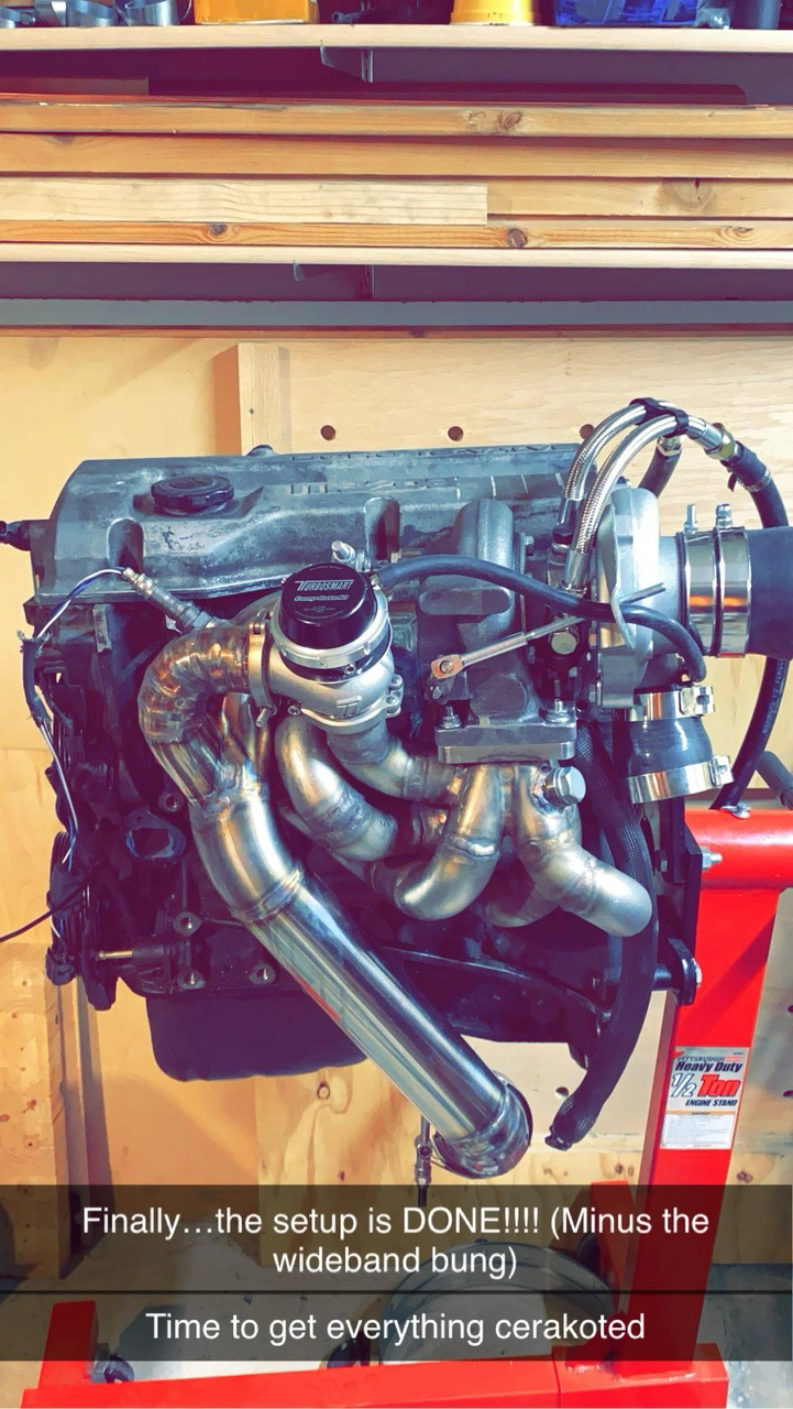

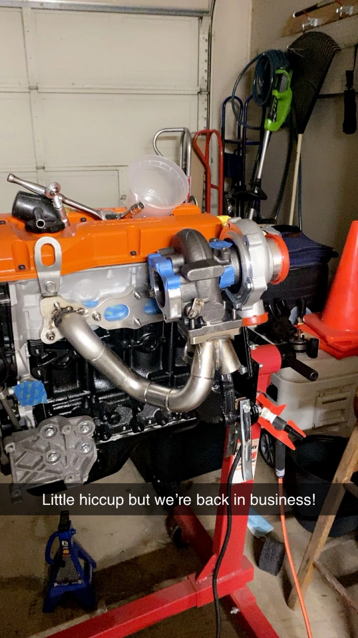

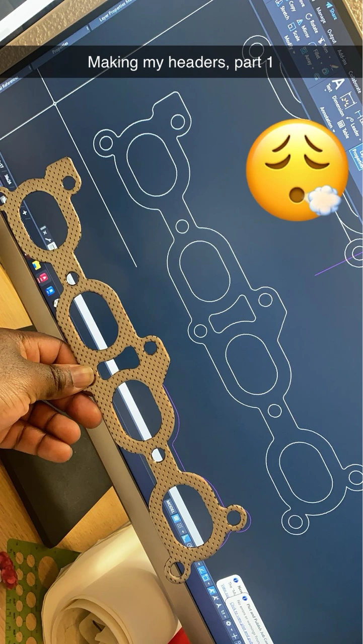

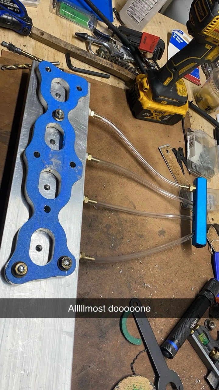

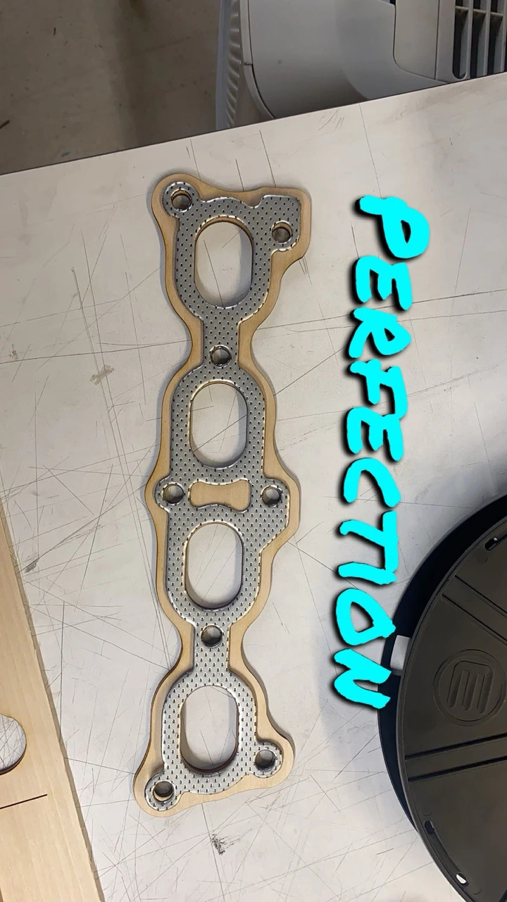

After getting the engine put together, I started tackling the turbo header, which was probably the hardest part. partially because it was new territory for me, partially because I tend to be a perfectionist. 😅
Thankfully I use a lot of AutoCad for school and various modeling softwares for school, so i was able to get into the swing of things a little easier.
I think that if I were to do another manifold I'd like to experiment with pulling it to the drivers side and relocating the battery to the trunk.

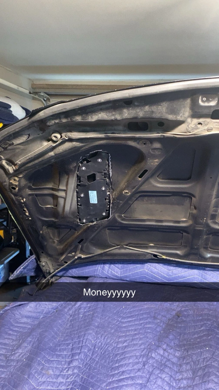

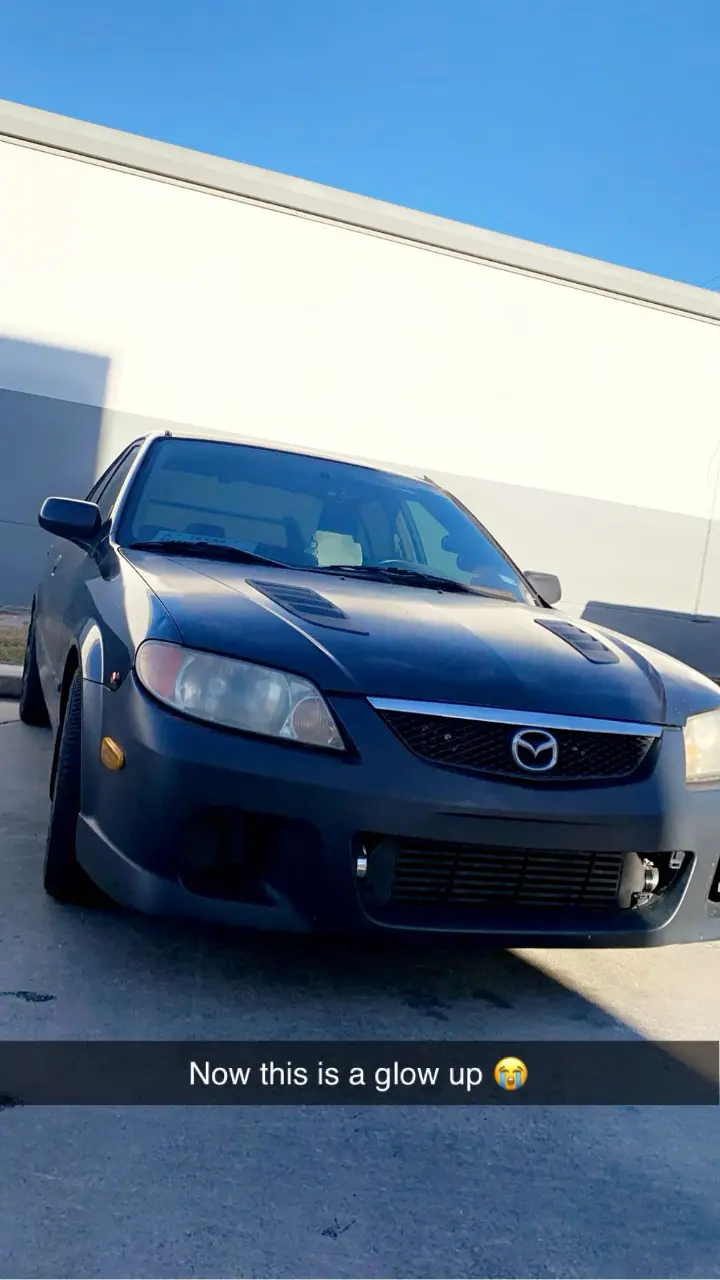

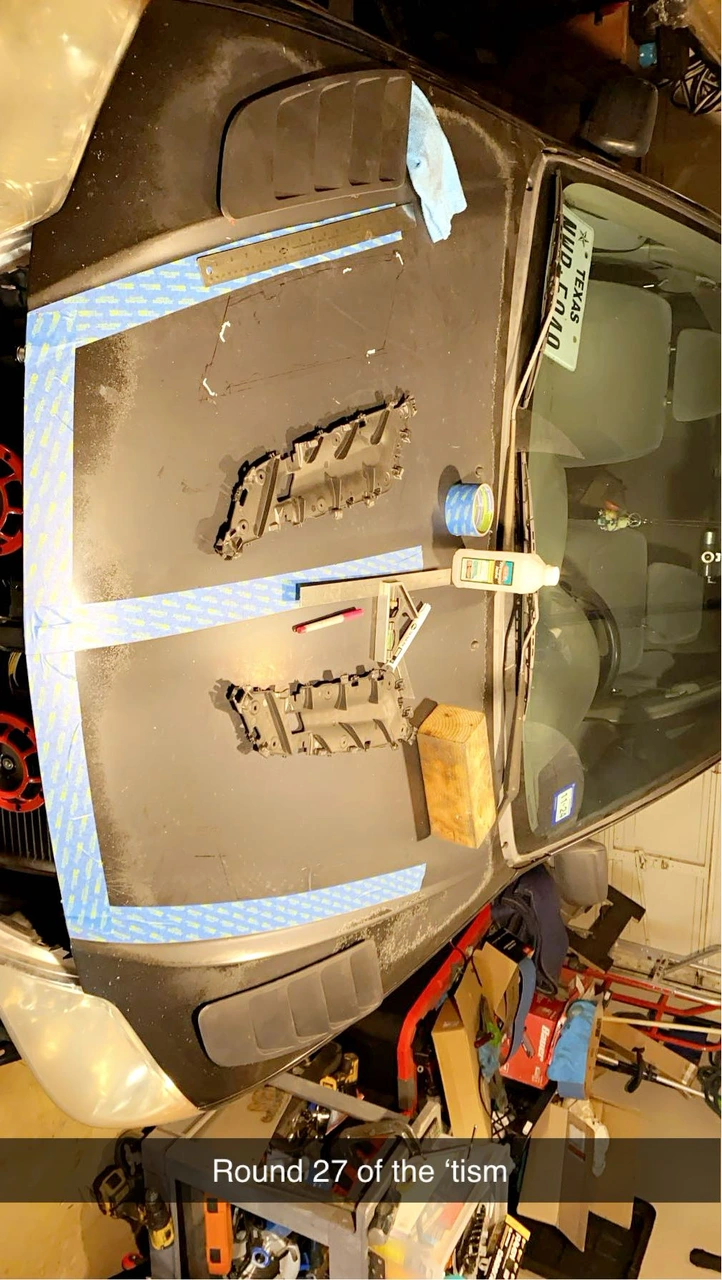

My most recent venture was deciding to install Roush Hood vents onto the Protege to help with the heat soak that I was getting underneath the hood. Response in the low end and high end has oddly felt better? Idk if there's any math or physics to this?
The only problem that I've run into so far was all because I couldn't commit to how permanently I wanted to bond them to the hood. After finally going the "safe route" of just using Ultra Black gasket maker, I found that the gasket had cracked along the outer curves of the hood and the vent had separated by only about a mm, but still.

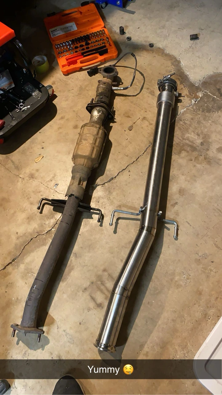

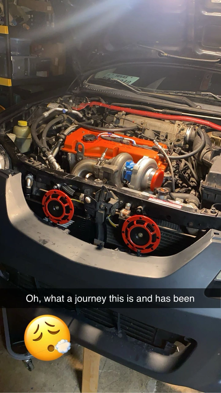

With that out of the way, I spent the past week getting over the fear of commitment and started getting the turbo on the car and finalizing the exhaust.
True to car build fashion, things started going a little sideways. The dump pipe was just too close to the fans to get it routed to the bottom of the car. I wasn’t willing to get rid of the passenger side fan, and I wasn’t willing to cut a hole in the hood because I just didn’t want to. I was tired of cuttin holes grandpa.
So, I got to work on routing the dump into the downpipe.
I was doing great, between the constant back and forth of fitting things on the car and taking them out again to check measurement, I thought I finally was sure of the fitment.
NOPE.
I cut the hole for the dump…somehow…a good 1/2” off target. Granted, it was 3am and I’d been pulling consecutive 2am work nights and getting back up by 6am to go to work, I should’ve known to stop and revisit the morning. Instead I found myself hacking the downpipe back apart to replace the bad section.

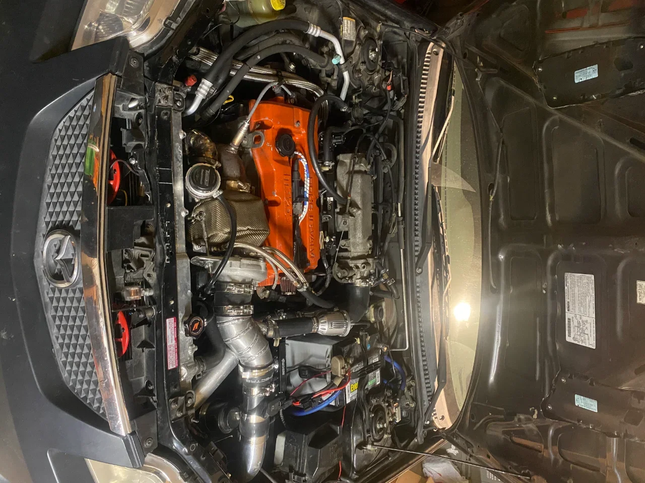

Which brings us to tonight. Finally finished welding everything up, I got everything on the car, loaded the SuperMapStock file and primed the turbo and engine. I crossed my fingers and fired her up.
Only to see she was running 24.22 on the afr gauge. 🙃
Long story, short…I forgot to run the catch can line back to the nipple on the manifold. Huge vacuum leak for the win.
Second start up and…SHE RAN LIKE MELTED BUTTER ON PANCAKES.
Took her out for a test drive and maaaan….i forgot how nice it is to be in a car that can actually accelerate. At 5psi, and staying under 7k rpms, the difference is night and day.
No leaks (I’m lying) and no weird noises…I can’t even relay my excitement.

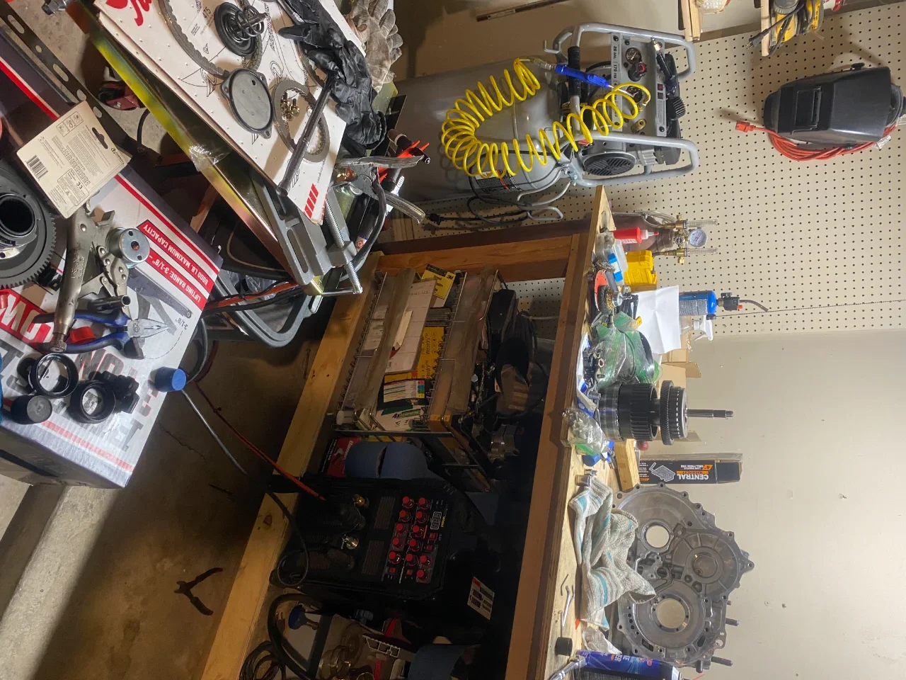

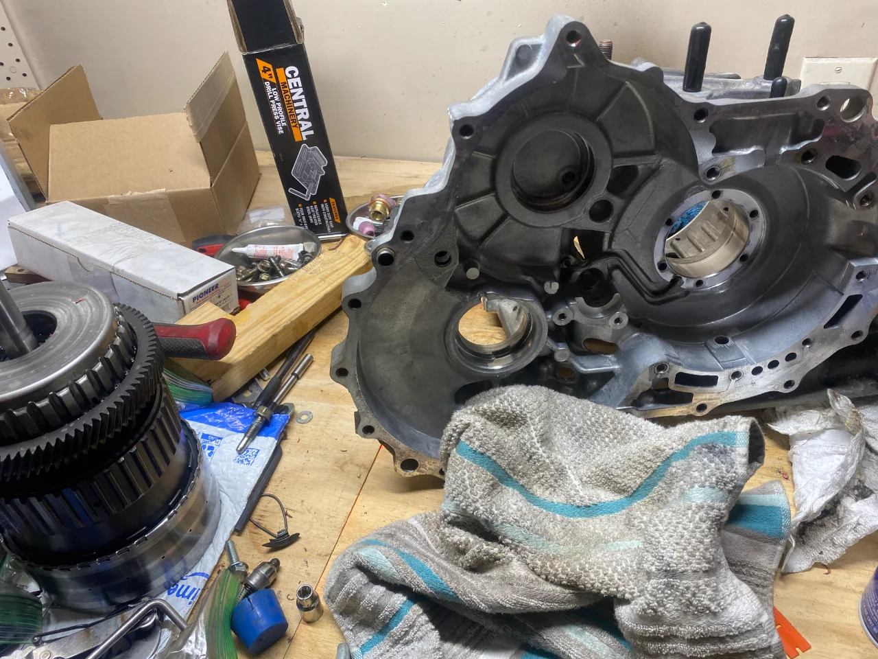

Annnnd I broke it. The stock transmission absolutely loved the 12psi...until it didn't. Heard a lovely bang from the engine bay while attempting a pull and now she's living comfortably in 2nd gear, forever. Welp, good thing i was already going to rebuild the spare transmission. Engine is still running great over a year later and the transmission lasted about 9 months after boosting it.
SSAFC has actually been pretty stout and I was able to get a Radium Fuel rail for the NA Mazda Miata to fit using some custom brackets I got cut and bent using SendCutSend. Waiting until i get the Haltech 1500 to put on the Fuel Injector Clinic 650cc's on to the car.
Until then, the spare caing is nice and "mostly" clean and the new friction plates just came in from REMCO!
