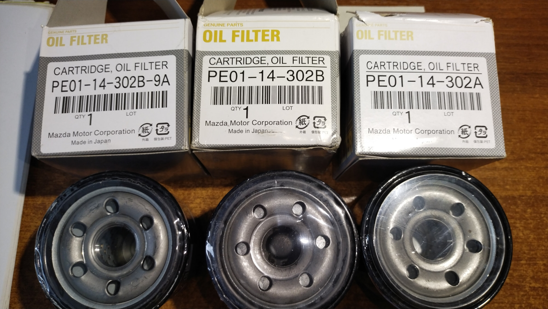

I was looking at oil filter prices today, and it appears that the Japan filter is now less money than the Thai filter. But they are calling the Japan filter PE01-14-302B/302A. Not sure why there is a slash 302A in the description. Anyway a pack of 10 Thai filters is $123.99 and a pack of 10 Japan filters is $68.07 which seems too good a deal to be true:
Thai filters
Japan Filters
Thai filters
Japan Filters

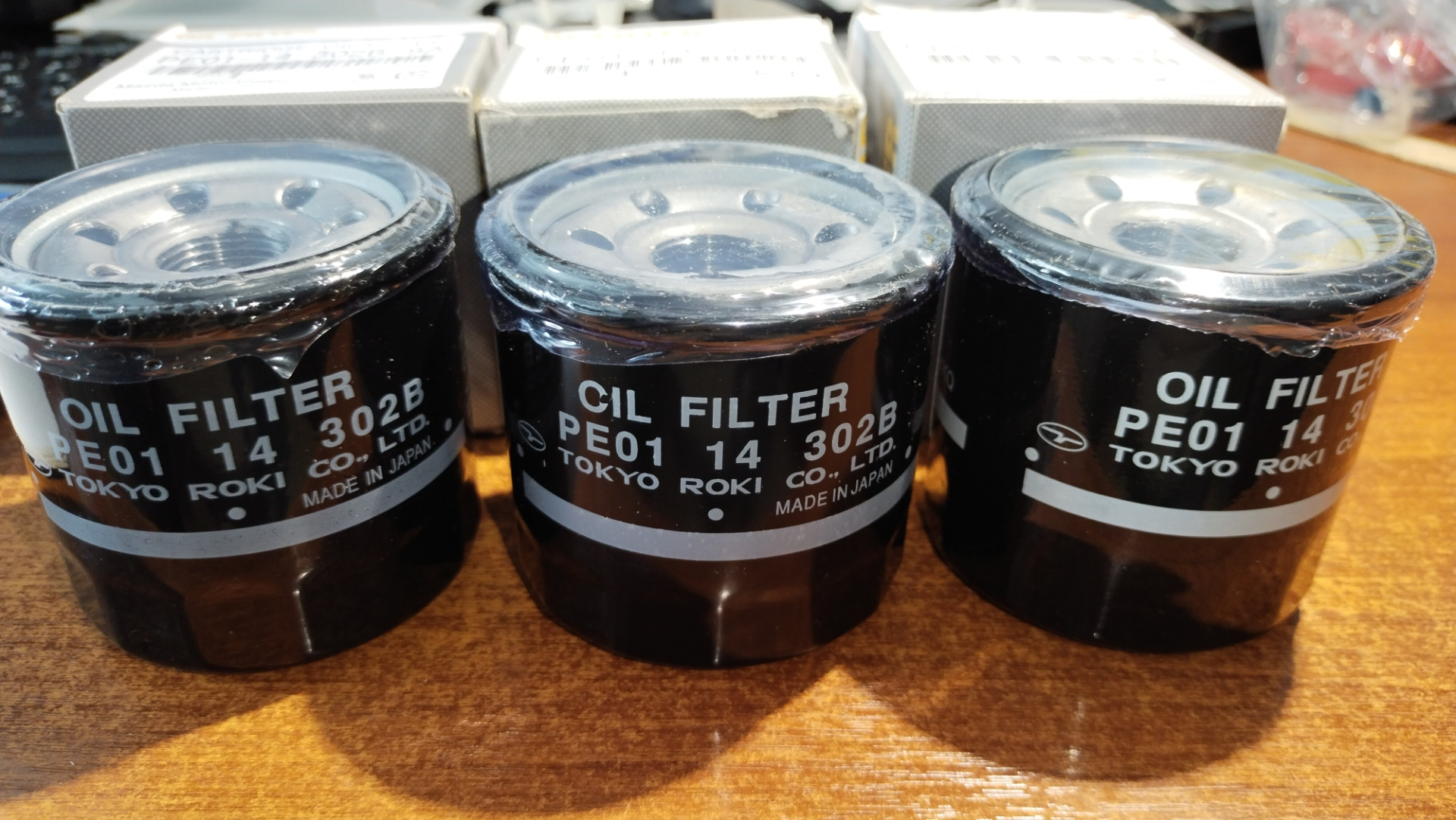

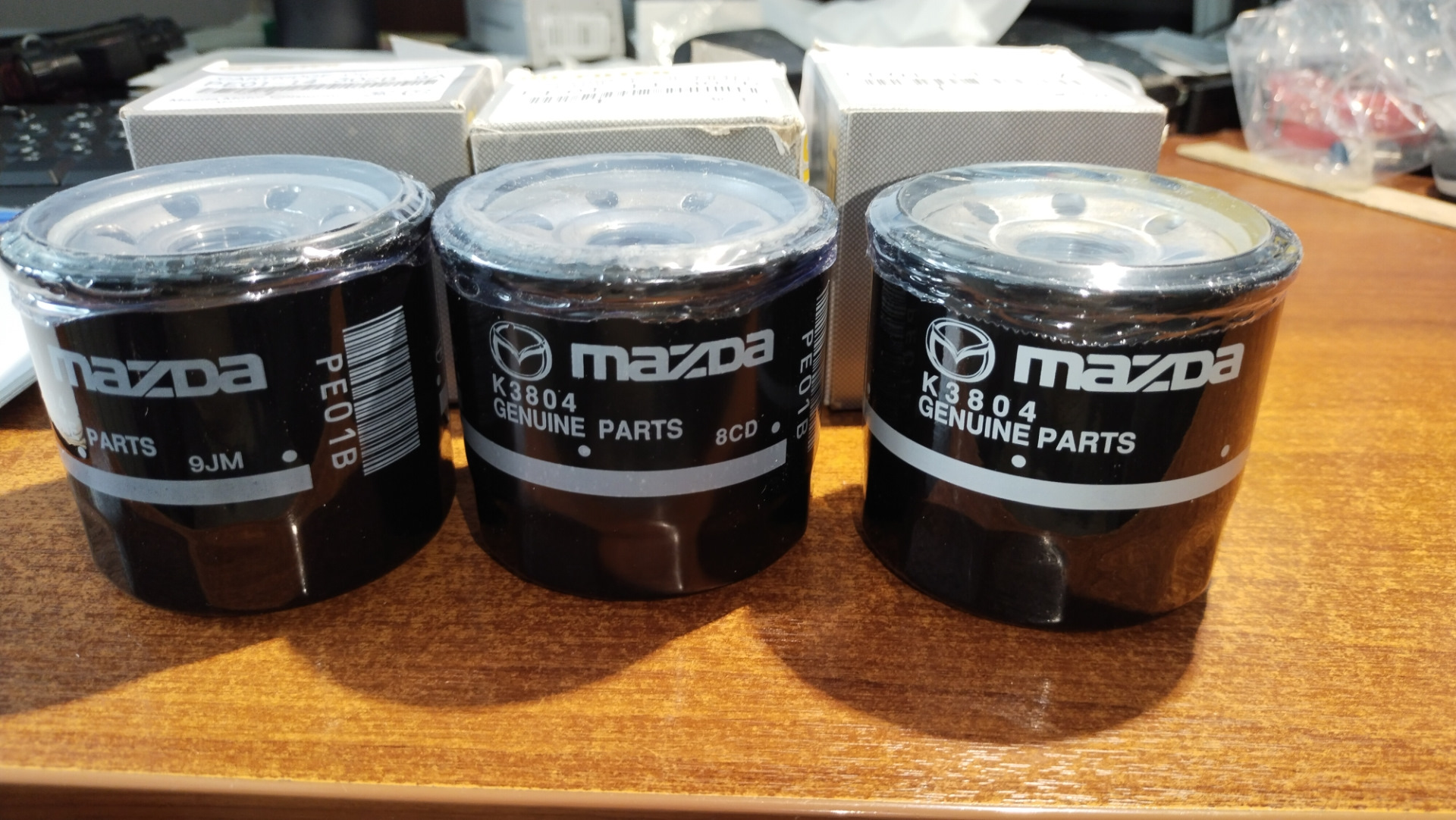

fake... ebay is full of them
real ones look like this, and do cost about $10 a filter
when it's too good to be true, it usually is!

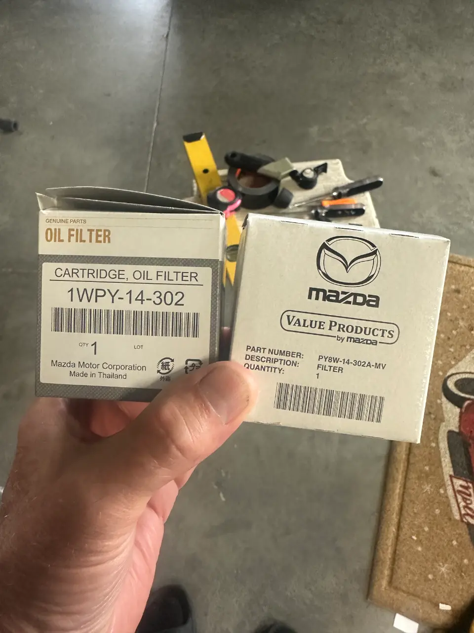

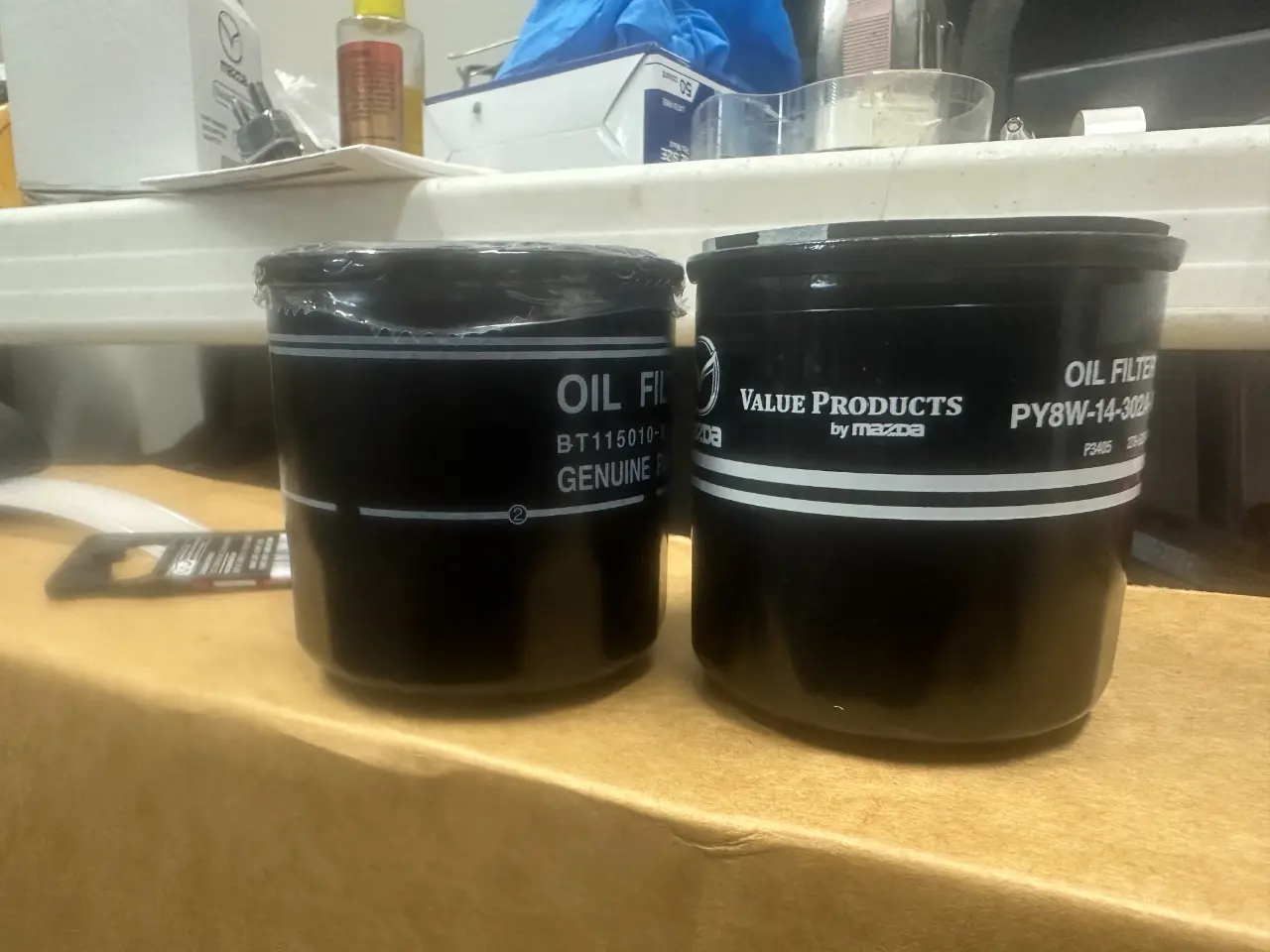

Both bought at the Mazda dealership...the Value product is made in the USA I got a $30 gift card from my Mazda dealership and went in and bought filters with it..they said they only were carrying the value products now.....
they can say whatever they want... typical stealership scum
I can assure you the much better Denso made 1WPE filters are still very much available... while the value line filters might be "approved" by mazda, they're inferior in construction in every way... my dealer pushes the hell out of those and only keeps a couple of 1WPEs in stock, for warranty claim purposes and for the picky ones like me who will buy them (I don't: I imported a bunch of PE01s years ago)... they're basically half the price of the 1WPEs, especially now that with the tariffs the prices of the 1WPEs will eventually go up because they're made in thailand, and there's higher tariffs applied to thai stuff than japanese stuff (makes you wonder if mazda USA will go back to PE01s here once their stock runs out)... so this means, they can make much more money off oil changes, using cheap crap 0W20 tanker truck oil from wherever is cheapest... the value line used to be made in mexico, but if they changed to USA, it doesn't surprise me
if you don't care, like many typical car owners don't, the value line filters "work fine"... just don't count on them to do much good beyond 5000 miles, which is what most plebs change their oil at... if you're lazy/"ecological" like me (using the "flexible" oil change reminder setting) and try to get 7500 to 10000 miles between changes, then you'll want a better filter and oil (using the expensive legit mazda 0W20 with moly)

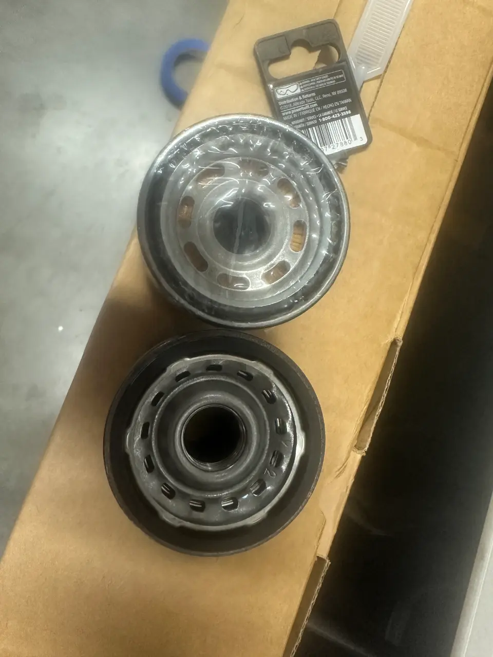

as for the filters, those new "USA" value line PE01/PY01 filters appears to be made by honeywell... the design looks too familiar lol... the old mexico made ones had lots of issues with leaks apparently, and people on the BITOG forums have said that the contact surface area of the gasket isn't as wide as the ones on the 1WPE/1WPY or good japanese PE01/PY01 filters, since those round o'rings squish down and spread out once pressure is applied on them... coupon or not, I would've walked away from buying those filters, get them elsewhere, or just buy WIX if I'm in a quick need for a filter and call it a day lol
on a side note, subaru america used to sell the japanese made filters off and on over the years and they last sold them about 17 years ago and switched to the honeywell ones... they're so much more crappier, and the price difference wasn't big back in the days... I haven't cared to look into those filters since then since I don't own a subaru, but I heard that during the "drought" years of selling non-japanese made filters, there were all sorts of issues with them... no doubt to me because of quality issues and the fact that subarus run higher oil pressures than most cars to begin with
