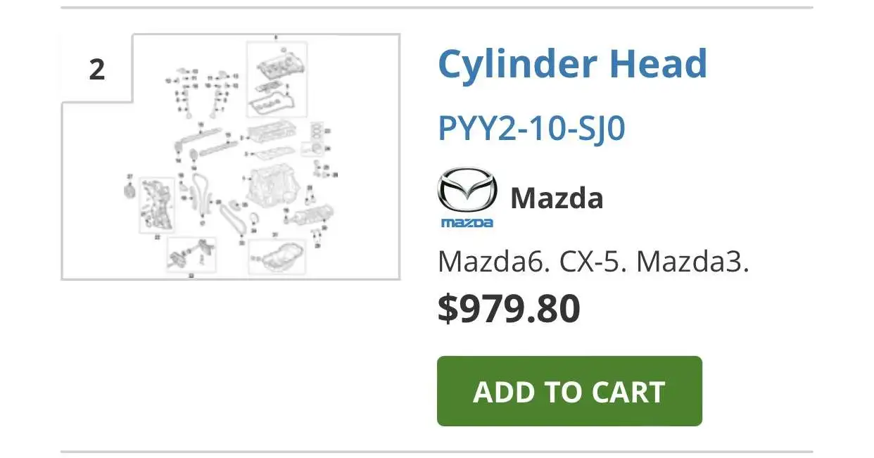

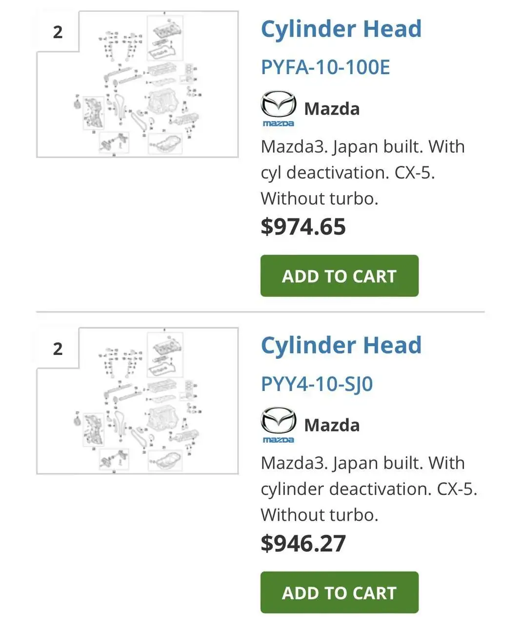

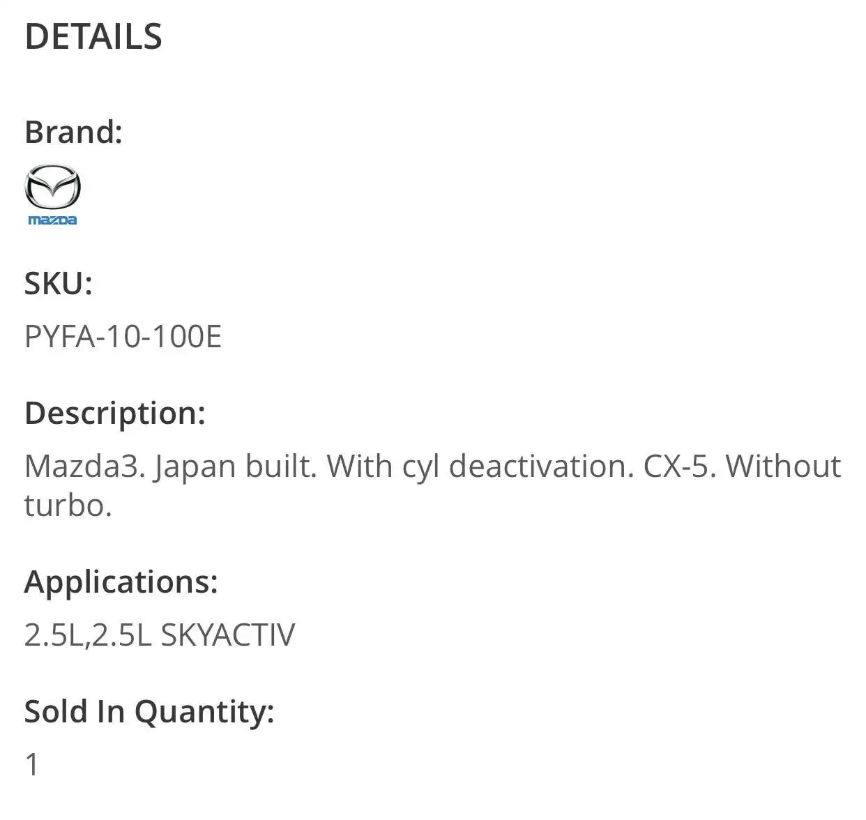

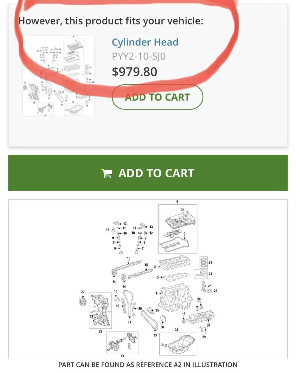

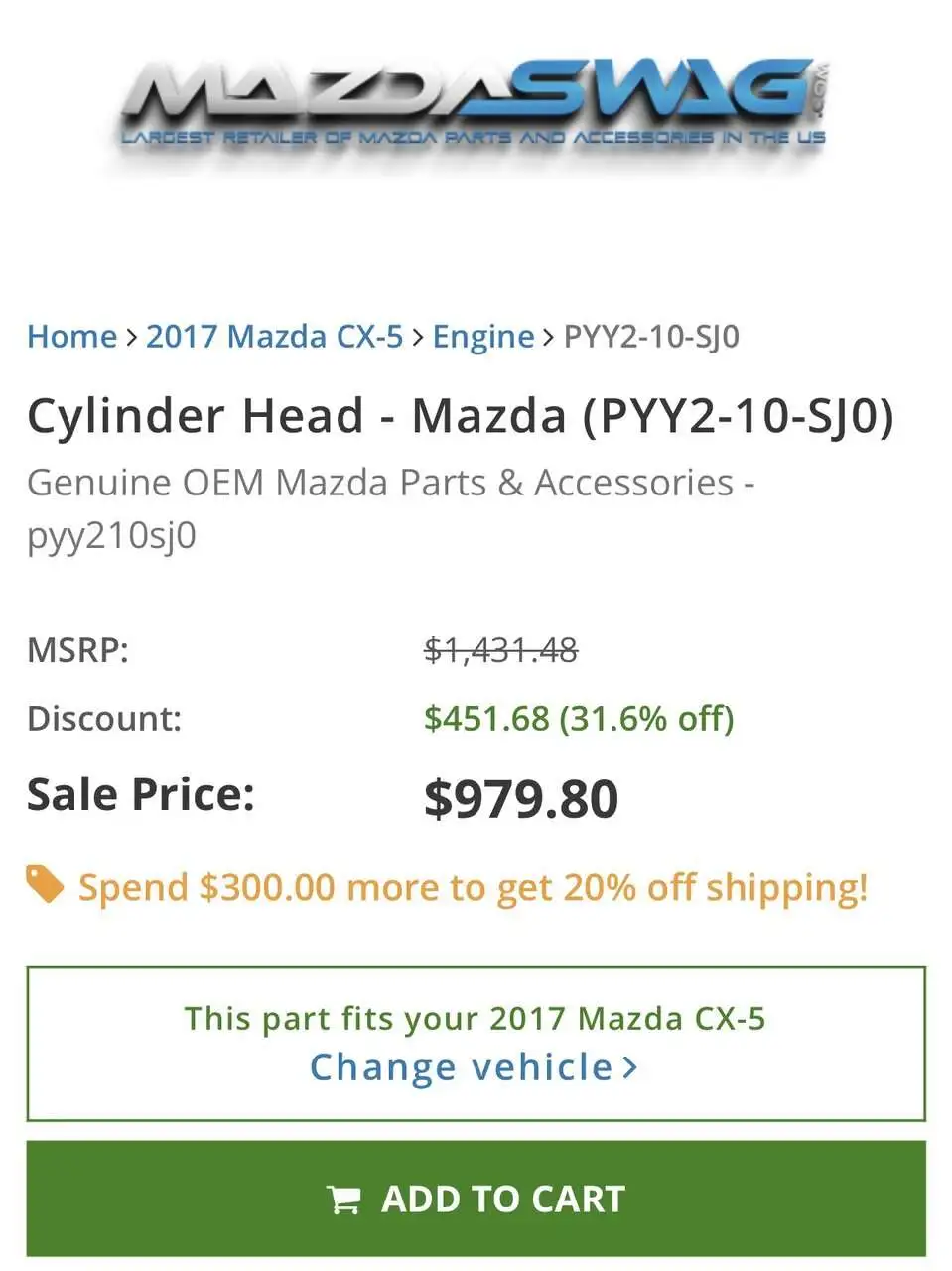

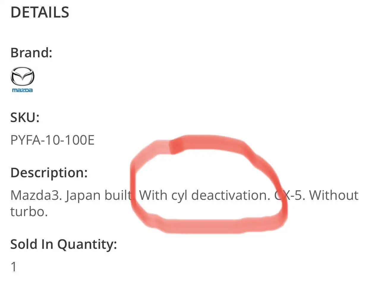

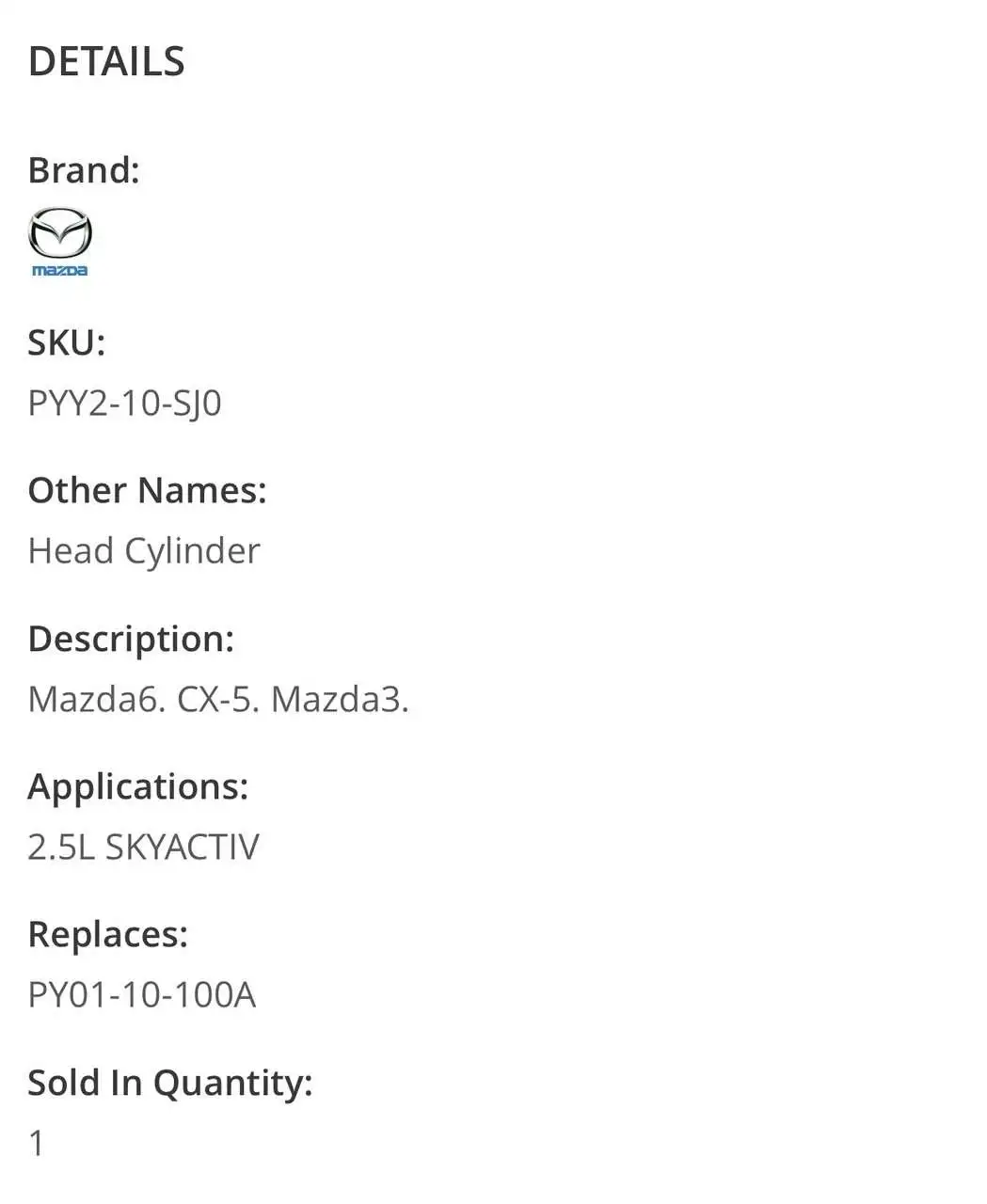

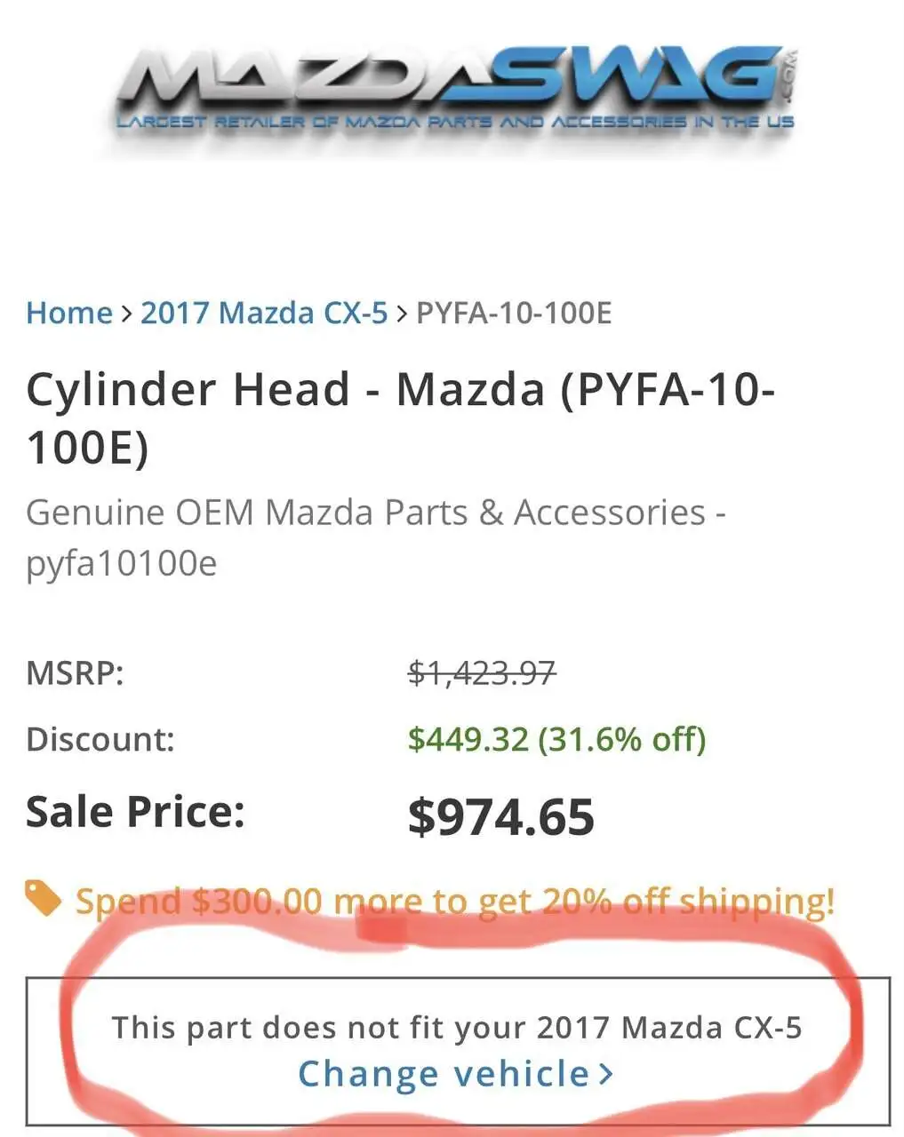

This’s incorrect. PYFA-10-100E is the cylinder head with cylinder deactivation. There’s no way the cylinder head is interchangeable between the 2.5L NA with CD and without CD as explained above.
Cylinder head PYFA-10-100E is for 2.5L NA with CD:

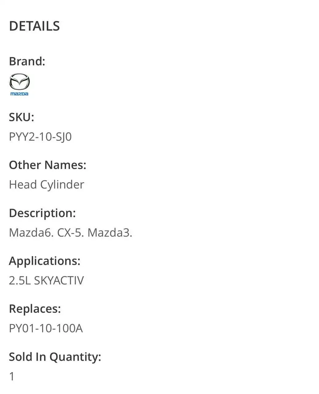

Cylinder head PYY2-10-SJ0 is for 2.5L NA without CD:

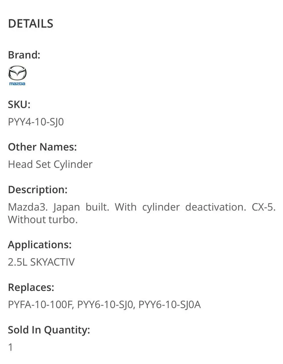

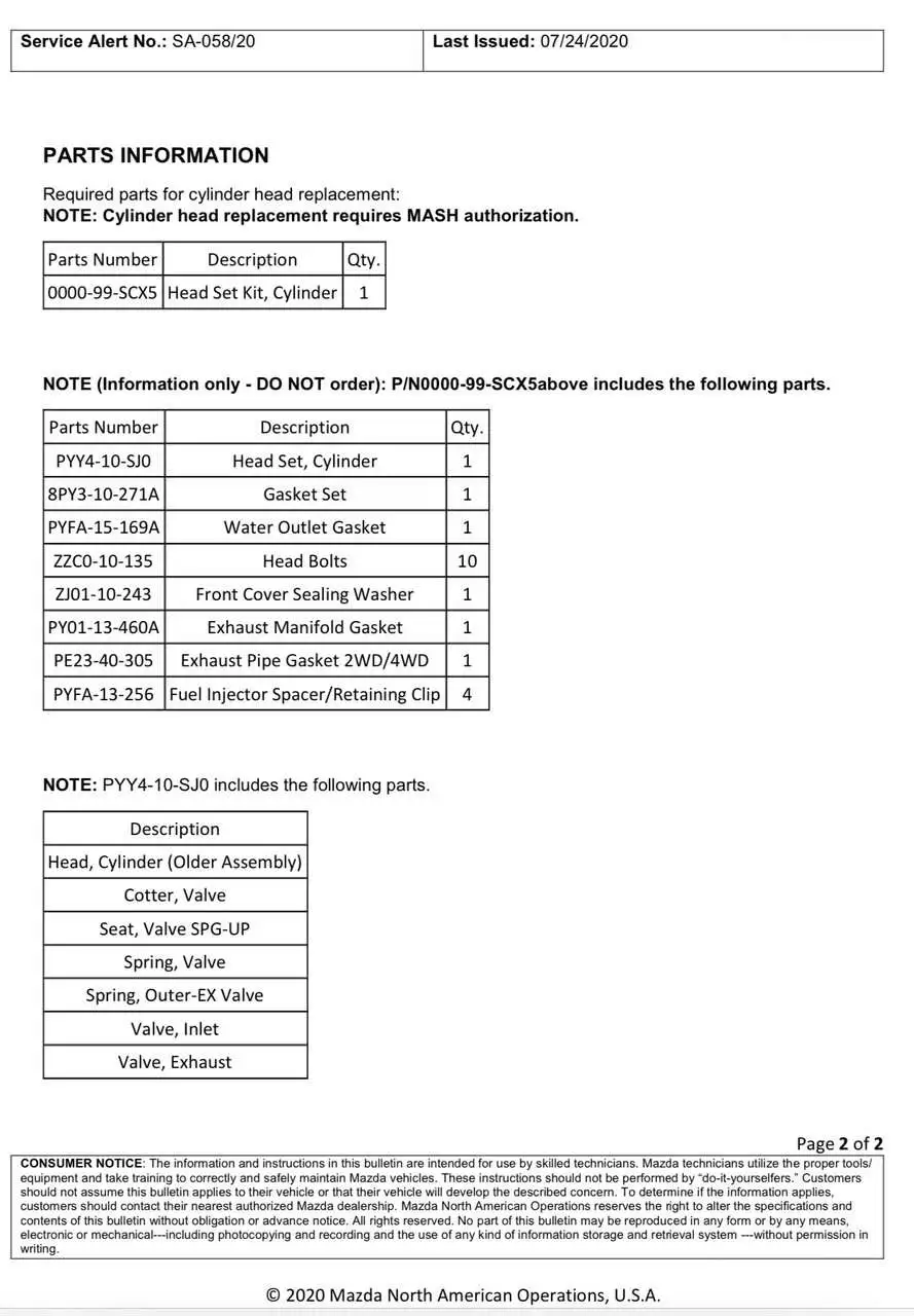

So if the head is cracked on a 2.5L NA with CD, dealer needs to order a cylinder head set kit p/n 0000-99-SCX5 which included a “loaded” head PYY4-10-SJ0 and all other necessary gaskets and washers to replace the cracked head.
No, PYFA-10-100E is only for 2.5L NA with CD, see above.

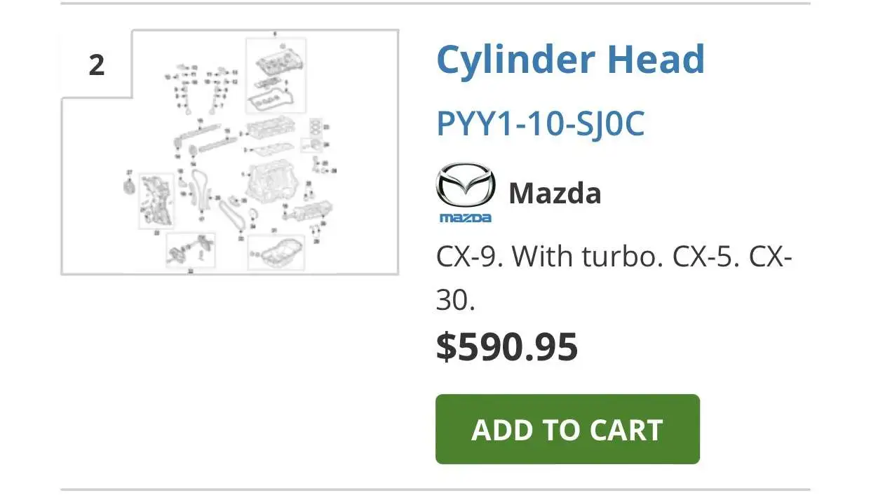

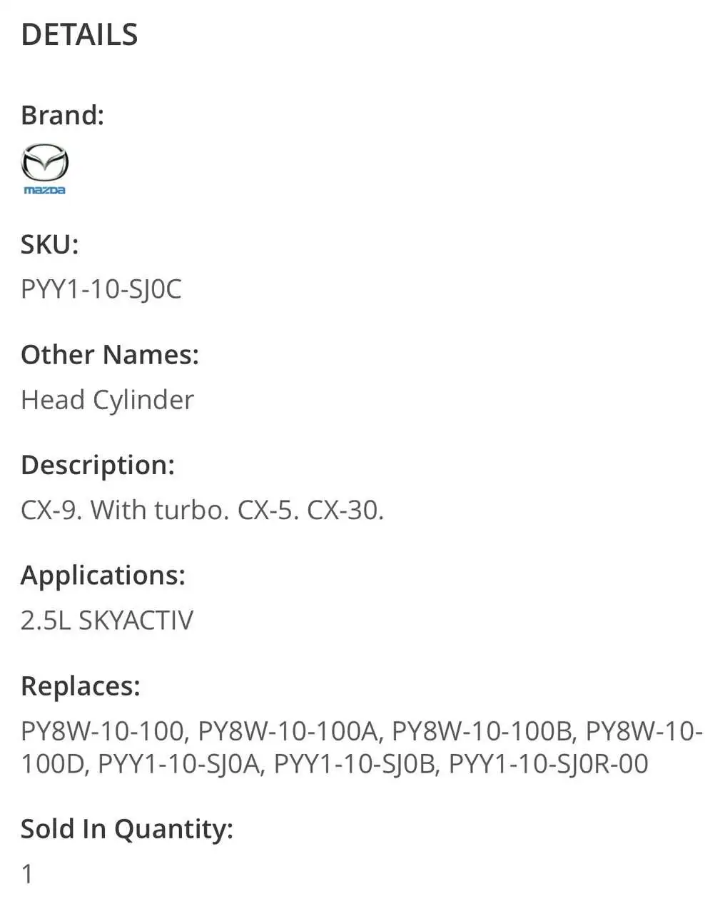

Does anyone know if the 24 turbo has a different head than the NA version? I've read turbos don't have CDA.
2.5T has different cylinder head due to added turbo plumbing. There’re 3 different cylinder heads for Mazda’s 2.5L series.
The cylinder head for original 2.5L NA without cylinder deactivation has p/n PYY2-10-SJ0.
The cylinder head for later 2.5L NA with CD has p/n PYFA-10-100E. However, there’s a “loaded” head PYY4-10-SJ0 for easy head replacement to save labor cost; and p/n 0000-99-SCX5 further includes necessary gaskets and washers with the loaded head to replace the cracked head.
Finally, the cylinder head for the 2.5T has p/n PYY1-10-SJ0C which of course is the latest updated version to prevent head crack. There’re many revisions for turbo head, PY8W-10-100、PY8W-10-100A、PY8W-10-100B、PY8W-10-100D、PYY1-10-SJ0A、PYY1-10-SJ0B、PYY1-10-SJ0R-00, and then the current one.
