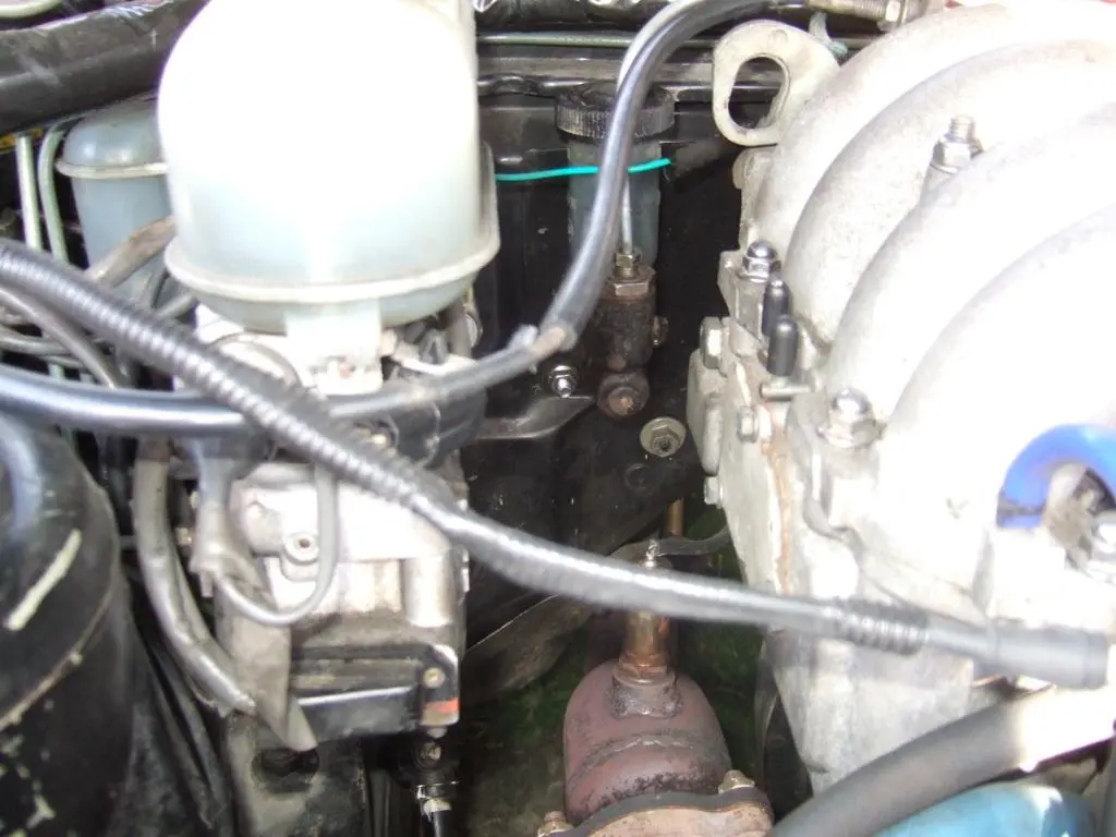

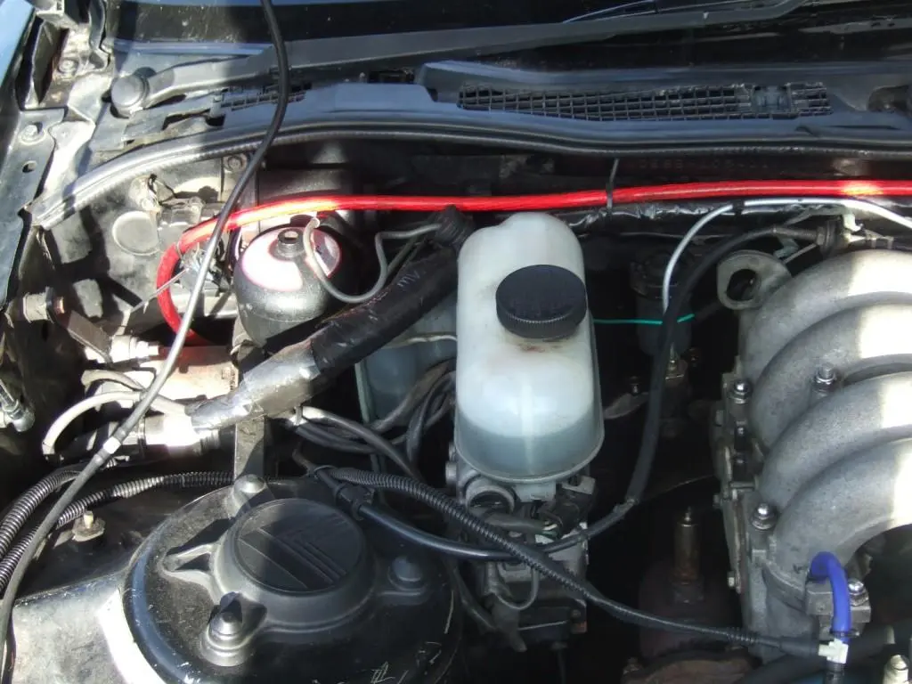

hey guys my cosmo has had the manual swap done as well.
fc box and clutch master and slave cylinder.

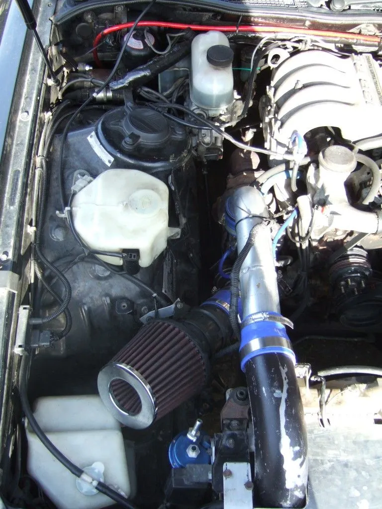

I had to fit a plate on the fire wall to spread the load of the master cylinder as it had started to crack from the stress, as it wasnt designed to have a clutch mounted on it.

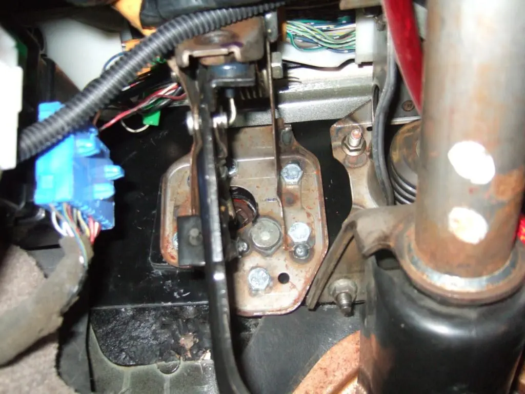

i fitted a pedal box from a MX5, as the clutch pedal is separate from the brake pedal, and is the same length as the rx7's, the only thing i am not happy with is the pedal sits a little lower than the others but thats a easy fix that ill do in the next week or two.

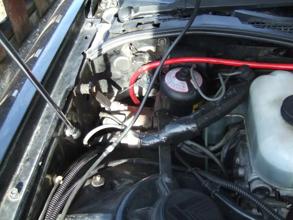

for the ABS unit all i had to there was shift the pump to the other side which freed up lots of room and stopped the master cylinder hitting the inlet manifold.
hope this is of any use. i can post pics if people wont to see.

heres somes pics, sorry for the delay guys ive been helping my mate put a new clutch in his rx7.
the plate on the inside goes right across the brake master cylinder mounting area aswell.
to mount the pump i had to move the radiator over flow tank. but i was able to shift the pump with out having to cut any wires or make new brake lines.

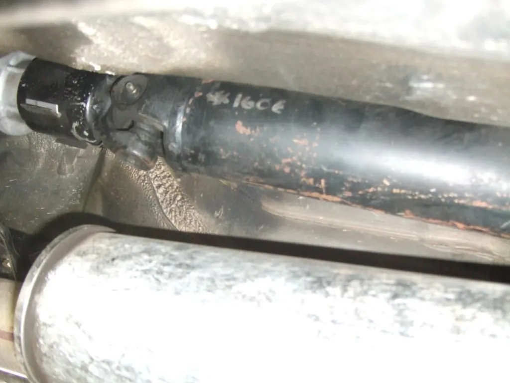

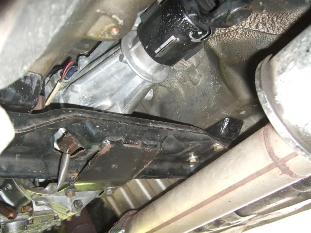

the drive shaft will have to be made up, so you will need the yoke (front end ) off the FC drive shaft and cut the front end off the cosmo one to suit and get it all balanced. for the cross member i had to make up some spacers to drop the cross member about 25 mm and then a plate was welded on to it to meet the FC box mounts.
ill try get a under car pic.
the cosmo motor will of course be a auto motor and have a counter balance on the crank shaft so you will need a flywheel that doesnt have that built in and bolts to the weight, i thought most manuals came with the counter balance weight built into the flywheel, but i could be wrong.
you could just take the balance weight off and fit a weighted fly wheel but i thought they crank, rotors and weights were a blananced set and kept it as is.
the drive shaft is a two piece unit still, i couldnt fit it all in the photo.
