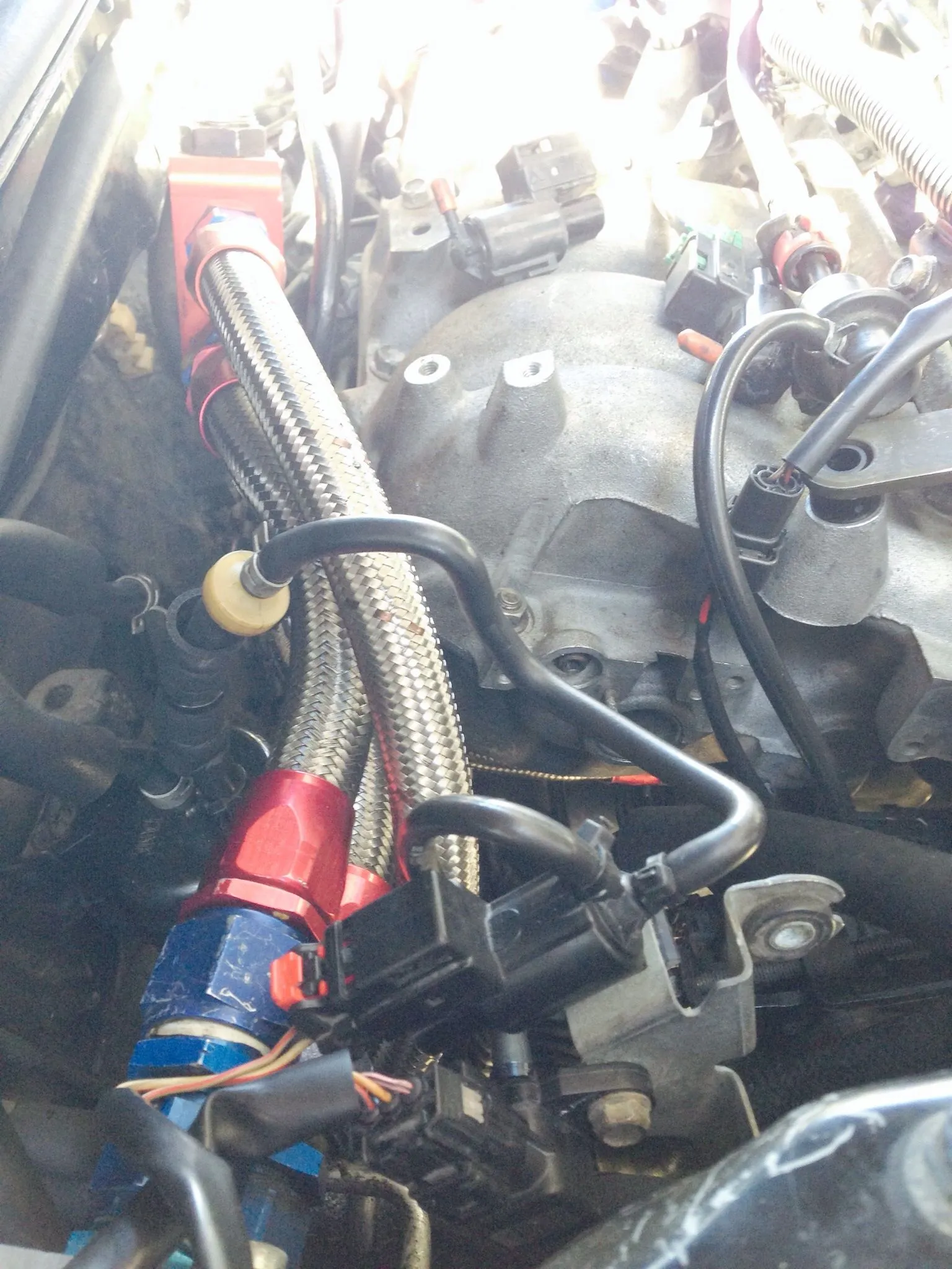

I'll post a pick of my conserned vac lines. Every vac diagram I have found doesn't really show this area of the car.

I was hoping there was an assembly section to show where the hoses go and what gets plugged after the vtcs removal. The guy before me tapped and put screws in the holes.
Look back at the picture I posted above, is the vac line going out of the fuel pressure regulator supposed to be hooked up to the prc solenoid?

Not a problem man lets get this straightened out. The purge solenoid originally was near the TB, it looks like the vac line before the one-way valve was cut shorter and runs to the MAP sensor instead of the purge solenoid. The vac line for the MAP sensor (what the two sensors in the pic appear to be) should run to the Intake Manifold, there is a vac nipple near the bottom. The VICS flaps (if they are there I can't really tell) have a vac line that runs from the actuator on the IM to the solenoid (opposite of the connector side on the solenoid) and the top vac nipple on the VICS solenoid runs to a port on the IM in the center near the firewall. Fuel pressure regulator vac line runs to the fuel pressure solenoid (brown connector) and then to the IM, you can bypass the solenoid but the vac line must run to a nipple on the IM.
I wish I had better photos but this is how the stock setup is (more or less). I have relocated the fuel pressure solenoid next to the VICS and VTCS but you can see how the lines run to the IM and how the MAP sensor setup is stock.
I am moving the vac hoses now. I did hook up the map sensor to the port hole from the vtcs removal.
My Vics has been removed as well. I also do not see a purge solenoid. I attached a pic of the connector that believe is supposed to go to the purge solenoid...
Where does the one check valve that was cut shorter need to be hooked up? The nipple on the throttle body, what should be hooked up there? My wastegate is currently routed to it.
