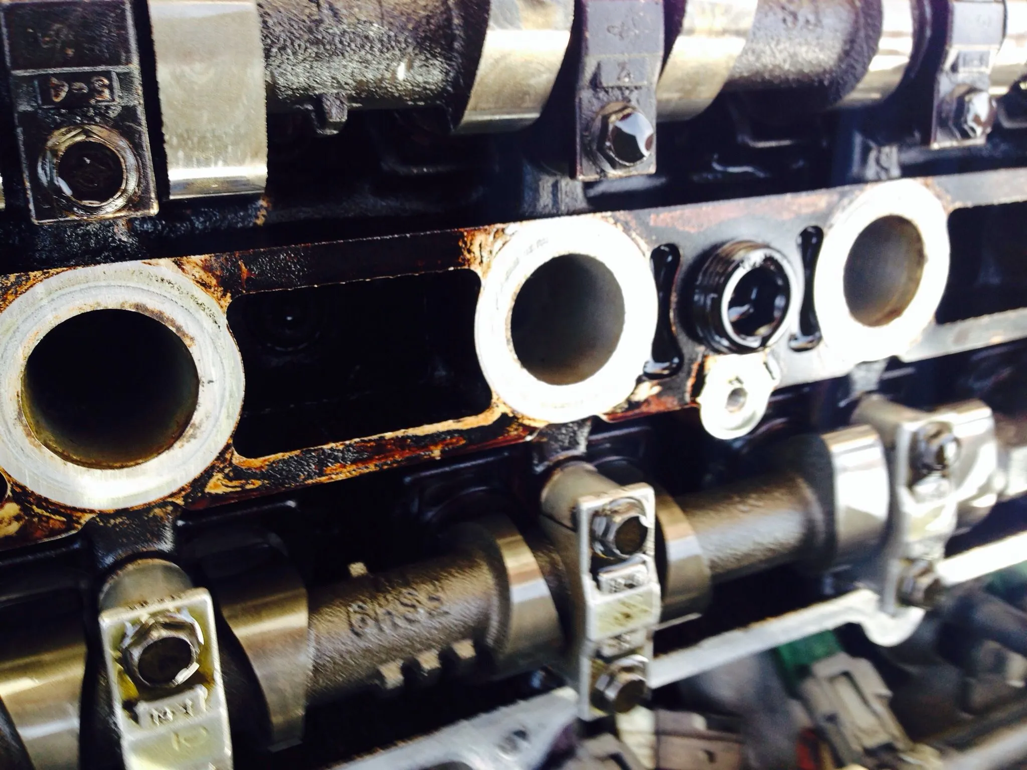

Pull the valve cover and see what the cams are marked as.

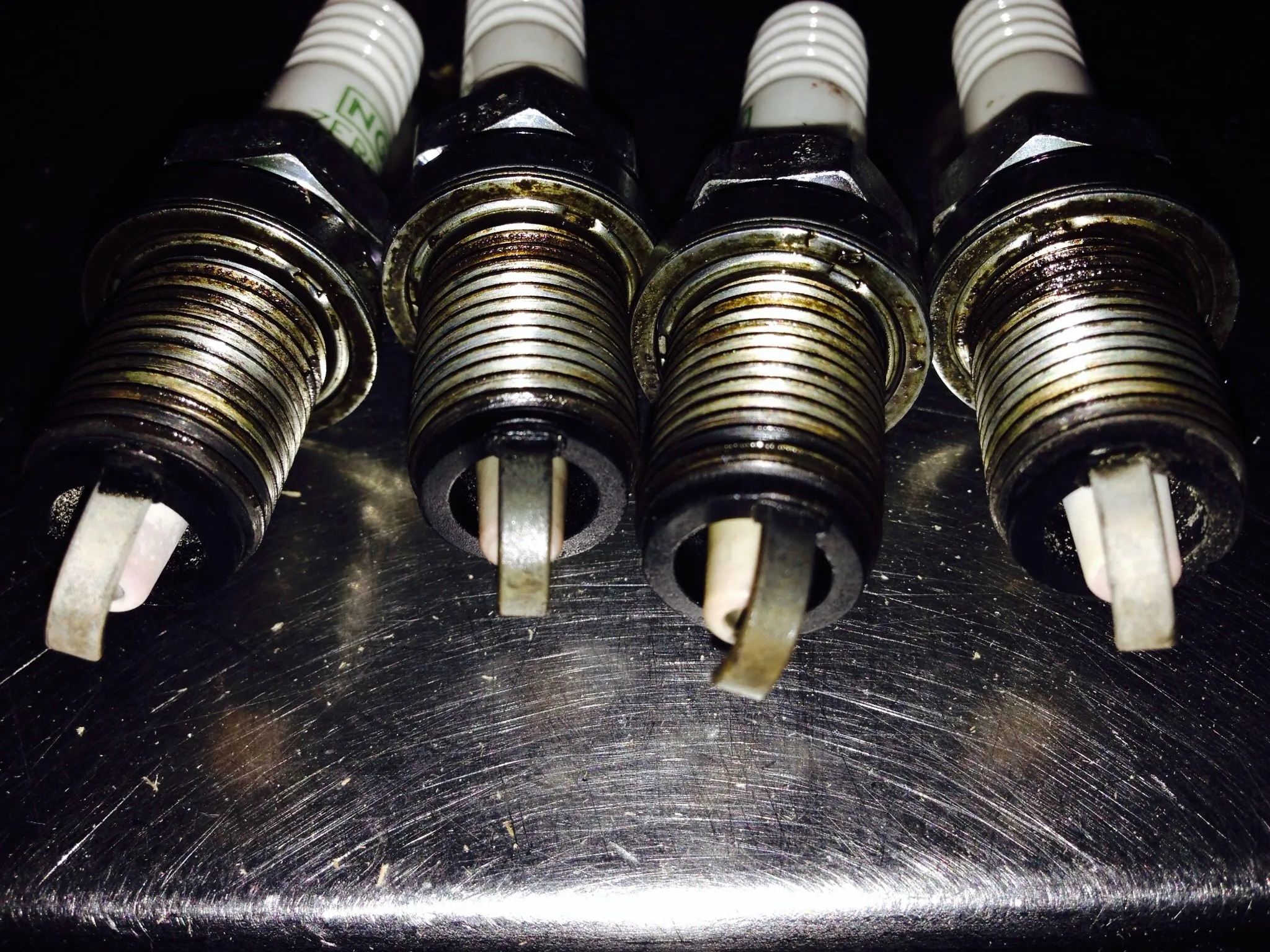

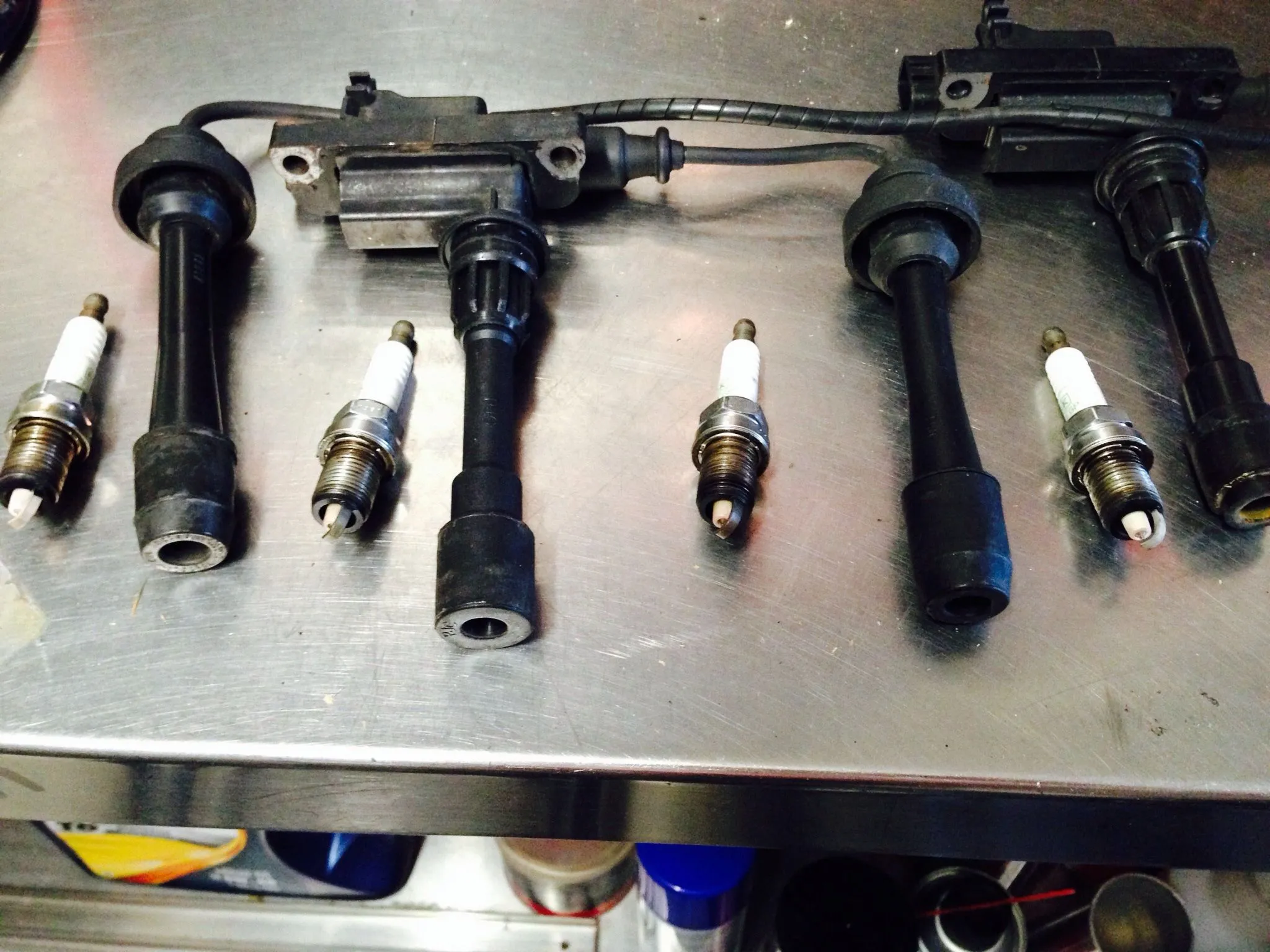

I pulled the spark plugs and the Maf sensor when I got home. I posted a picture of the plugs below, and they are in order as if they were in the car. The Maf sensor was dirty. Question, does the Maf on these cars have two wires inside the Maf sensor housing? I only see one...

The #2 plugs looks clean like it hasn't been firing. See if the car still has stock cams or not. The BOV requires vacuum to open, if the motor is leaking vacuum like yours is the BOV won't open. You may be replacing unnecessary parts instead of fixing the actual problem.
