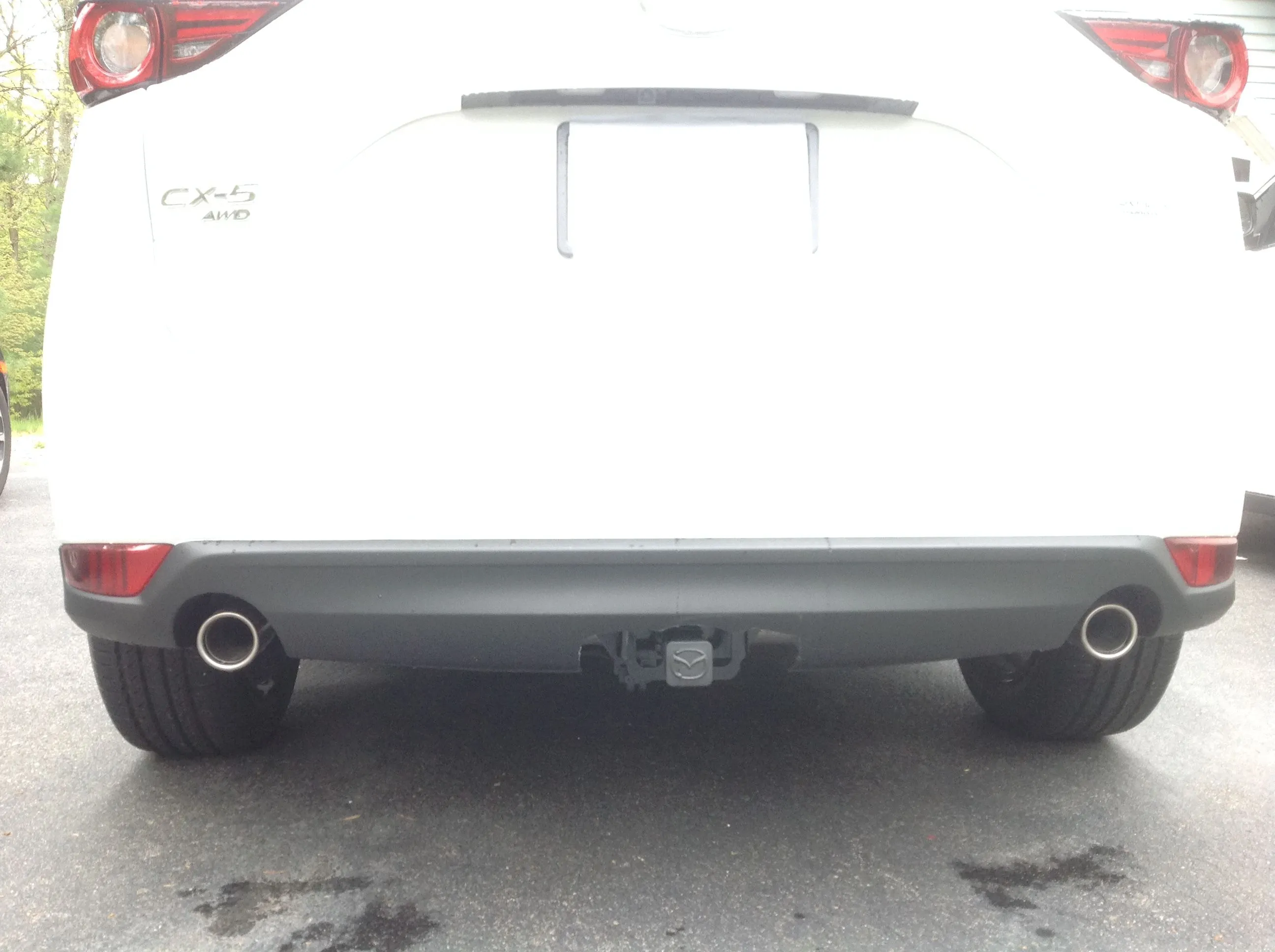

I have no reason to post fake stuff. This is hard to believe but true. My purpose here is to warn others and hear suggestions as to what the solution(s) might be. The dealer used the wrong template and did a horrible job cutting the bumper. Should never have been delivered like this. The service department head told me that he was upset that his guy did it this way. Of course I asked him why he approved the delivery! This A big dealership in our area.
My main point is that buyers should be aware that the OEM hitch requires a cutout and some dealers are not aware of the proper way to do this. Customers should be made aware of this before the installation. I added a picture from Mazda Customer care that shows the proper hole template/cutout.

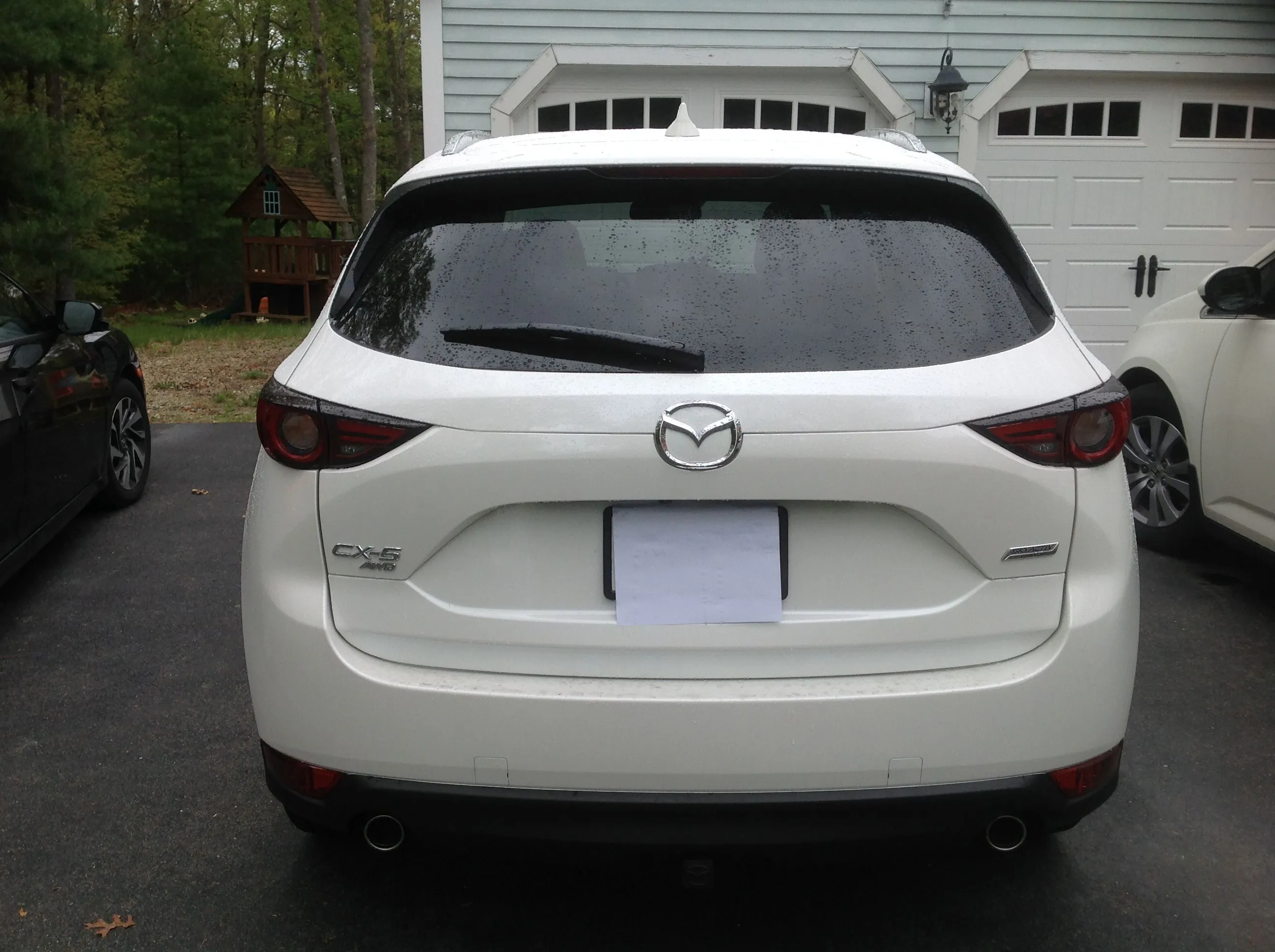

One poster suggested that I take a picture of the back of my CX-5 to legitimize my original post. Will do that tomorrow and block out my plate. Raining today.
Like I mentioned earlier, this is not a fake post.

Here are 2 photos of my CX-5. I see a few posters are questioning the title of Beware of dealer installed hitches, which I agree may be a bit over the top. Actually it is 2017/2018 model hitches.
The real issue is to be sure that buyers know how high the hitch rides on the bumper, that a large hole will be cut and that there are 3rd party alternatives that do not require a cut. Usually I go over every inch of the car before accepting but I trusted the dealer, my 3rd purchase from them, and was iin a rush to get back to work. I fully admit, my bad.

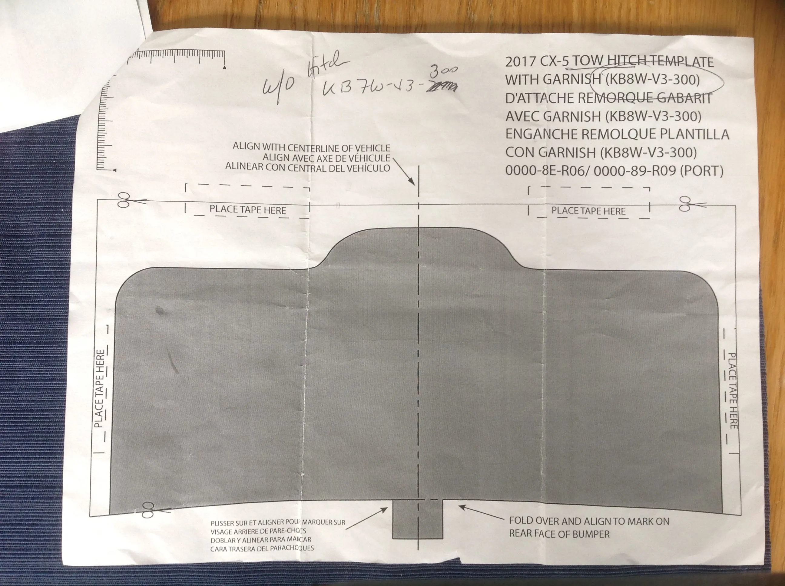

Anyway, my next post shows the template they use when installing the Stainless rear bumper Garnish. This is what they used instead of the right smaller hole template without the Garnish. Cleaning up the edges of the hole, buffing the bumper scraps and installing the Garnish may be my final decIsion. Waiting for Mazda Corporate Customer Care to suggest a solution.
2017/2018 hitch hole template for dealer installed Garnish accessory
Here is a picture of the template to accommodate the Garnish part for the rear bumper on 2017/2018 CX-5.
See part number in right top corner.

OP did say the tech used a much bigger hole template designed for installing rear bumper garnish.
