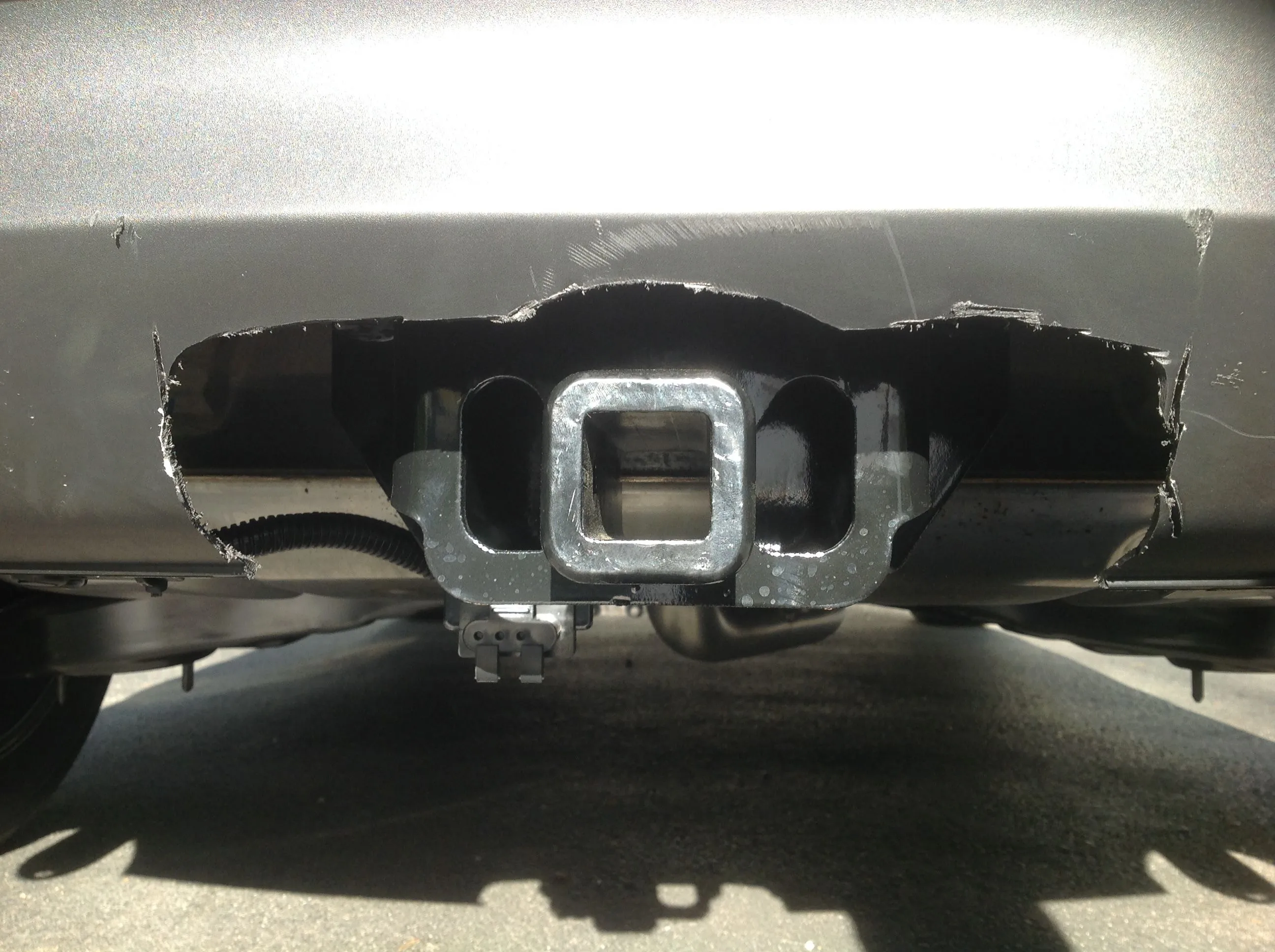

After negotiating the purchase I got the dealer to add in the hitch for free. When I got the CX-5 a big gapping unevenly cut hole was cut into the bumper to accommodate the OEM hitch. Found out that even though the online picture on the Mazda site shows the hitch just below the bumper with a small cut out, that the hole is much higher and about 10" wide! Ugly as sin!
Wish I had waited and put an after market in. Dealer offered to replace bumper with a locally painted replacement, which I will not do, or trim the hole. They should have shown me a picture of what it would look like before installing.

Could you kindly take a photo of what it looks like now that way we can see how badly the dealer had installed this hitch?
You are not the first to have this issue. A reasonable person would make a paper templete and tape it to the bumper and carefully use a small saw to trim out the opening. Ed

Dealer should provide you with a brand new bumper free of charge then take it elsewhere to get the hitch installed
This sounds miserable. You should get bumper replaced. Can you share a pic? If they didn’t go into the painted part they can probably just get you a new plastic bumper cover that would cost them $25.
The black plastic and the painted part are all one piece.

A properly installed Mazda hitch may not look precisely like the one in the accessory brochure, but a 10" wide ragged cut hole is unquestionably a major dealer screw-up. You're going to need a new bumper cover one way or another, so why are you resisting the dealer's offer to replace it with one that's "locally painted"? Do you think you're going to get one that's factory painted? That's not how it's done. The factory replacement cover is all black and the installer has to color match the top portion.

When your negotiation backfires... sounds like the bumper offer is the proper fix.. I am curious to see how badly they butchered it though. There is a cutting template they are supposed to use.
I use a curt hitch that sits flush with the bottom.. no cutting.

Thanks for the responses. Dealer has been more than cooperative. The new bumper option just bothers me. They made it clear that the locally painted bumper may not be a perfect match. The frustrating part is that the Mazda accessories picture shows an under the bumper installation. I have installed a lot of hitches in the past myself but they threw it in as part of sale. The option I may choose it to have them install the Stainless Garnish part, which would cover the overdone hole. Part: KB8W-V3-300.
The dealer is open to whatever I want to fix the issue. If the dealer had shown me what the install would have looked like I would not have had them do it. The template they use is way too big for the hitch. The template they use is the one used for the Garnish installation, which has a hitch and non-hitch version.
So here it is:
Again, dealer is mortified and wants to fix to my satisfaction. Yes, I should have installed a Curt myself, I know! Lesson learned.

H o l y s***!!!
You accepted your brand new CX-5 in that condition? I would have hit the ceiling after seeing that mess and I would have been VERY tempted to walk away from a dealer who would do work like this.
It appears as if they added the electrical connection as well? I'd inspect the work done for that VERY closely.

Damn that is horrid it’s like someone’s first time using a jig saw. I’d just get the locally painted bumper and move on. Also there going to have to cut it again so I’d take it off. Get your money back and get a hitch that doesn’t require drilling.
Wow, that is more than just a sloppy job, that’s a FUBAR.
Whoever did that must have just gotten back from their weed break. The fact the dealership tried to push it off on to you makes me wonder.
