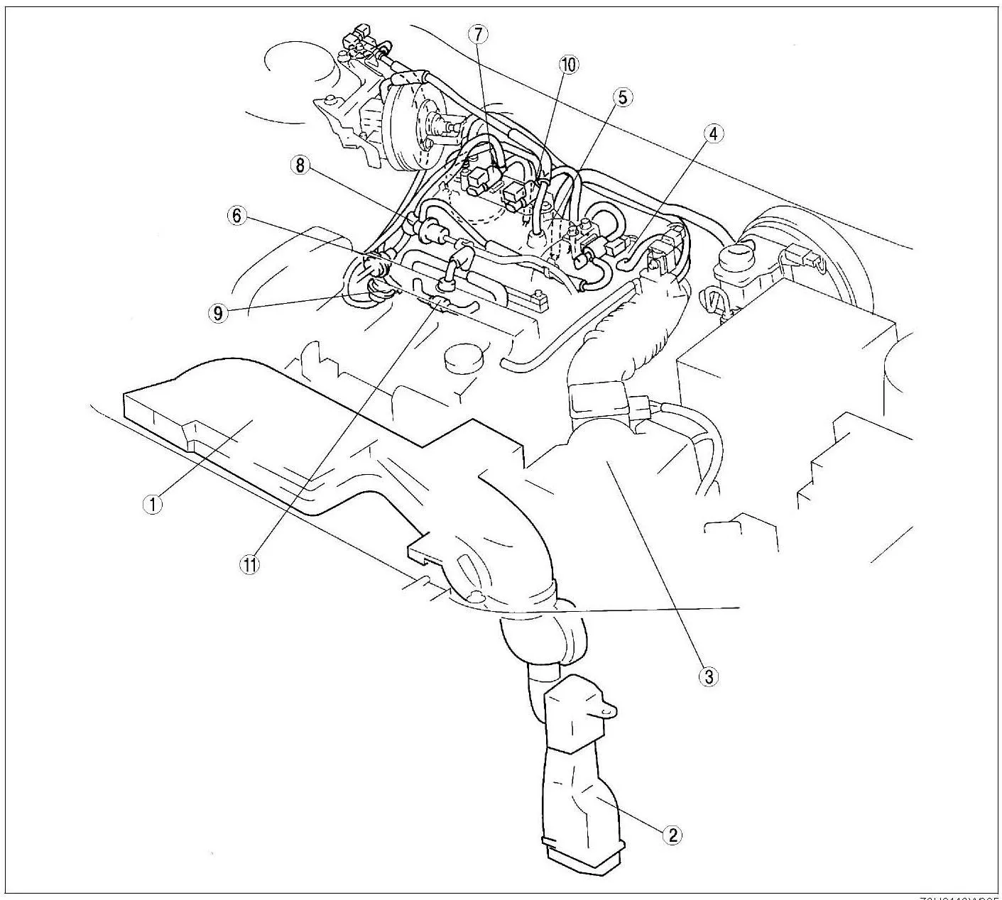

define vics solenoid valve.
which is it?
or better yet where is it located on my 2.0?
do u have a part number?

the VICS solenoid is item #10 in the attached.

purchased both today, thinking that the codes are independent i'll change both once they come in, but are u sure the vics couldn't have caused the knock to go bad or read a knock????

both of those code only have to do with circuit malfunctions. thats why i suggested just replacing the sensors.
attached are the pages from the shop manual for your review.
hey, njaremka.... what was the other solenoid identical to the vics of #10, but in position #7 i think??
is that for the vtcs???? the parts number is the same on both parts and the replacement is a different number all together..... maybe i got a new and updated part.... seems the same manufacturer is mitsubishi (3 pt. star symbol) and looks identical, but has different numbers on the bottom
If the vics is not functioning properly in the high rpms it could be causing knock maybe?? This solonoid closes off part of the im to change to a short runner above 5500rpms. Not to say there is not a problem with the knock sensor also.
