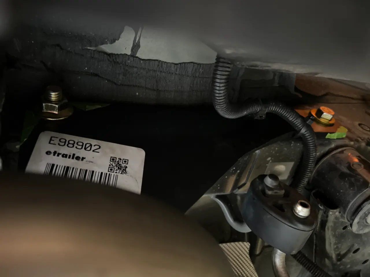

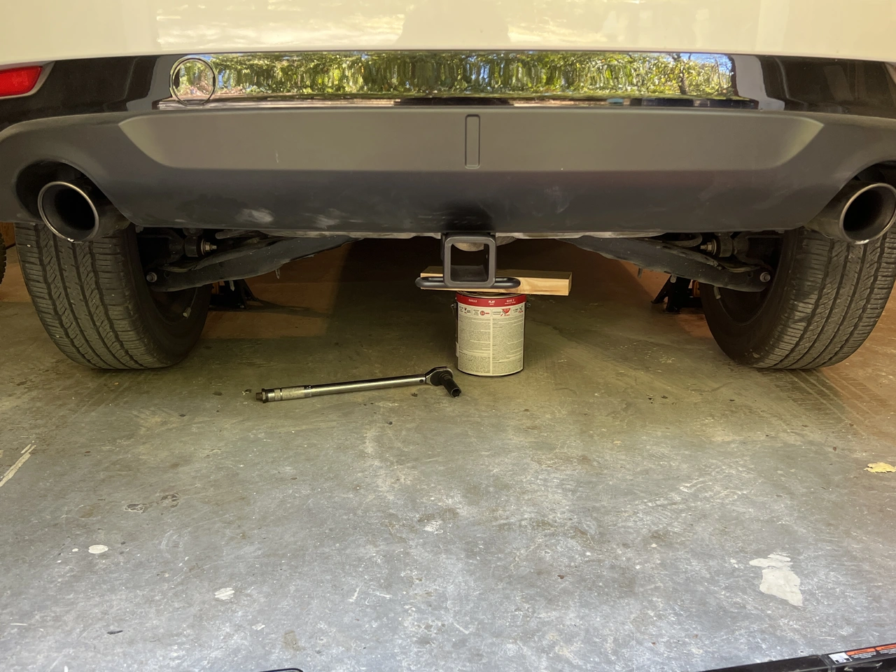

Hey all,
I installed an eTrailer branded hitch on my 23 Turbo. Installation took two hours solo. It’s a PITA maneuvering the hitch into place but a simple install if that makes sense. The hardest things to do were sliding the muffler off its rubber mounting points, and pulling the carriage bolts through the hitch with the snake wire whilst holding the hitch up lol. Plenty of room to work with when torquing the nuts and bolts. Easier than my old ‘13 sport. Only note, you’ll have to remove the extra trim on the underside of the bumper and toss it. No room for it after install.
Looks very sharp, nice matte black finish. Now I’m off to install the light kit. Not looking forward to running the lead all of the way up to the battery. My RAV4 hybrid spoiled me with the battery in the trunk space during my last hitch install.
