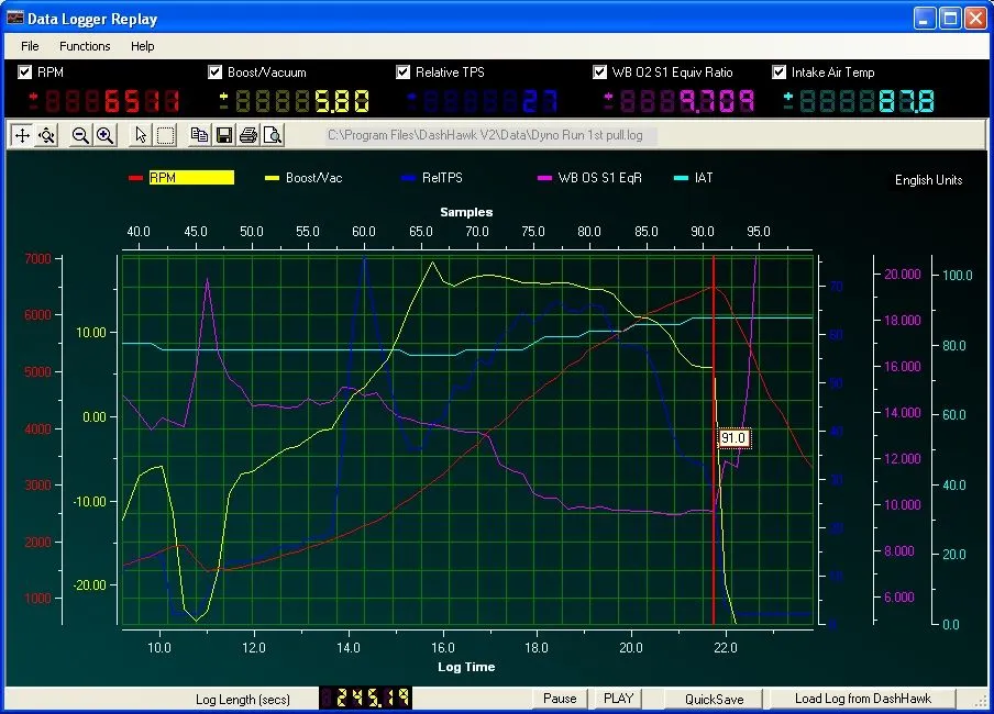

Does the dashhawk read air/fuel ratios?
Well for now it reads your wideband equivalency ratio but you can just multiply it by 14.7 to get A/F which is what I did in the log below. The guys over at MSD are supposed to add that feature in future firmware updates.
