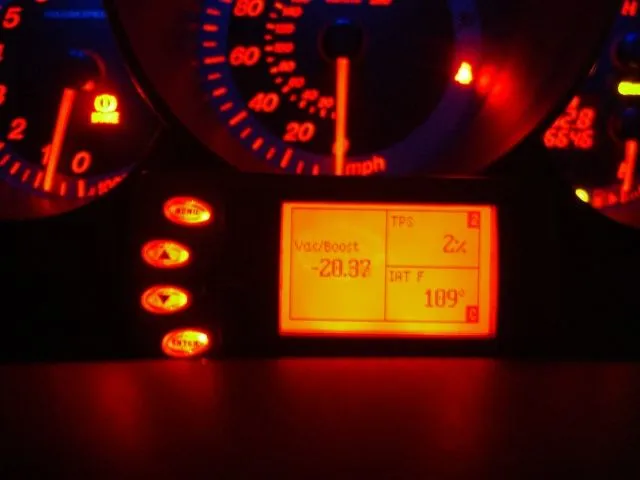

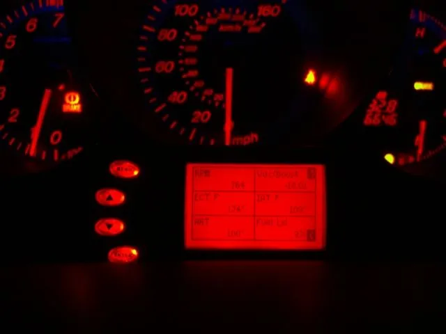

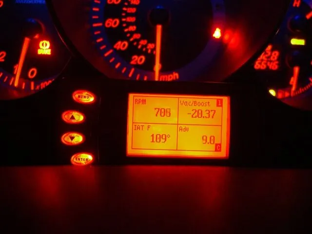

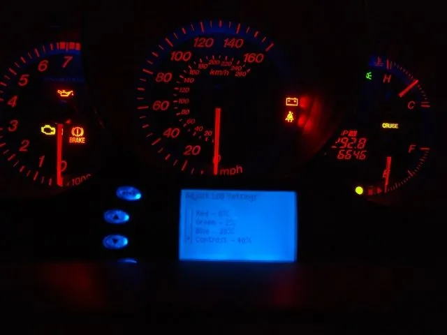

Sorry for the blurry pics but it was hard to hold the camera still with a low shutter speed. :(
Here is how I have mine mounted as well as a video of the startup. And yes it turns on/off with the car without any button presses. In the video, I do have to press the button to get out of the warning screen though. You only have to do this a few times at first. I just flashed mine with new firmware today so it reset everything. Normally it just goes right to the last screen displayed when it was last turned off.
You can display anywhere from 2 pid's to 7 on the screen at one time. But you can customize 11 or 12 different displays and cycle through them with a single button push. You can also change the display color to 16 million different colors (RGB combinations)

It depends on how many parameters are displayed. I normally display 3 at a time like what in the second pic and I have no problem reading them at a glance. I always keep Boost as the parameter on the left so its the most visible. It also has configurable alerts. You can set 3 alerts for 5 different parameters and have the display flash a different color for each one. So you can set an alert for your coolant temp so that if it goes over a certain amount it will flash the value and the color even if its not one of the parameters currently being displayed. And since one of the parameters is RPM, you can set it to flash at a specific value effectively turning it into a shift light :) And the splash screen is also customizable. I just made that mazdaspeed one today.
And no you can't alter the ECU with this. All it does is read the sensor values.

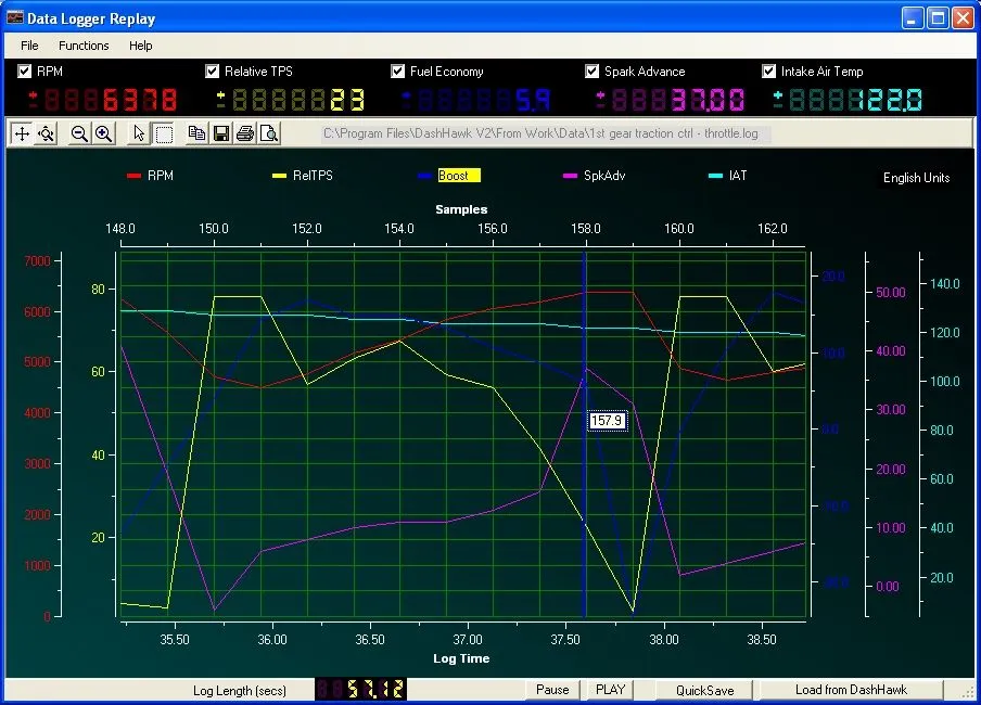

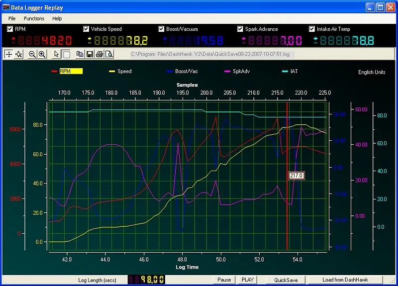

Heres a log I did recently cuz I was interested in exactly what the ECU was doing to the boost and throttle plate at WOT. Here is a screenshot of what happened in 2nd gear. At 6400 RPM's the boost was at 5.9 psi and the throttle position was at 23% :( Nevermind that at the top of the chart it says Fuel Economy instead of boost. I'm trying out a beta version of the firmware and they haven't updated the PC software to match the pid names. Heres another log of a WOT run from 0-80mph.
