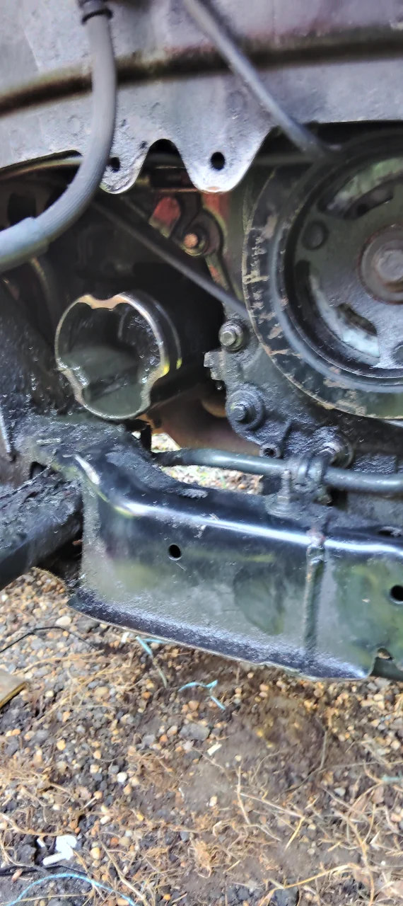

Trying to replace passenger front CV Axle. I have experience with CV axles in the past. Changing carrier bearings on the passenger side. However, this looks like a 2 part axle, that the inner half is permanent. I am working on the ground with a floor jack. Tried pry bar. Ball joint splitter and maul. The axle has already separated..(pic). Is there anything that has to be unbolted on the carrier??
It is supported by a bearing behind the engine, you need to unbolt it from the engine because it is probably stuck in the bearing holder. 3 bolts if I recall.
