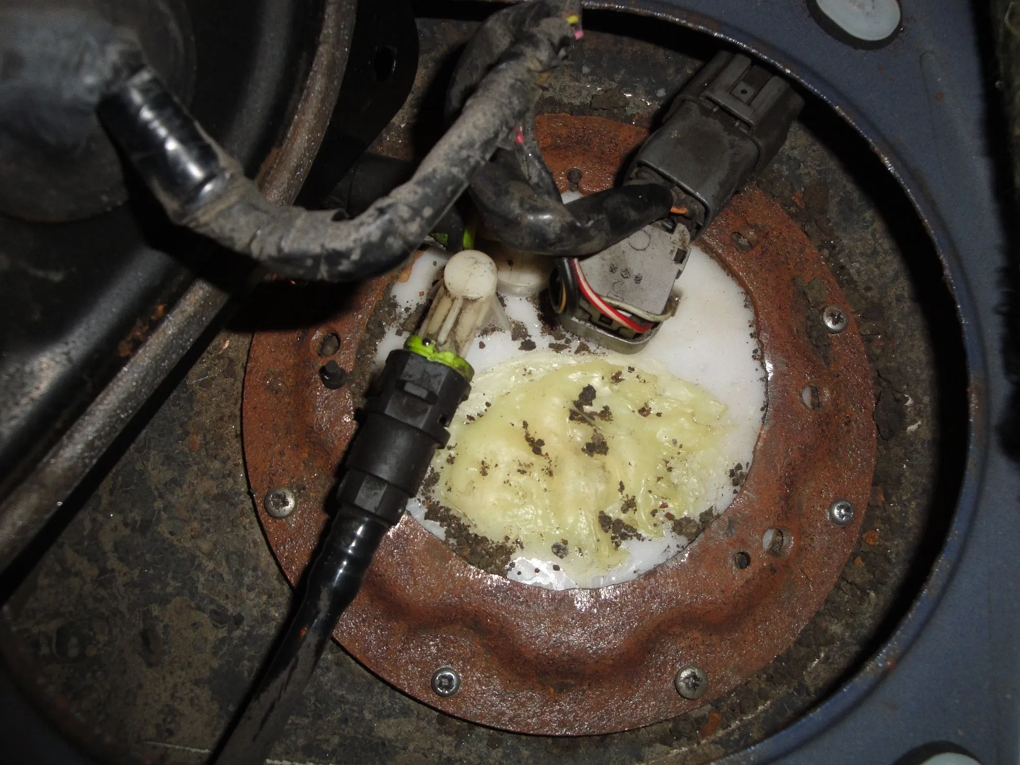

Update on the repair... The sending unit was OK. When I brought the car the guy unmounted the fuel pump assy and said : who ordered that sending unit?!?!? And told the guy he was stupid right in front of me lool. The mechanic took Epoxy and put a whole tube on the top of the pump assy, had 2 little cracks, once solid, the glue was as hard as plastic. Had to use a grinder to remove excess that would prevent the assy to stick in place with the ring that goes on the top of the tank! So instead of a 300$ fix, cost me 100$. All good now, 1 week and still fine

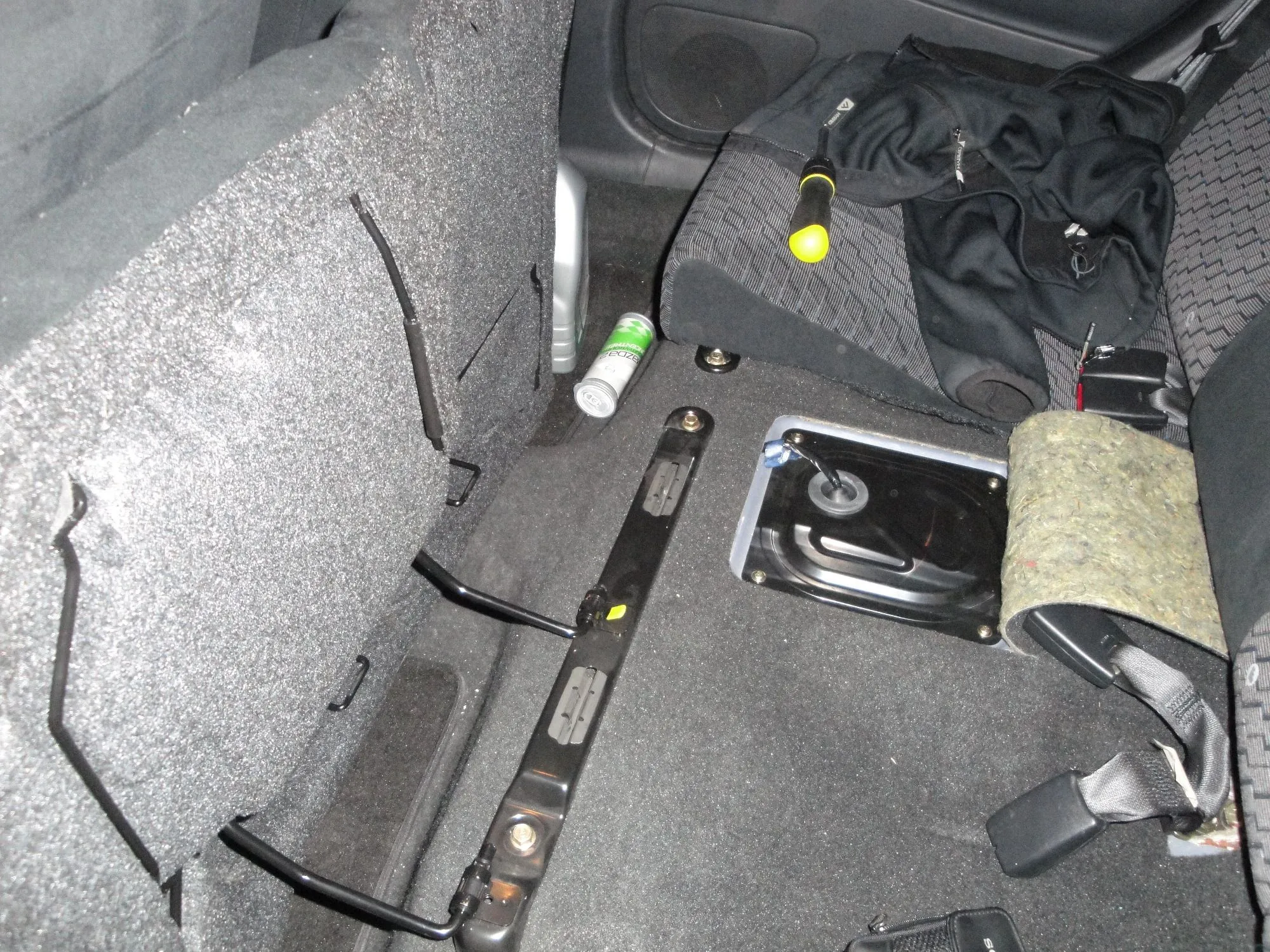

If you have the same problem as I had, remove the back seats ( just pull them they will remove easily ) and you should find a service plate right there. Remove the 4 bolts and you will be able to access the fuel pump that is on the top of the tank. If you see gas, your problem is probably like mine : the top of the fuel pump assy is made of plastic and has a metal plate to protect it. The plate tend to rust over time and punch little cracks in the plastic. With the pressure in the tank, the gas leaks from there.... take a look at it, it will take you 2 mins. If you see any gas on the top of the tank, don't look any further.

gas tank leak on top!!!!!!

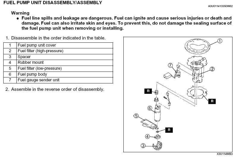

Rudy if you are planning to keep your car for some time I would recommend replacing your sending unit housing (plastic housing) rather then taking a chance with a backyard repair. To conferm your leak location use some brake cleaner and spray the area completely which will bring back the white finish of the plastic, then once cleaned and dry turn the key on but dont start the engine (no need) and while holding a flashlight look closely to see the area it is starting from. You will most likely see a hair line crack with a small valley beside it showing where the fuel has been leaking. If you must and the area of the crack is in the area away from the fittings for the lines then scuff the area and apply your epoxy. Remember this is a short term fix as the fuel will be working it's way around the epoxy again.
Here is what you will need for the repair:
Fuel Body GY01-13-ZE0 {Shown as (2) Fuel Filter (high pressure) in diagram}
Gasket B25D-42-166
Plate BJ0E-42-16XE
O-ring ZL01-13-ZE5
Washer FEH2-13-ZE4 (may not be necessary)
You will also need the 8 screws that hold the ring in place as they will be completely rusted when you try to remove them.
The float, low pressure filter, and pump switch over to the new fuel body. The washer and O-ring seal the pump in the new body.
