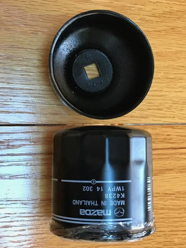

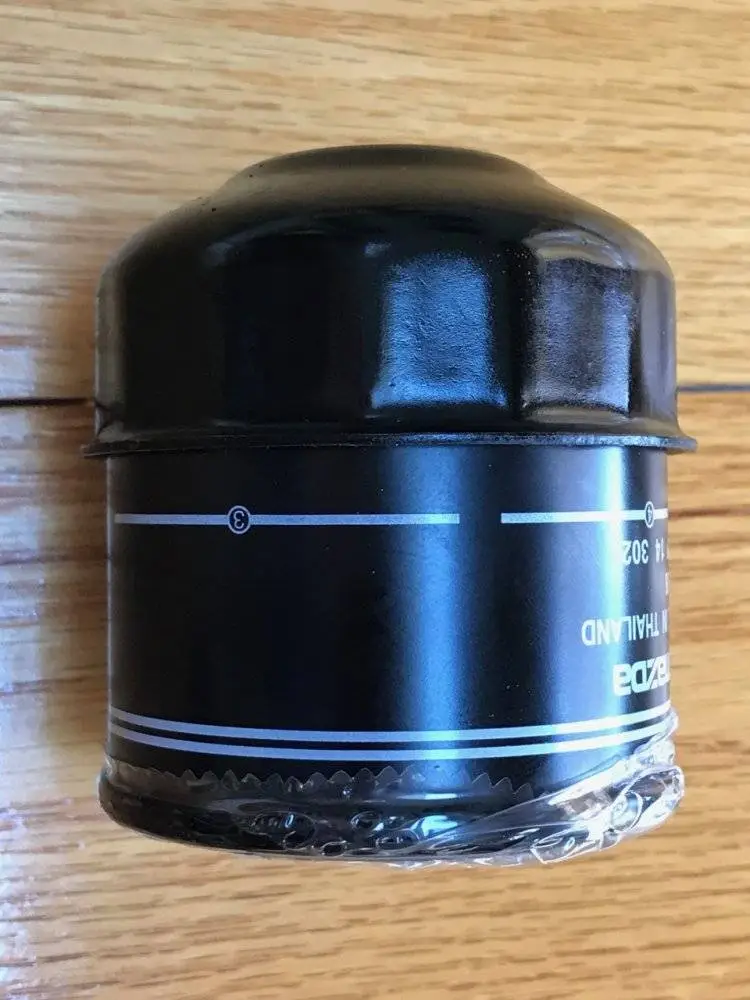

I purchased my 2020 Signature at the beginning of October last year. For the last month, the dash has been telling me it's time to change the engine oil, which I did yesterday.
I purchased the Mazda 1WPY-14-302 oil filters six months ago to check that the filter removal cap I used on my previous 2000 Camry would fit. The cap fit fine. 5W-30 full synthetic ILSAC GF6A oil purchased from Costco.
After draining the oil out of the pan and installing a Fumoto drain valve I was quite surprised to find that the oil filter removal cap did not fit the factory installed oil filter; the filter was too wide!
WTF? I've been reading this board since mid-summer last year and can't believe I missed the fact that the factory installed oil filter is wider in diameter then the current made-in-Thailand ones being sold!
Fortunately, the old "hammer and screwdriver" method for removing an oil filter worked. But color me surprised that this was needed!
Yes, Thai made OEM Denso oil filters are a bit smaller in diameter than Japanese made OEM Tokyo Roki oil filters. The stock oil filter on 2.5T is Japanese made Tokyo Roki PY8W-14-302, but Mazda North American Operations had stopped supplying PY8W-14-302 a couple of years ago and it’s superseded by Thai made Denso 1WPY-14-302 which is smaller. Usually it isn’t an issue unless you use cap wrench on the oil filter. I ordered a "Genuine" Mazda Oil Filter Wrench A255 for $10.20 from Med Center Mazda along with oil change kits years ago but it ended up exactly the same as https://www.amazon.com (commissions earned)https://www.amazon.com (commissions earned) The sizes of CTA A255 cap wrench are 65 & 67 mm with 14 flutes. It fits Mazda OEM Japanese oil filter perfectly on 67 mm and OEM Thai oil filter on 65 mm size.
Here is the size comparison between Japanese and Thai oil filters for my 2.5L. The sizes of OEM oil filters used on the 2.5T are the same as on the 2.5L.
⋯ I purchased the Mazda 1WPY-14-302 oil filters six months ago to check that the filter removal cap I used on my previous 2000 Camry would fit. The cap fit fine.
This makes sense, as Mazda 1WPY-14-302 oil filter is made in Thailand by Denso (Toyota).

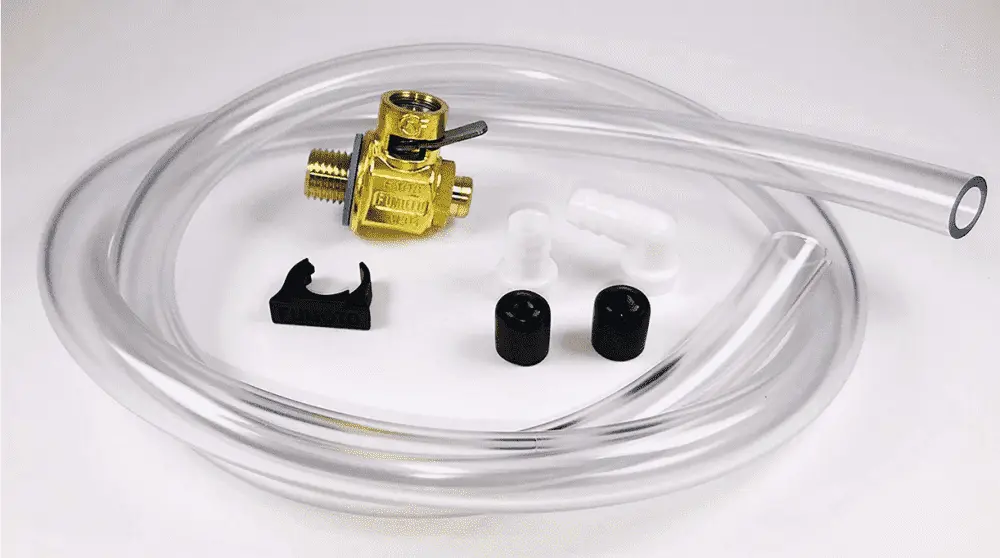

Exact part no. for the Fumoto valve? Did you get the short or long nipple? did you need their exender adapter or does everything clear the pan okay. Thanks
I purchased an F106S short nipple with included locking clip, right angle and straight plastic attachment and drain hose, and two nipple covers off of eBay. No adapter needed, even though the Fumoto website said it might be necessary. I can see how the valve sticking out a little ways though does take up a bit of room where the oil filter is located, but the cap tool I have to remove the filter still easily fits in the space.
If I had to do it again, I might purchase the F106N with the longer nipple, now that I see how protected the valve location is.
Okay, so all 3 of these? Attechment were needed too? I've never needed more than just the valve itself

Yes. One of the good things of the OEM Thai made Denso oil filters is there’re —①——②——③——④— marks on the metal shell, so that you can tell easily how much partial turn you have made with these marks as the reference point after contacting the seating surface.

Just changed the oil yesterday on my (new to me) 6 and in the process installed a Fumoto F106N (long nipple). It fit just fine and I like having the longer hose attachment. There were no clearance issues of any kind. Bought on Amazon for $23+.
I also bought 10' of drain hose at Home Depot for $3+
