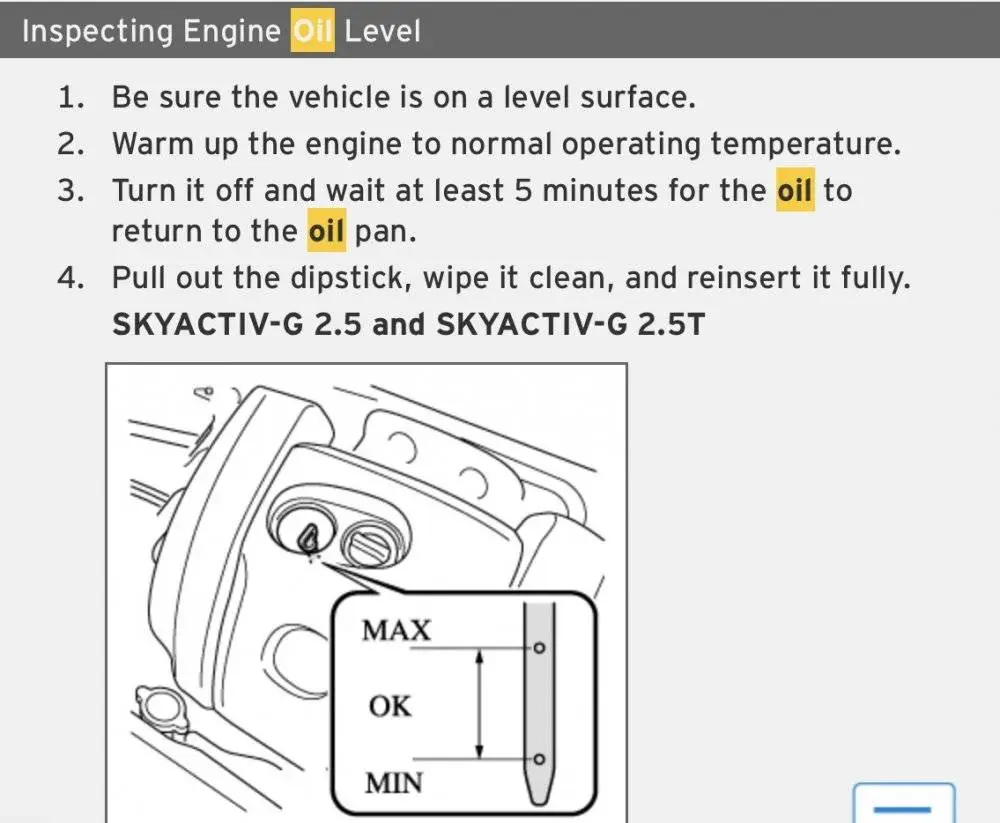

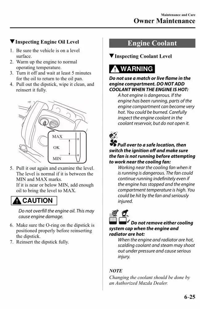

It boils down to individual preference. This debate has been revisited a few times here already. Some people can't read the dipstick on a warm engine, so they check it cold. Others can read the oil level when warm with no issue.
The only thing to note is that, as you mentioned, Mazda specifies when to check the oil level, and it isn't when the engine is cold. Saying that the cold check is "more accurate" is false. It's easier for those who can't read the dipstick on a warm engine, but it's less accurate according to the authority (Mazda). This isn't a matter of opinion, its a statement of fact.
Yes, to each their own.
But the fact is Mazda has never mentioned that to check the oil level when the engine is warm. They only stated “wait at least 5 minutes for the oil to return to the oil pan”. So when I waited overnight making sure most oil has returned to the oil pan and checked the oil level the first thing in the morning, where did I violate Mazda’s statement? :unsure:
I think it's pretty obvious what they mean when they tell you to warm up the engine in the previous step. But if that's the way you want to interpret it, that's fine. It's your car, do what you want.
