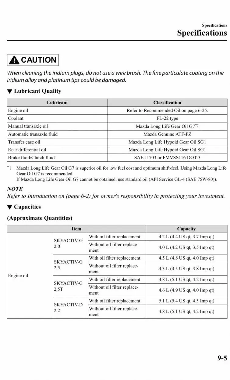

What exactly the part number you saw on the dipstick?
And how much oil do you use for the oil change on the 2.5T? 5.1 quarts (stated in owner’s manual)? 5.5 quarts?
Which owner's manual are you referencing? I checked the 2020 CX-5 and 2018 CX-9 owner's manuals when responding to one of your posts the other day, and couldn't find where they state the amount of oil required for an oil change. Maybe I wasn't looking in the right place.

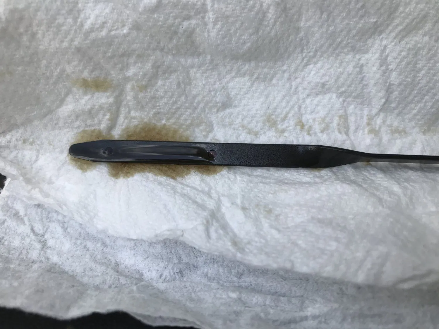

Hot:

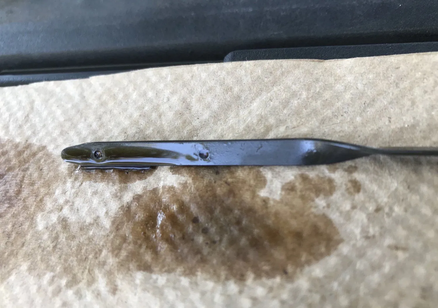

Cold:

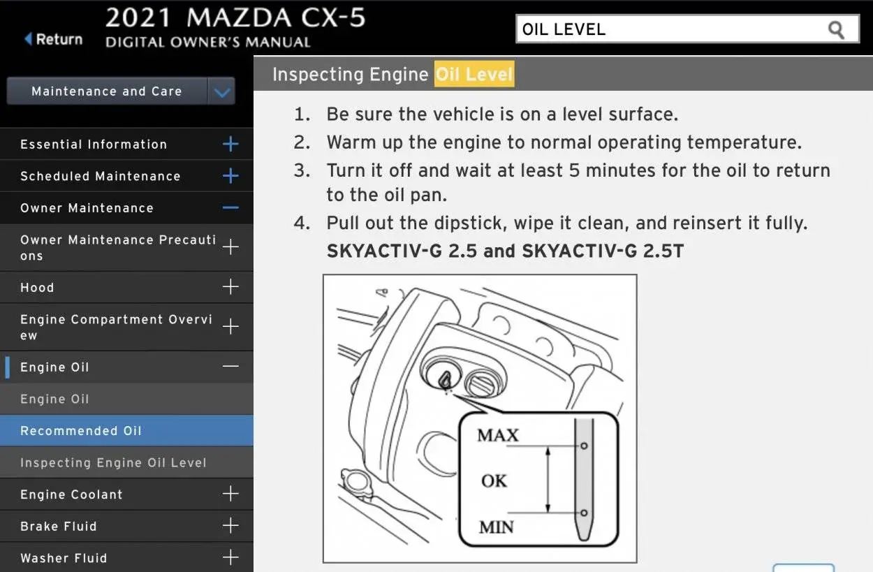

Um, doesn't waiting until the next morning to check, meet their requirement?
3. Turn it off and wait at least 5 minutes for the oil to return to the oil pan.
In what window of time does "at least" end?
I did an oil level check after driving my CX-5 around for about an hour and make sure the engine is fully warmed up. Then I turned it off and waited at least 5 minutes for the oil to return to the oil pan. To be exact, the picture was taken 10 minutes after as I had to take the measurement multiple times due to the difficulty of reading the hot and watery 0W-20 oil on the dipstick.
And here’s the oil level taken at the first thing in the morning on a cold engine before the engine start. No wiping, one pull, and easy to read the oil level on the dipstick:
As we can see, there’s almost no difference between the oil level measured in hot engine and in cold engine, just like dunhillmc’s pictures showed.
This’s from 2020 Mazda CX-5 Owner’s Manual:

I always check my oil level cold.
Mazda’s recommendation. Oil expands when it’s hot.
And more oil will return to the oil pan if you check the oil level cold.
And see post #9 above for comparison between checking the oil level hot and cold.
