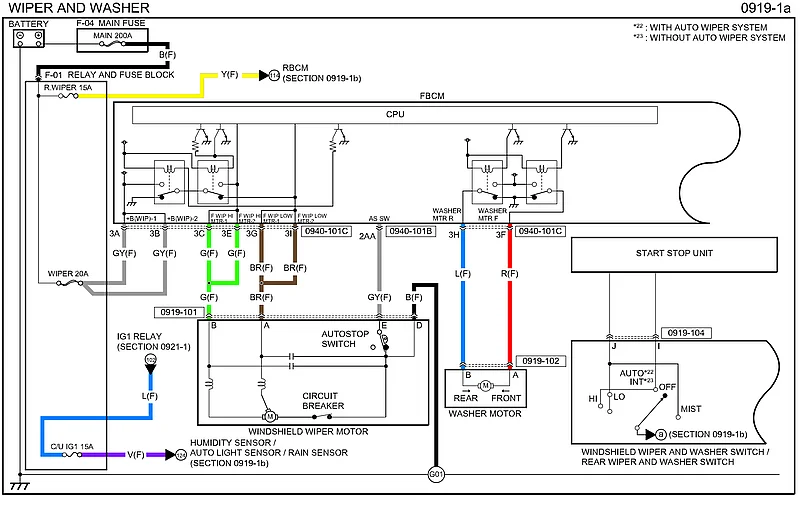

It could definitely be a relay. Unfortunately, the wiper relays are internal to the front BCM, and so I don't believe they are easily replaceable.
