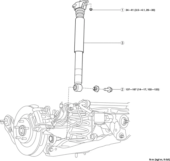

One question here. Since Mazda Workshop Manual doesn’t mention this replacing the rear shock absorbers, is removal of the rear stabilizer end-links necessary? And why?
Make sure the suspension is under normal load (not jacked up at all) when removing endlinks; they shouldn't be an issue.
It also doesn’t mention removing the rear coils. If you trust your jack to hold the control arm in place while you remove and replace the shock, disconnecting the end links and removing the rear coils isn’t necessary. You’ll want to disconnect the end links if you want to lower the arm enough to remove the coil.
Another problem? There is no room to remove the bolt securing the lower part of the shock with an impact wrench without removing the coil. I disconnected the end links and removed the coils to get at that bolt with my impact wrench, as well as for safety purposes.
Another problem? There is no room to remove the bolt securing the lower part of the shock without removing the coil. I disconnected the end links and removed the coils to get at that bolt with my impact wrench, as well as for safety purposes.
OK, got it. You actually separated stabilizer end-link and lower control arm to remove the coil spring, then replaced the rear shock absorber. So the job is a bit more involved than the manual says. I guess this’s another example of a good theory on paper but it may not work in real life experience! Thanks for the explanation.
Exactly, and no problem at all! I have no idea why the shop manual didn’t specify those two additional steps under the shock absorber removal/replacement procedure. I might have received a little surprise had I not watched FelixDs YouTube video LOL!

Do you have a nut or a bolt (② in the diagram shown) for bottom eyelet of the rear shock?

I've changed a few sets of rear shocks. The worst was Saturn Vue because of all those stupid plastic rivets around the mounting point. Otherwise just unbolt the top and bottom and replace.
Ruthrj, are you suggesting if I can remove that bottom bolt without using an impact wrench I don't have to undo all of those 'links', etc. ?
A bolt for the bottom eyelet.
I think so. Chris_top_her suggests that too in the thread Yrwei linked above. You’ll want an extension for your wrench handle though to break that bolt loose. It’s on there with 120+ Ft lb of torque in a somewhat awkward position. Imagine trying to manually remove a lugnut that’s on too tight on the backside of the wheel.
When I looked at it in person I said screw it, I’ll do the extra couple steps to save myself that headache LOL. I didn’t care for how FelixDs mechanic used a jack stand under the control arm though. I felt much better using my floor jack to support and lower the control arm. It also was a cinch to lift back into place when reinstalling the coil.
Thanks.

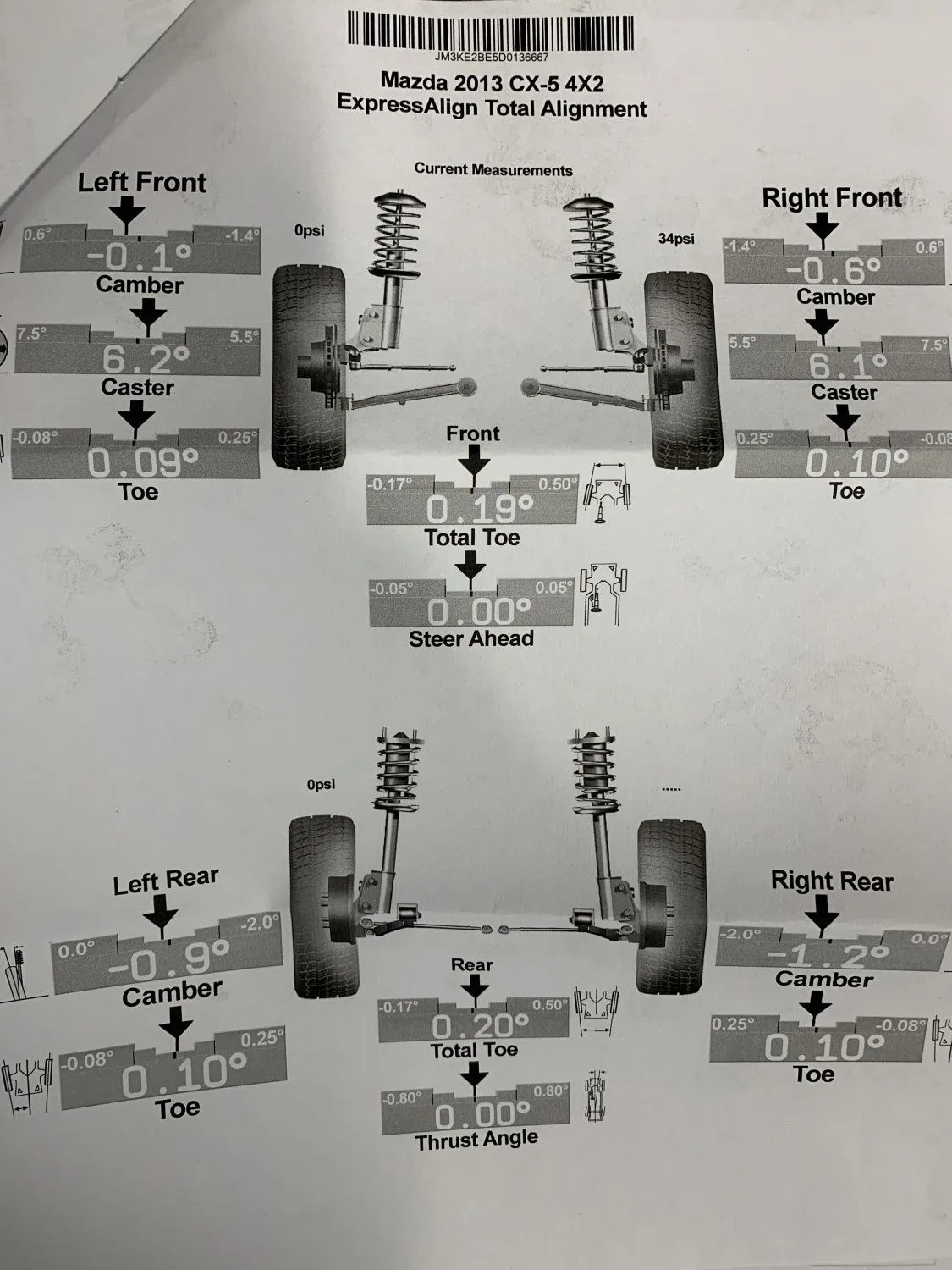

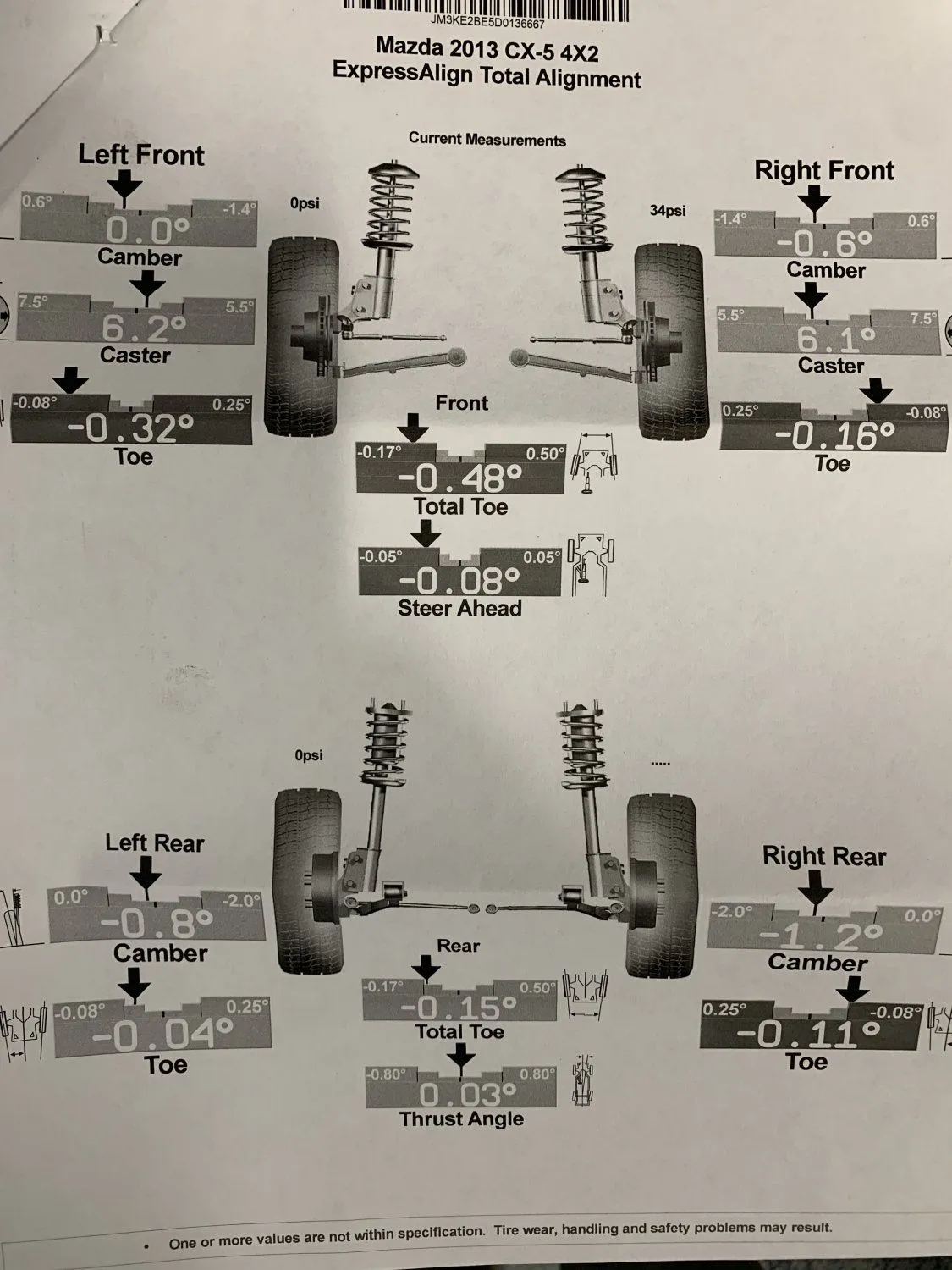

Post and pre alignment specs. Toe was way off on 3 of the 4 wheels, nearly out of spec for the last wheel. I’d like to think all of the suspension work caused that and not 8 years of no alignments lmbo. Tires have worn fine, car went straight, and gas mileage has been unchanged over the cars life. All in the green now!
I was expecting to see green and red colors, but your alignment before-after reports are black-and-white?! ;)
Not much the mechanic can do on casters and cambers and they’re all within specs. Good to have the alignment done it seems. (y)
You can’t see the colors?
Lol, jk XD I guess the place I went to couldn’t spring for a color printer!
