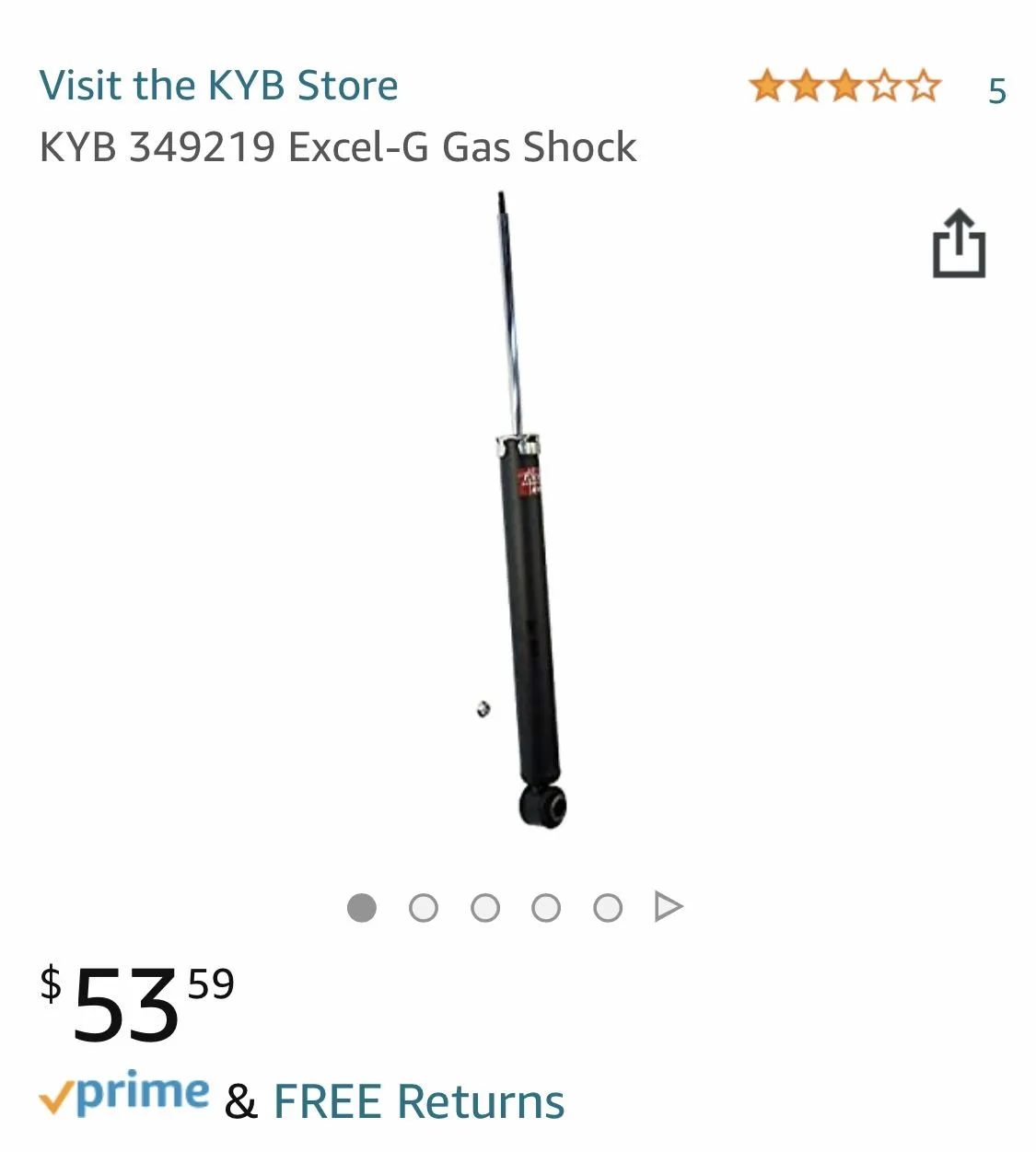

Just for the info of anyone else looking to replace their struts/shocks down the road here are the KYB part numbers:
Front Left - KYB 339337
Front Right - KYB 339336
Rear Shocks - KYB 349219

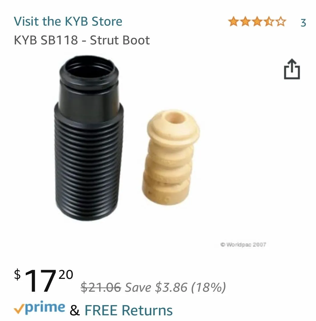

Strut Boots - KYB SB118
Now I saw the earlier post #16 and #17 OP Voda Pas did say he had reused “actual” upper rubber mount as the KYB shock doesn’t come with it like the OEM shock. He also ordered strut boots presumably is for front, but it seems the rear KYB shock also needs some dust cover boot. Here are comparison pictures between OEM rear shock absorber and KYB’s. OEM shock comes with entire upper rubber mount but KYB shock doesn’t.
awesome, thank you! I’ll look into KYB SB118 for the rears, I plan to reuse the existing mounts. Much appreciated!

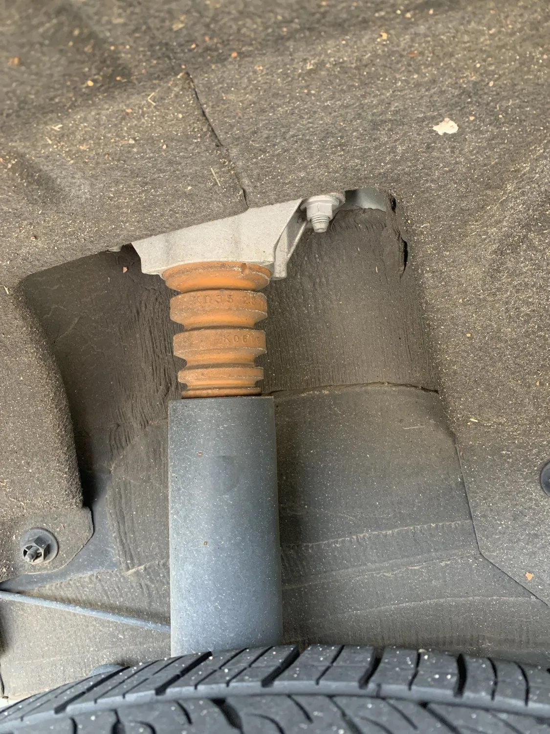

I think I should be able to reuse this whole portion pictured with the new KYB shocks. The black part moves freely when I jiggle it and the dust cover seems to be in good shape. The SB118 part looks applicable if you’re disassembling the old strut assembly to reuse the coil and such, but i should be good to go with the full assemblies I ordered :D
Yes, you should be able to reuse the upper mount and dust cover from factory rear shocks. I just remember someone had mentioned that he needed the upper mounts as they were worn while replacing the rear shocks, but he couldn’t get them because it’s part of OEM rear shock absorber. I believe the lower bolt for rear shock will need some maneuver to take it out. OP and @Chris_Top_Her discussed a bit in post #18 and #19.

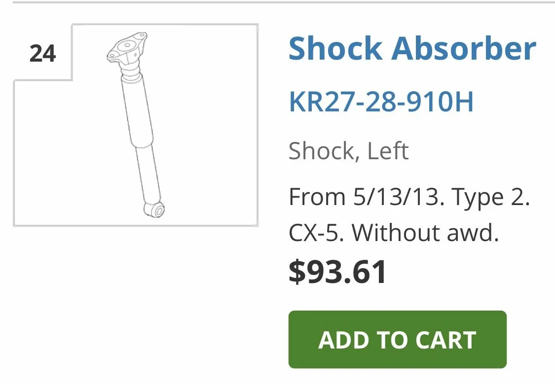

I believe the top mounts on rear shocks have been beefed up since your 2013 CX-5, but they’re not available separately. Strangely this top mount for rear shocks which may be different from gen-1 CX-5 is available for gen-2 CX-5.
2014 Rear Shock Mount
2016 rear shock mount?

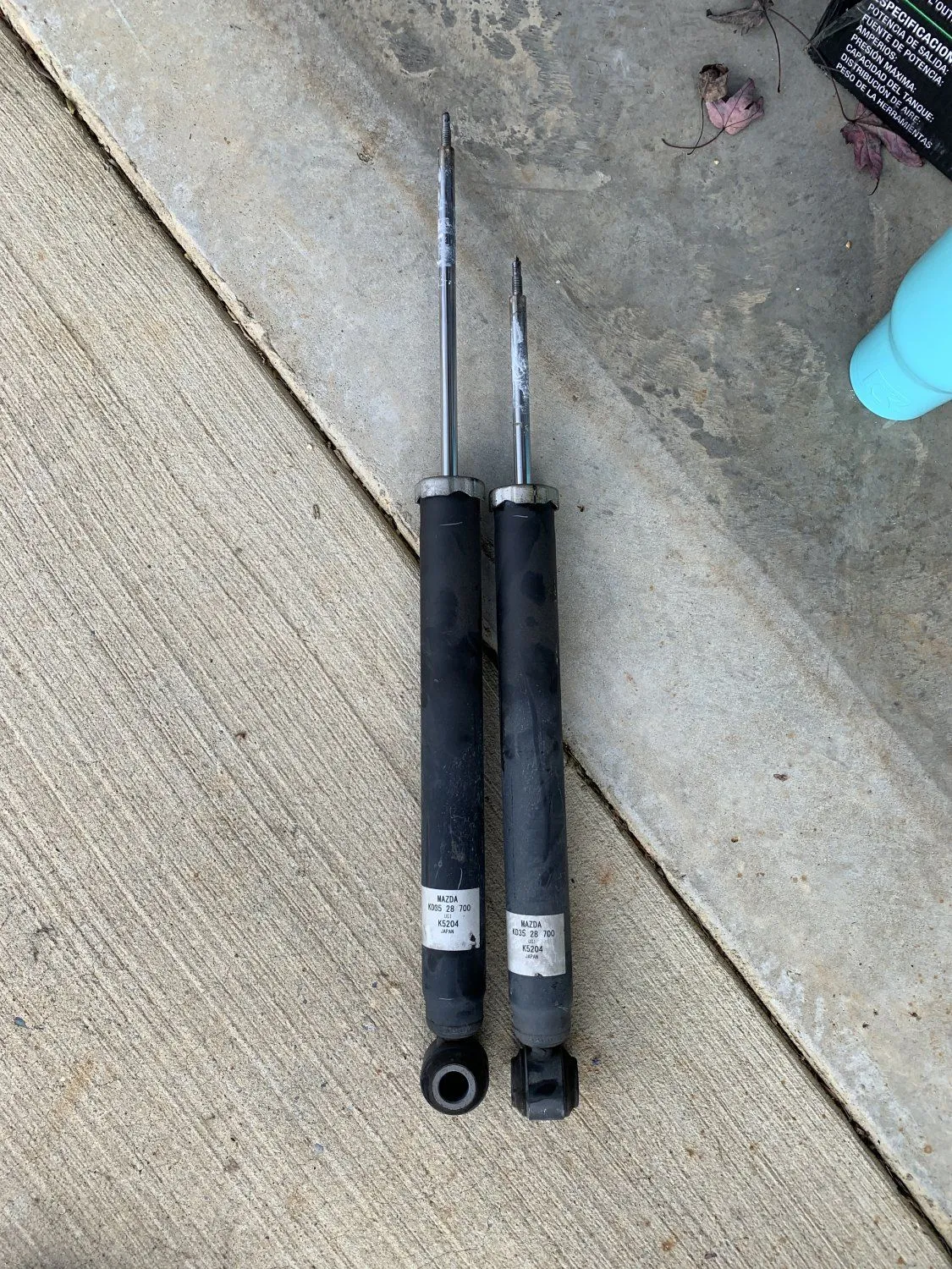

rear shocks are replaced. You’ll need a 12mm box wrench and a pair of vice grips to remove the mount. Grab the stem with the vice grips and unscrew the 12mm nut. It had some blue lock tite, so I applied some when installing the mount to the new shock. Saved about $40 per shock vs OEM reusing the old mounts, but YMMV. If I ever replace these again, I’ll get OEM for the included mounts.
rear right shock was definitely bad lol. Some seepage down the side. Pic included to show it doesn’t push as far as the old drivers side.

Apparently you made a right decision to replace your rear shock absorbers. The factory rear shocks from Japan have p/n KD35-28-700 on your 2013 CX-5, and the current OEM rear shock for 2013 CX-5 has the p/n KDY5-28-910C. It seems to have several revisions so far.

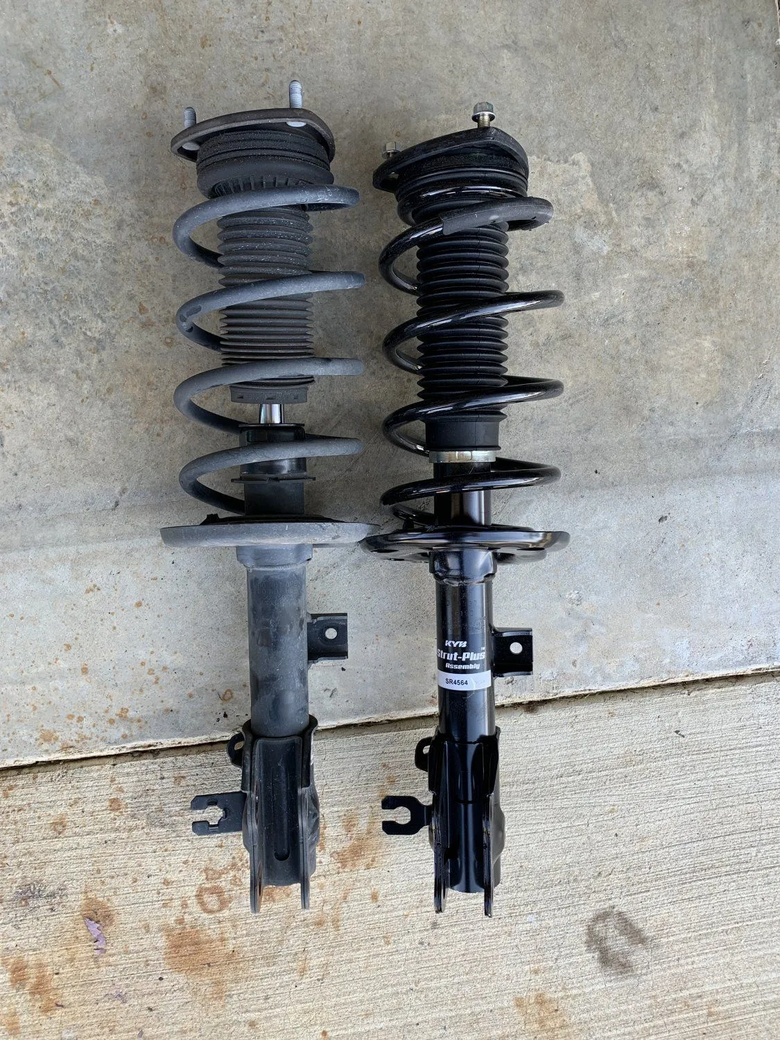

I’m very impressed with the build quality of the KYB complete strut assembly. At just over $100 a strut, I think these were a no brainer.
That's for the quickstrut? That is good.

Yessir, $113 at Rockauto. I’ll have to send in my rebate for $25 for a full set of KYB shocks and struts too.
Not trying to save $100 per strut, but I prefer the original spring where the spring on complete strut could have a little differential spring ratio and may cause different ride quality. So far I haven‘t tried a complete strut. Like replacing torn CV boot, I’ve aiways been using new boot kit instead of getting an entire drive shaft.
Yes, KYB does have good reputation on quality. Do they say where are those made? China?
Like everything in Mother Russia, they say Made in Taiwan
Huh, on second thought the box for the front struts says “Assembled” in Taiwan. The front struts say “Taiwan”. The shocks are made in Japan. Odd lol
