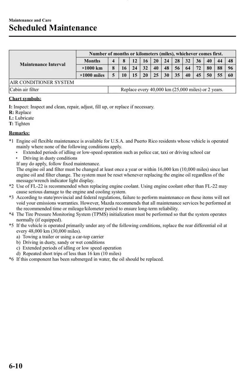

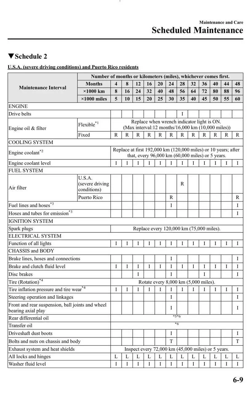

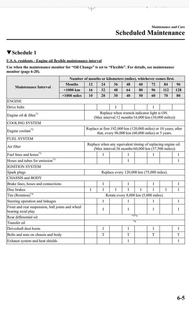

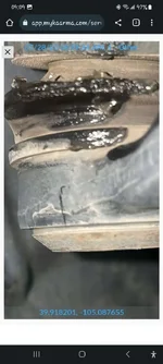

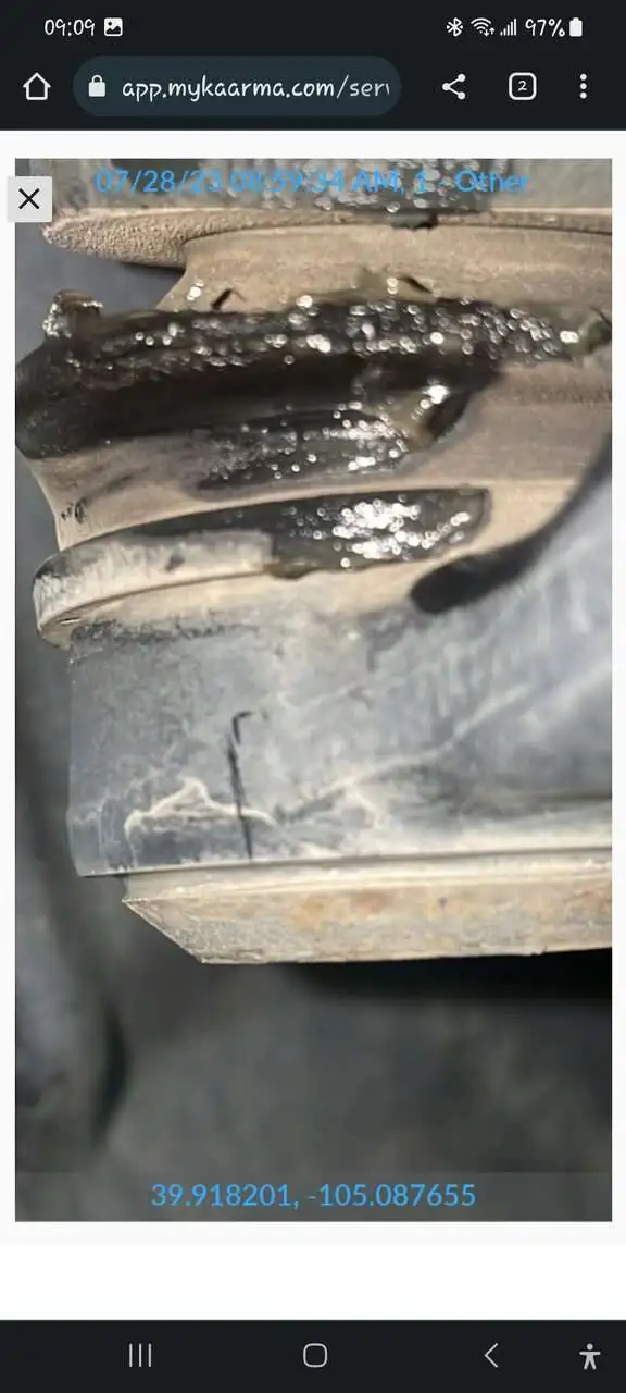

Control arms and tie rods? Unless you have obvious problems such as torn boots or clunking noise, I doubt you need to do anything on them at 74K miles.

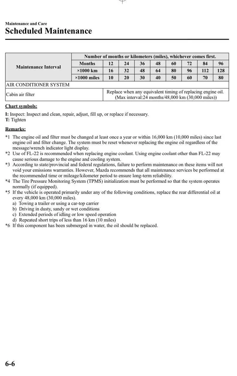

Here’s the maintenance schedule from the owner’s manual of you 2016.5 CX-5:
I can see doing the other work but these two items caught me off guard. Especially with only 74k miles and how and where I drive. Wondering if I need to find another shop.
You didn't state how many miles are on your CX, more than 64k it seems?
What kind of driving do you do? Why are the front-end suspension components in such bad (according to the dealer) shape? I have the same MY CX that you do, although with considerably less miles than yours, and I don't have any of the issues that your dealer says that you have. All the front-end components on mine look perfect. Have you seen the damage the dealer mentioned with your own eyes?
Color me skeptical.
I mentioned early on 74k miles. This service manager seemed like a stand up guy but this seems odd to me. I had a '94 Celica I put 282k on and saw little of this sort of thing. Certainly not until higher mileage.
My driving is on the city on pretty smooth pavement. Maybe a handful of highway road trips. Photos, details attached from Mazda service.

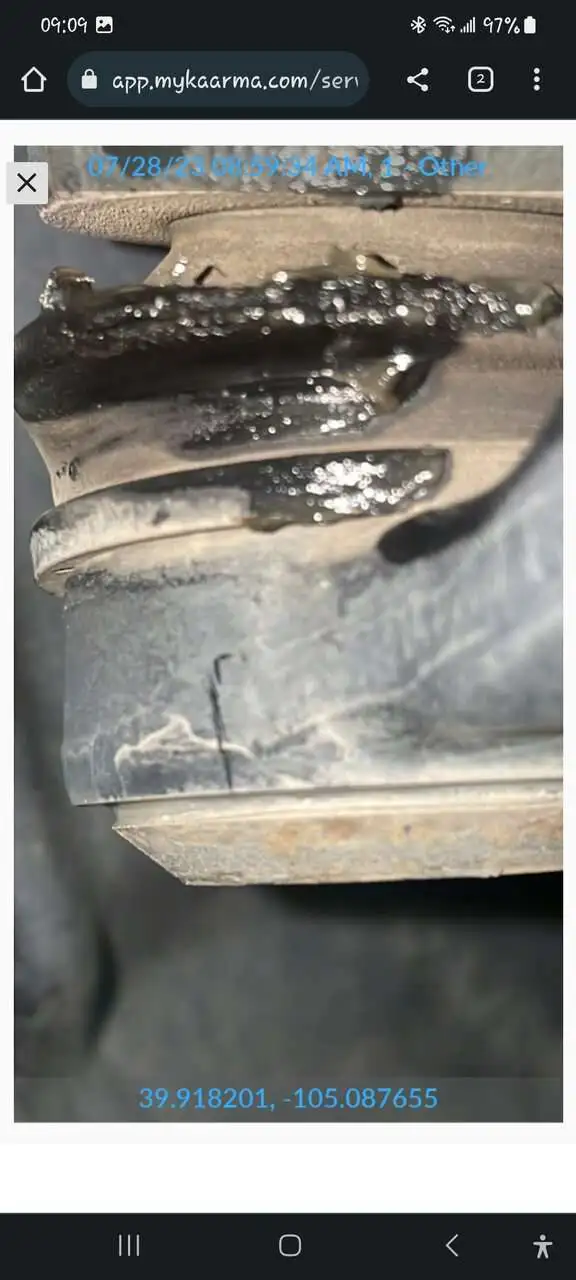

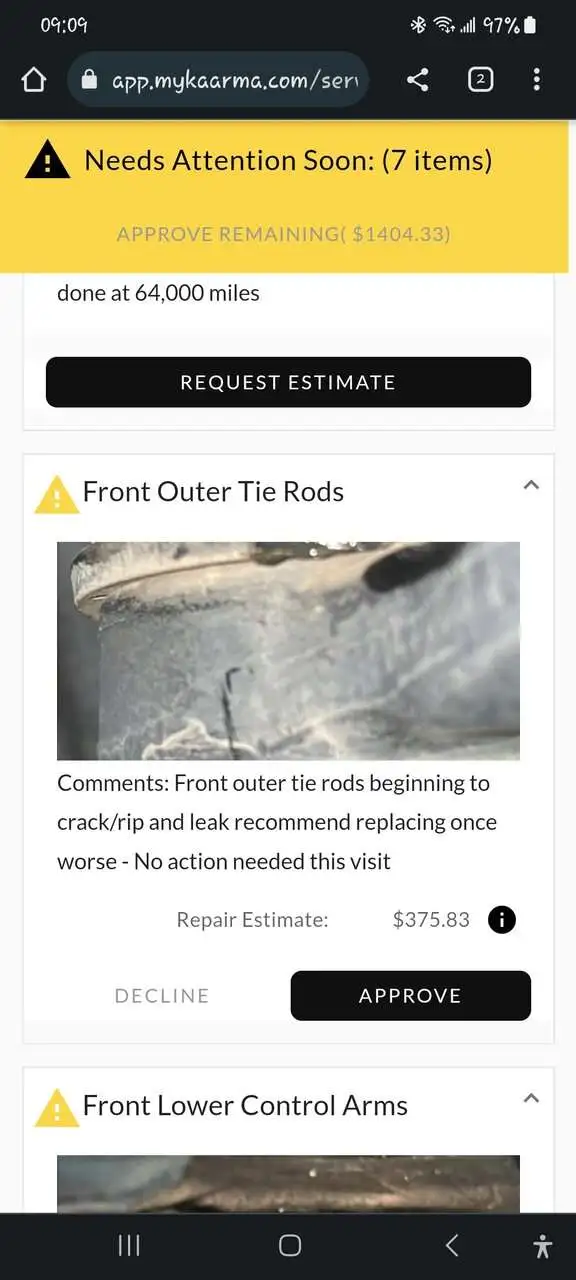

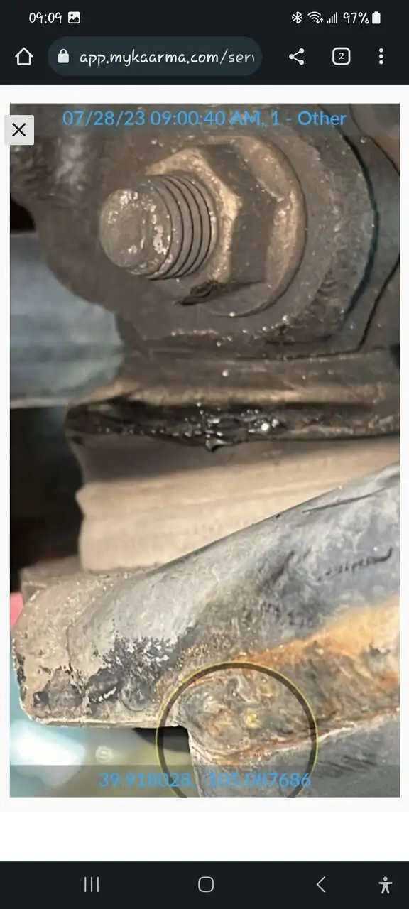

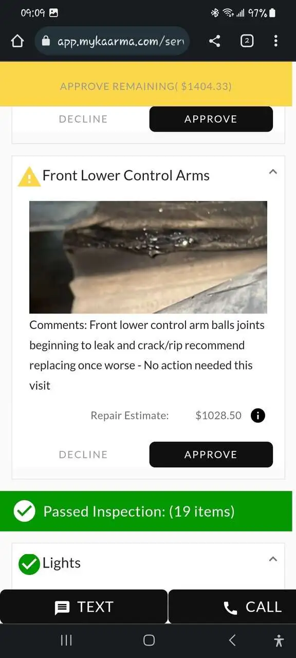

Seems to me like an honest report of conditions to you from the service provider. Those boots appear to indeed be ripped/torn/cracked/whatever and will eventually lead to worn out parts as moisture invades the areas. The recommendation of "replace when worn" is accurate. It could last a year or ten years.
That's a very good report of potential future issues and nothing saying you must do the work right away.

They do have down as needing attention (photos available). They suggest doing the following within the next 5k to 10k mi:
-front outer tie rods (Front outer tie rods beginning to crack/rip and leak recommend replacing once worse - No action needed this visit). $375. Inc tax.
-front lower control arms (Front lower control arm balls joints beginning to leak and crack/rip recommend replacing once worse - No action needed this visit). $1028. Inc tax.
-alignment after above work $119, before tax

I've mentioned this somewhere in earlier posts, but I'll chime in here and stir the pot a little.
Addressing some of your points mentioned it goes as follows:
>Regarding coolant flush, I decided to change (2X drain and fill) at about 43,000 +/- miles as I feel 10 years is too long for first changeout per Mazda. "Flush" what is there to flush out? The factory coolant looked pristine and no sediment in the drain pan. Done at same time as 2X drain and fill of transmission fluid.
> @ ~ 60,000 miles-- lower control arms and tie rod ends changed because of torn control arm bushings and all boots dried and split leaking grease. There was NO wear evident (looseness) yet but decided to get all done as a 'mid-life refresh' and these parts still had 60k wear. The control arms and their mounting bolts (all OEM Mazda - new bolts alone were ~$50) plus~40 shipping. Also new tie rod ends ,quality Japanese aftermarket because Mazda not available, were about $22 each. Parts total came to about $500 . Labor and alignment ($130 + 70) another $200. Since replacing control arms or tie rod ends both require an alignment, might as well get it all done with one alignment.
> right after this I had my mechanic install new front stabilizer bar bushings. cost ~ $20 parts and $80 labor. I tried first, no way in hell, it went for him to do LOL. They made a small improvement in further tightening things up and importantly are DONE.
> About 3 weeks after having this done, I got new tires( Pirelli Scorpion AS+3, there's a thread or 2 on these) for ~600. Already had a fresh alignment so no additional expense there.
>The philosophy here was to get all new parts (I did stabilizer bar end links about 6 months prior to all of this work, so good there) to render a tight front end with good ride and handling and nothing required for a long time. And that is what I got!! Now, I've been down the "replace 'this part' and a little later replace 'that part' because it is now worn out" type of scenario in the past and it "don't fly no more". Especially if $50 worth of parts cost $100 alignment and could have been done before.
>In summary, total cost of parts, labor ,alignment and new tires --- about $1500+/-.
I find your quotes for tie rod end and control arm replacement rather atrocious and they don't even include the necessary alignment, that's quoted extra. And another very important thing-- are these OEM Mazda parts or some questionable aftermarket parts that may fail early and that they have marked up the price hugely.
I, personally, think you can do better.
Almost forgot to add-- I purchased the parts and gave them to my mechanic to install (not all mechanics will) and he is cool with that. But ,as is custom, he can't offer a parts warranty because he didn't supply them and I expected that going in.
Well, that's my curmudgeonly view on things. Good luck.

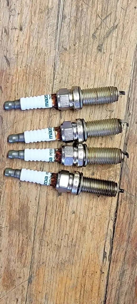

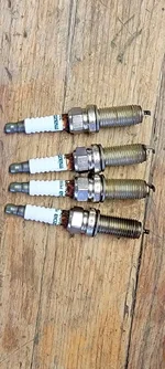

Got the plugs done today with this view. And the old plugs don't look too bad for a little over 74,000 mi.

I posted the official Mazda maintenance schedule from your 2016(.5) CX-5 owner’s manual in post #38 and you don’t need the first coolant change until 120,000 miles or 10 years.
Your 2016.5 Mazda CX-5 GT AWD w/Tech has 74K miles and is about 7 years old. Why you worry about the coolant change at this time?
IMO for a 800-mile trip, I don’t believe you need to worry about anything mentioned previously. Just make sure all fluids, oil、coolant、brake fluid、and windshield washer fluid are up to the Full mark before you go.
