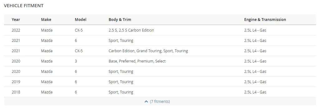

I am seeing that the part PYY4-10-SJ0 is the preferred choice for the replacement of the cracked heads. This part seems like its built in Mexico.
So!!! the affected Japanese built cars are getting replaced with Cylinder heads made in Mexico.
Looking at the vehicle fitment history, the part PYY4-10-SJ0 might be in production since 2018
Taking all this into consideration, Mazda might have not done any modifications to the design to address the cracked cylinder head problem, but are asking the dealers to replace the heads based on the availability of either PYFA-10-100E or PYFA-10-SJ0.
Assuming that PYY4-10-SJ0 has been in production since 2018, this does not guarantee that the problem will not reoccur.

I am seeing that the part PYY4-10-SJ0 is the preferred choice for the replacement of the cracked heads. ....
That's the number of the 'loaded' head, which includes all valve train components installed, with the exception of the HLAs. And that's also the reason for the higher price. Reading between the lines of the TSBs, they started distributing that head when it became clear that the dealers were regularly replacing LOTS of 2018 NA engines under warranty, due to cracked heads. Mazda decided to cut their internal costs by replacing the head, instead of the entire engine,. And they also cut the number of hours for the job (i.e. their warranty reimbursement for labor back to the dealers), as a result of the tech no longer needing to transfer valve train components from the cracked head to the replacement.
The consistent story from nearly every Mazda employee is the root cause of the cracked heads being bad castings (i.e. a manufacturing problem). Now that of course does not make it the 'truth', but it's certainly been consistent anyway. Also, the replacement loaded head is visually identical to the original 2018 head, and so far, no one has ever presented anything showing that the base part of the loaded head is different in design or structure from the original 2018 head.
But, as always, stay tuned for additional information.
